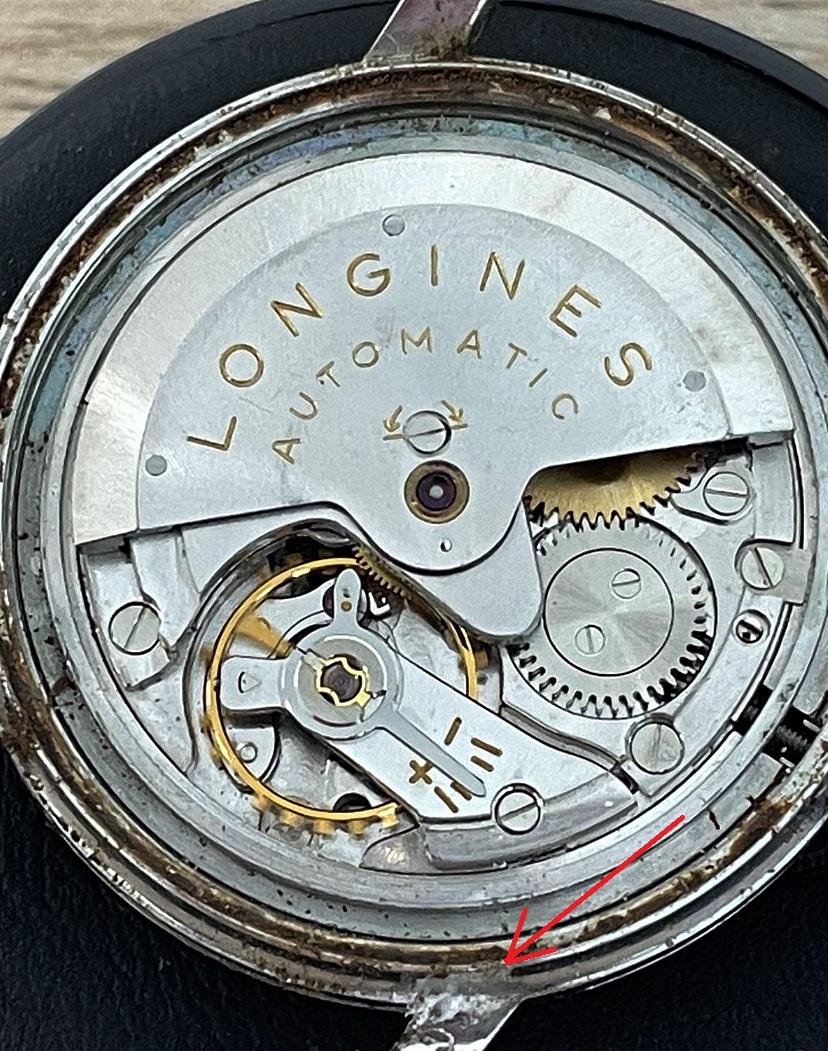

Hi specialists, can you please take a look at this movement from a seller? Do you see, besides of the dirt?/rust from salt water??, anything "conspicious"? And did thee have been some repair on the case?
Thanks in advance! Jo

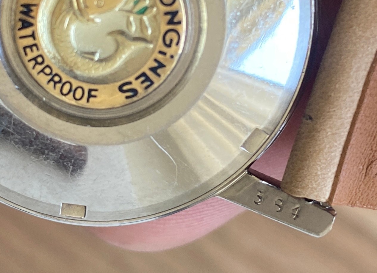

Its sold with a metal-bracelet...so are these marks on the case normal???
edit: lugs are original
edit 2. what stands the number on the lug for?
