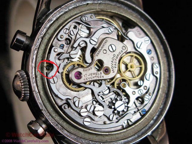

    Can anyone confirm that the circled screw in the image below is the stem release screw? It seems the only plausible candidate, but this chronograph module has me a little disoriented.

    Only plausible candidate :D

    Yeah, well that's gotten me into trouble before. Never assume.

    You are correct Lou.
    I just checked an illustration of the dial side for the M90/95 and the setting lever pivots from that side of the stem.

    Ah yes, I see that now in the esemblograph book, thanks!
