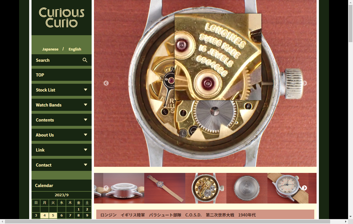

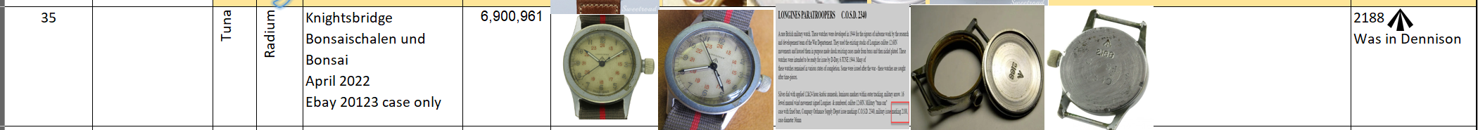

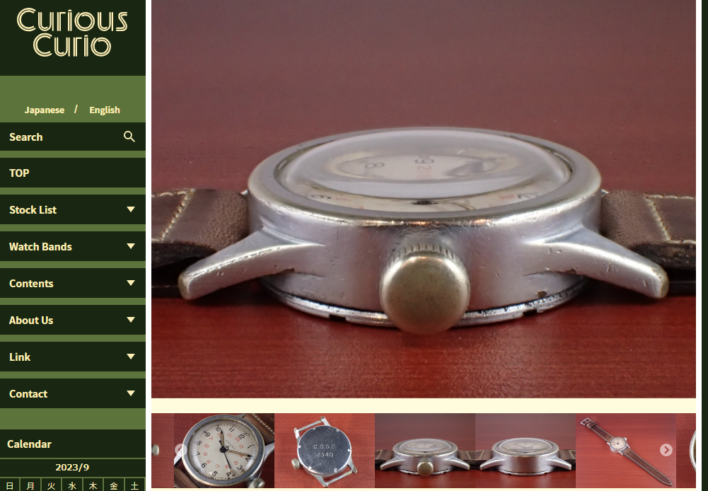

More COSD Transplant and tragically one less watch.
1,532
4,443

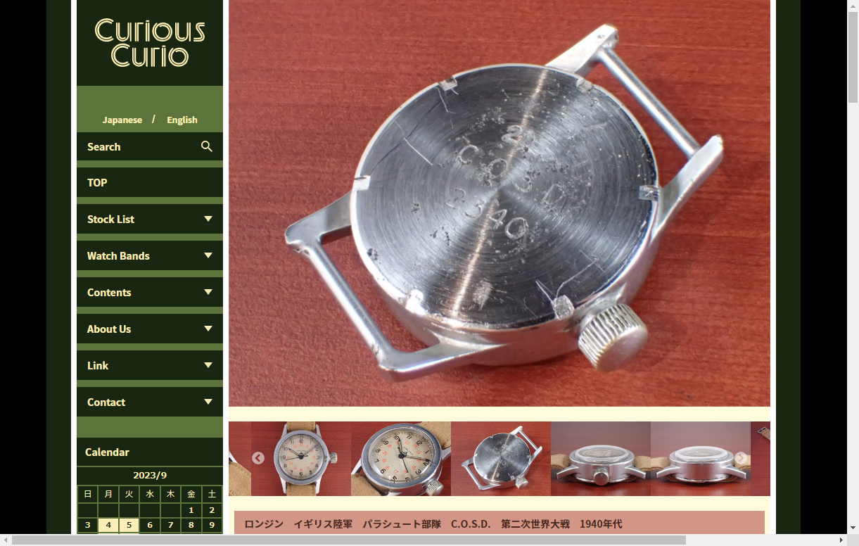

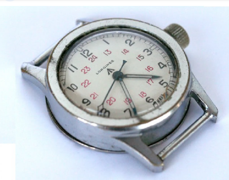

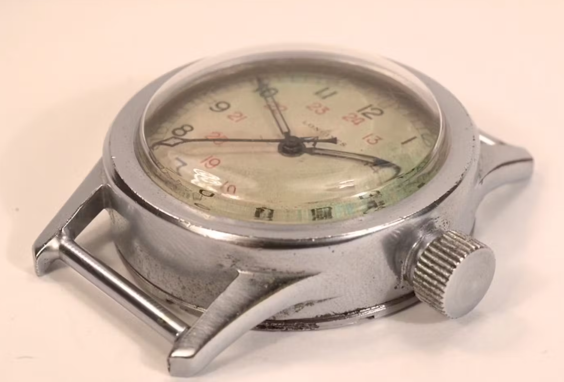

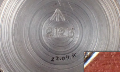

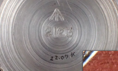

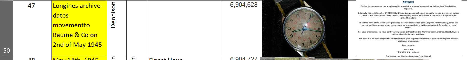

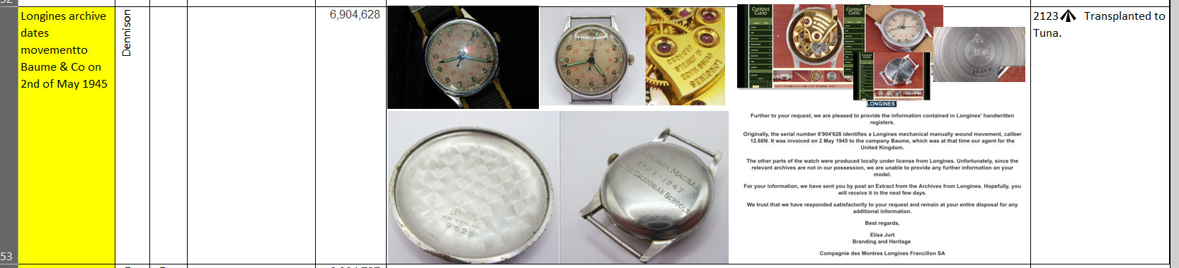

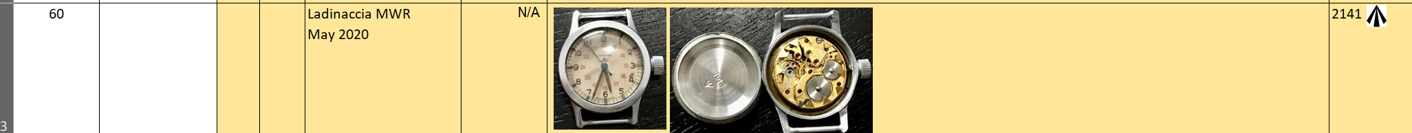

This watch case ^2123 was flagged as unoriginal.

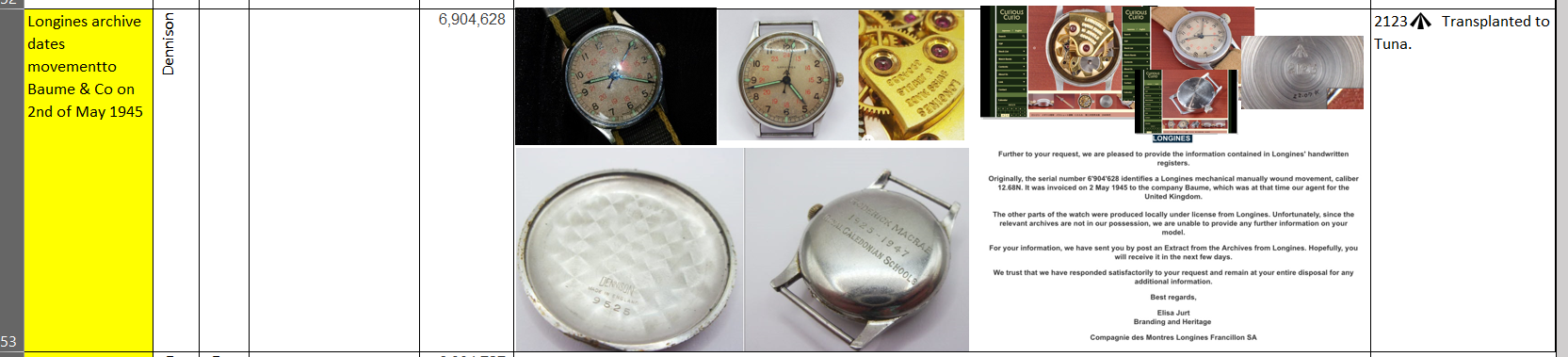

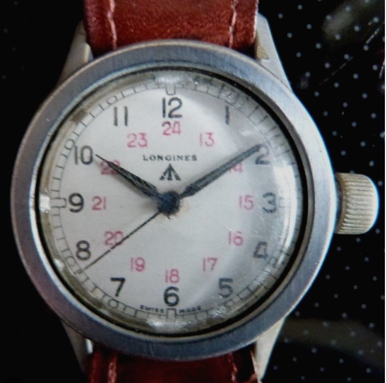

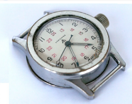

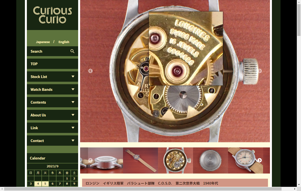

So someone bought ^2123 and bought the below Dennison COSD
Relumed the dial or found another dial and hands and put it in case ^2123
And technically it is still wrong because it ideally should with that case now have a MoD dial no lumen and no lumen hands. Also, this is a minor point but to me big, the case crystal is no longer the thicker domed dive wide flange plexi these cases are equipped with. It has a ordinary top hat semi dome pressure fit replacement plexi so the top of the case and inside retainers have also been taken apart.
And, knowing Ando-san, probably paid well into the $10,000 and over price for watch built out of multiple donors (good or bad). This watch should not be used for tracking re-issued watches.

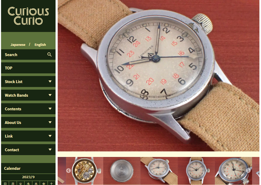

Just out of curiosity, what would you put into a cast off Dennison 13322 former COSD case?
Maybe most of these people were all thinking that no one would want these empty cases? I certainly don't have the imagination to come up with a repurpose scenario. First watch that comes to my mind is a "24 hour Longines" watch surely will have the original reference so would not make sense in a Dennison case and since the asking prices for those have started to get close to $1000 they are better off in the original 24 hour cases.

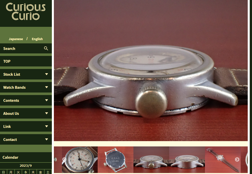

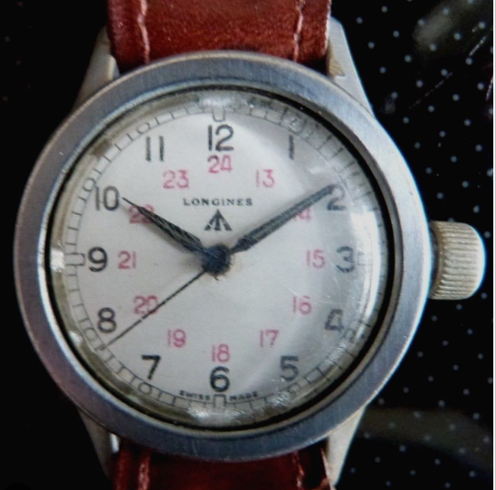

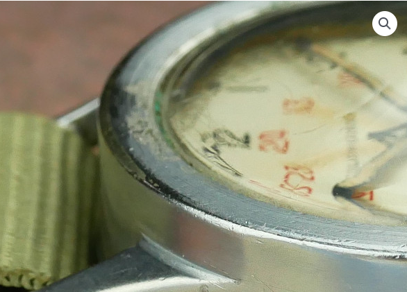

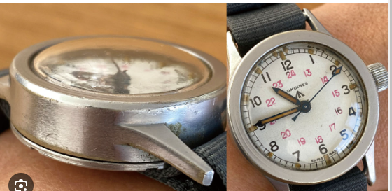

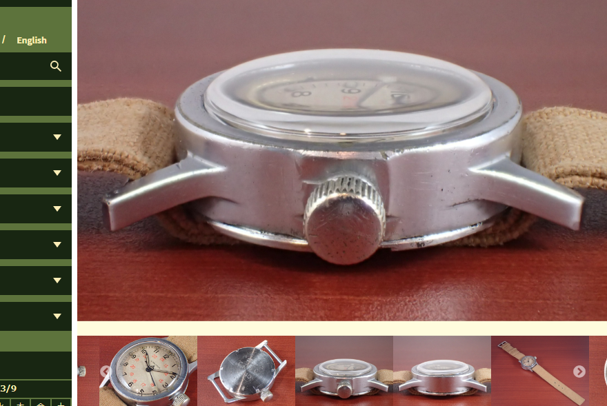

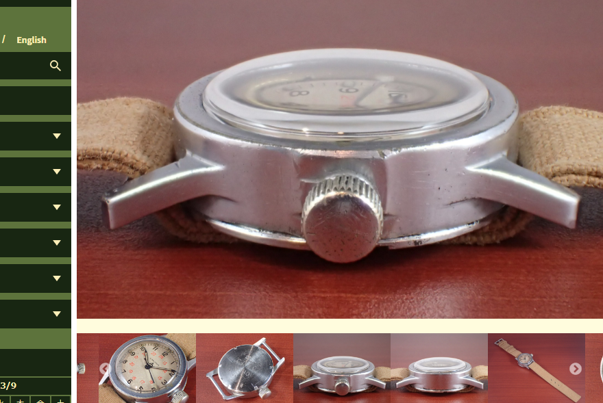

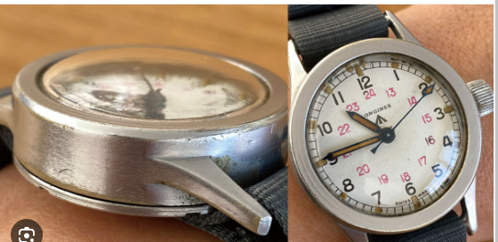

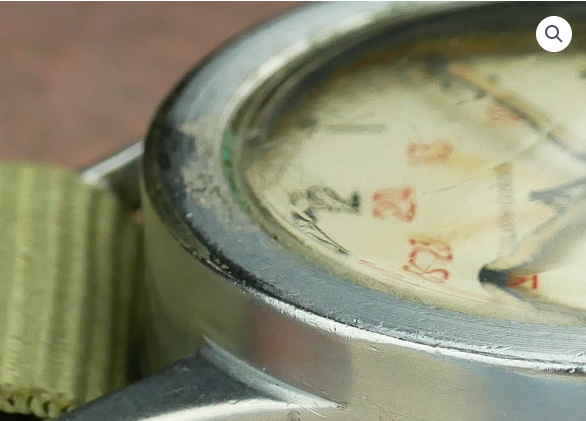

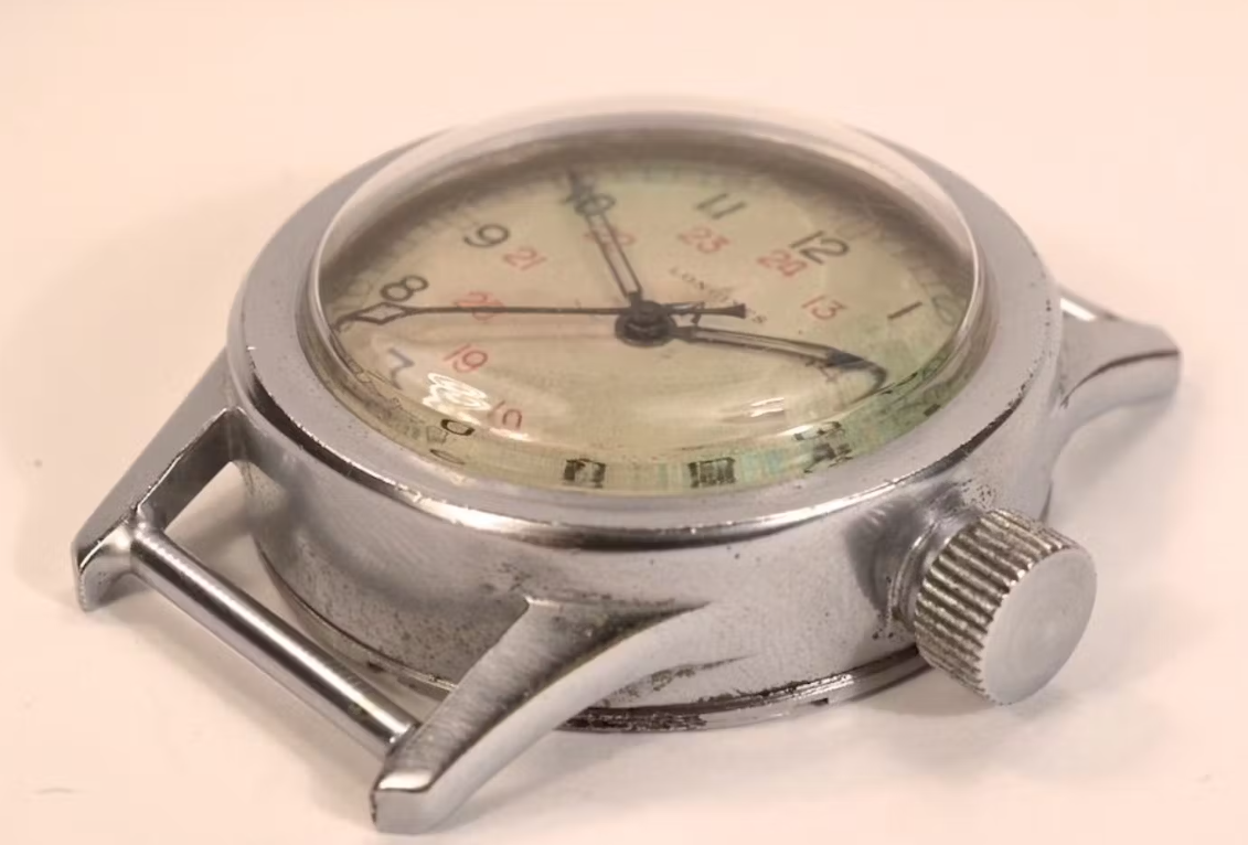

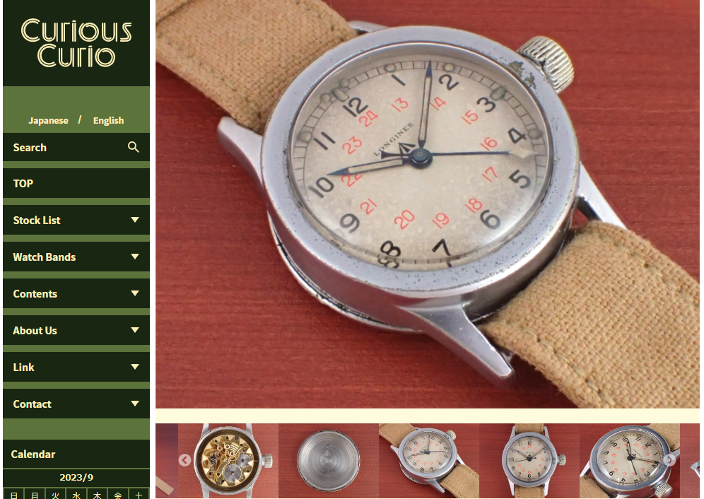

This is probably more of a minor issue, but it also changes the appearances of the watch to have a really wrong type of crystal on the watch in my personal opinion.
These types of plexi are wrong.
Correct plexi, note the thickness of this plexi vs common plexi to resist breakage underwater pressure.
2,597
5,666
Damn that crystal is ugly ! Nice detective work to figure out the donors. I wouldn’t mind so much if there was disclosure, but like you say some clues are there from the mismatch between the early dial and the later small crown.

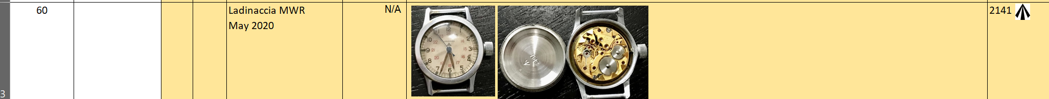

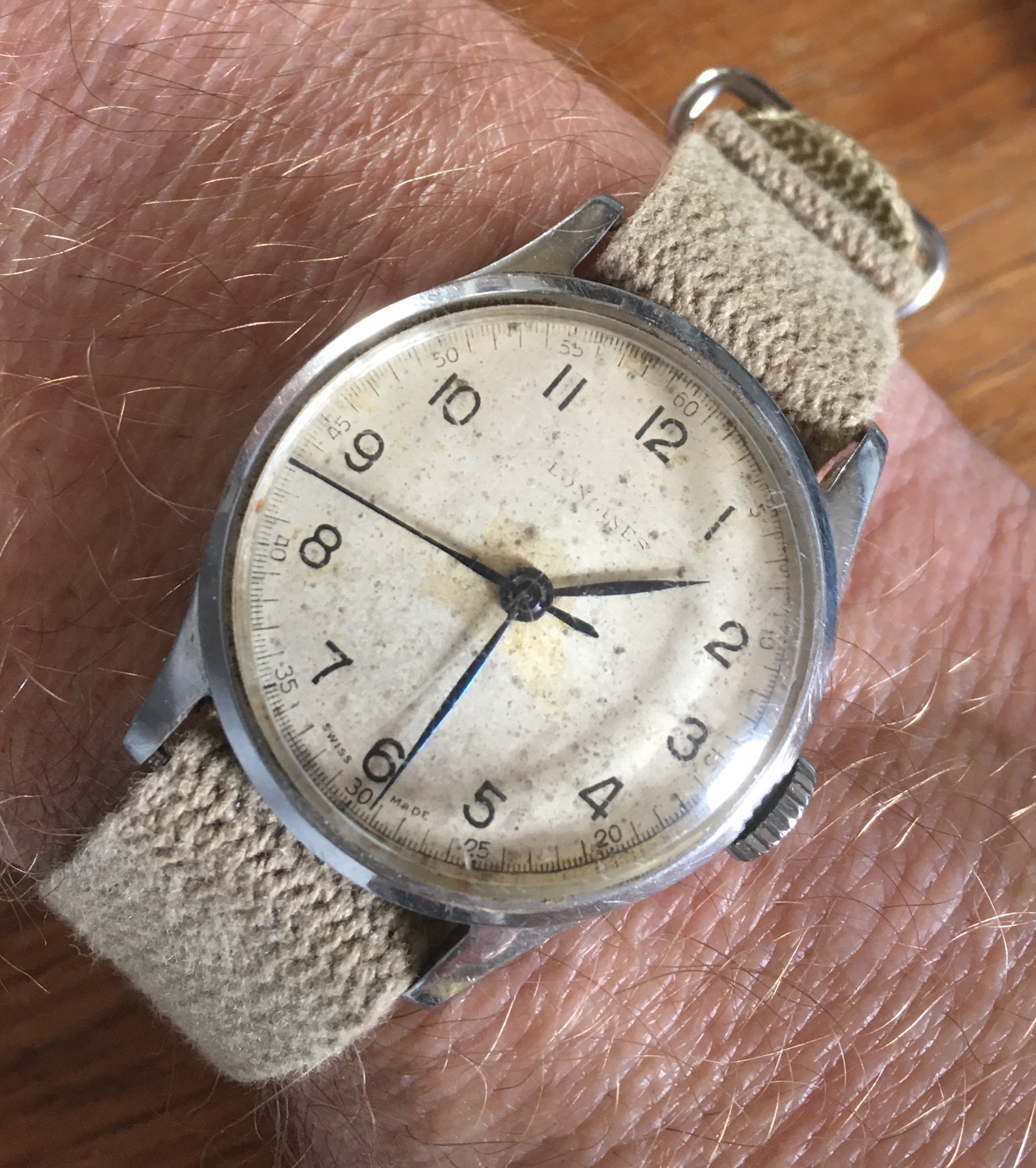

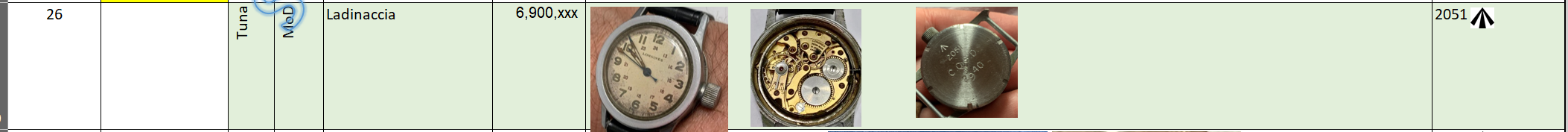

Actually I think this is a common problem.
Three more with radium dials and MoD re-issued cases. I doubt these left the MoD this way.
This one I suspect has other issues until we look at the extract for it. Dial is obviously civilian.

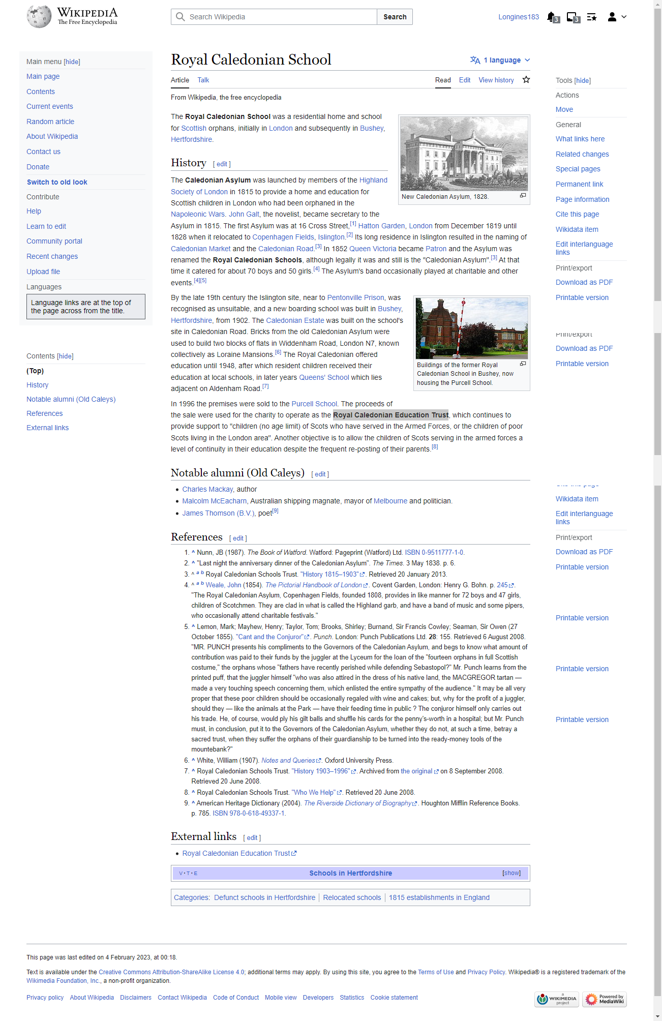

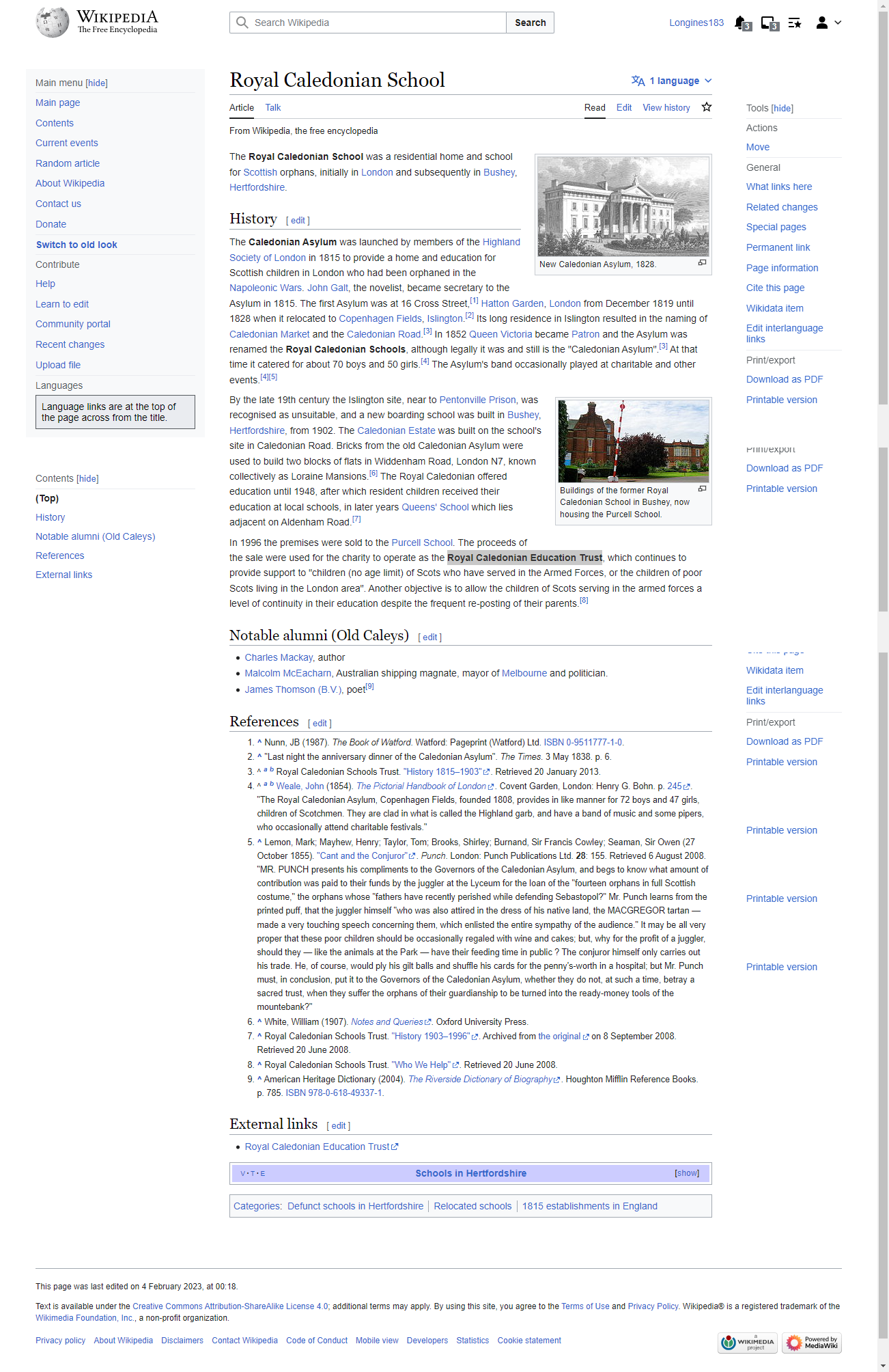

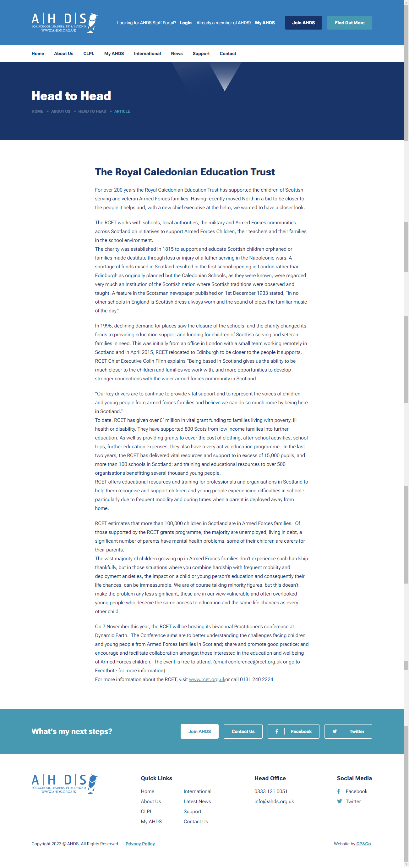

Here is some of the history of the Royal Caledonia School. And it lives on with the Royal Caledonian Education Trust in existance today.
