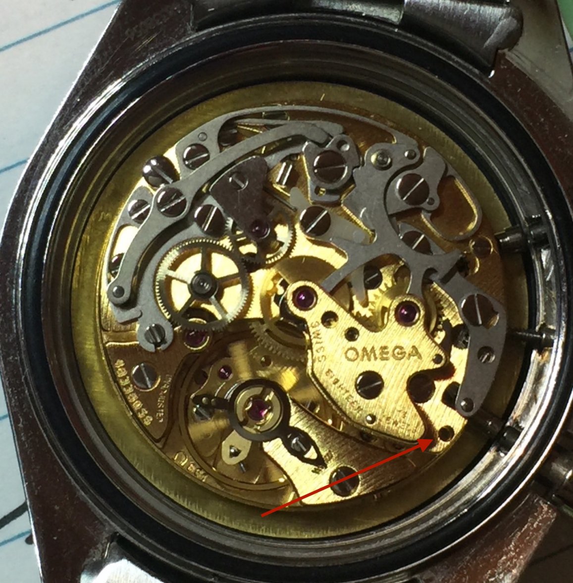

    Hi Guys. Would someone with a 3590.50 cal.861 movement with the spacer/dust cap combination just have a quick check of their movement and let me know the head size of the screw that goes here. It has to be the model with the dust cover and spacer as one unit as other screw heads from 861s with the single dust cap are too large and the cap/spacer cover wont seat over it.

    One unit? Aren't those two screws supposed to hold down the spacer? If not holding the spacer, it doesn't seem screws are needed there.

    Yes it's the same screw as you have on the other side. It's better to have it for the movement to be properly set in. they come over the holding ring. I have to order two at Omega's tell me if you want some. How could you take the ring appart without removing the other screw? :thumbsdown:

    Thanks, mate. Good question. I ended up getting an Omega screw from a watchmaker mate - so lucky there. Yes the dust cap was pressed tight onto the spacer, this is what threw me as I thought it was just one complete unit. The "unit" therefore had been sitting loosely. Now the spacer is secured by the screw head on both sides and all good. Learn something everyday with watches. I am glad it is 100% sorted now though.

    These screws heads are just narrow enough not to touch the edge of the dust cover but they help pressing the ring onto the movement so that the pushers are held correctly.
