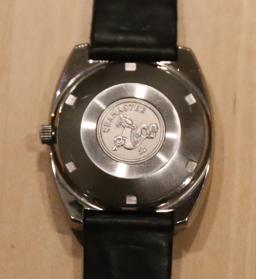

    For completeness, the watch is a calibre 752, serial number indicates 1970. Case ref 166.111. Back is below.

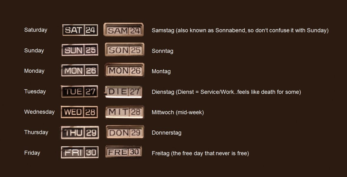

    So, time to start practicing. Here's a little helper for the holidays
    chronos likes this.
  12. rmcd Dec 24, 2016
    13
    15
    A perfect Christmas present :) Thank you. I'll print that and post it on my office wall.
