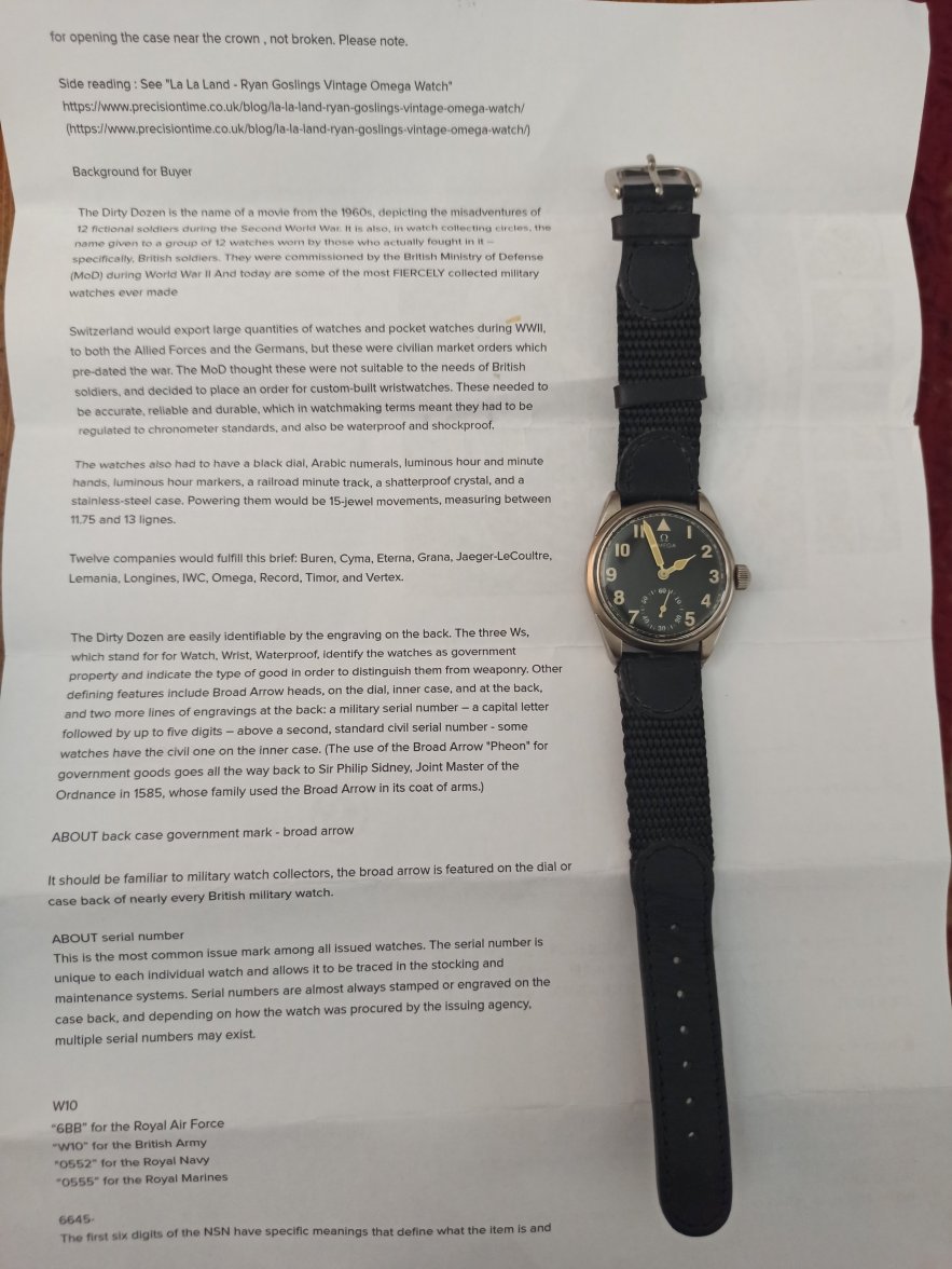

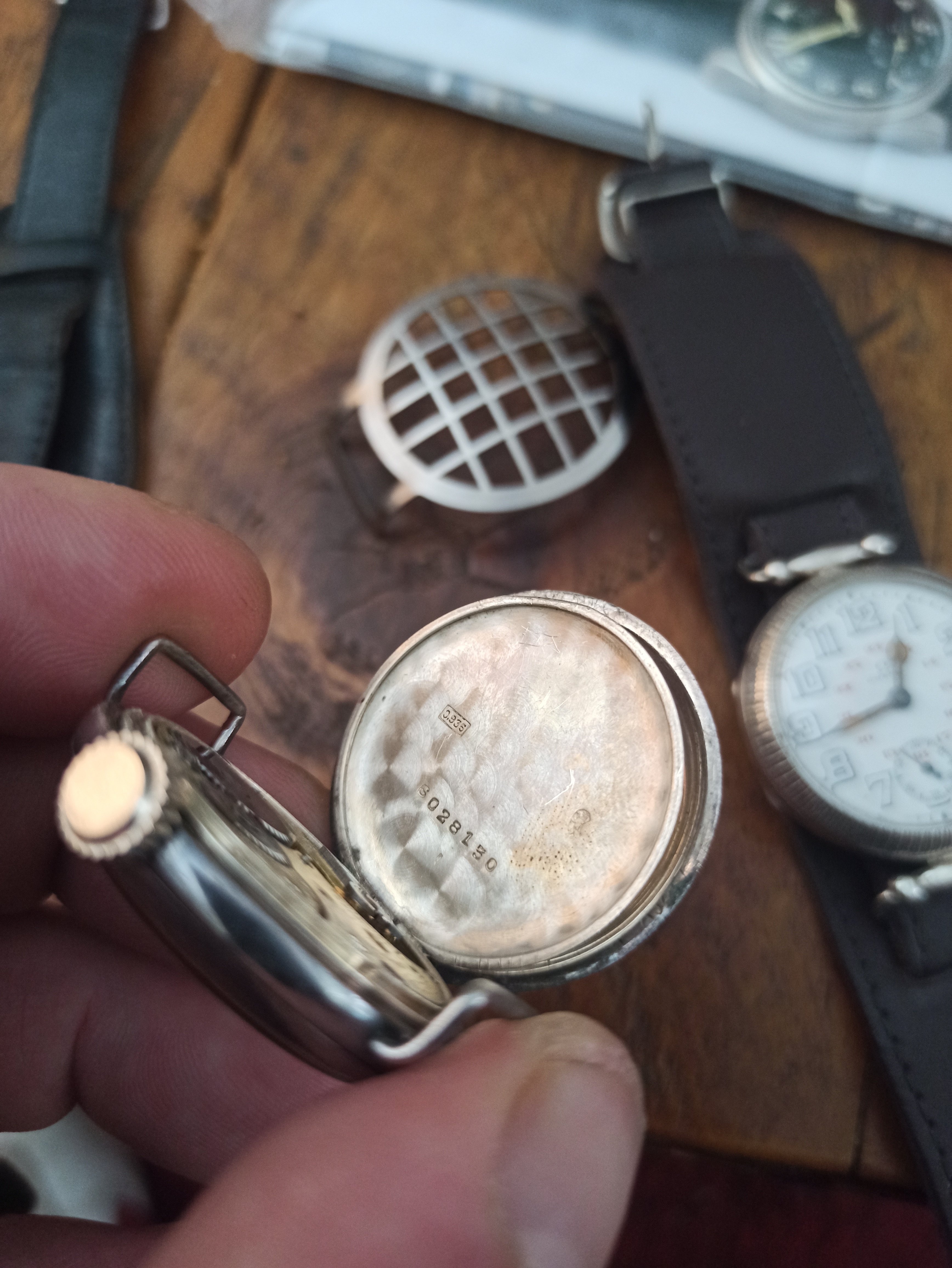

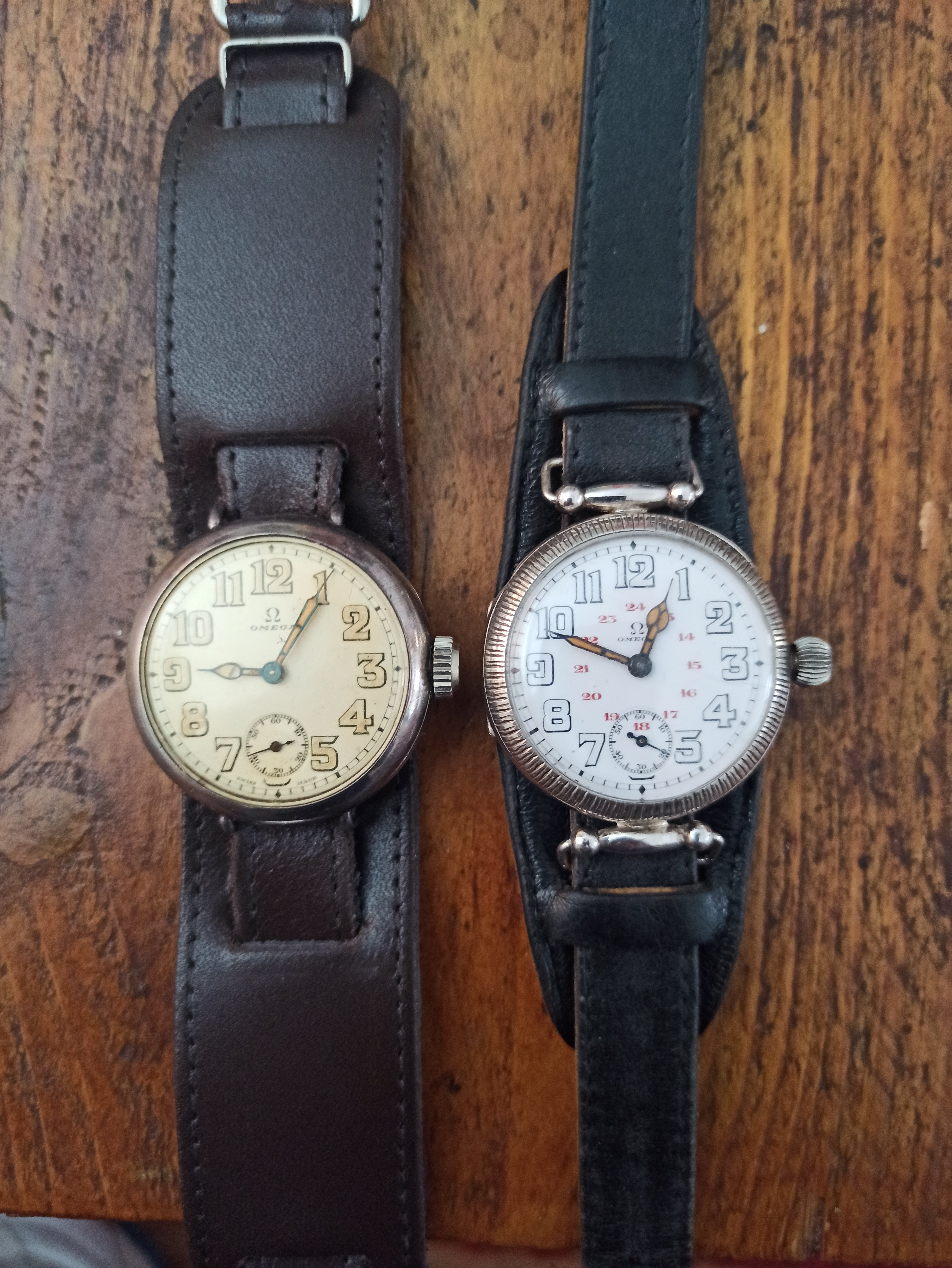

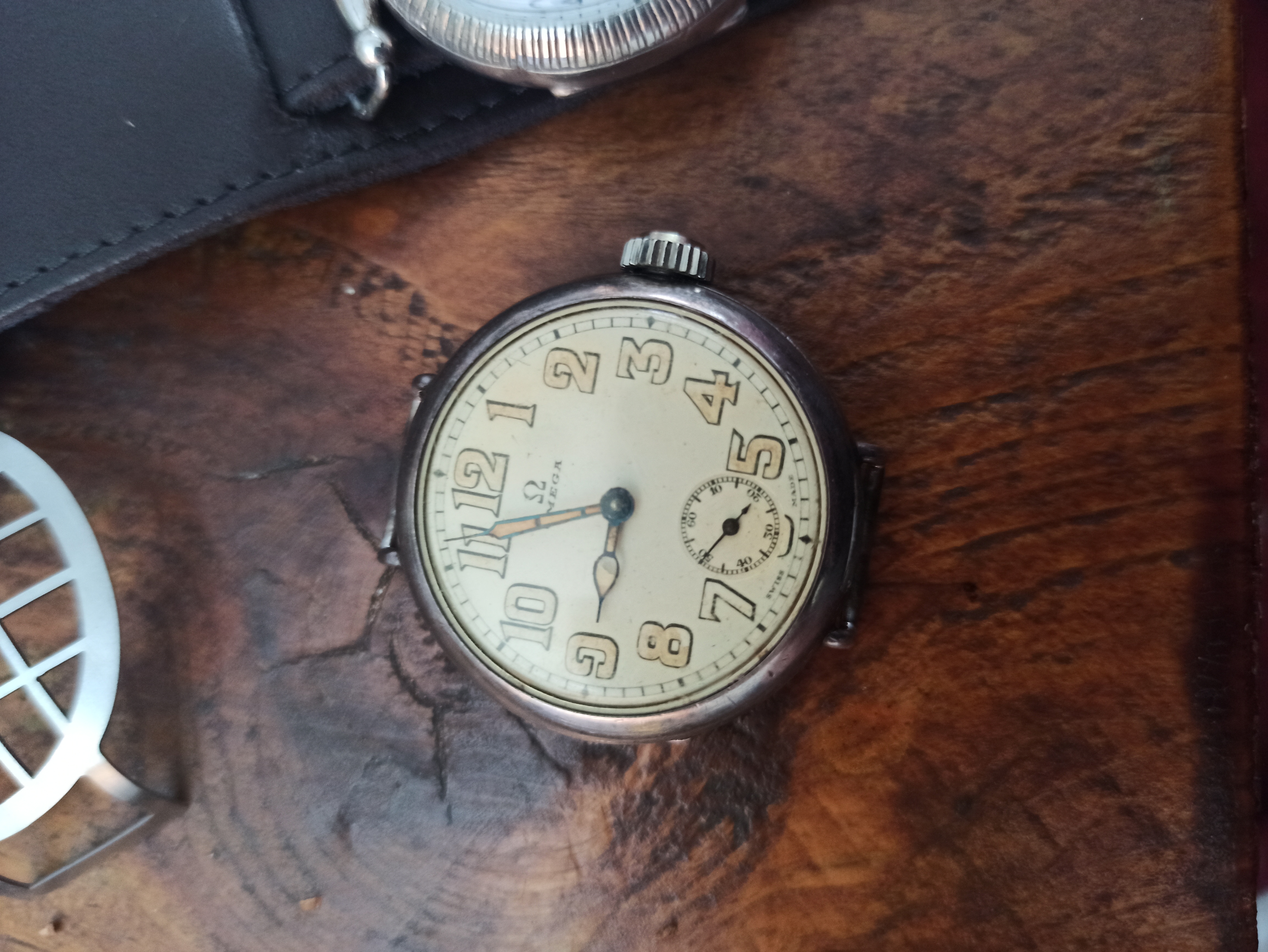

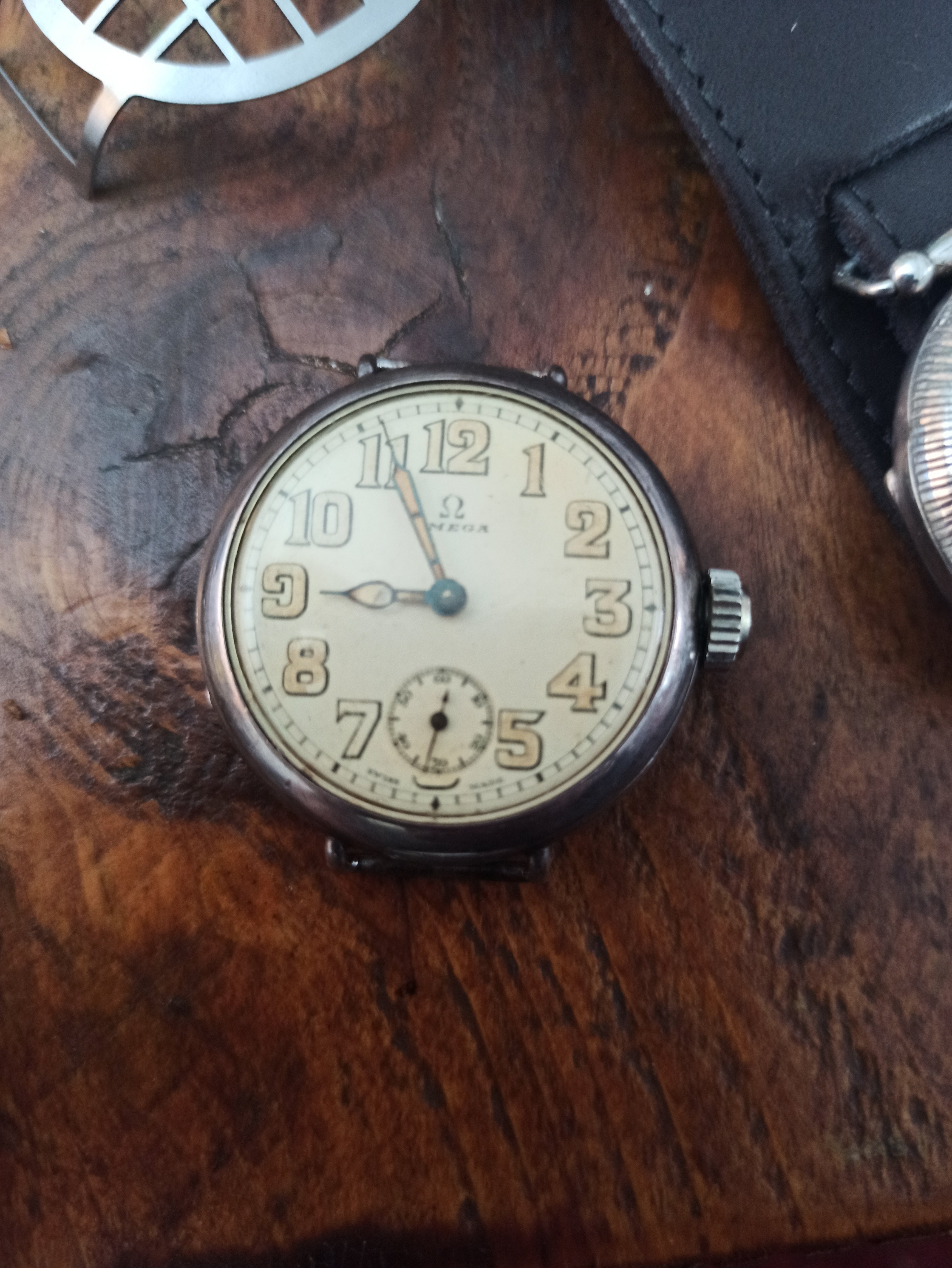

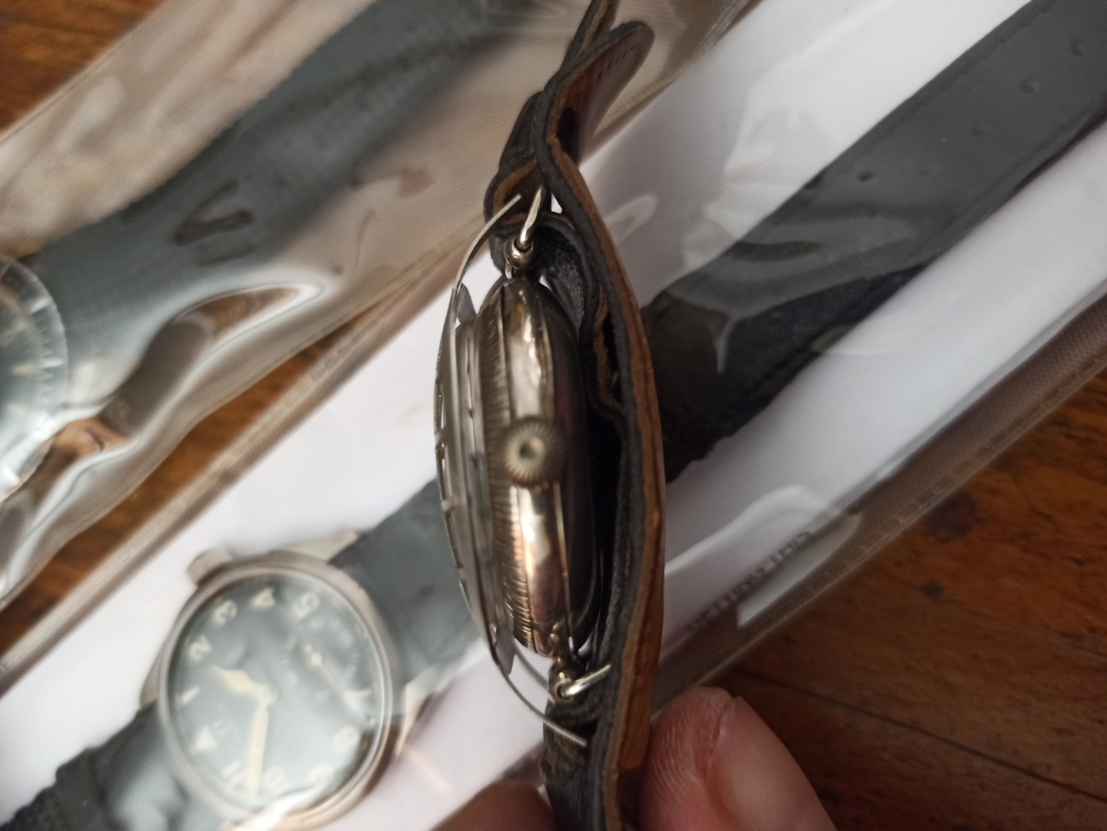

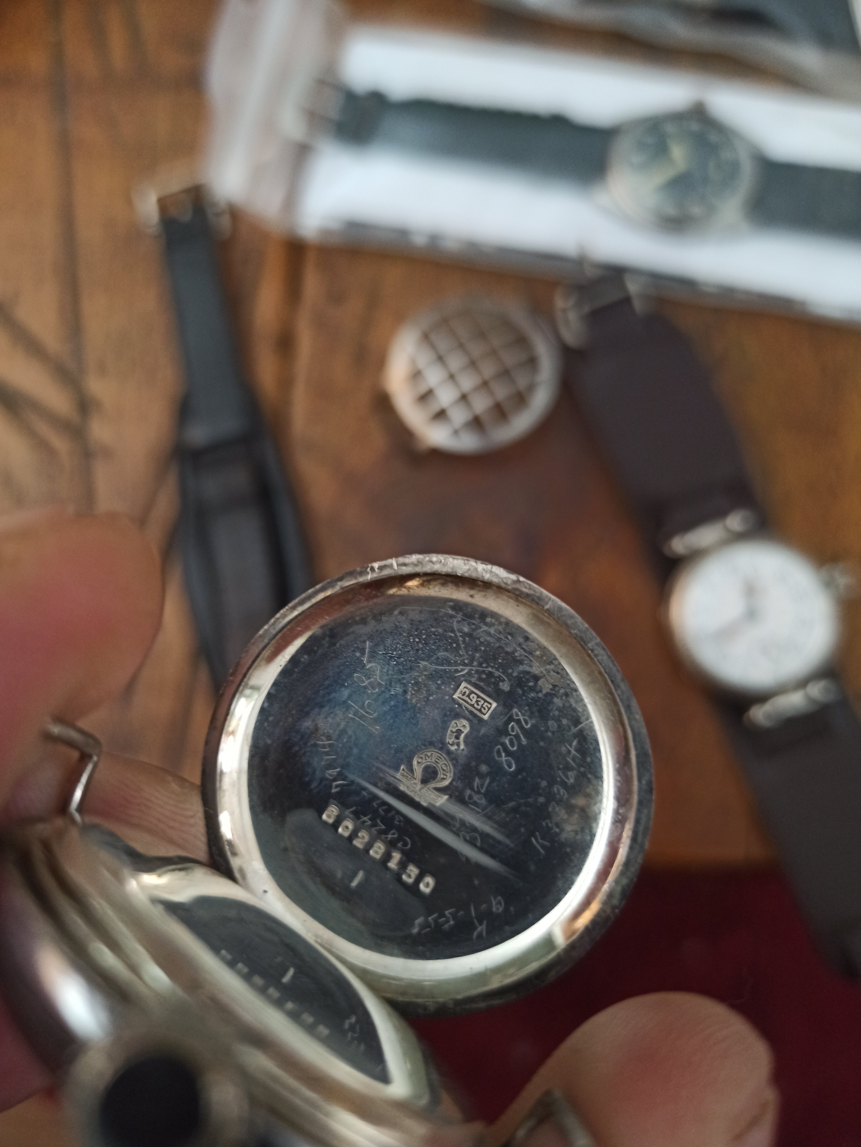

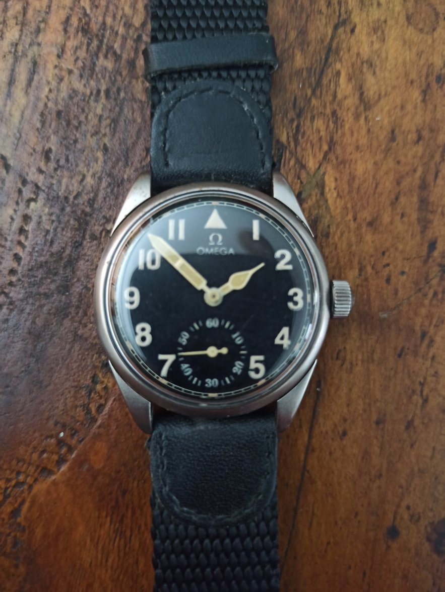

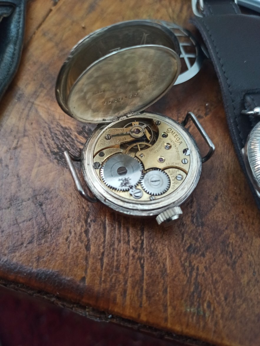

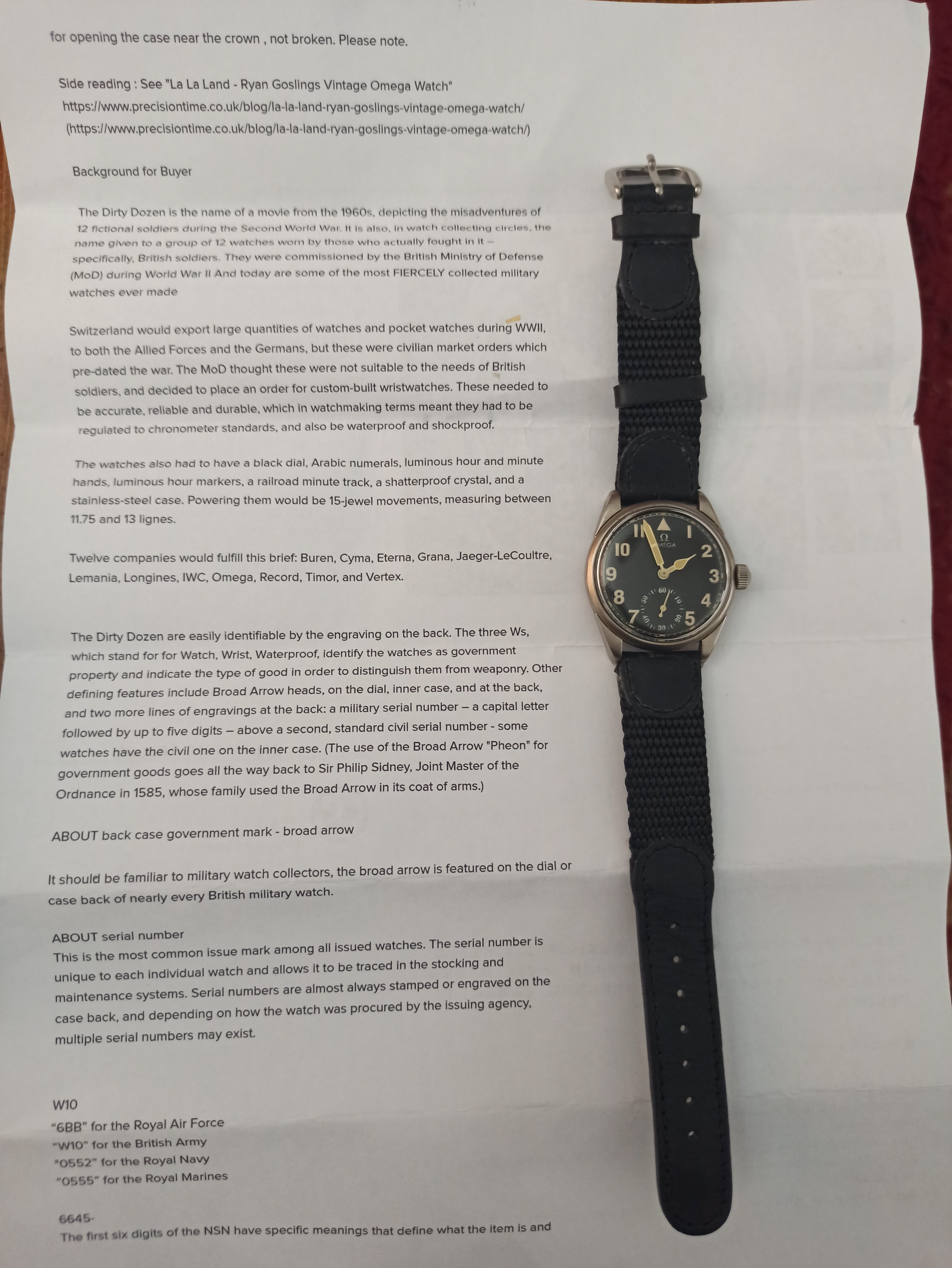

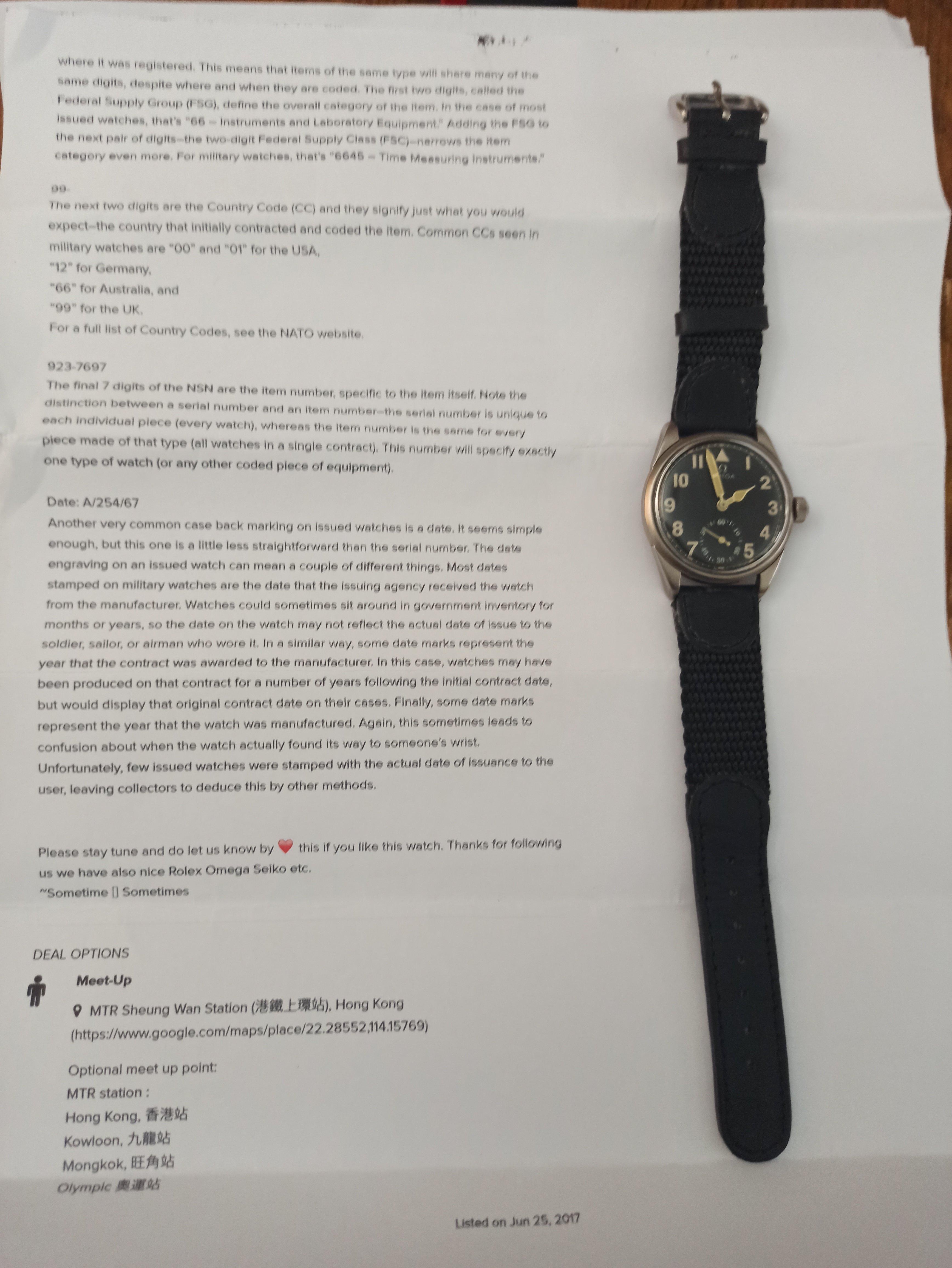

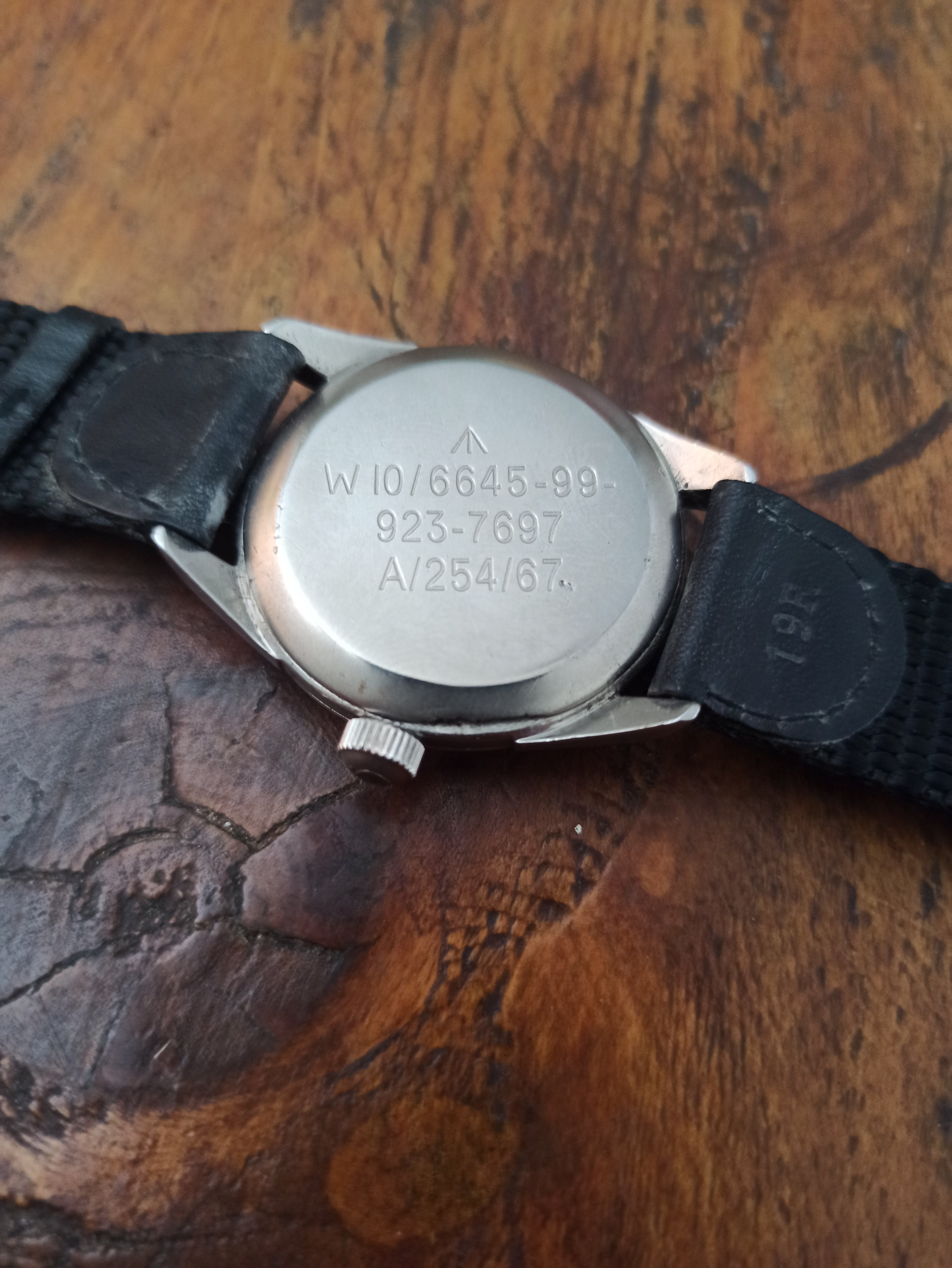

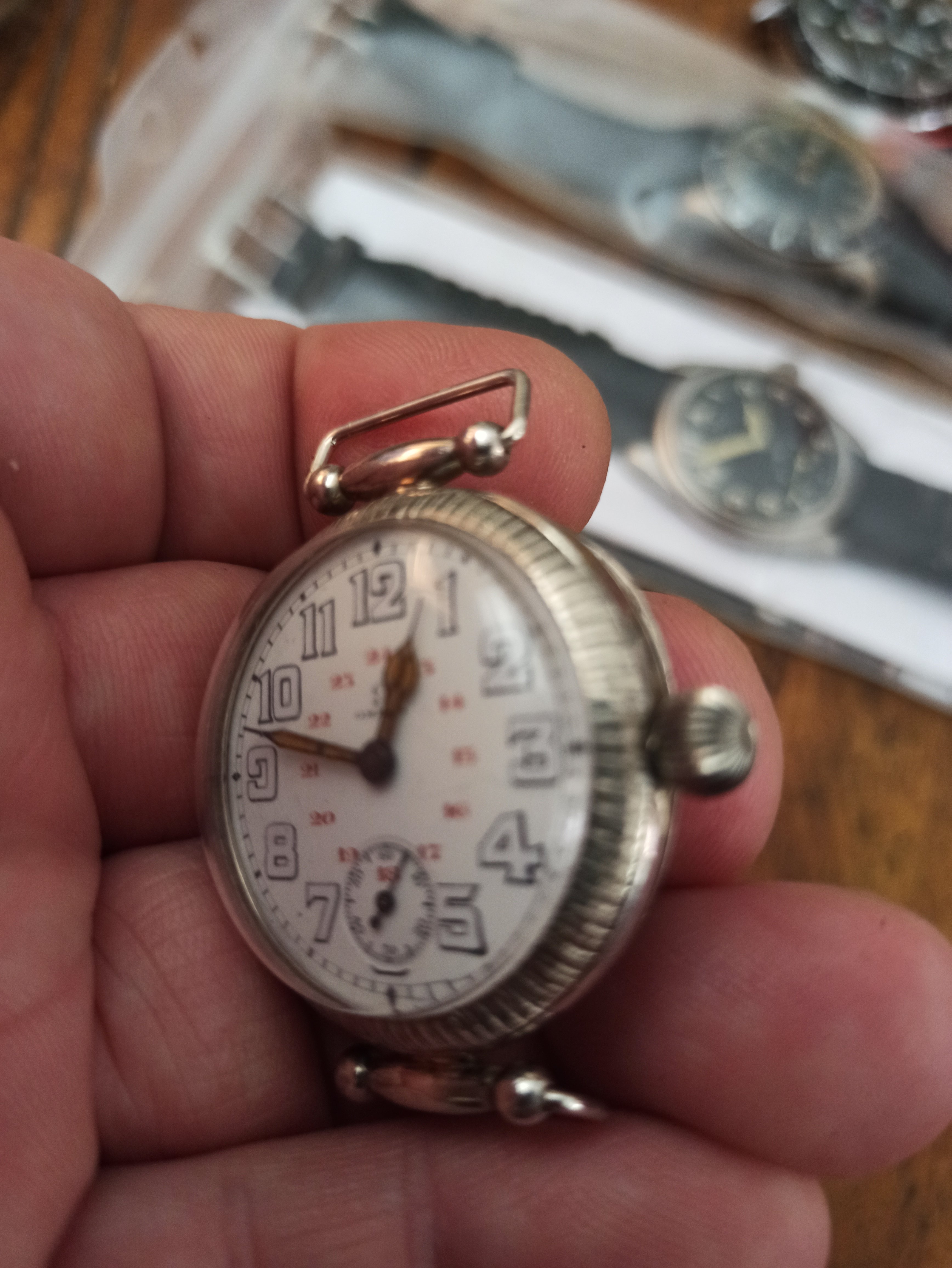

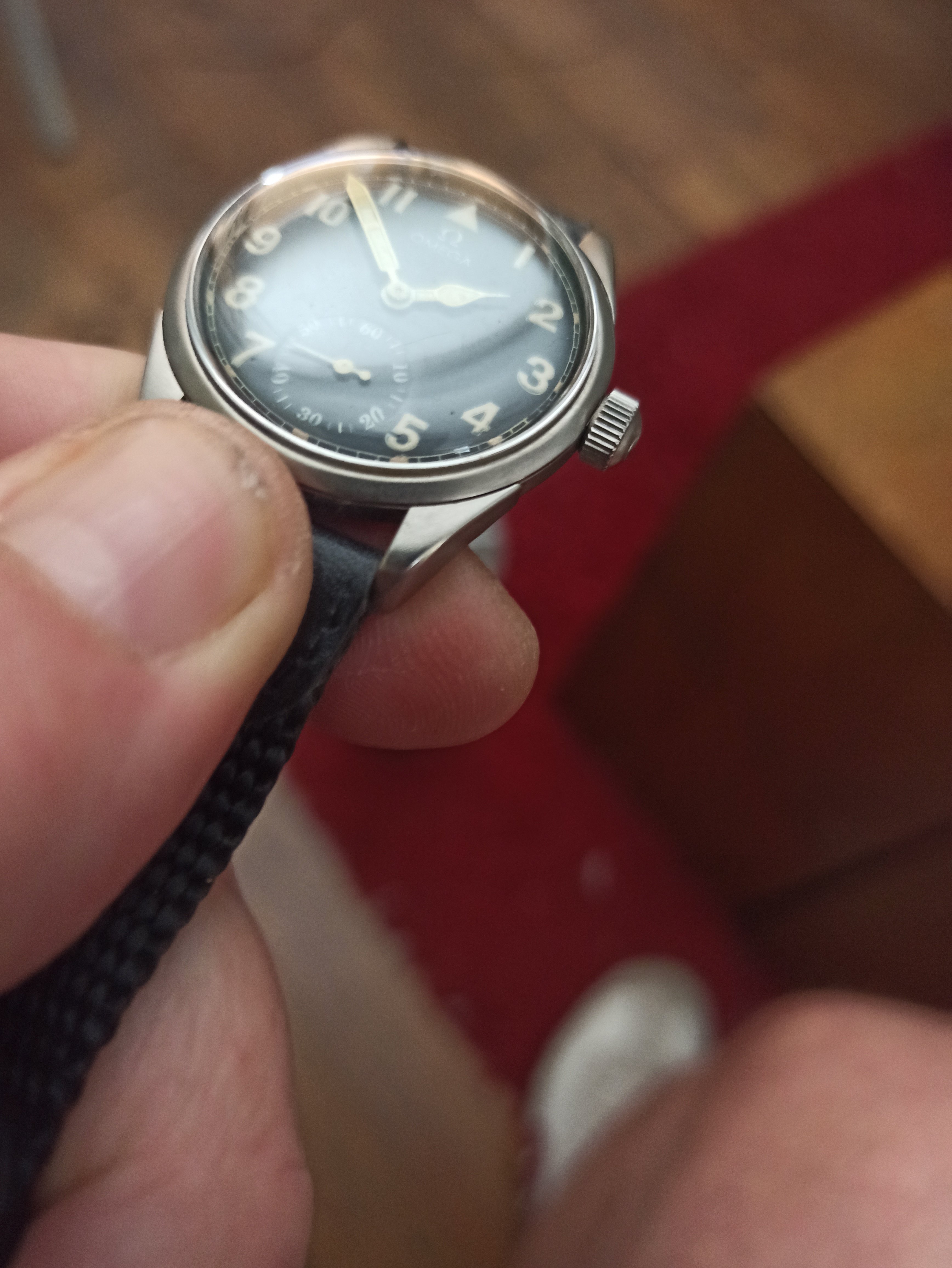

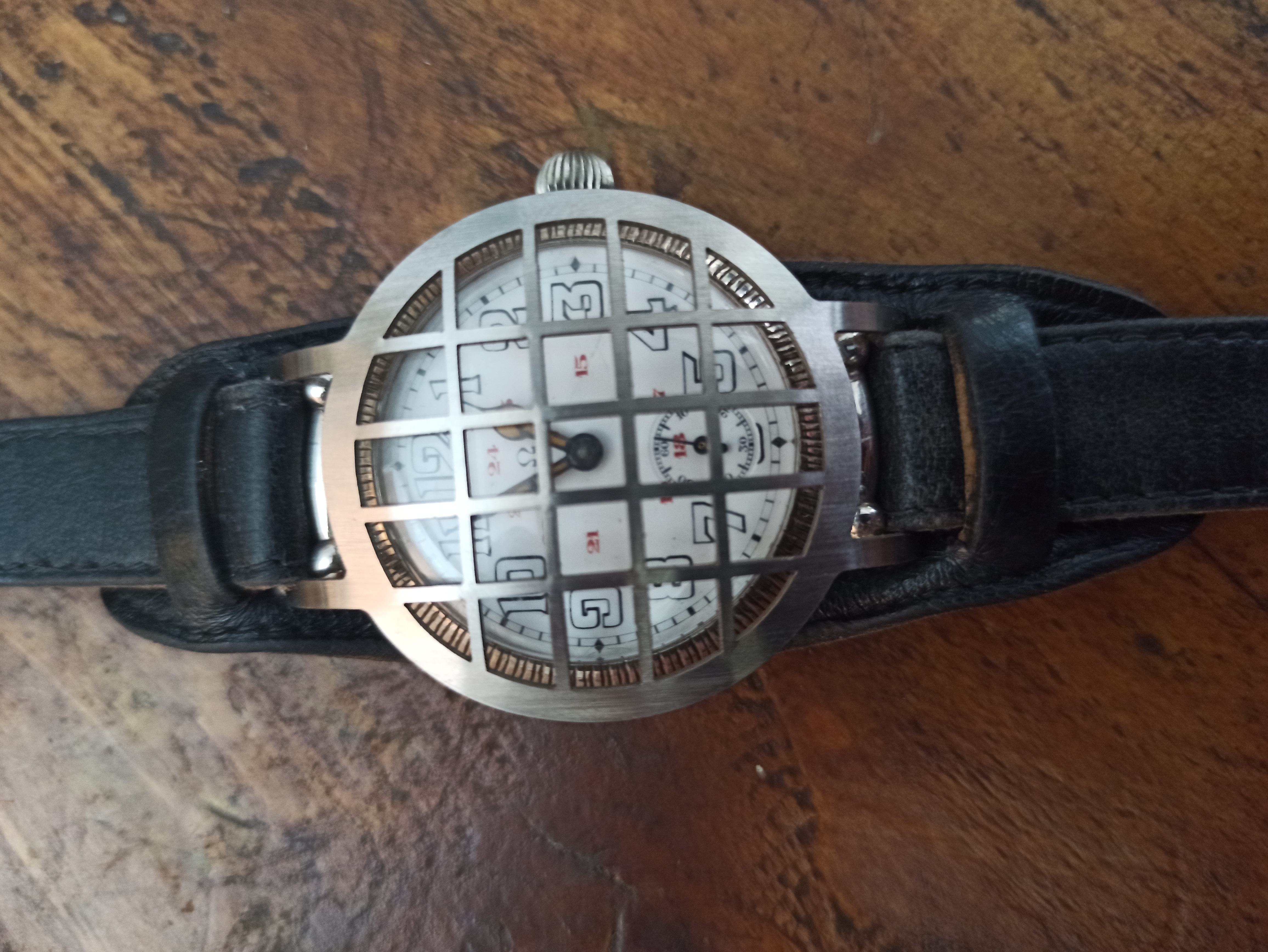

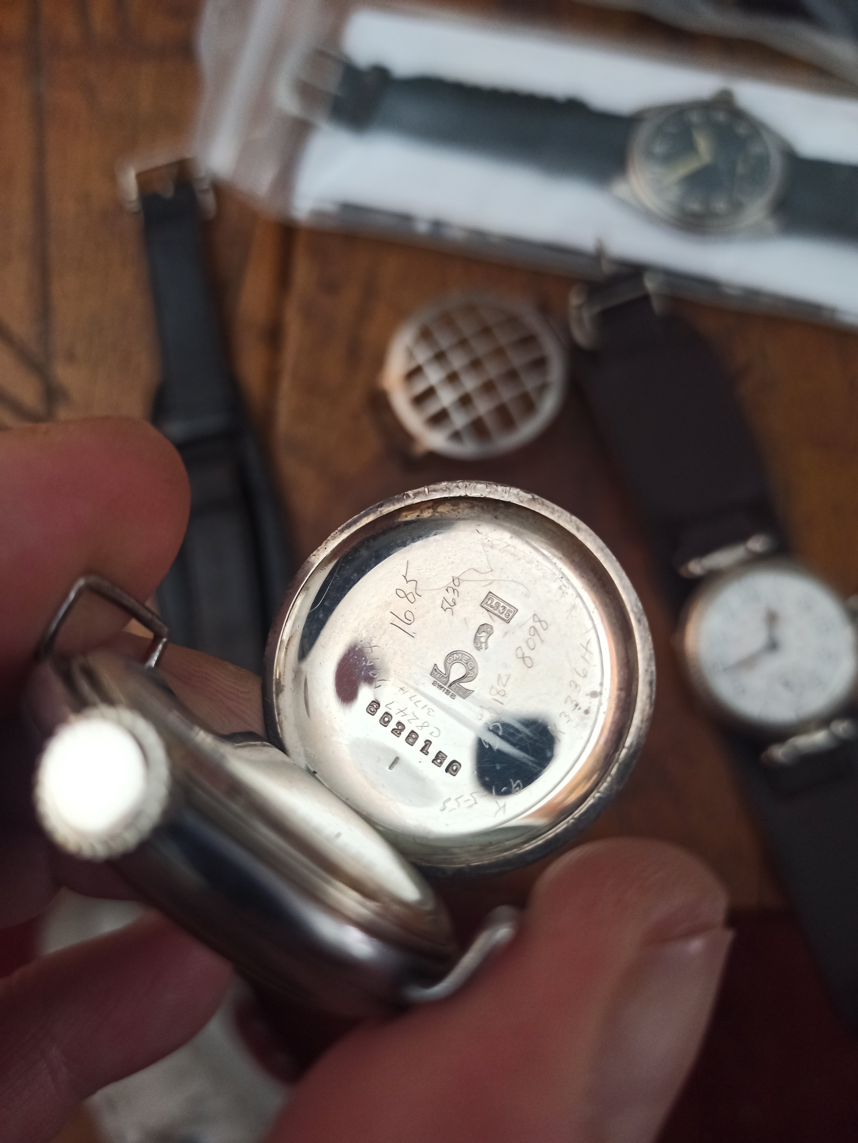

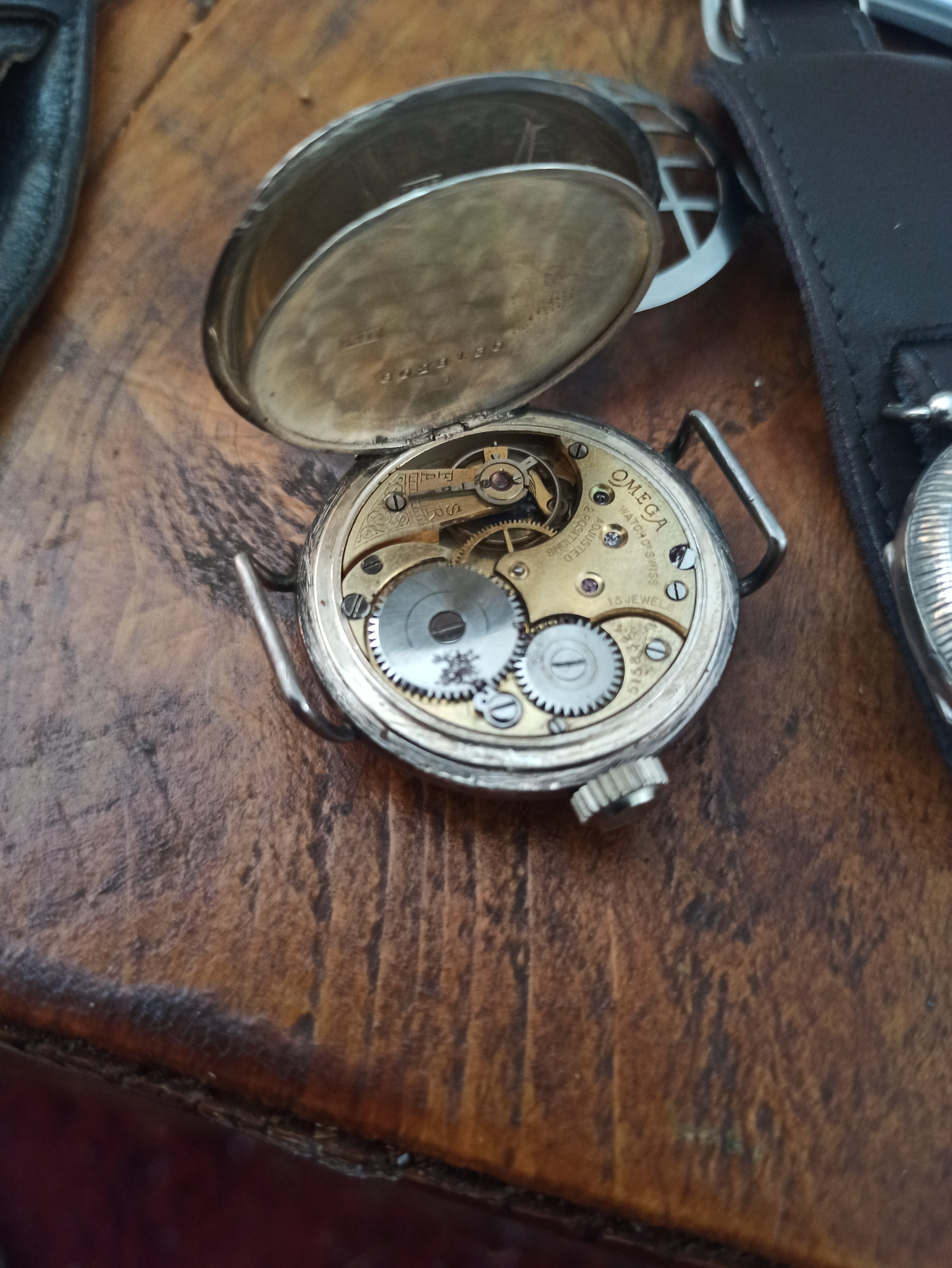

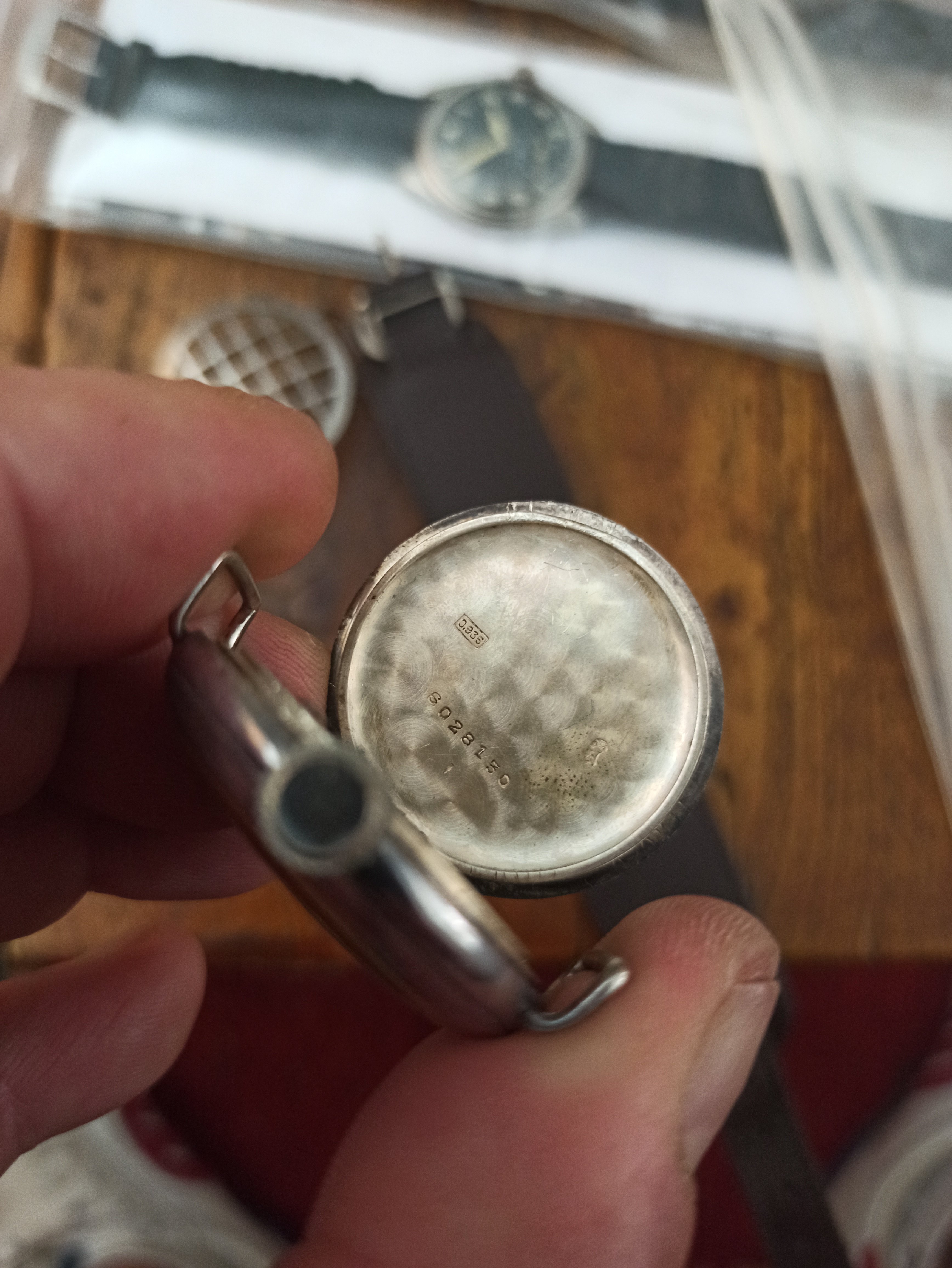

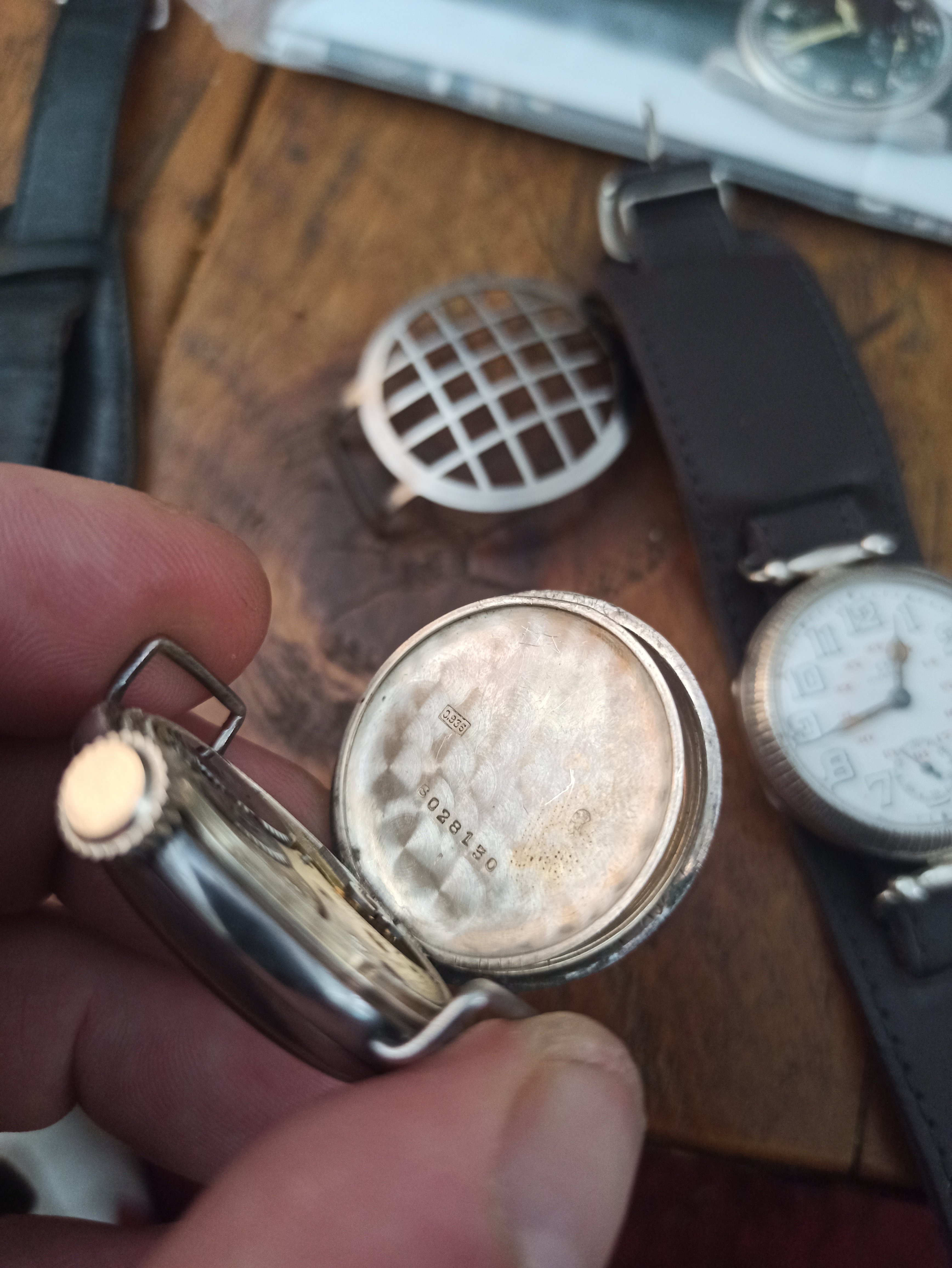

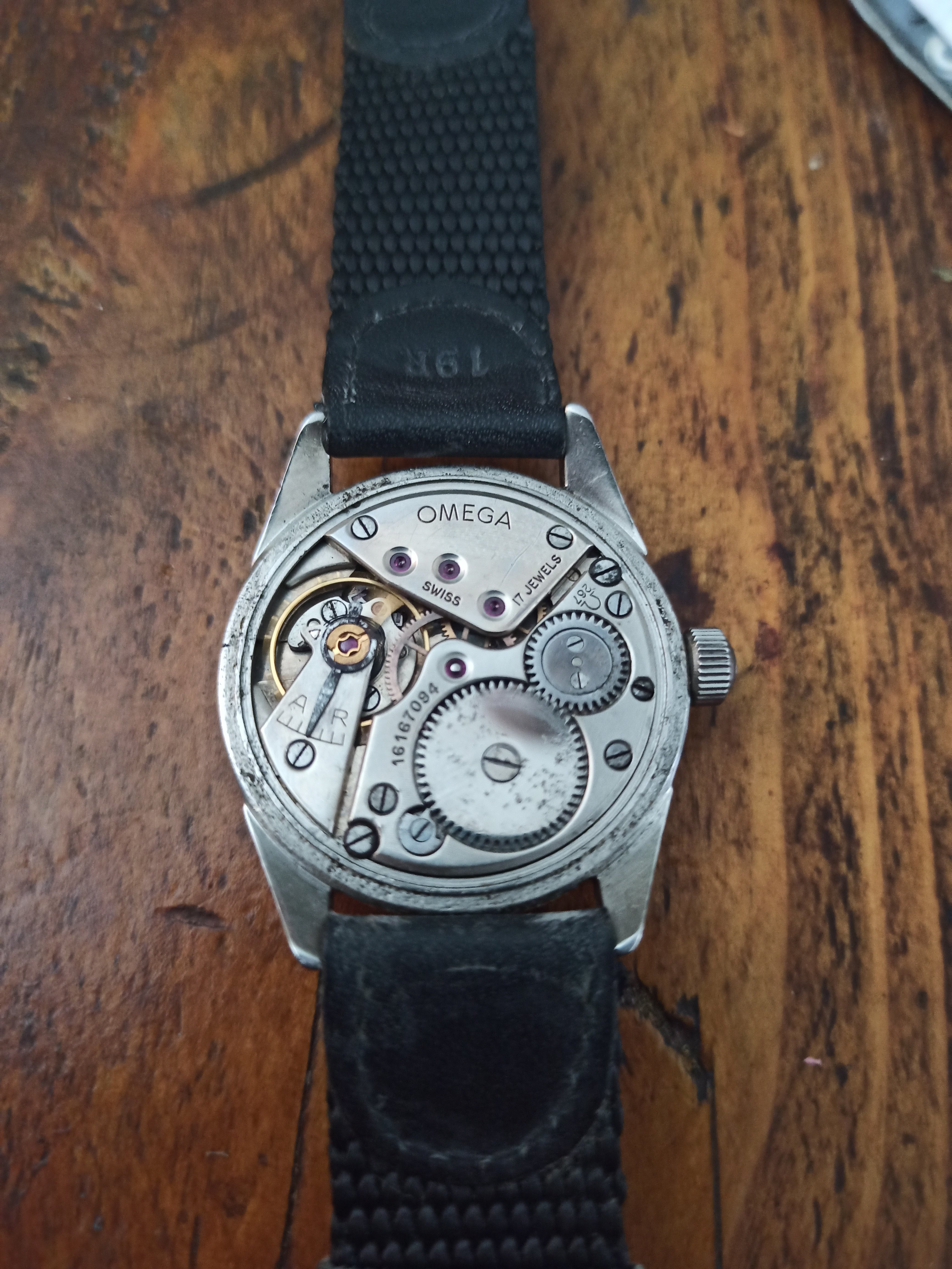

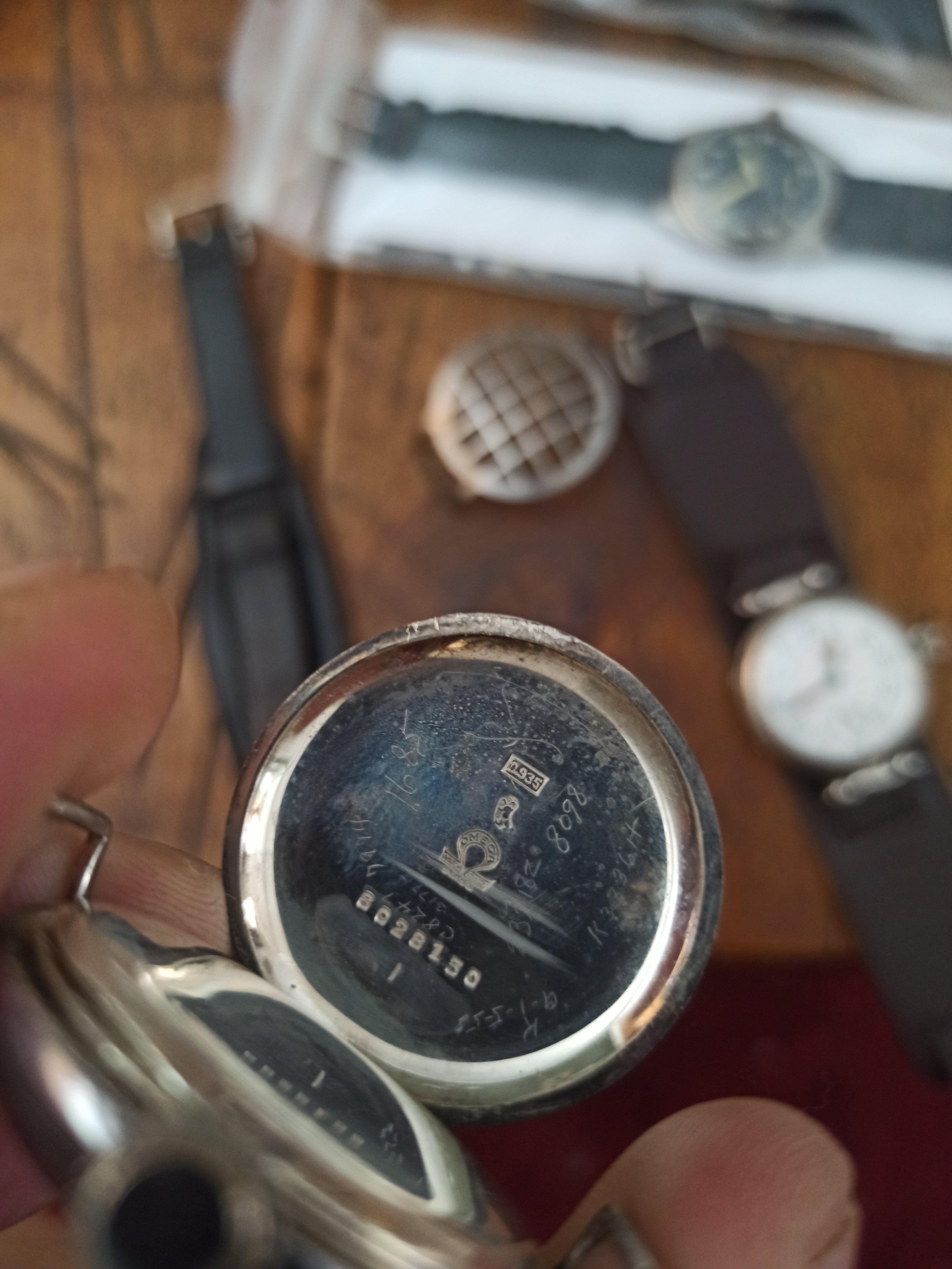

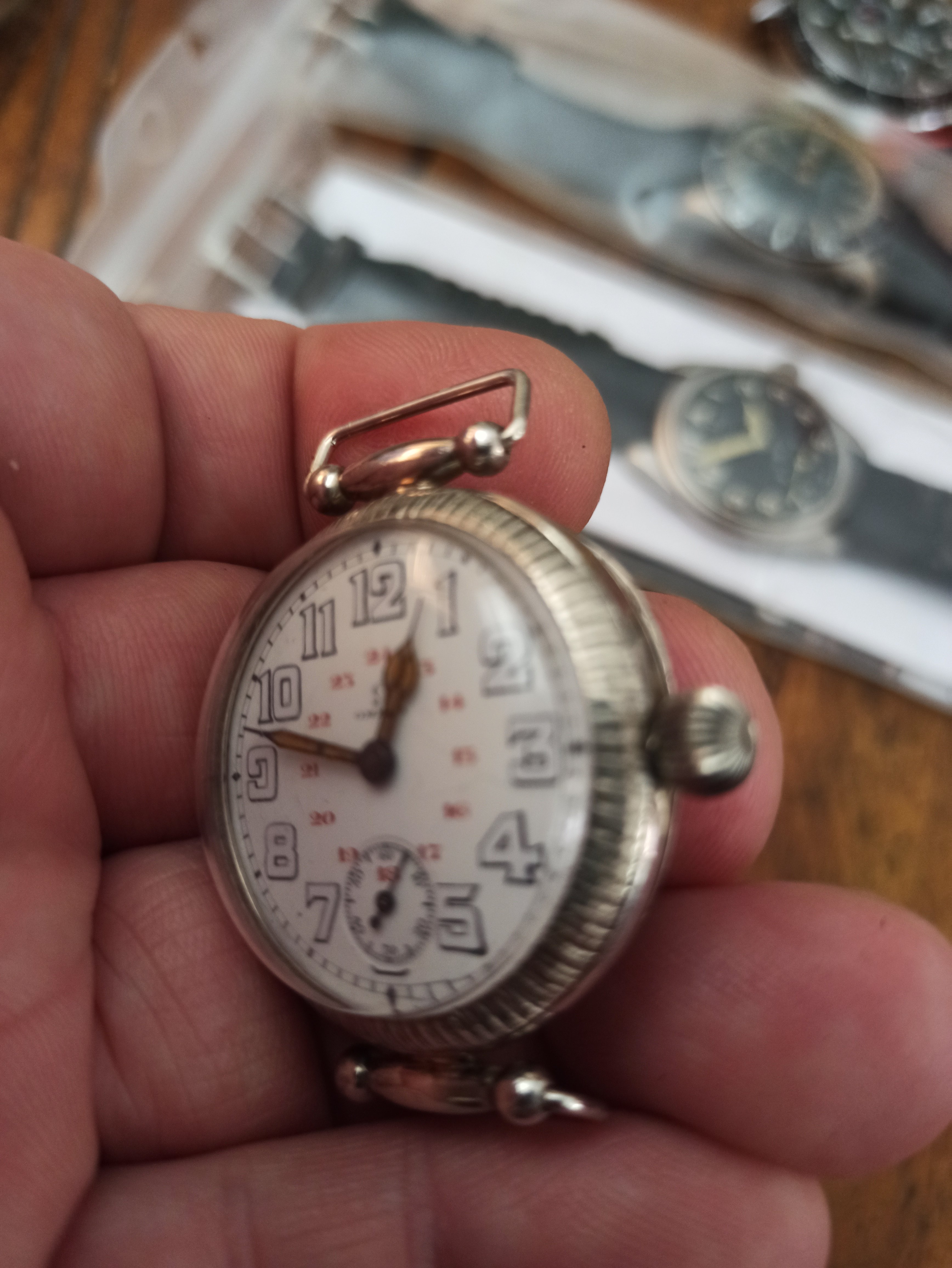

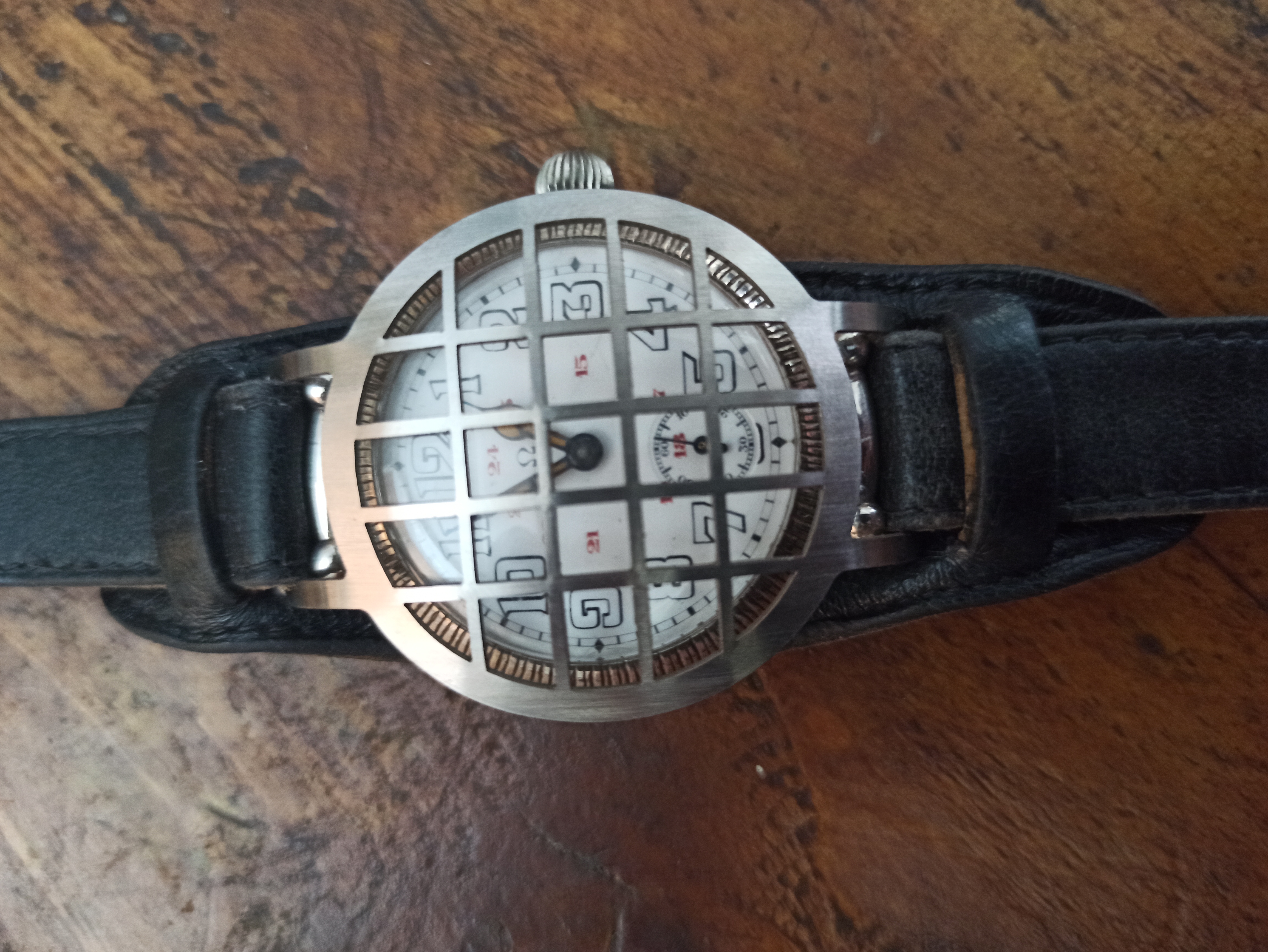

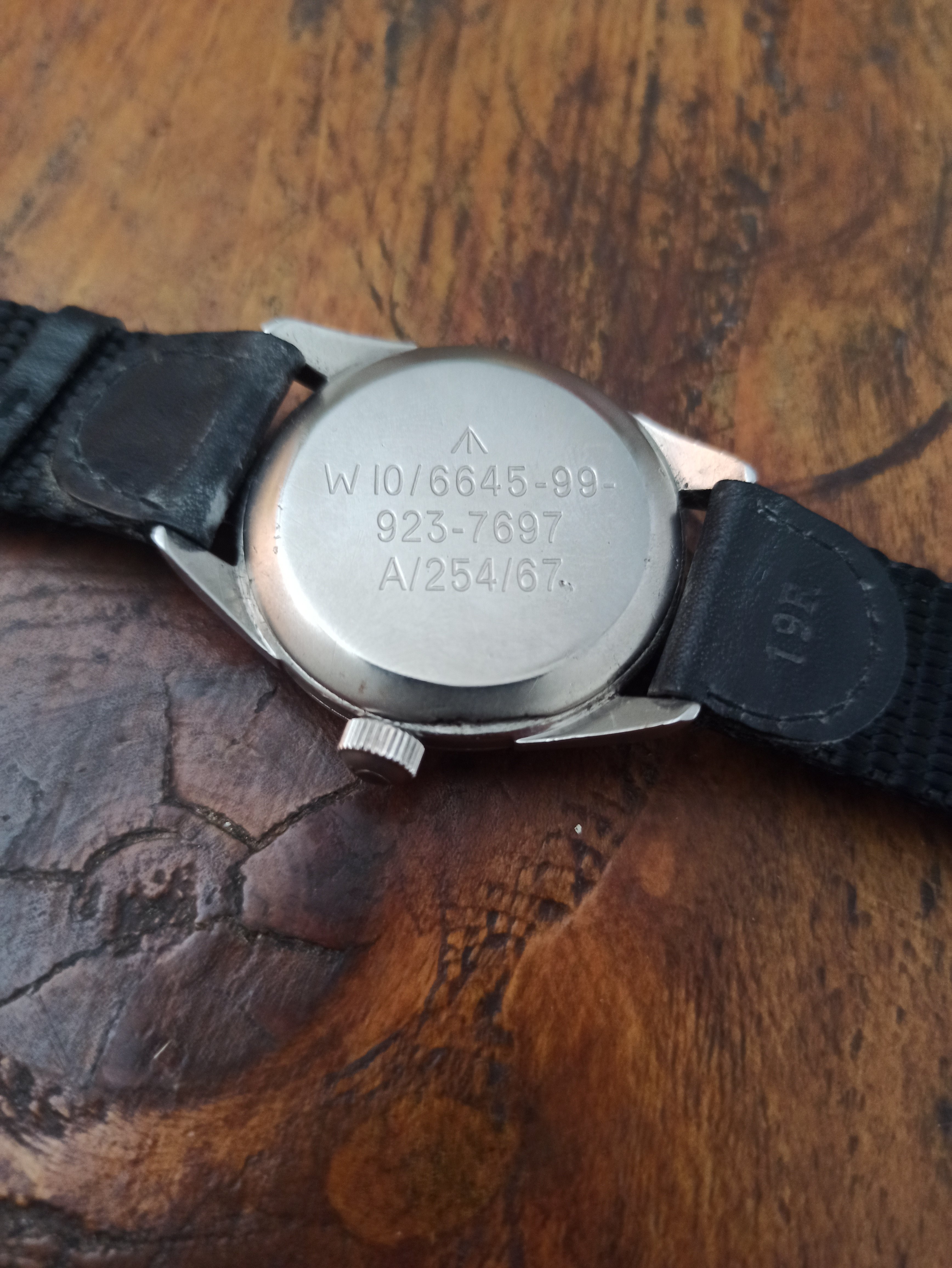

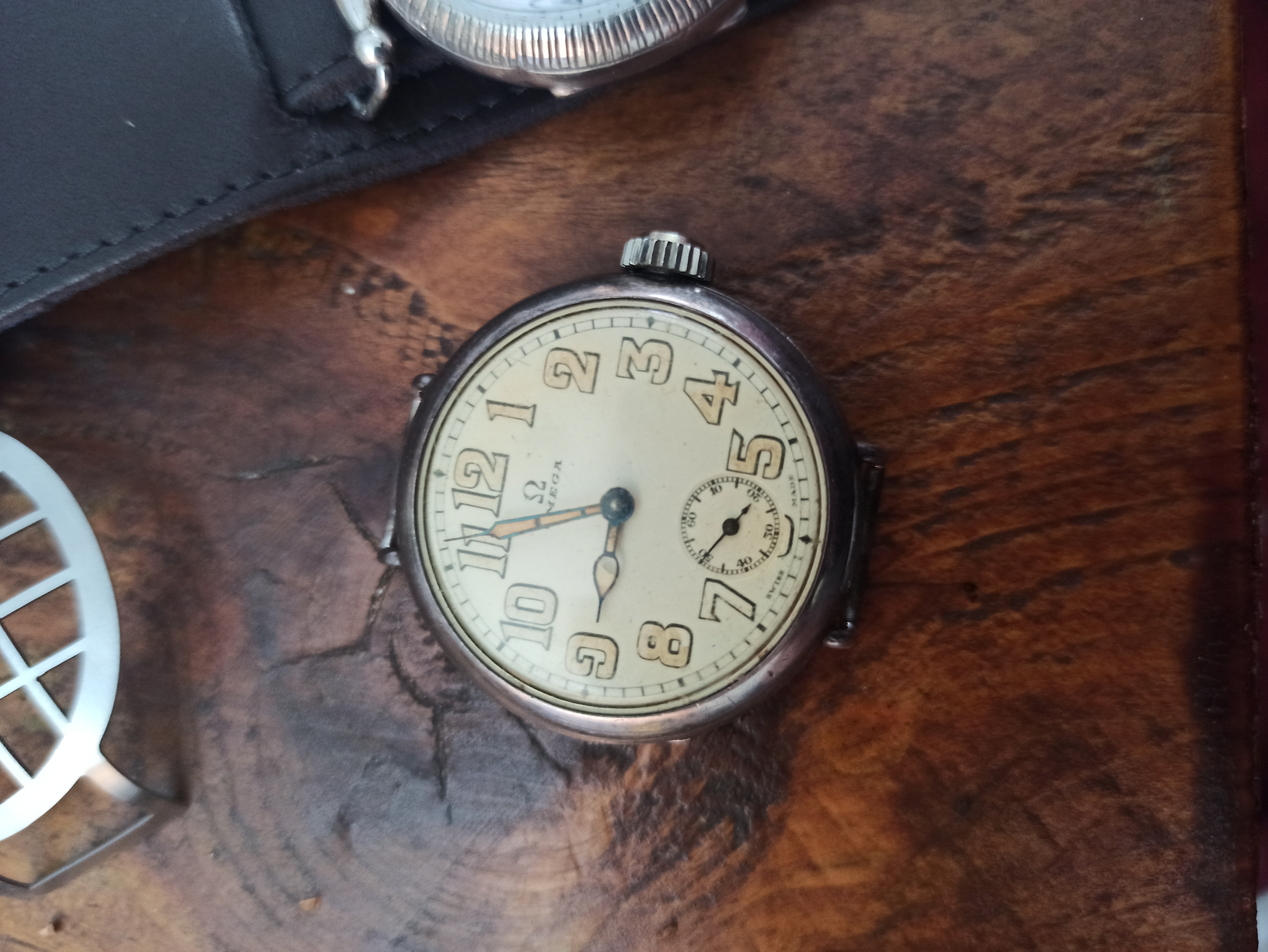

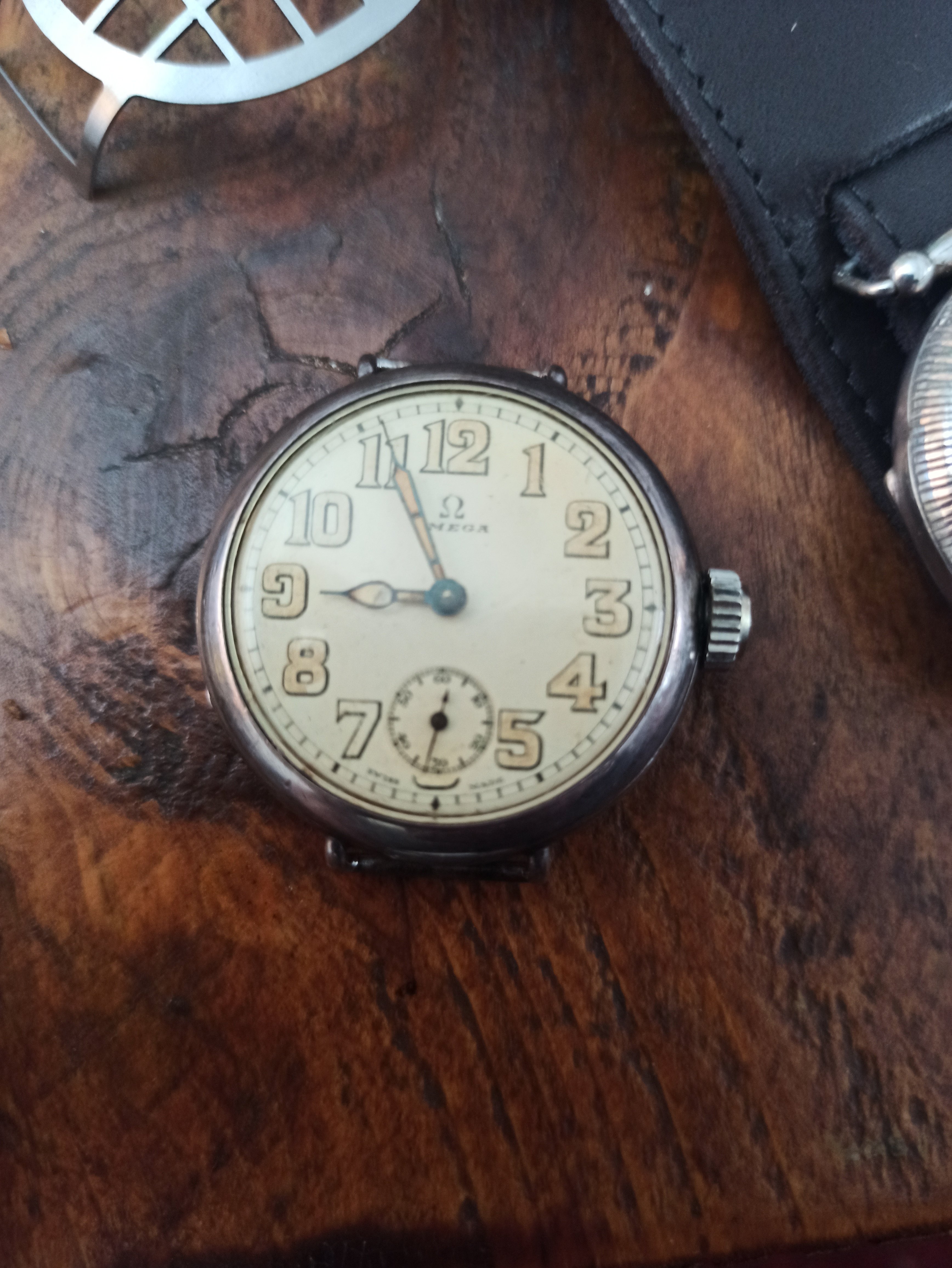

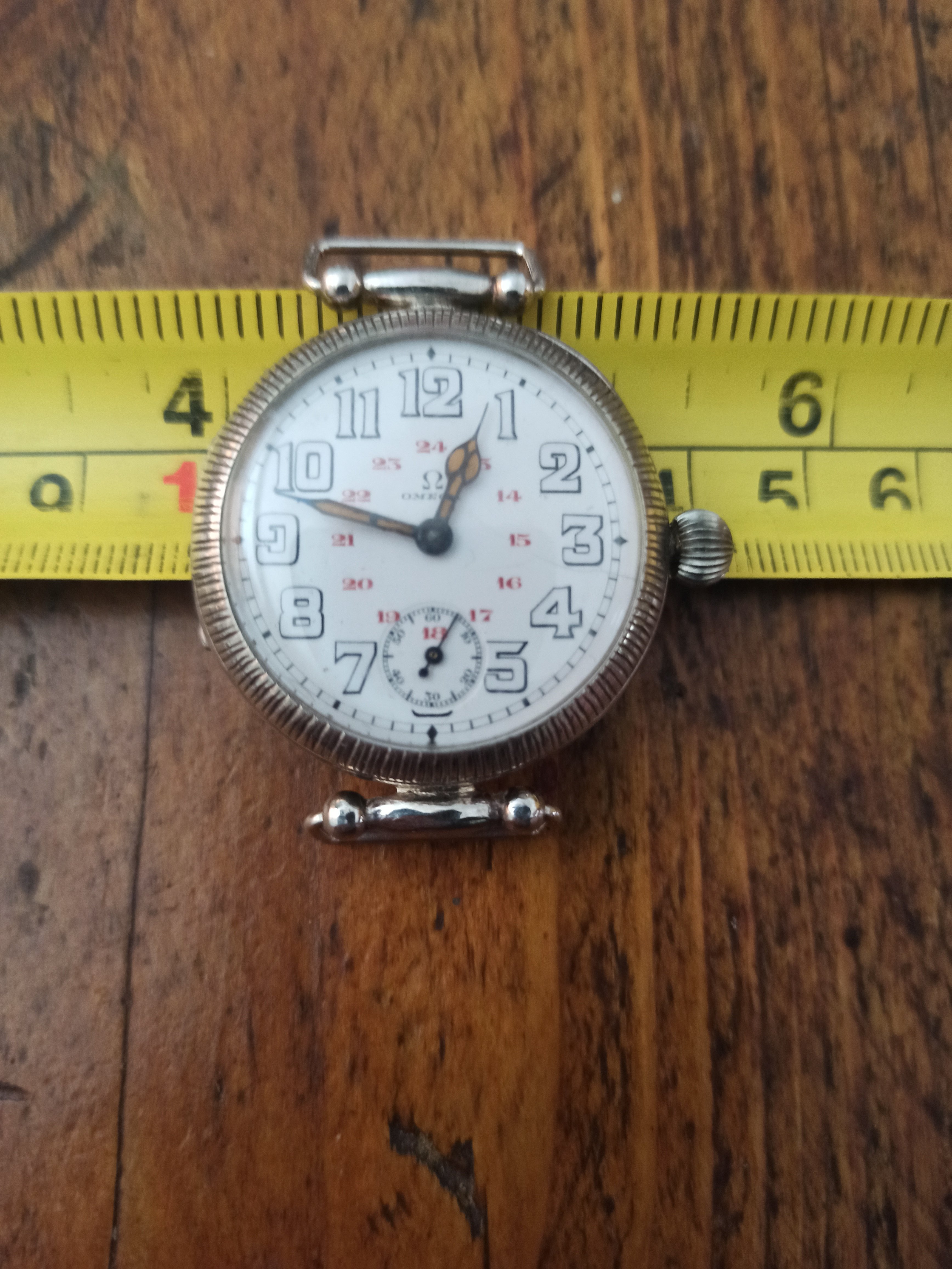

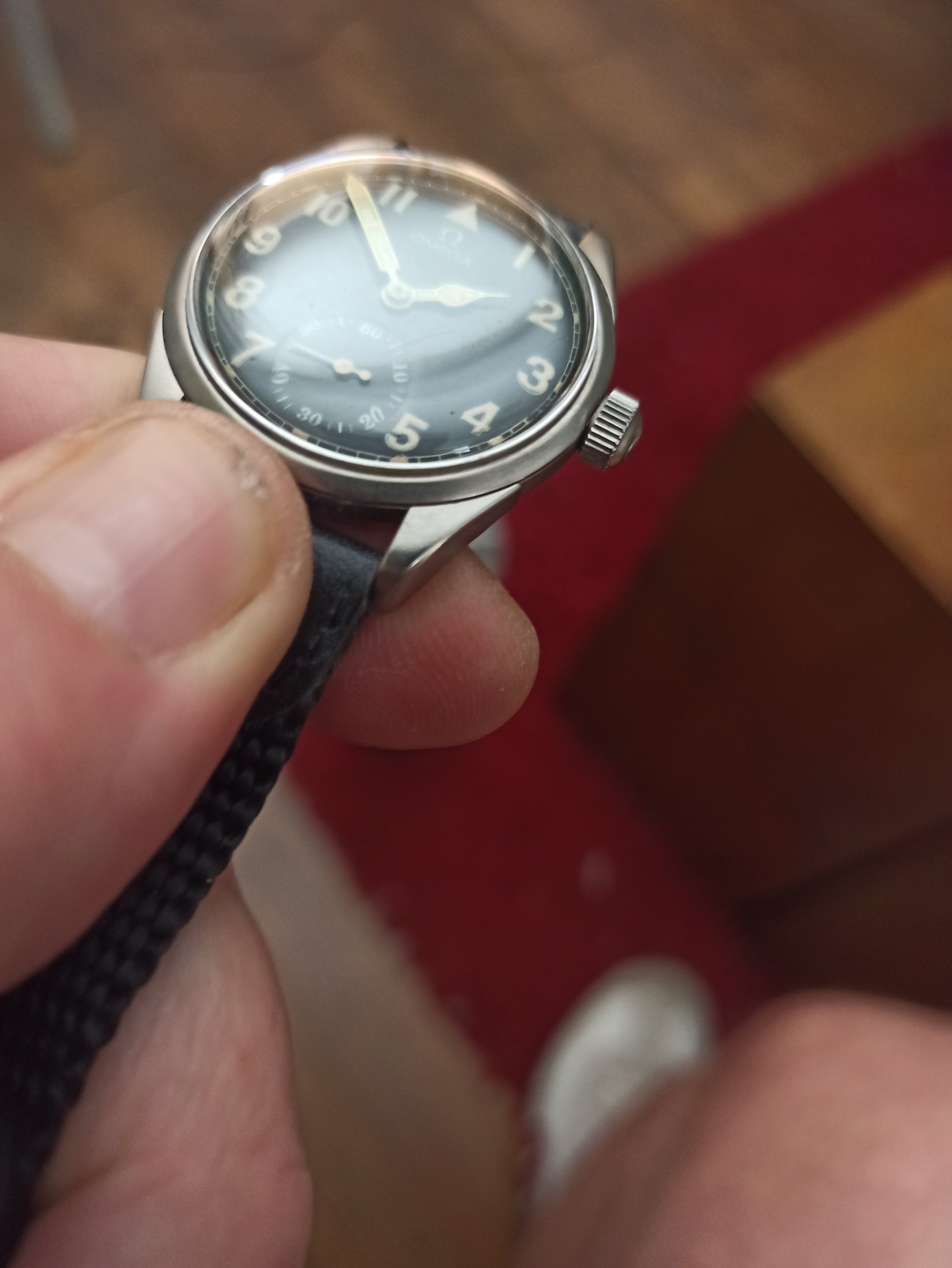

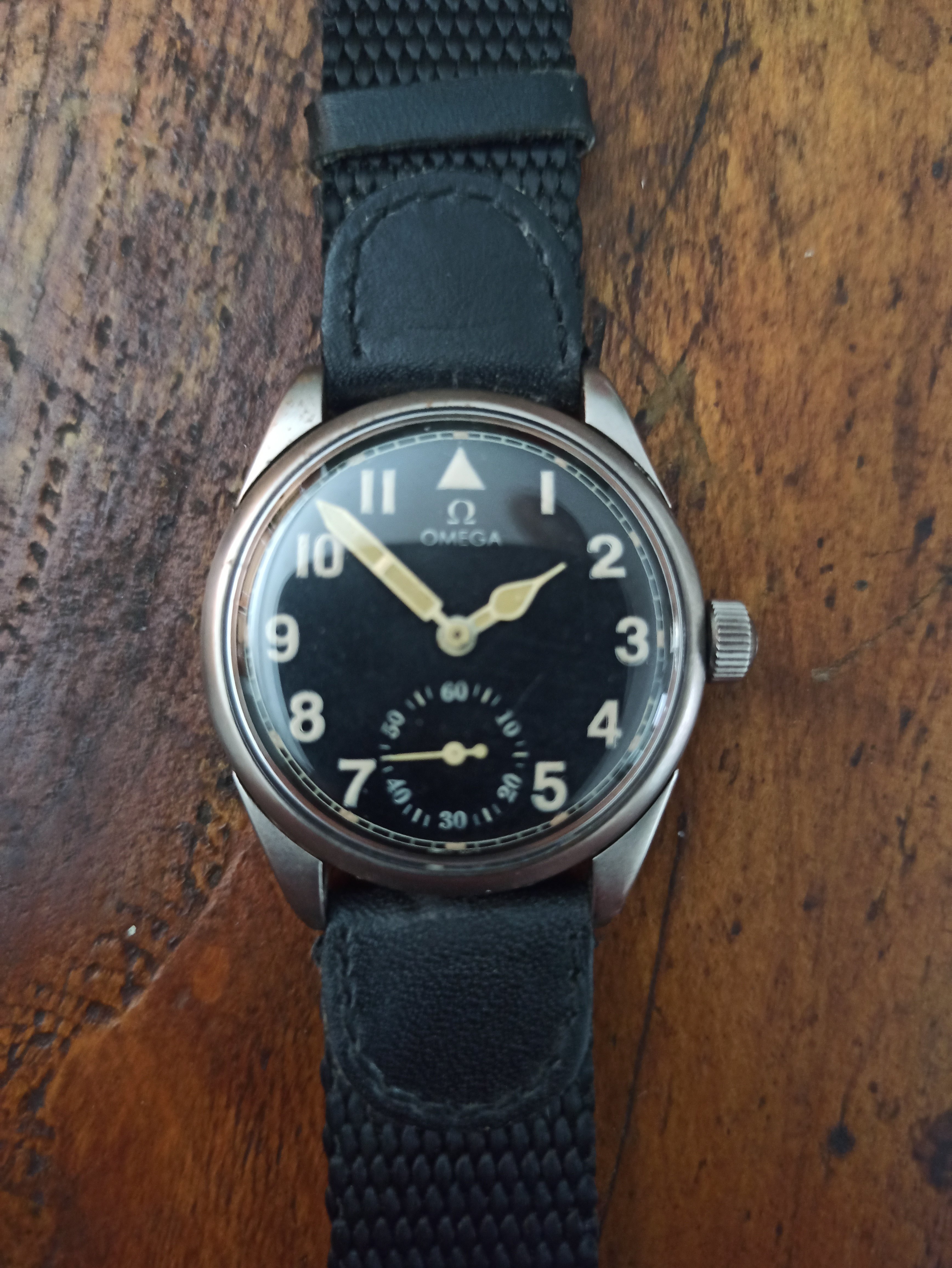

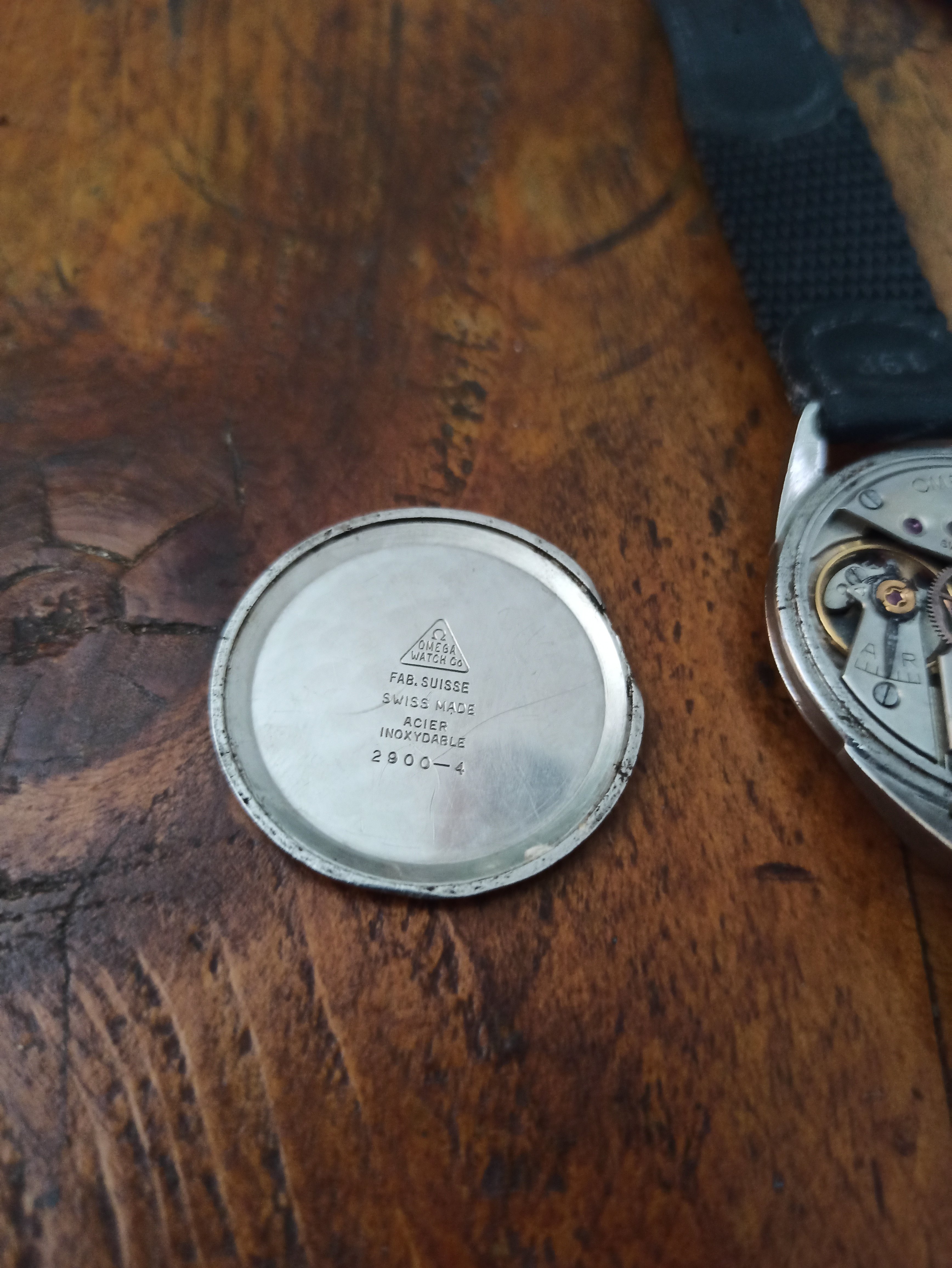

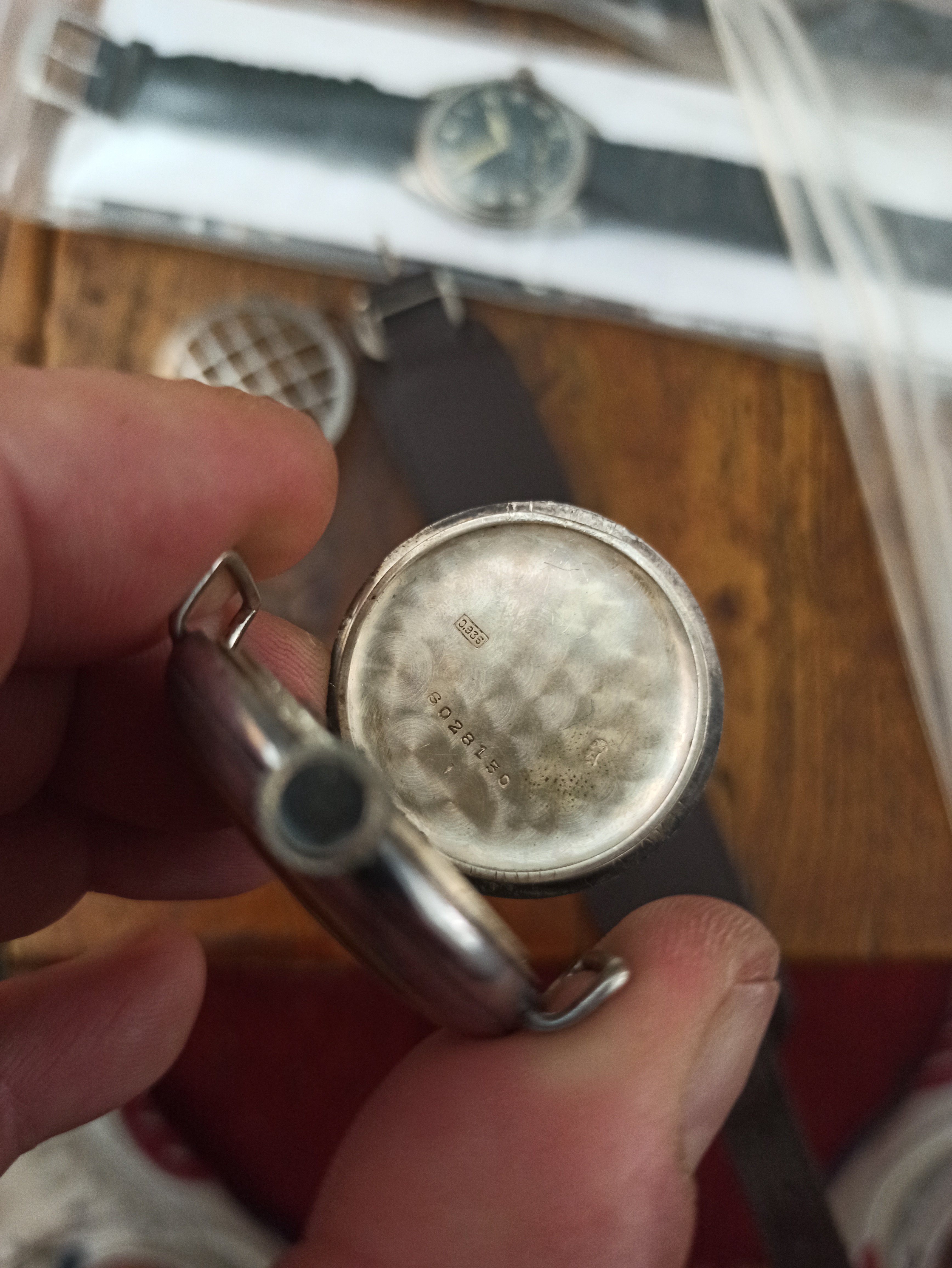

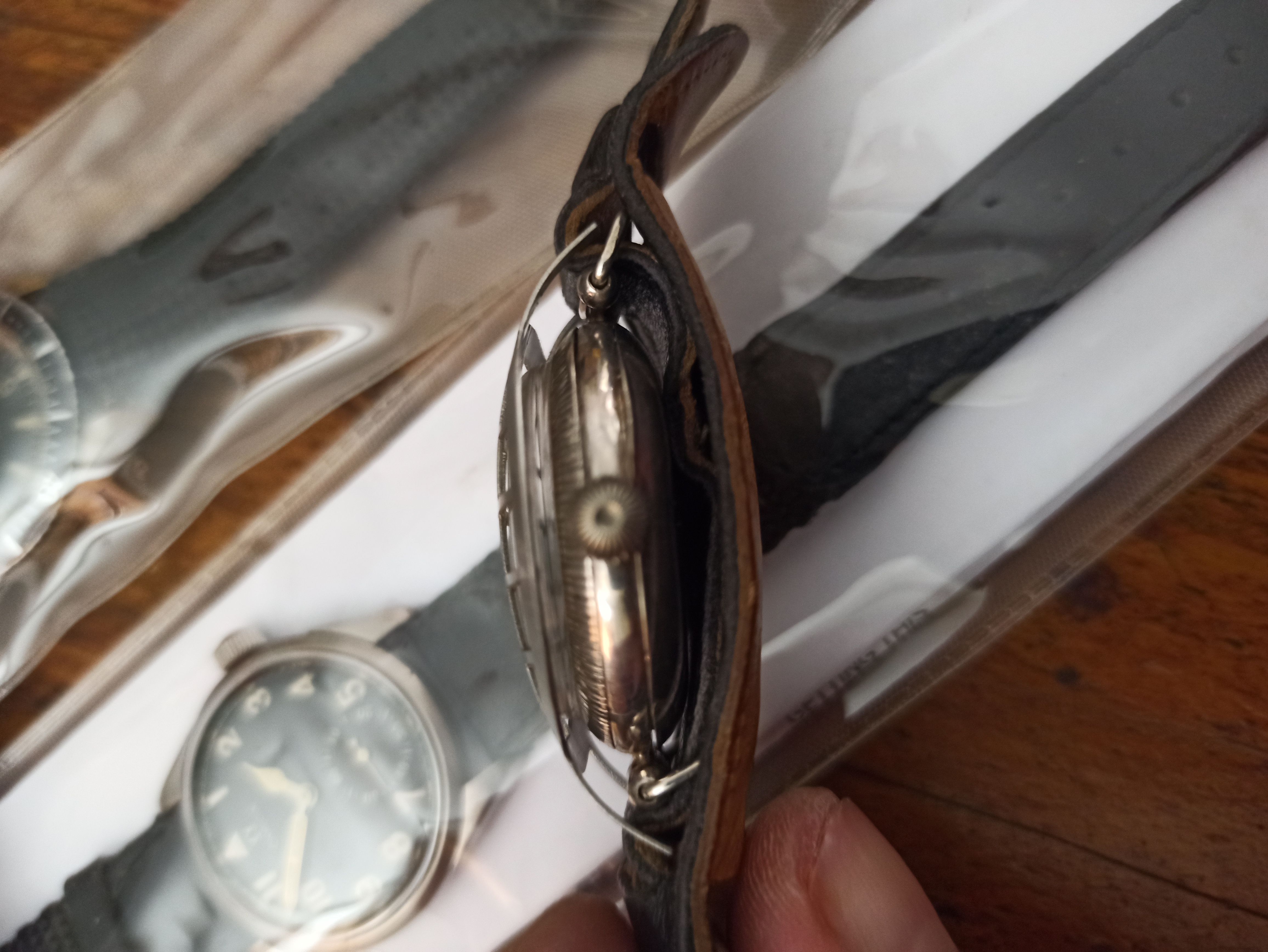

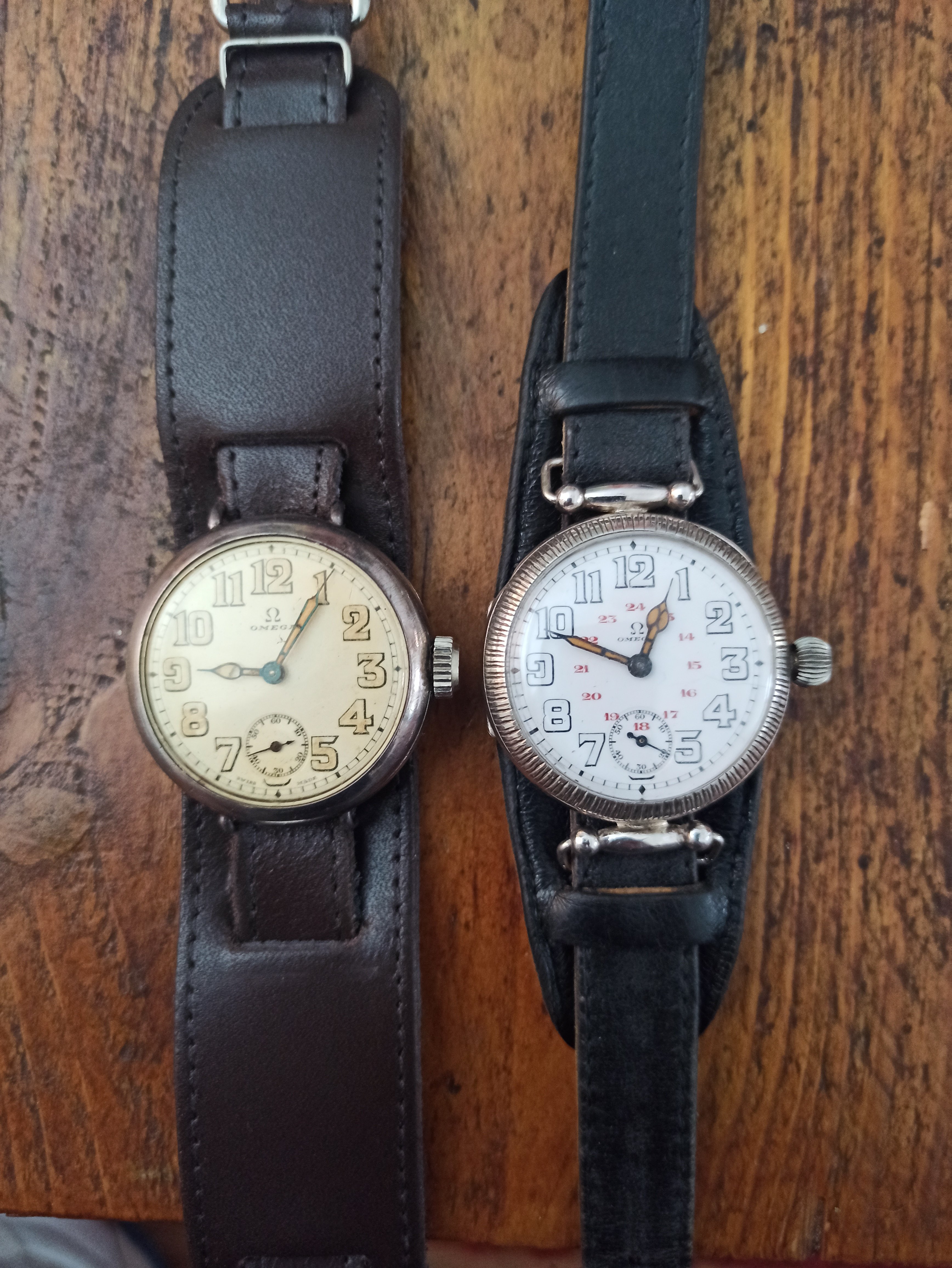

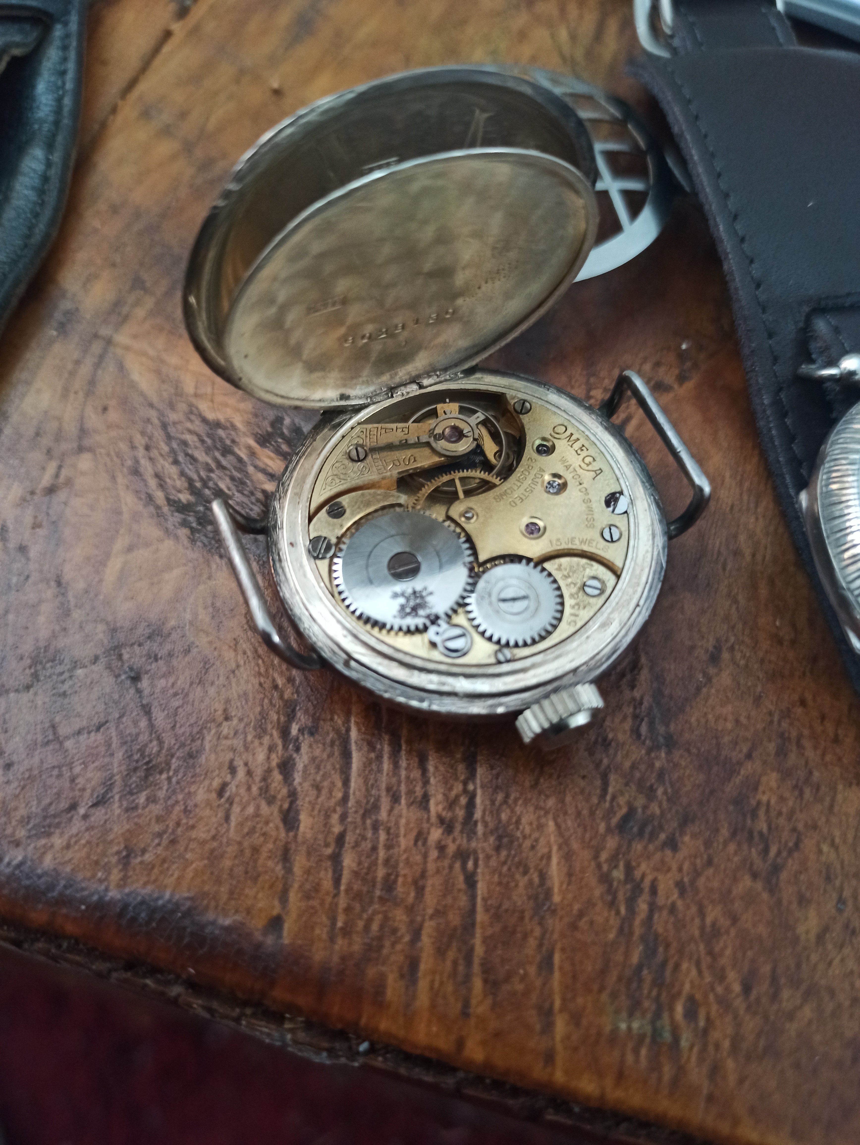

I have 2 WW1 omega trench watches and a WW2 Omega. Dirty Dozen maybe? I bought it in Hong Kong about 5 years ago and the last 2 pics have all the info that came with the watch, but I've seen other watches that have a case on the back with lugs? So not sure....
I was hoping for some advice and information I can include in an ad as I intend to sell them.
Any suggestions/advice/offers welcome!
Thanks in advance.

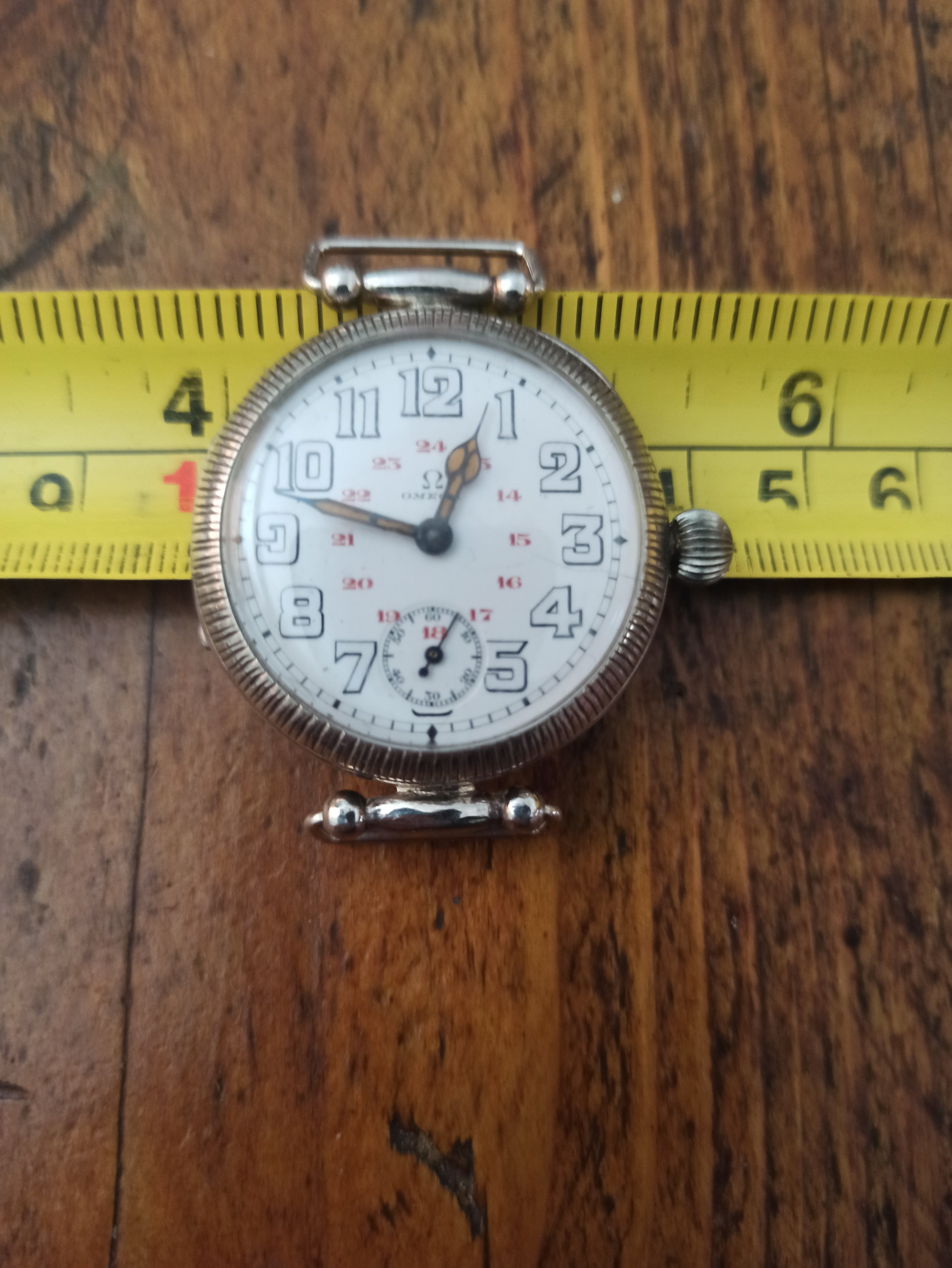

Definiitely keep the trench in the Omega case. The other, meh, but no reason to dump it if you like it. I am not qualified to comment on the WWII piece, but iti looks like its hands were replaced. The dial looks refinished to me, too. Not surprising in the Asian market.

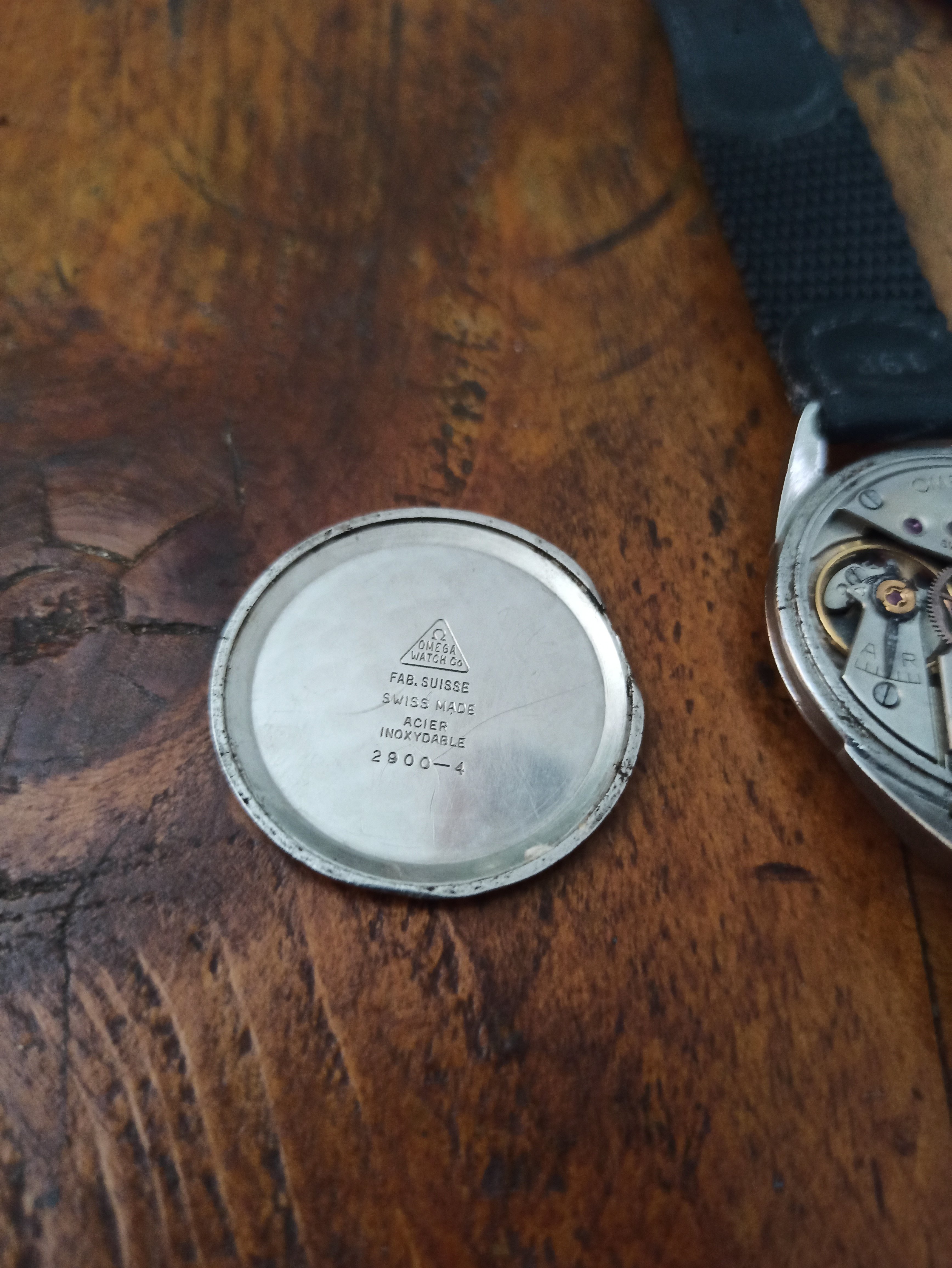

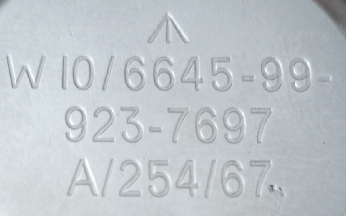

"WW2" Omega = Fake Omega. Pay attention to the laser engraved back . A bit early for Laser of any form..

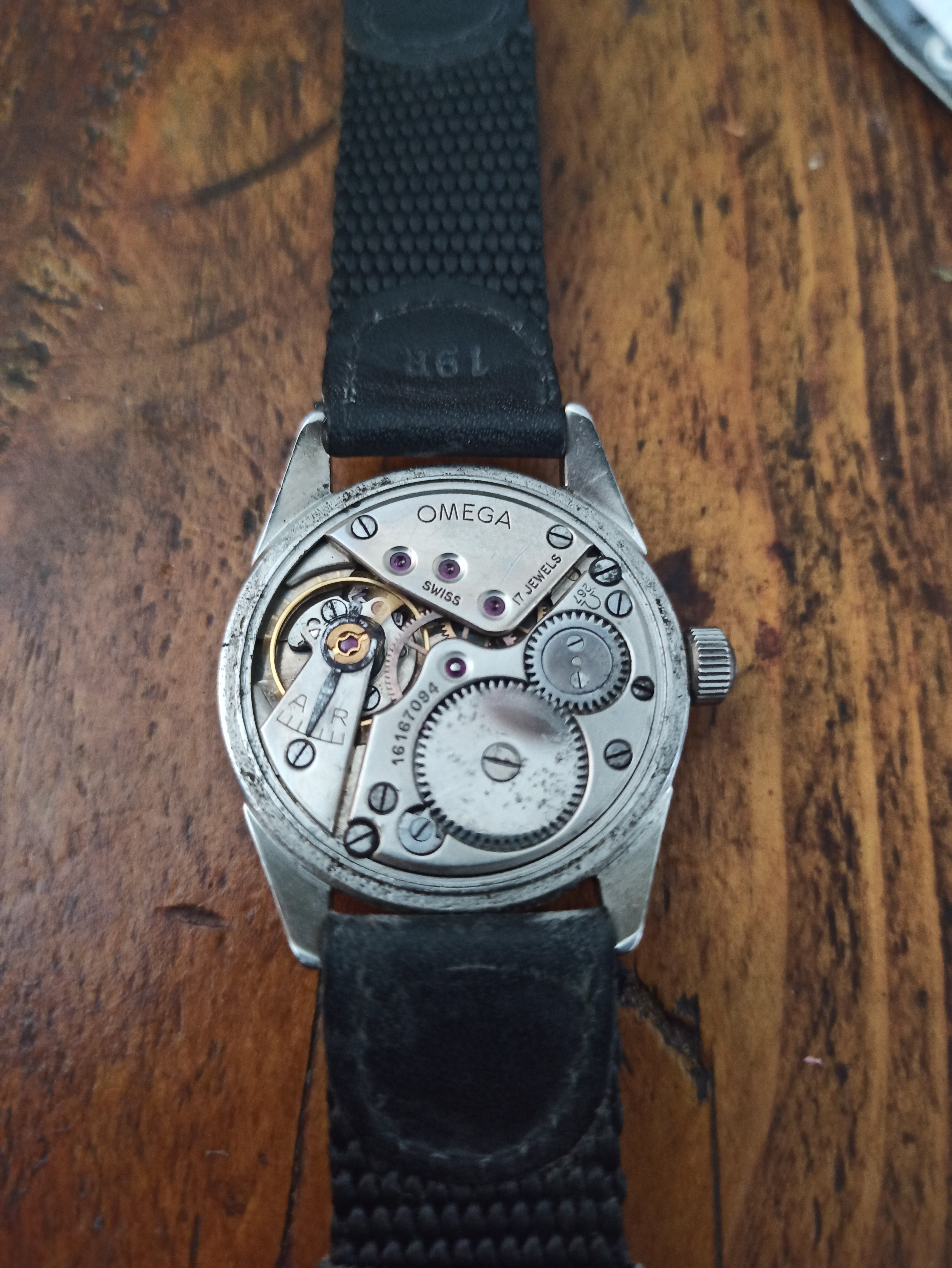

But it is an Omega movement, or?

yes, but made to look WW2 Dirty Dozen

I see nothing suggesting any of those are genuine military issue.
5,631
5,815
Many people do not realize that, at least in the US, very few watches were actually issued. I am aware of two use cases: highly-jeweled watches from a few manufacturers for the US Signal Corps, and seven-jewel Elgins for Artillery. The rest were personal purchase either at home or overseas.

It looks stamped to me. You can see where the case has been deformed around the edges of the letters/numbers.
Not that it adds any "WWW" authenticity whatsoever.

The ww2 era? Watch has a stamped back, but no lugs. Definitely not etched

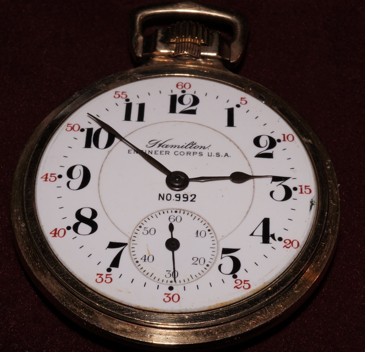

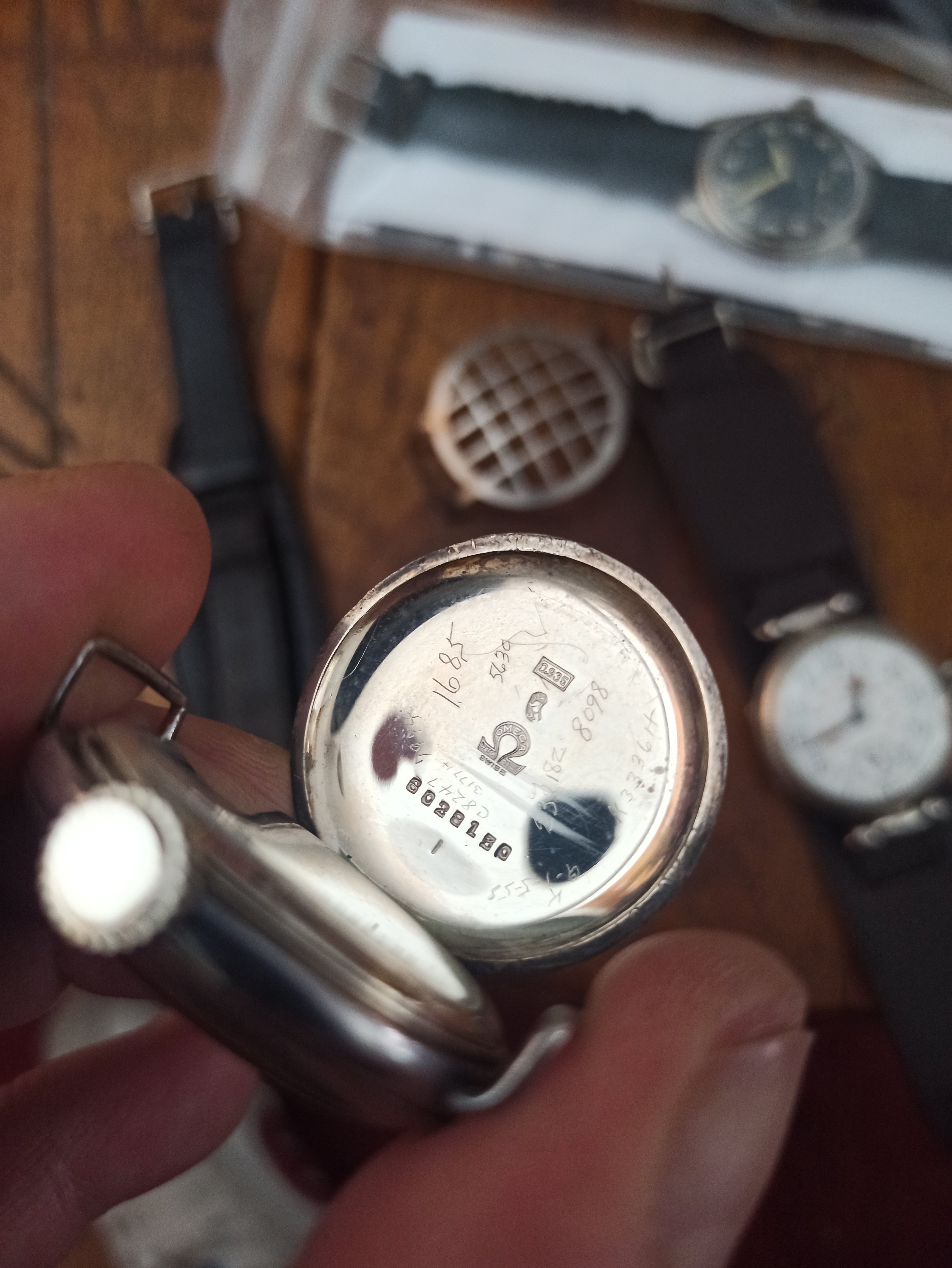

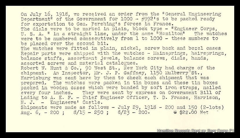

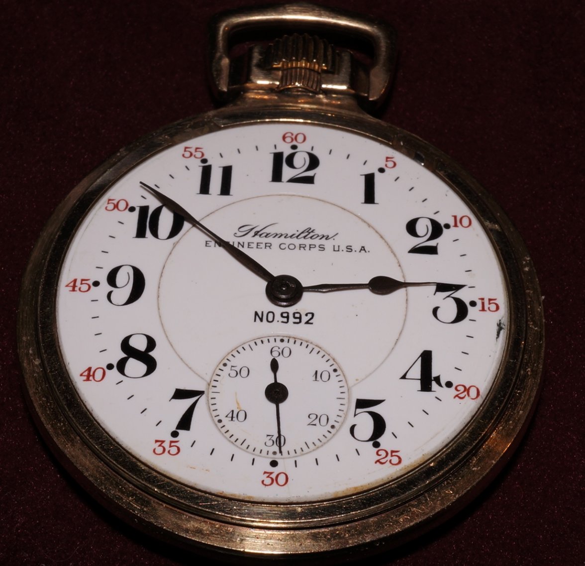

Only 40 of the pocket watches are documented.
Mine is 992

Mine is 992
Of course it is, that's the caliber number. 😀

Only 2 questions. How does an alleged WWII watch have a 16M serial number? Wouldn’t that be mid 1950’s? Never mind no one has to answer.

Only 2 questions. How does a supposed WWII watch have a 16M serial number? Wouldn’t that be mid 1950’s?
That is the alleged WWII watch.
Yes, grade 992 AND #992 of the run......which is kinda cool to have
The specification states above......001 to 1000
"Grade" in US and caliber in Europe/Canada & others and stamped on the movement.
I... wow. What're the odds?
Yes, 1 in 1000, but still. 😀
