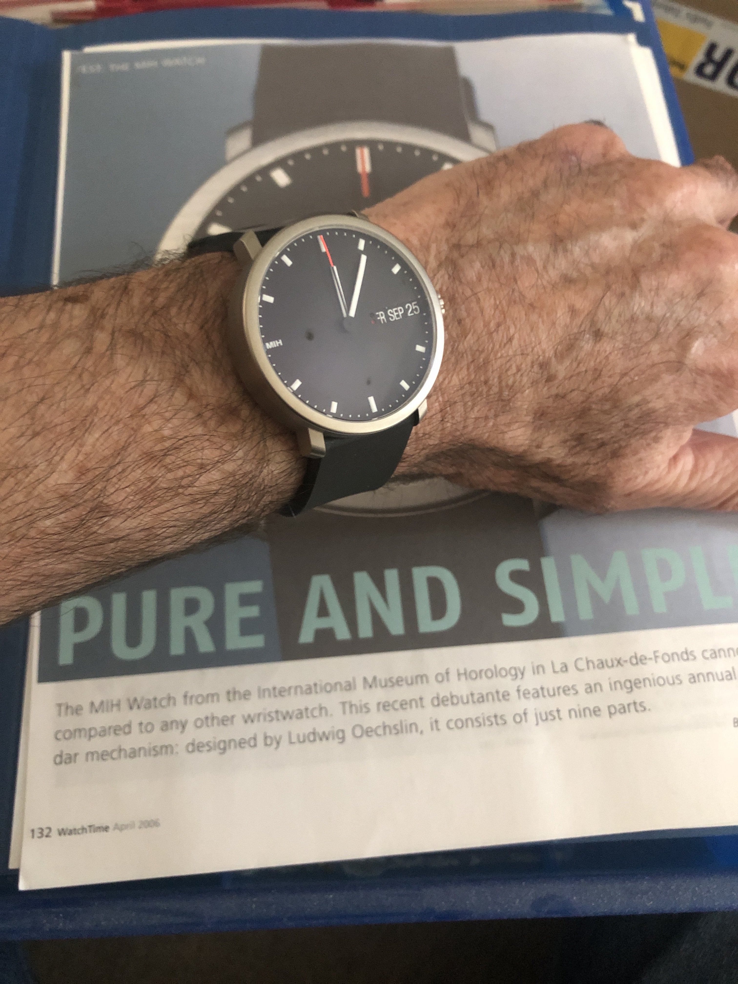

OK lousy pic but I bought this on my honeymoon in Switzerland and LOVE IT!
You can only buy new in Switzerland, you rarely see them come up on the pre owned market.
The is the brainchild of master watchmaker Ludwig Oechslin, curator of the Musée International d’Horlogerie in La Chaux-de-Fonds, Switzerland. The MIH utilizes a modified Valjoux 7750 movement featuring a mono-pusher chronograph, and, with the addition of only 9 components - an annual calendar function!
Lots of info online so I wont bore you rewriting what much more qualified people have already done.
If you are not familiar with the MIH you should look it up!!!

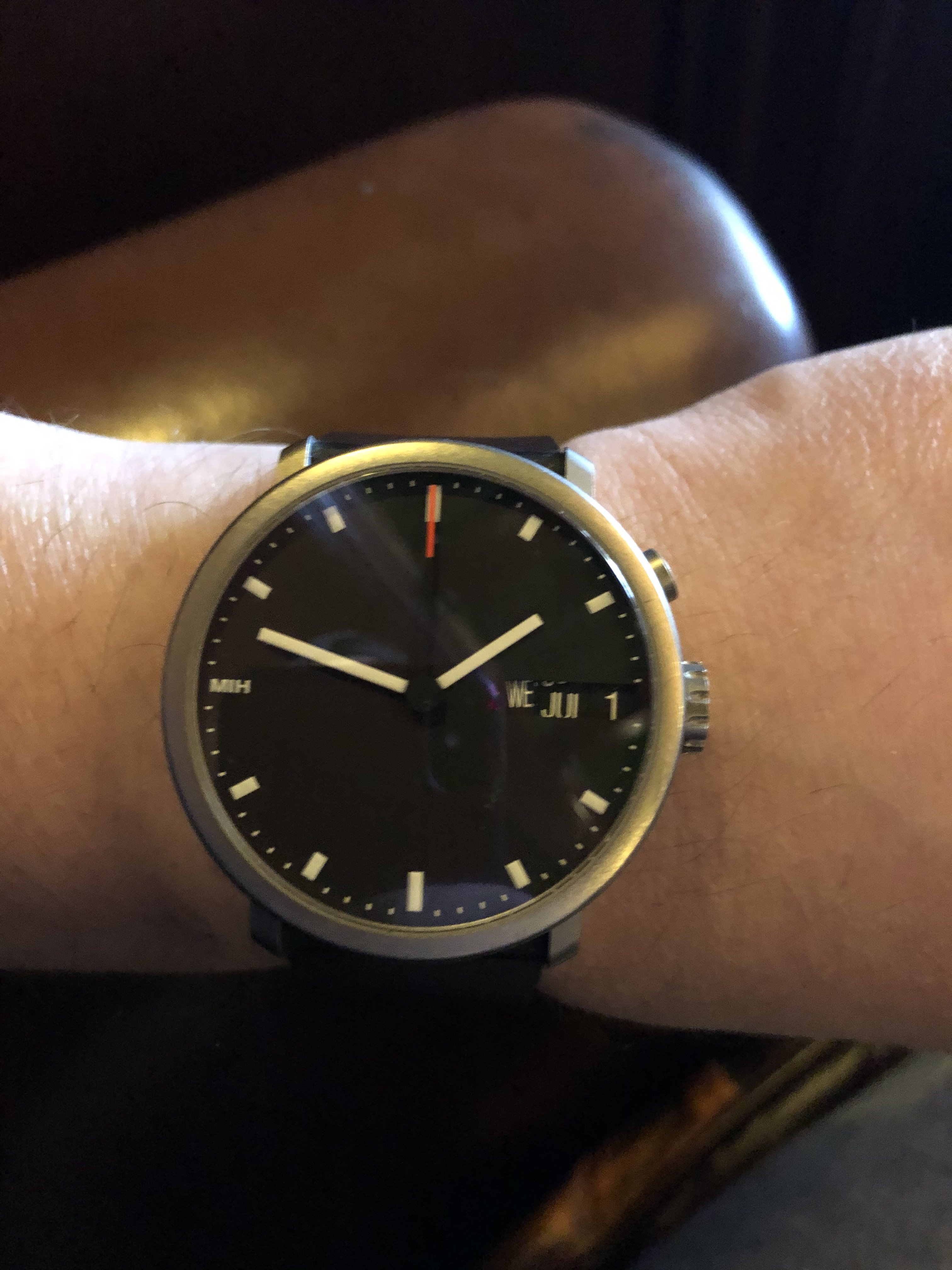

Marsimaxam: thanks for that great write up! The MIH is a wonderful functional, cleanly designed watch and a pleasure to wear.
I purchased my MIH from the Embassy boutique in Miami in 2010. Didn’t have to go to Switzerland. Not sure if they still have a US location though.
