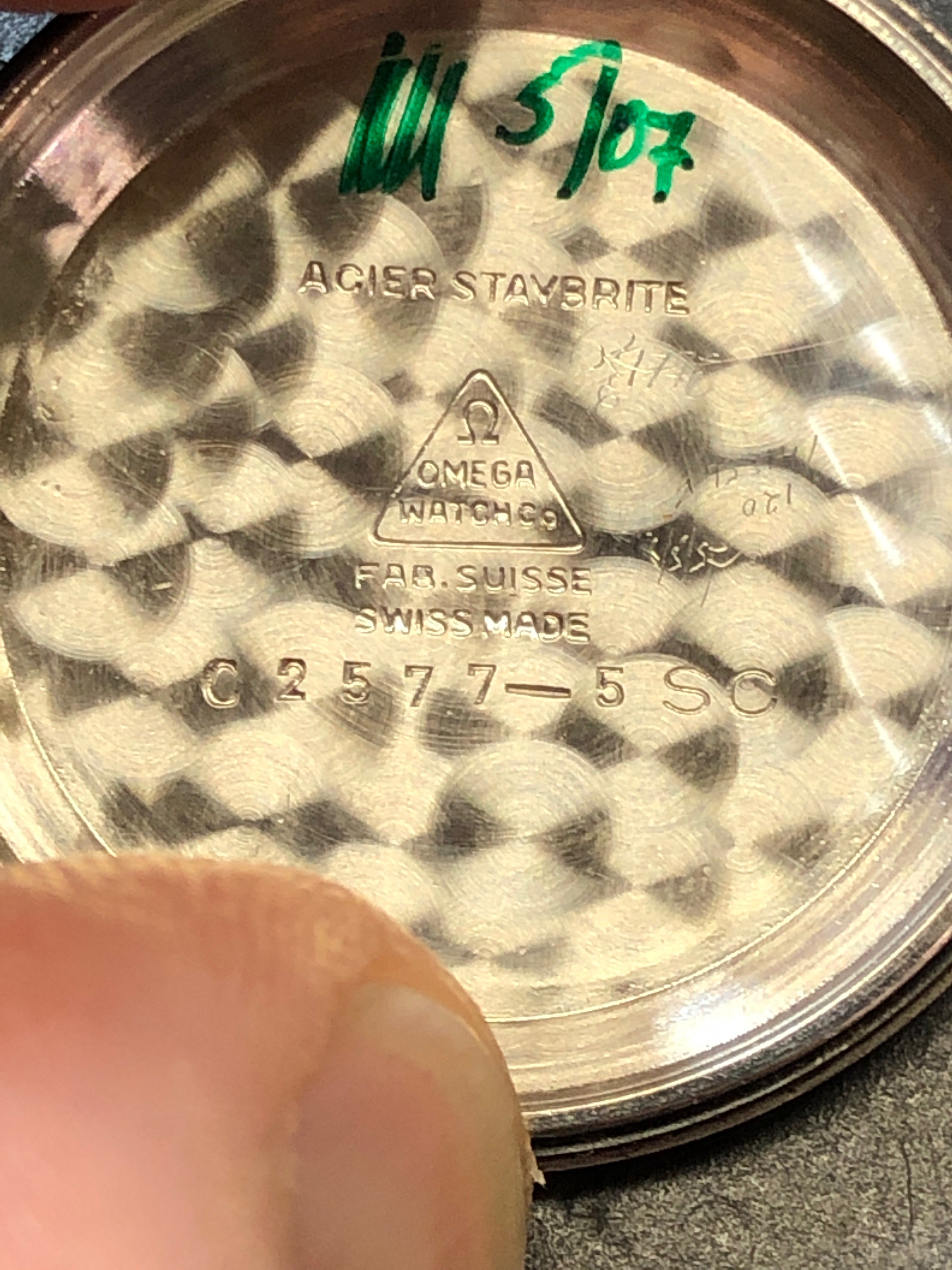

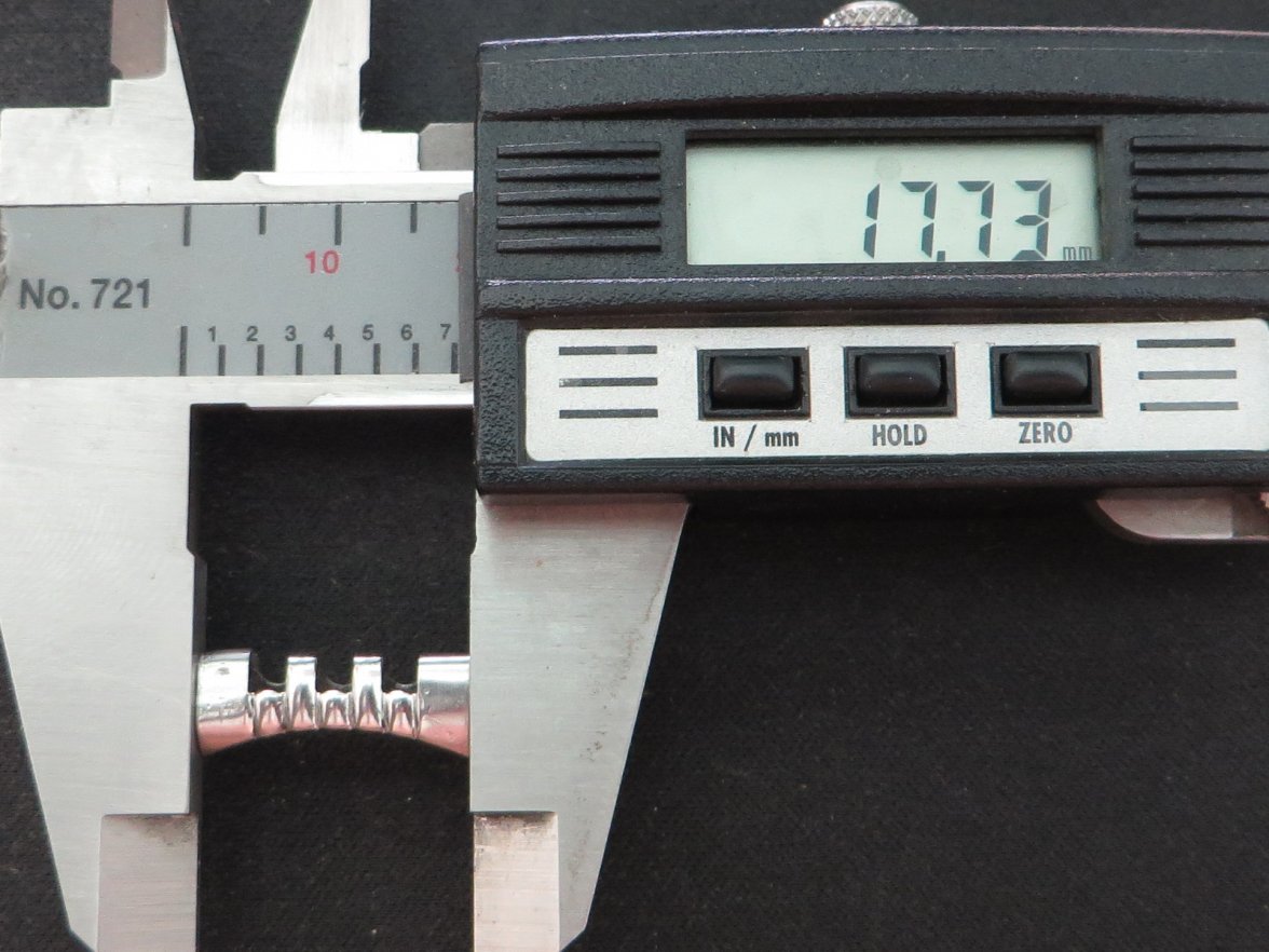

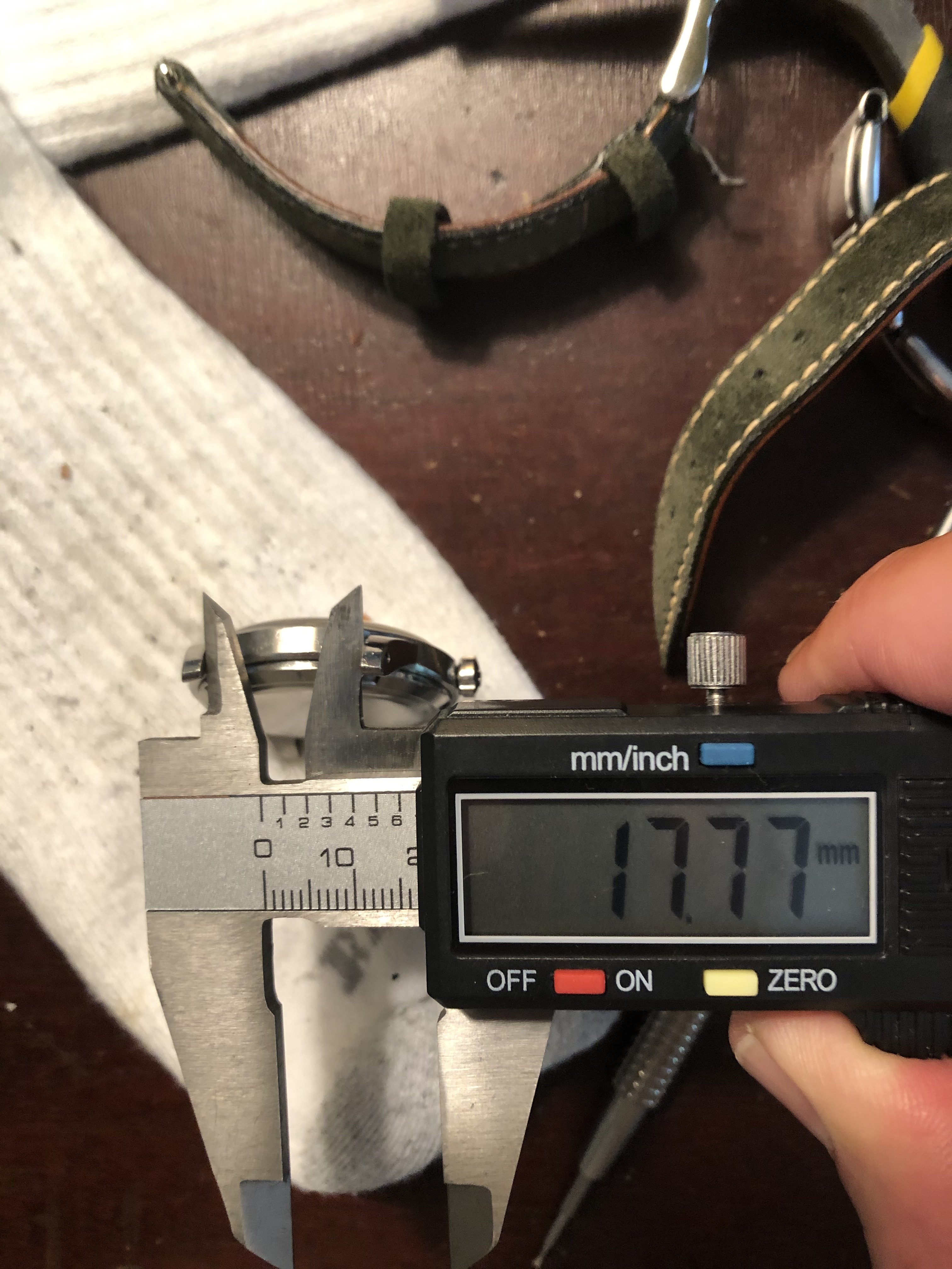

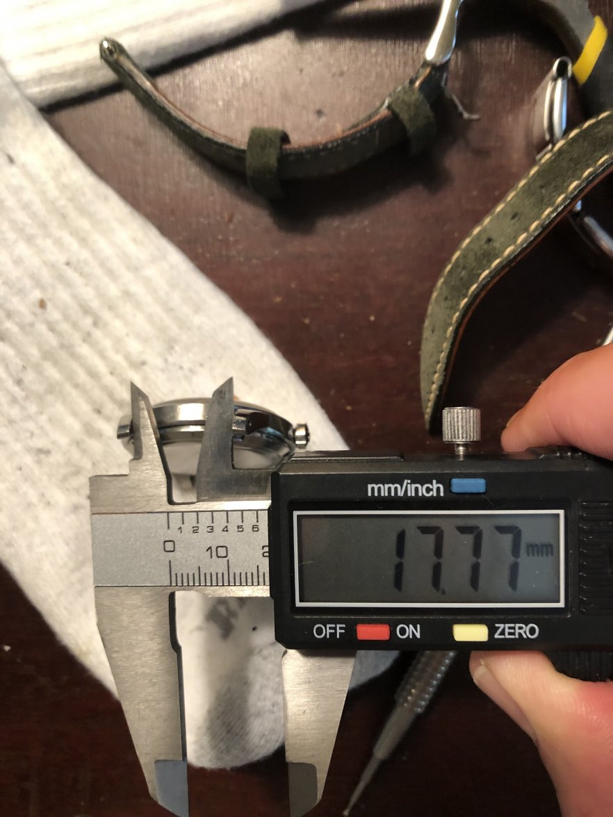

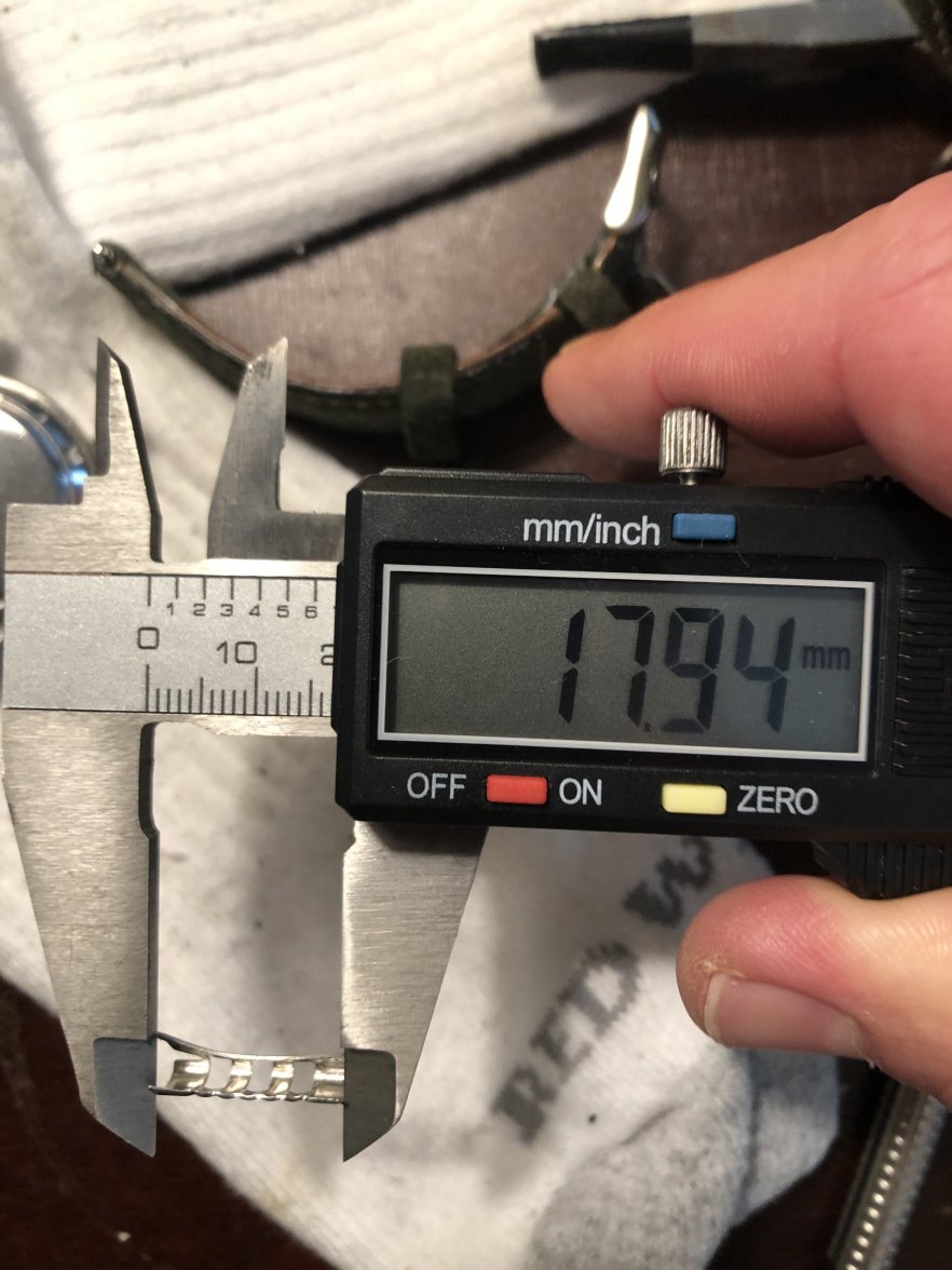

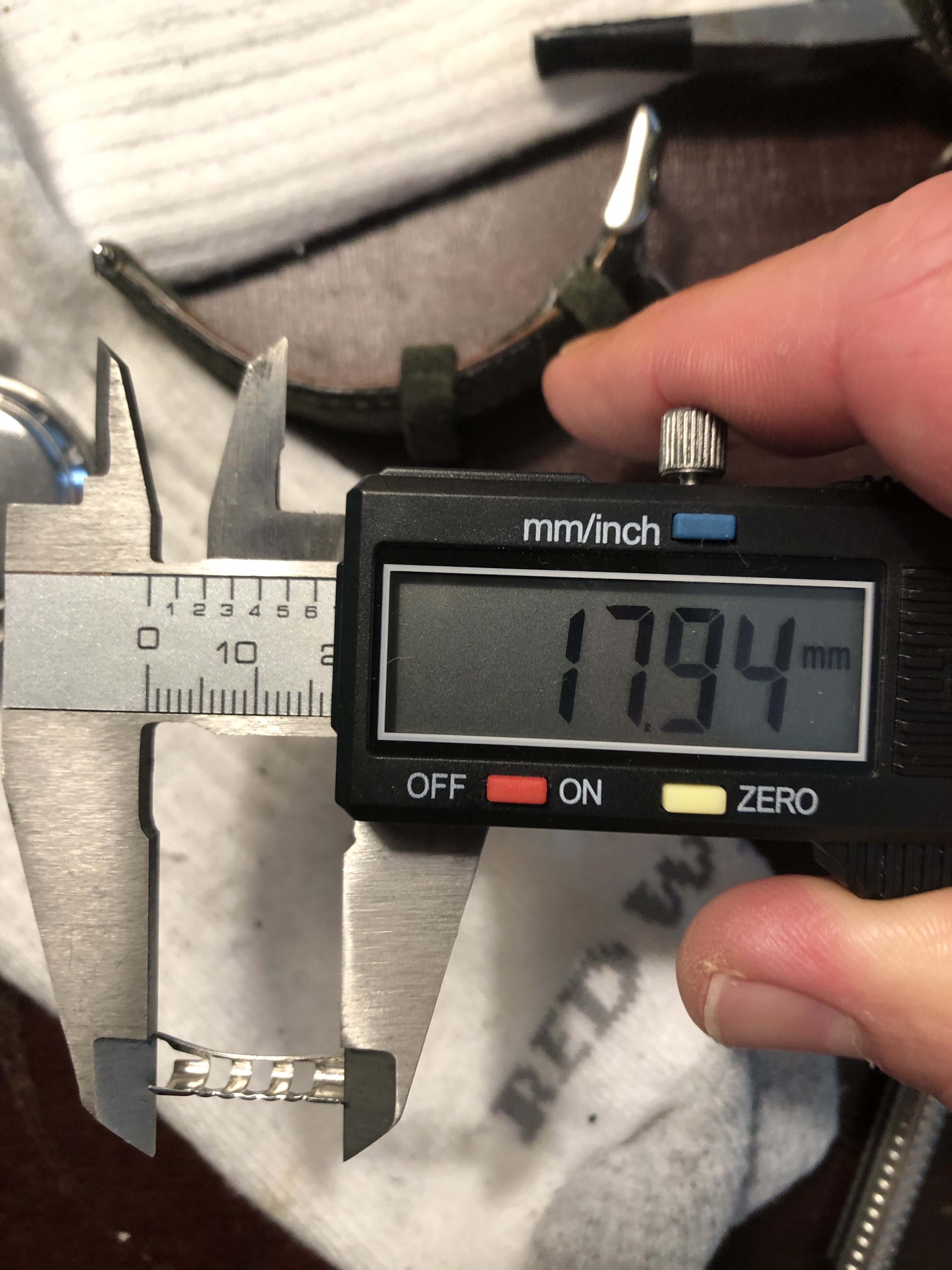

I have a newish factory 3010 with 511 endlinks that came on my ‘57 2949 (bracelet is the most recent one that’s available from Omega). I tried to mount it on my 2577 and it wouldn’t go on as much as I fussed. I was baffled and took out my calipers to realize that the 511’s measure 17.97 and the lugs on my 2577 measure 17.75.

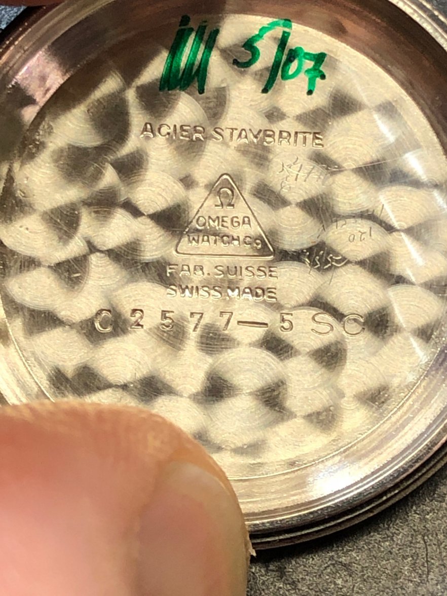

It has been pretty commonly agreed here that the 11/12/511/512 endlinks will fit all the fat lugged Seamaster’s (as well as the 14xxx and 166.010 series) - but is this incorrect? Is perhaps my 2577 a US market watch with English lug width (11/16th)? Or were the earlier (‘48-‘53) Seamaster’s indeed 17.75mm and not 18mm, thus requiring a different endlink?

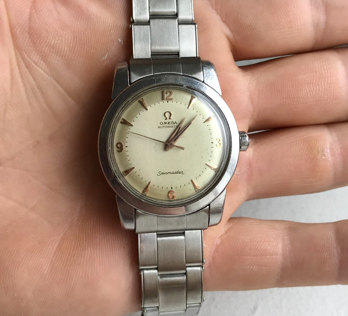

Dang, I just sold my 2577. Maybe @hejsam can check?
2,270
15,731

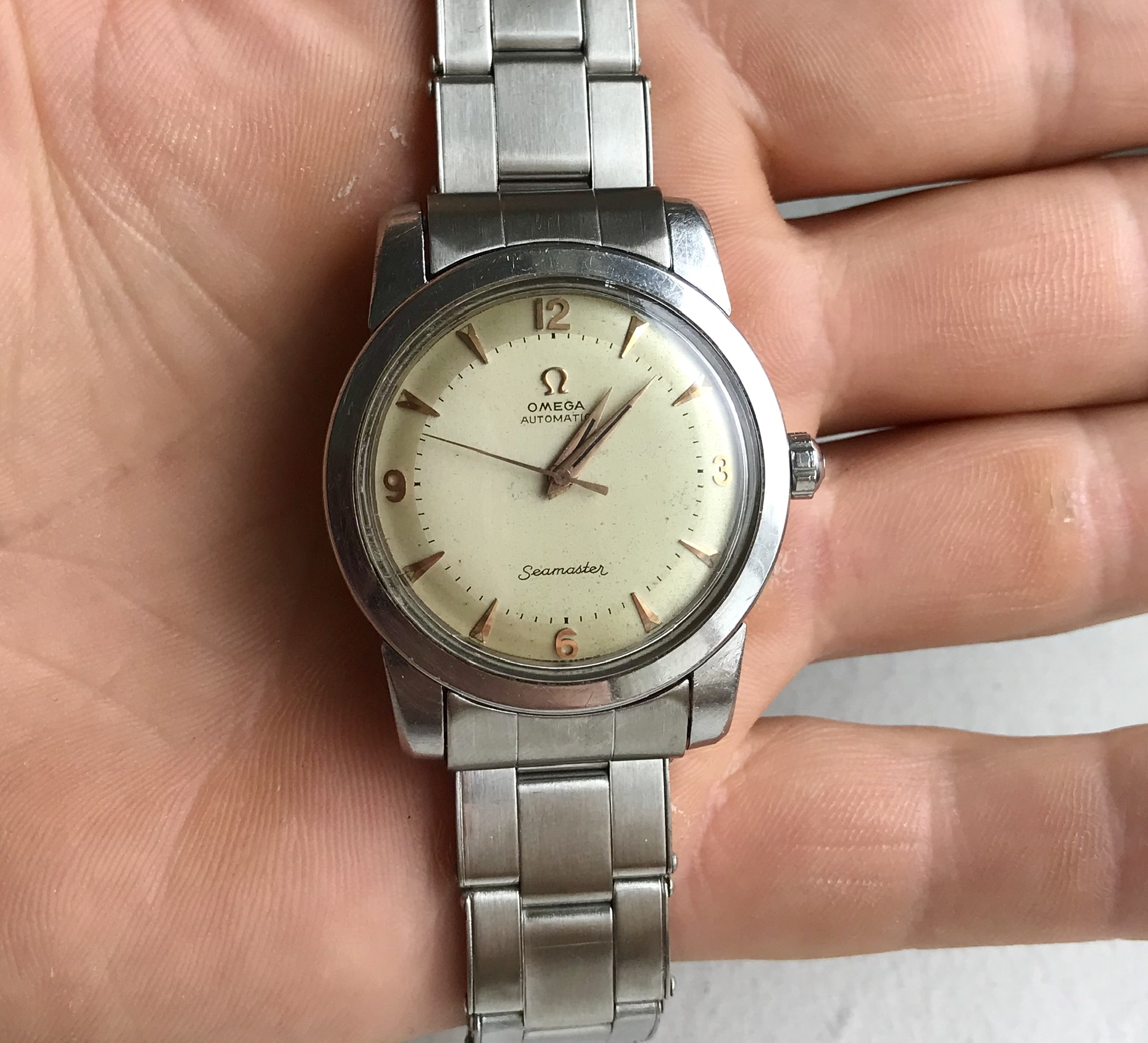

I’m away for a couple of days atm, will measure the lugs when I get back.
But pretty sure my lugs are 18mm and not 17.75mm since my 18mm bracelet and straps are fitting! 😀

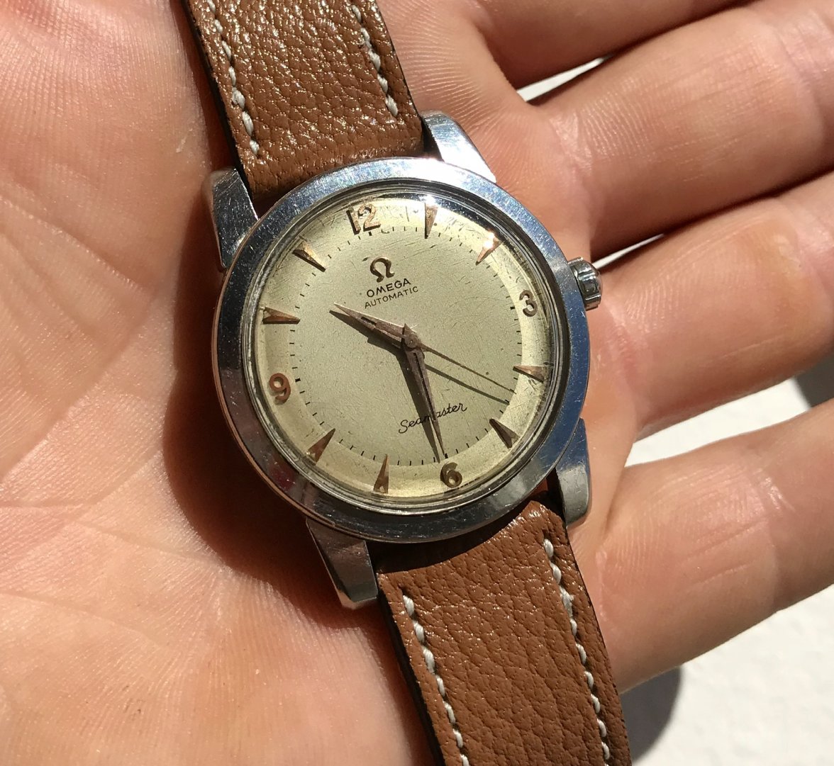

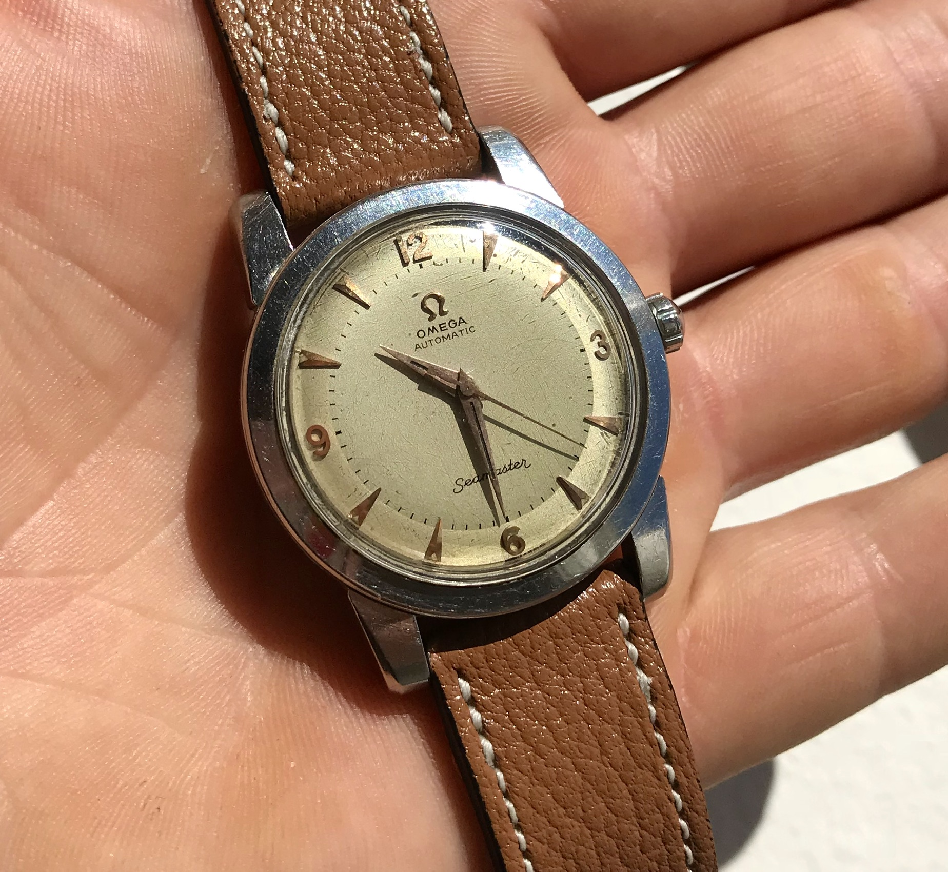

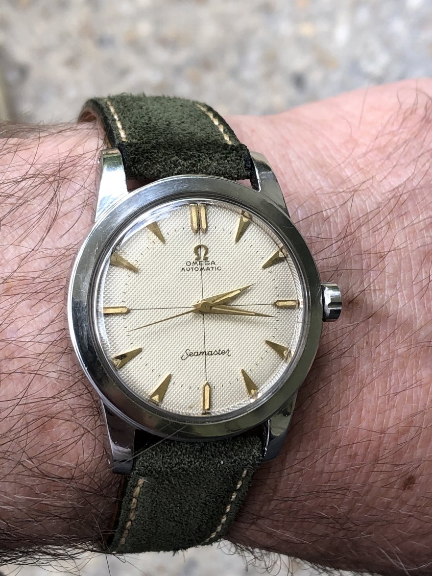

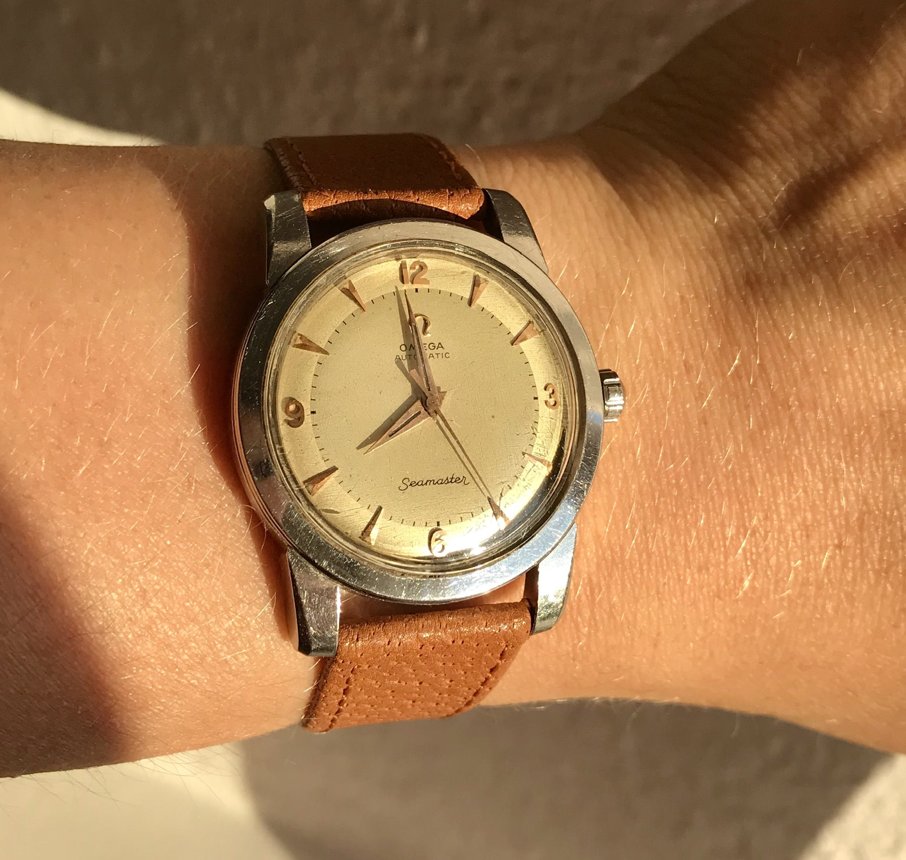

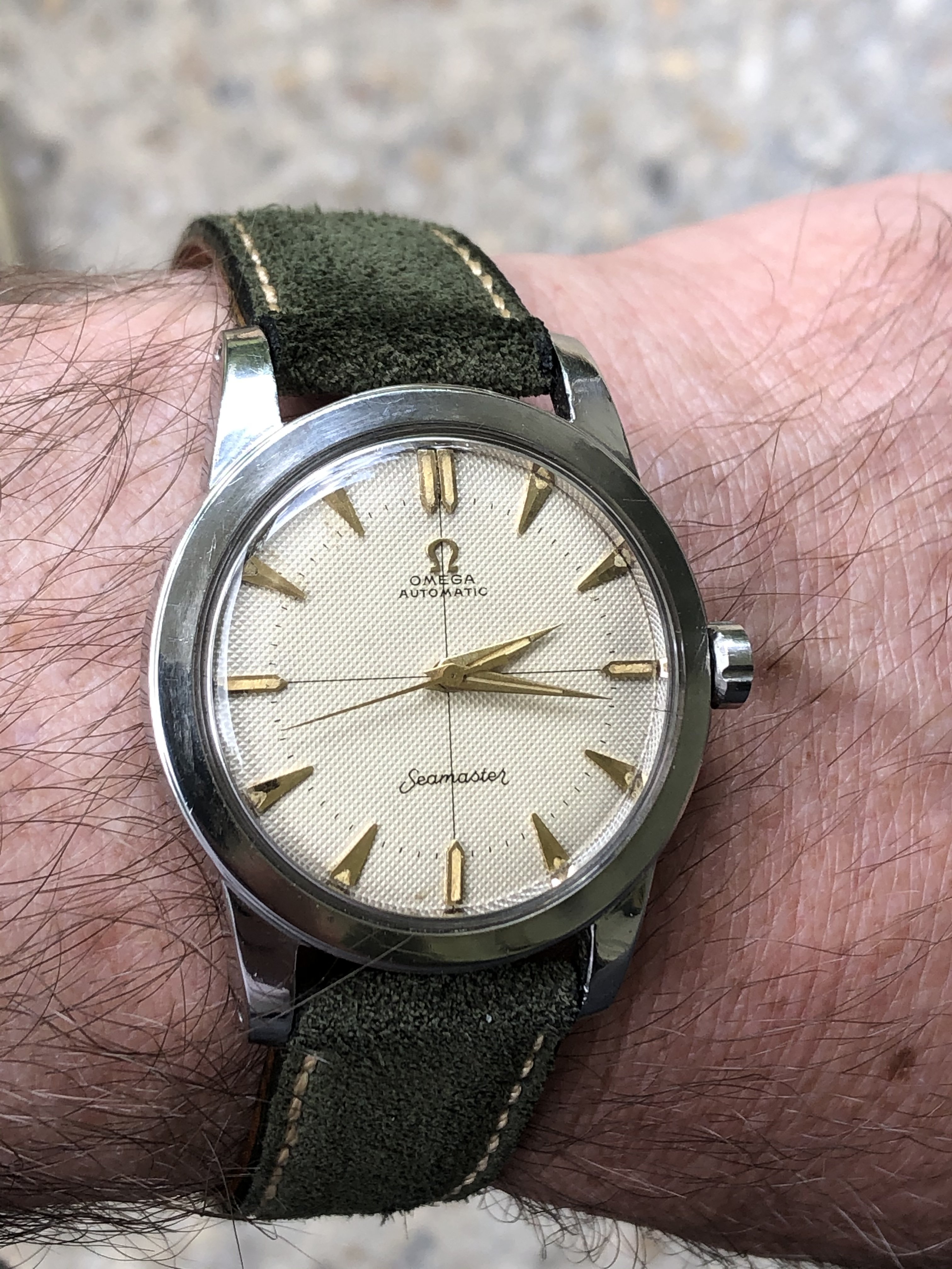

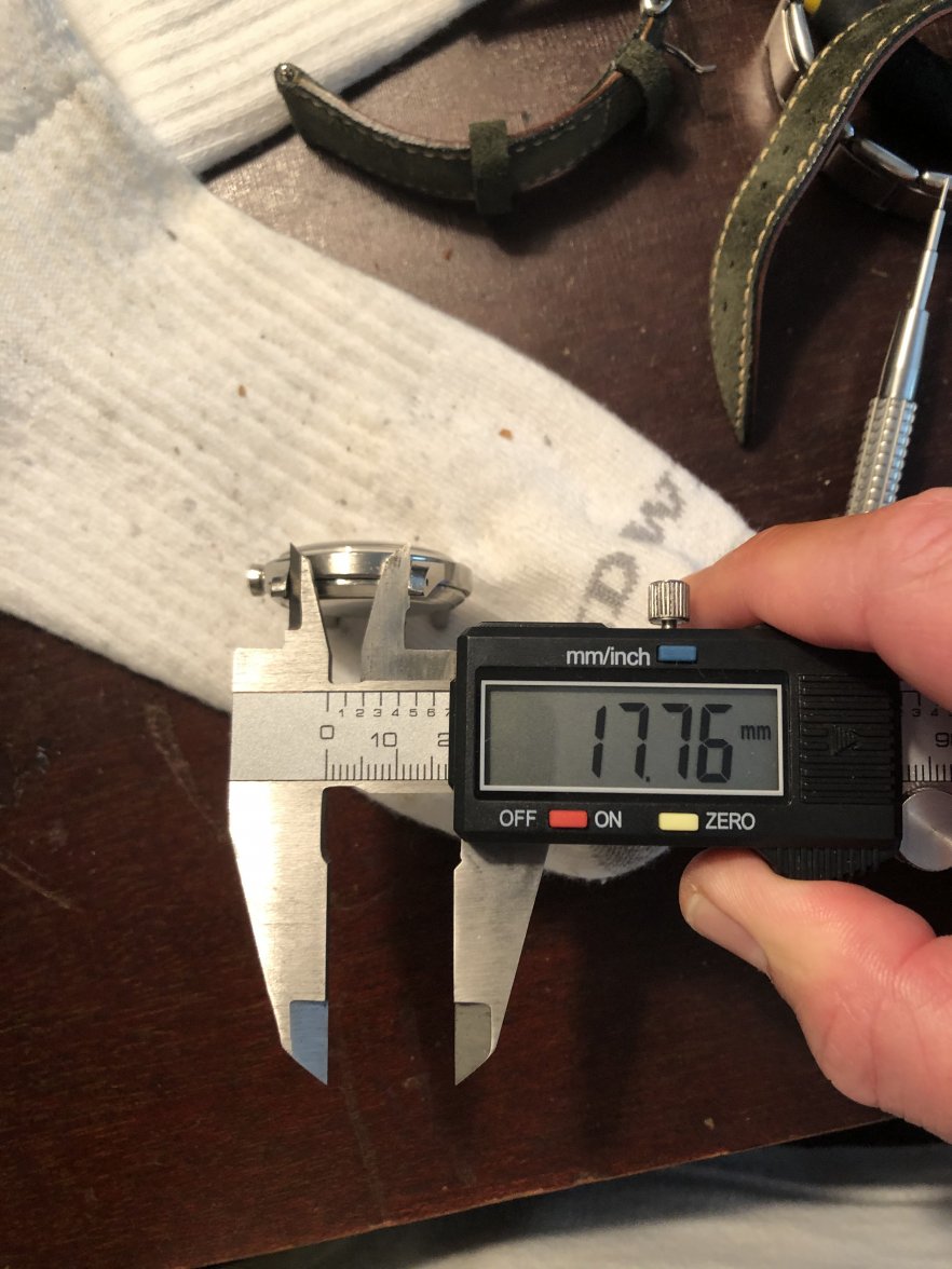

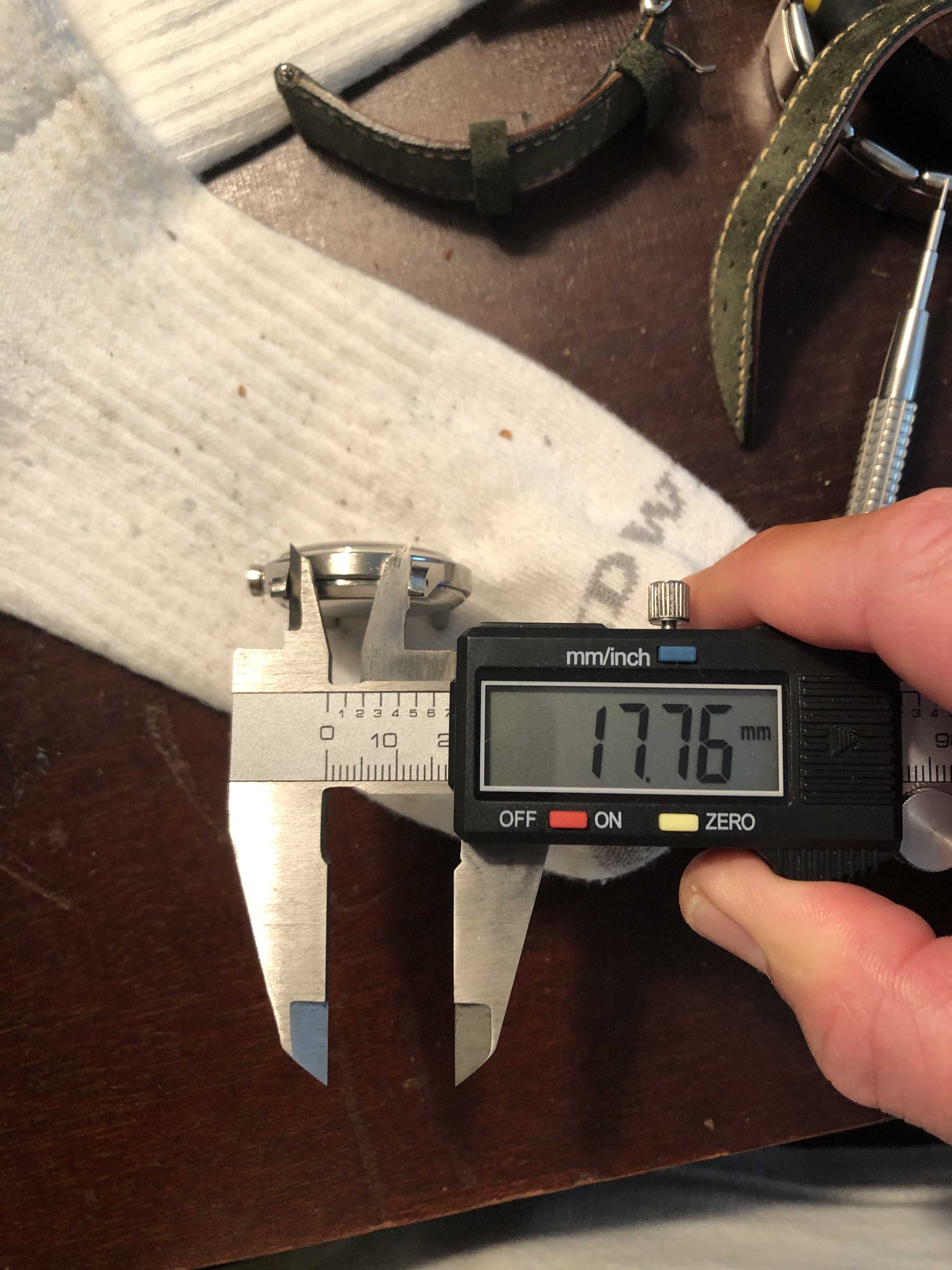

I took the calipers to them again- they are 17.75 on both sides (Lucas suggested maybe one lug got bent so I checked again. Even 18mm straps are a snug fit (cram) so it’s not just the bracelet. I’ll borrow another set of calipers from my friend just to make sure it’s not my measurements that are off- but those bloody endlink were not going in and snapped into the 2949 without issue.
The watch in question (pardon the aftermarket crystal retaining ring covering part of the dial- a correct one is on the way).

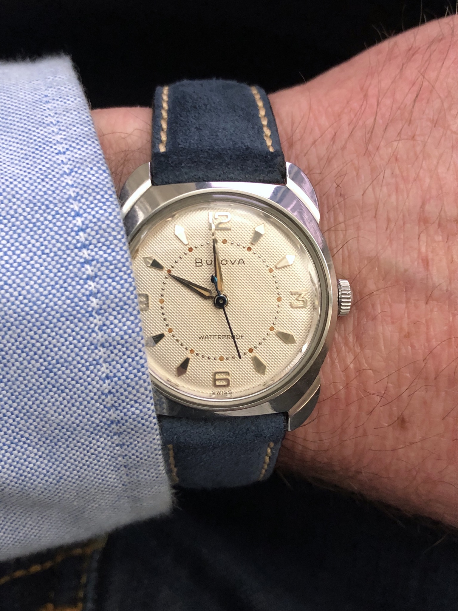

^ who makes the nice green suede strap?
Watchgecko- they did a “heritage” style line in a bunch of colors, I got the blue and green.
https://www.watchgecko.com/chedworth-suede-handmade-watch-strap

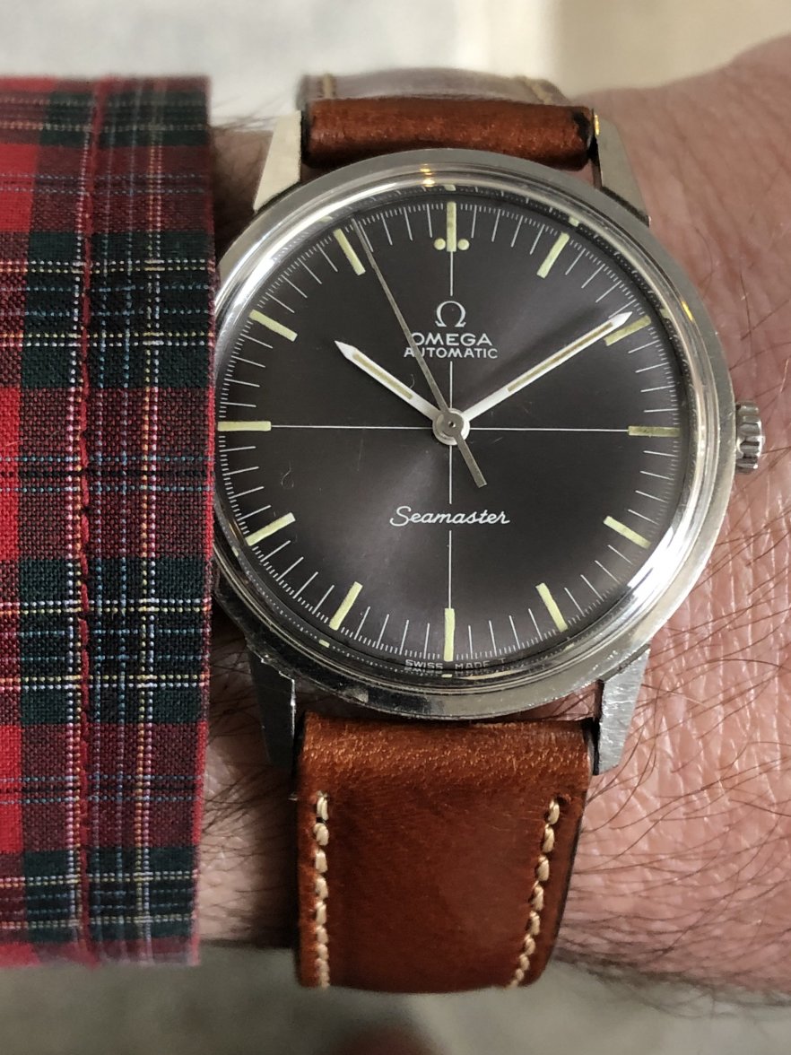

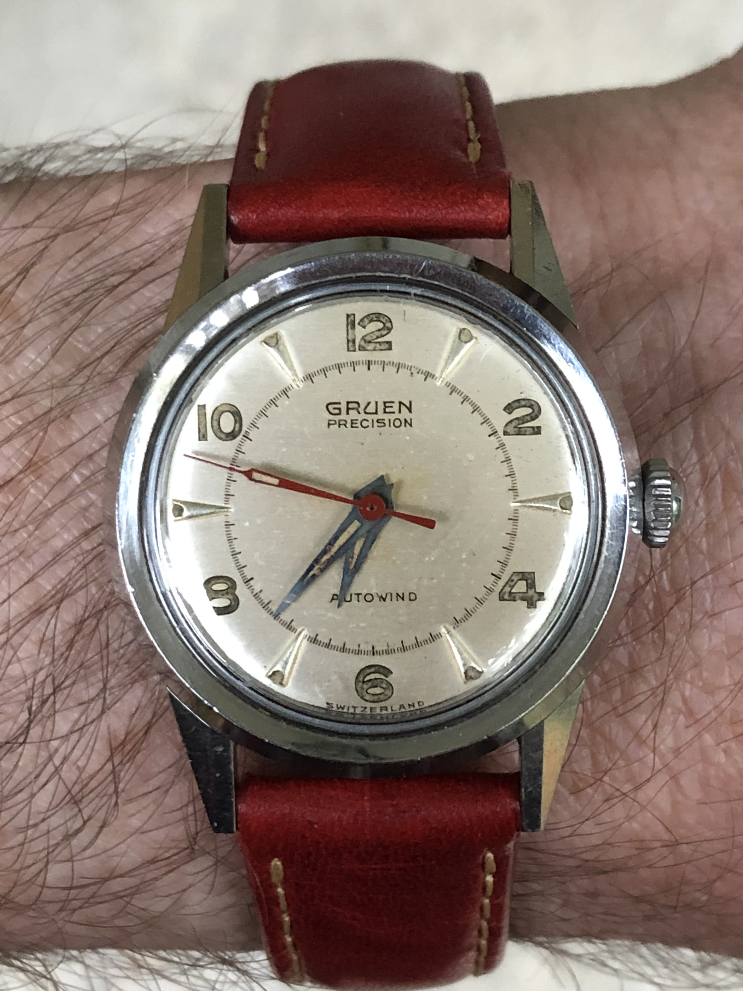

Then they did the same style in a Horween leather and I got black (not on a watch at the moment), camel and red in those.
https://www.watchgecko.com/geckota-kington-vintage-style-dress-watch-strap
I need to get more. Nicely done fun straps for little money.

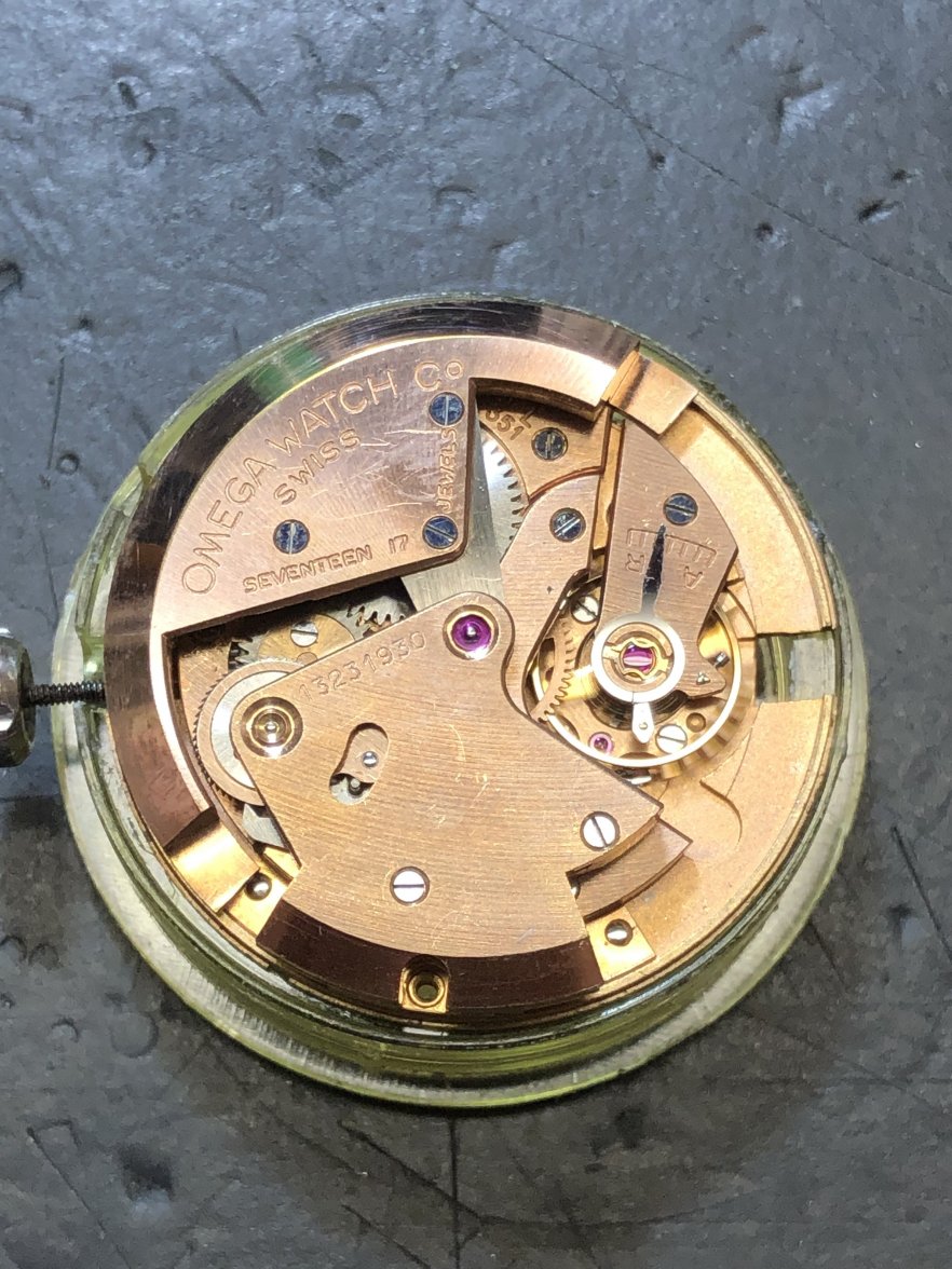

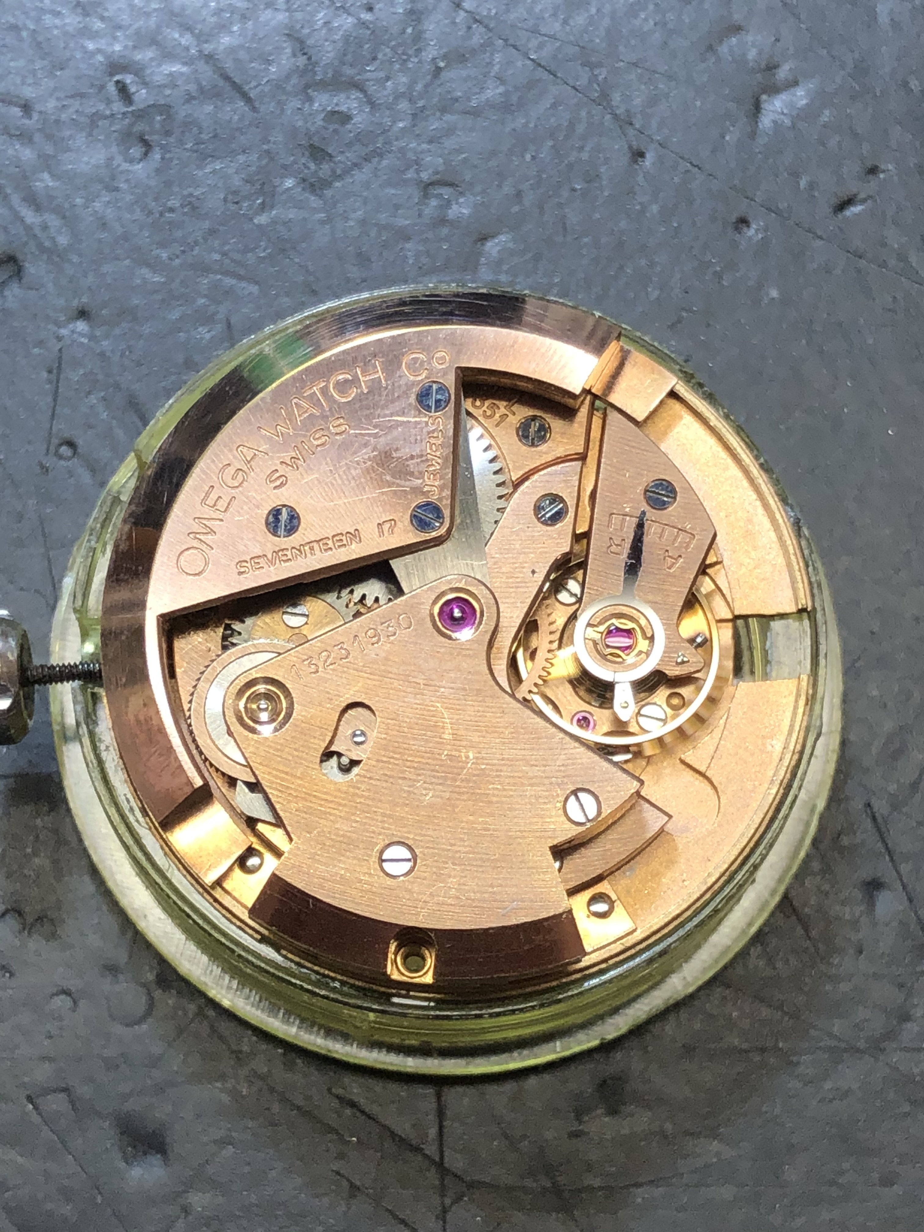

Might just be an oddball batch. I've checked several of mine and all are 18mm. You're watch movement is not marked OXG, so it would not be a US market watch. Remember since these were supplied on straps no one would have noticed something like this until they tried fitting a bracelet and a watchmaker at the time would have just filed the end links and said nothing.
16,305
45,025
This I can see- we sometimes forget that despite the huge volume of watches these companies were making much of the business was a cottage industry with changes on the fly, different parts suppliers and spec’s that were sometimes loosely followed. We get so mired down in matching date codes and year correct buckles- but they really just threw on what they had and called it a sale.
I’ll get a second set of calipers and see what they say but the oddity of the mismatched sizes still has me puzzled.

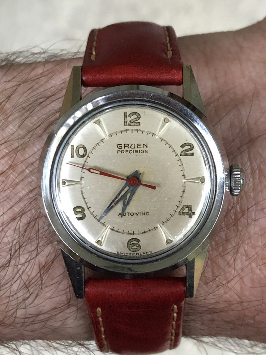

I know this thread is about lug size but the waffle dial Bulova is spectacular. 👍

cheers for that - looking now. That Bulova is 👍 Is it in the Bulova thread?

I believe I posted it long ago. It’s a show stopper for sure and I feel lucky to own it. What I love about this group is every time I post that thing in reference to something (be it Bulova, waffle dials, butterscotch lume, straps), it always gets compliments- which shows that this is a group of people who can truly appreciate great watches be them $100k PP’s or $150 Bulovas.
1,441
3,809
that beauty has it all; 3,6,9,12 dial, patina, unique cushion case, coffin markers, HC dial with inner ring minute track, alpha hands, blued seconds hand
16,305
45,025
I always like to think of it as “crab lugged”, but I do live in Maryland so maybe I am a little biased.😉
Not that I want the market to explode on vintage Bulova (cheap thrills for me) but other than the 666 series and Accu Astronauts, I think the brand gets very little love, and they were top notch all the way through the late 60’s with some very unique and archetypal designs of their respective periods.

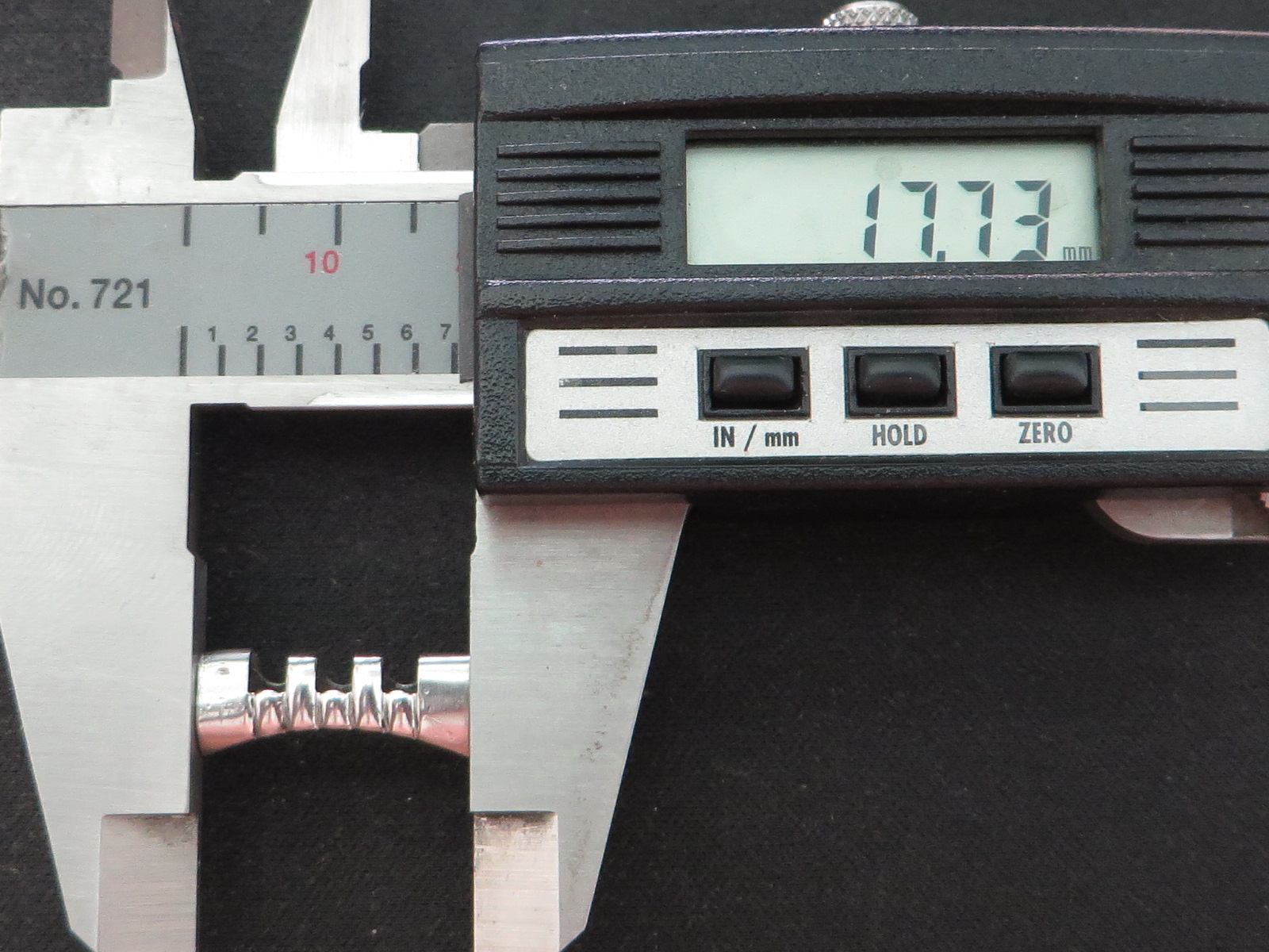

Digging through my BOR stash I found a pair of number 11s filed down to fit something, perhaps another 2577 with under-size lugs?
