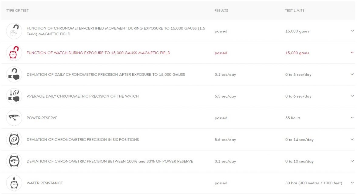

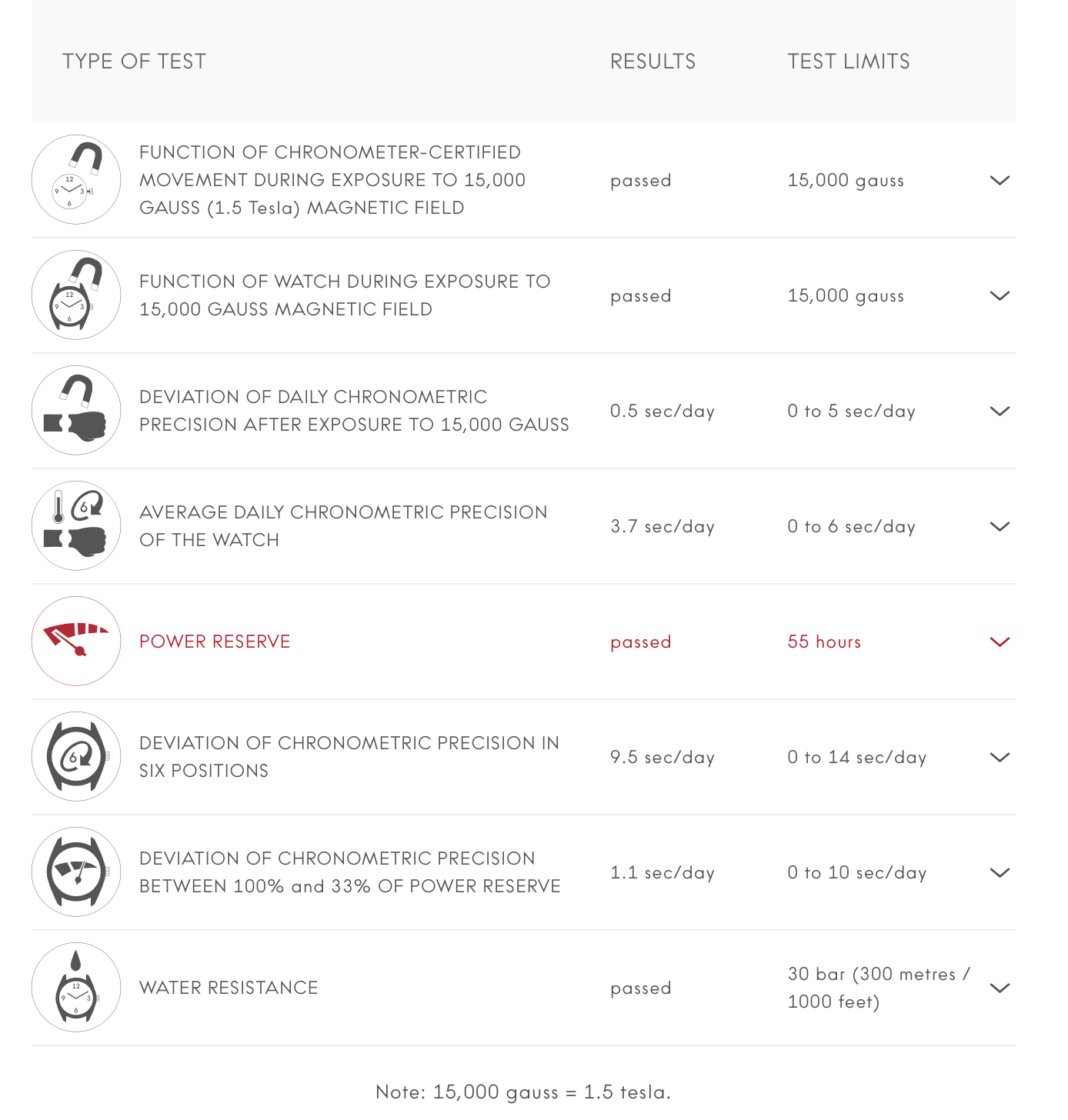

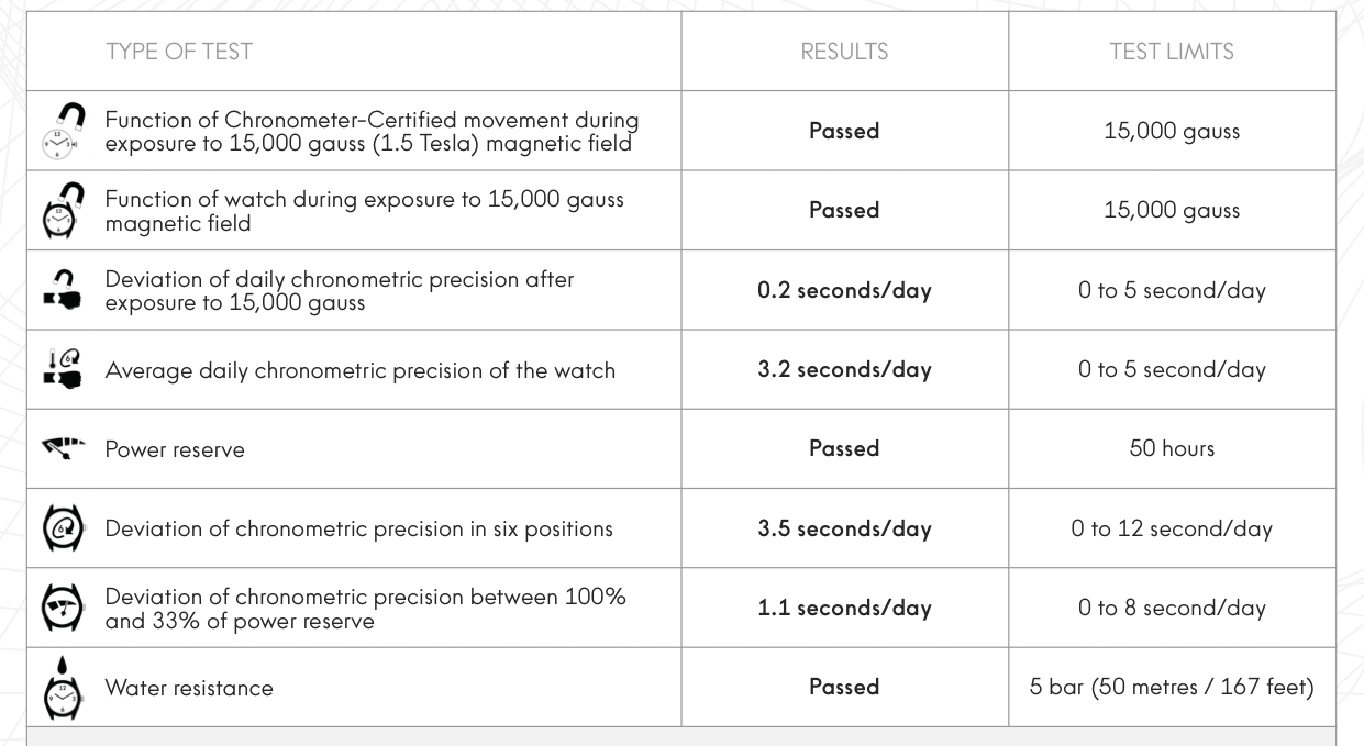

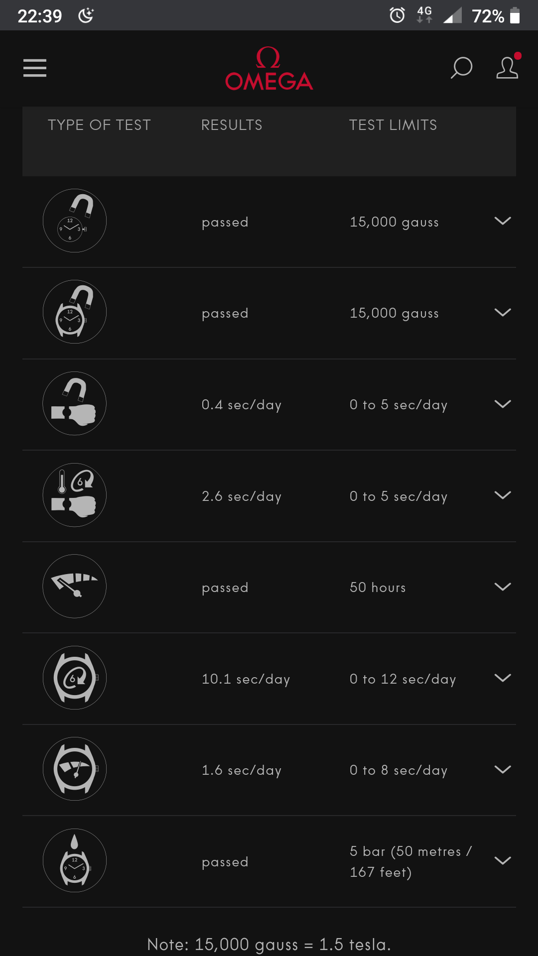

I’d be interested in seeing the METAS results you can download from Omega for your watches. Just curious on how the timing differs across watches and models. Here’s mine for the new 3861 Speedmaster.
298
520
I don't have mine handy, but the average daily was 3.3 spd. Not bad, you have me beat my 1/10th of a second 😉

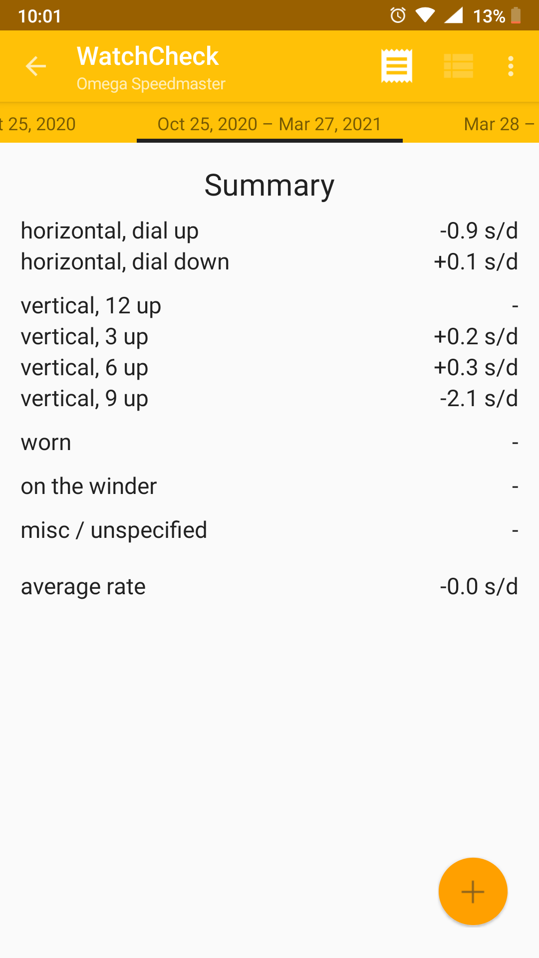

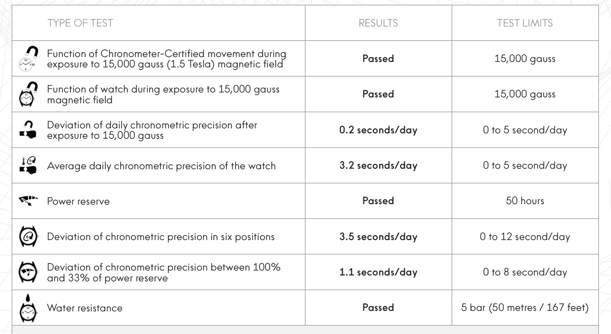

Are your average daily chronometric precisions accurate? Mine says +3.2 sec/day but it seems to be running around +4-5 sec/day.

This is my average for the last full period, not worried about the losses as that avoided having to hack.

Didn’t realize positions matter so much. Very helpful, thanks for sharing.

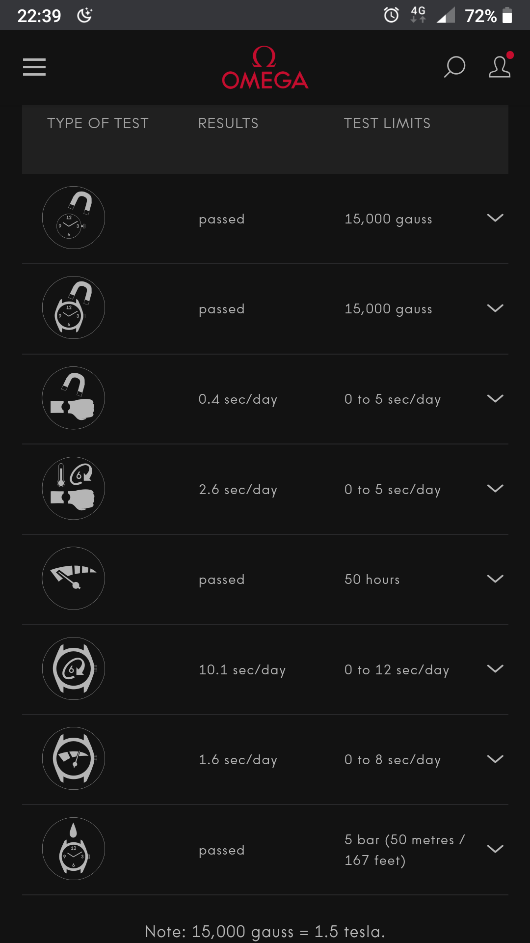

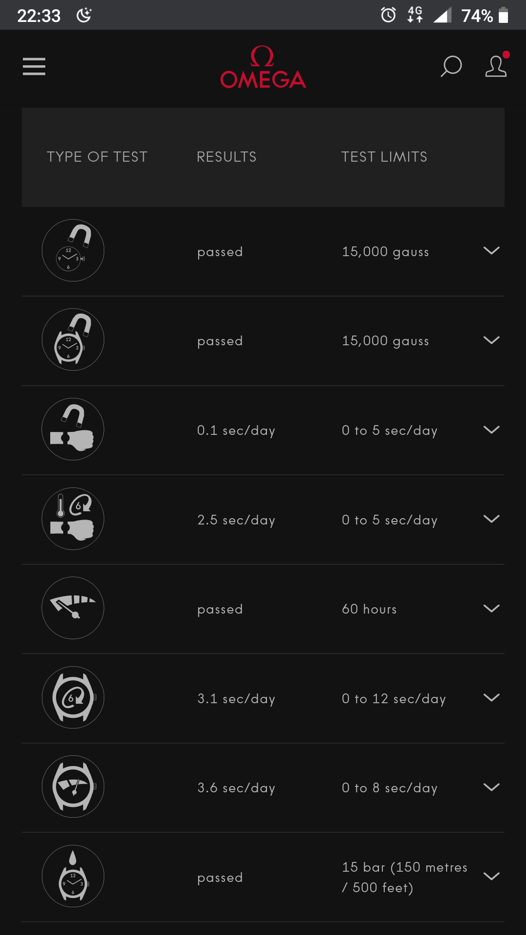

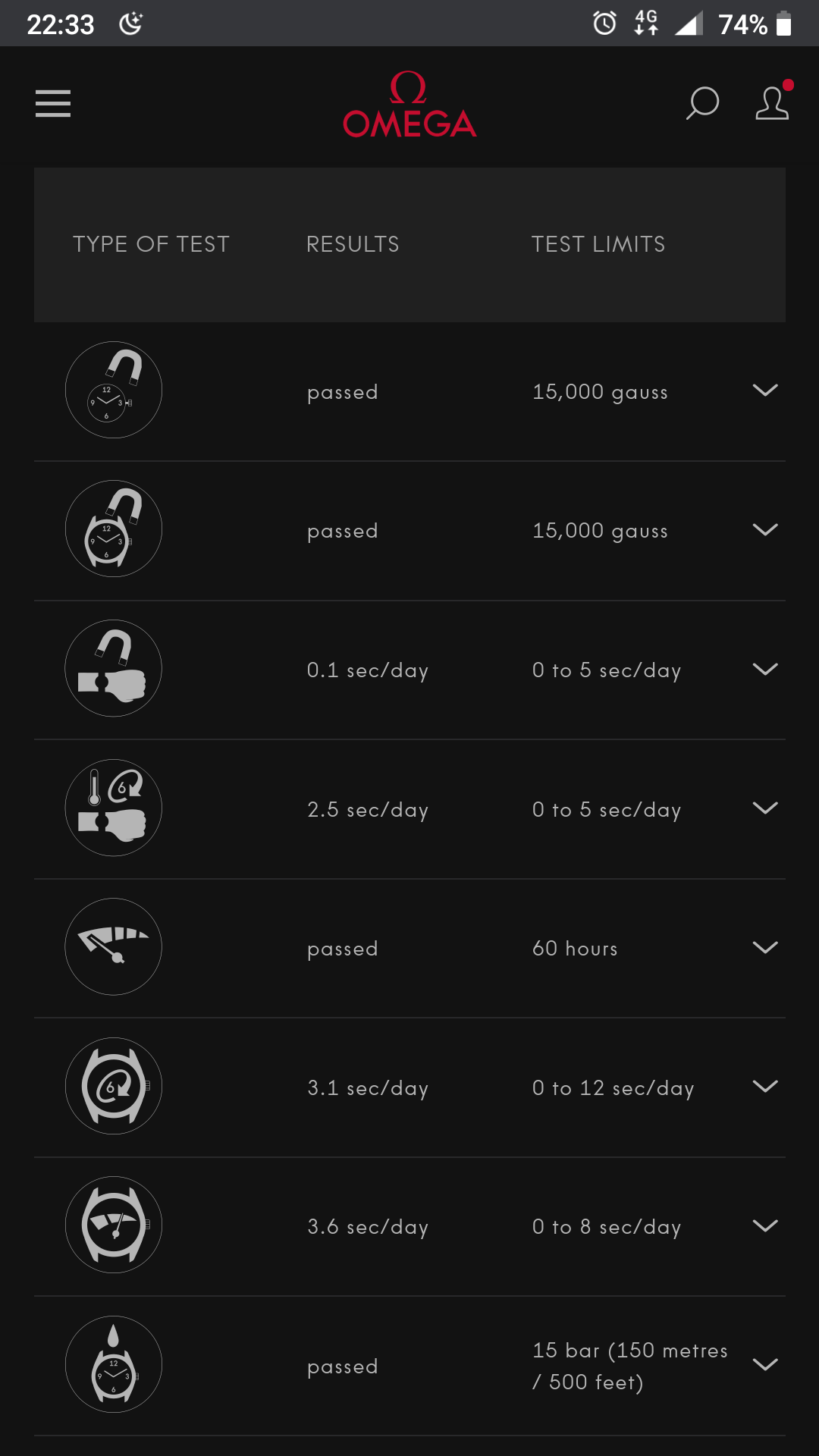

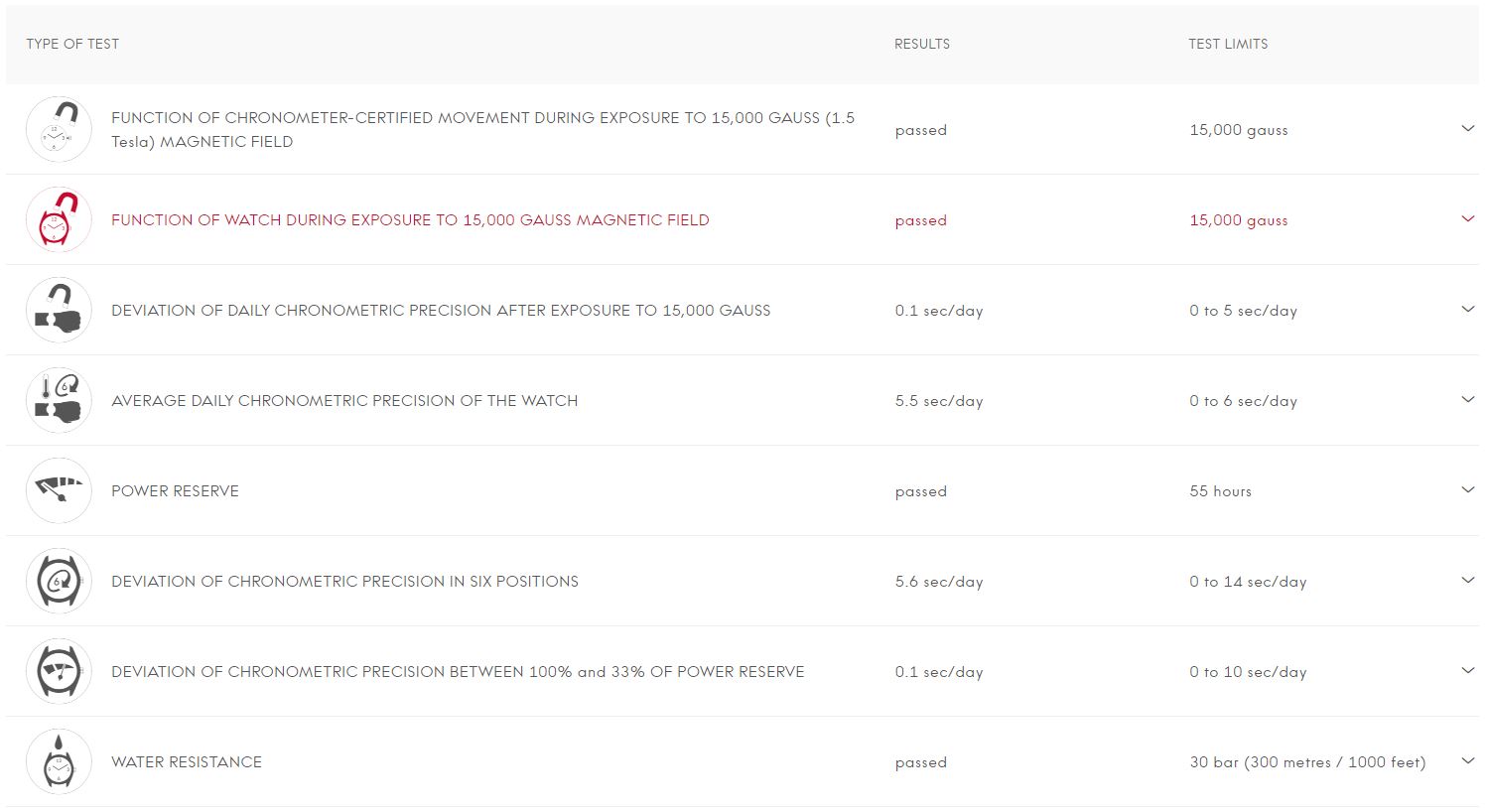

Here’s mine from my August 2020 SMP 300 (cal. 8800).

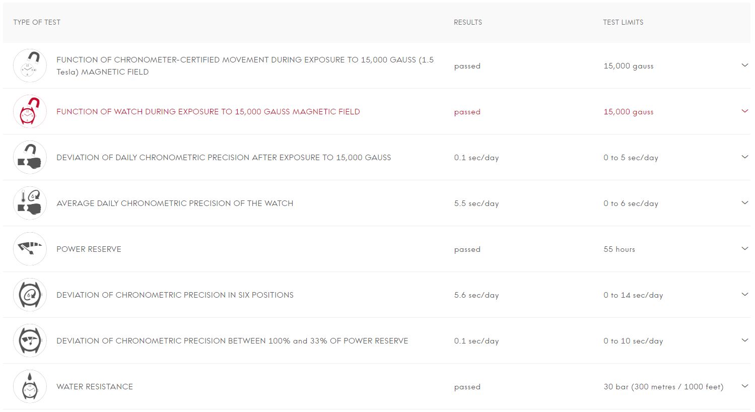

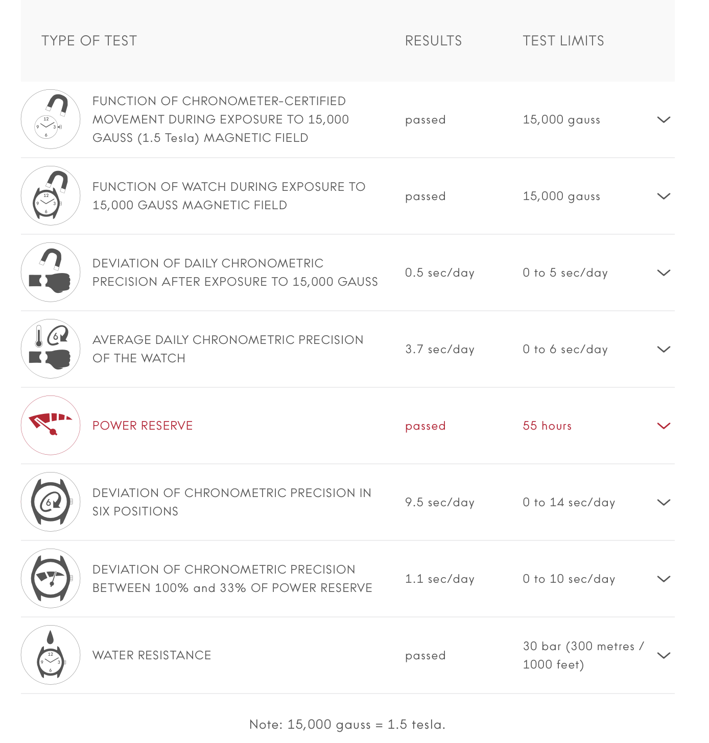

Honestly was a bit disappointed by my Omega Seamaster NTTD, they really took it to the limit. It seems worse than my Tudor BB58s.
Here are the results:
How come the range goes up to 5 seconds on your 3861 while it's 6 seconds for the NTTD? Thought they were under same rating, might be wrong.
I’m not sure. Good question, perhaps newer tighter standards?

Here are the results for my NTTD. I was a little surprised/disappointed too. Same movement (8800) as my Seamaster Diver and Aqua Terra, but slightly less accurate for some reason.

Think Omega is doing a bit misleading marketing here to be honest. Their homepage states clearly METAS requires a maximum deviation of 0-5 seconds, yet when I researched on METAS homepage there’s three classifications of which the second one fits exactly the requirements shown under the NTTD movements.
It’s no big deal however as when I wrote the boutique politely earlier that I felt my watch was too fast (wasn’t just because of the measured results) they immediately offered to calibrate it free of charge.
As always I’m highly surprised and satisfied with their service support!
25
I’ve been using an app to check actual daily deviation and I’m at 2.3 SPD over a couple days of normal use. A little better than the 3.2 SPD from METAS. Obviously a lot of factors and variation but feel good about it and it’s a good margin to not run slow.
