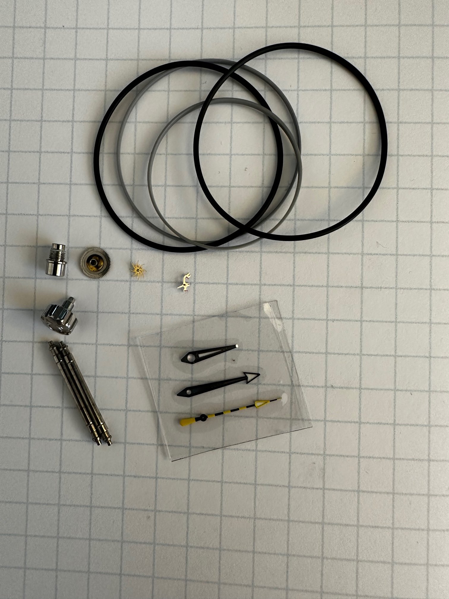

Both of my Aquaterras (Cal.8500 and Cal.8508) suffered similar failures, shortly after each watch went out of warranty. Hoping to save some money I took my Cal.8508 Aquaterra to a local watchmaker for repair. There was a long delay (six weeks or so) while he searched for a particular replacement part. The part finally arrived and he completed the repair. Except that the hour hand was now misaligned; it was only lined up with the hour marker when the minute hand was at about 15 min past the hour. I realized it was a mistake taking the watch to a (likely) non-Omega certified watchmaker and subsequently took both watches to our local Boutique and left them for repair. They came back about a month later. I got a "package deal" on the repairs, which came out to about $410/watch.
At least I got this nifty set of used parts from the Cal.8508 watch, including some pieces of the co-axial escapement:
So one lesson learned here is that it's probably best to have a watch with an 8500 series movement repaired by a certified watchmaker with an official Omega parts account (like the Forum's @Archer ), or have Omega itself do the repair.
