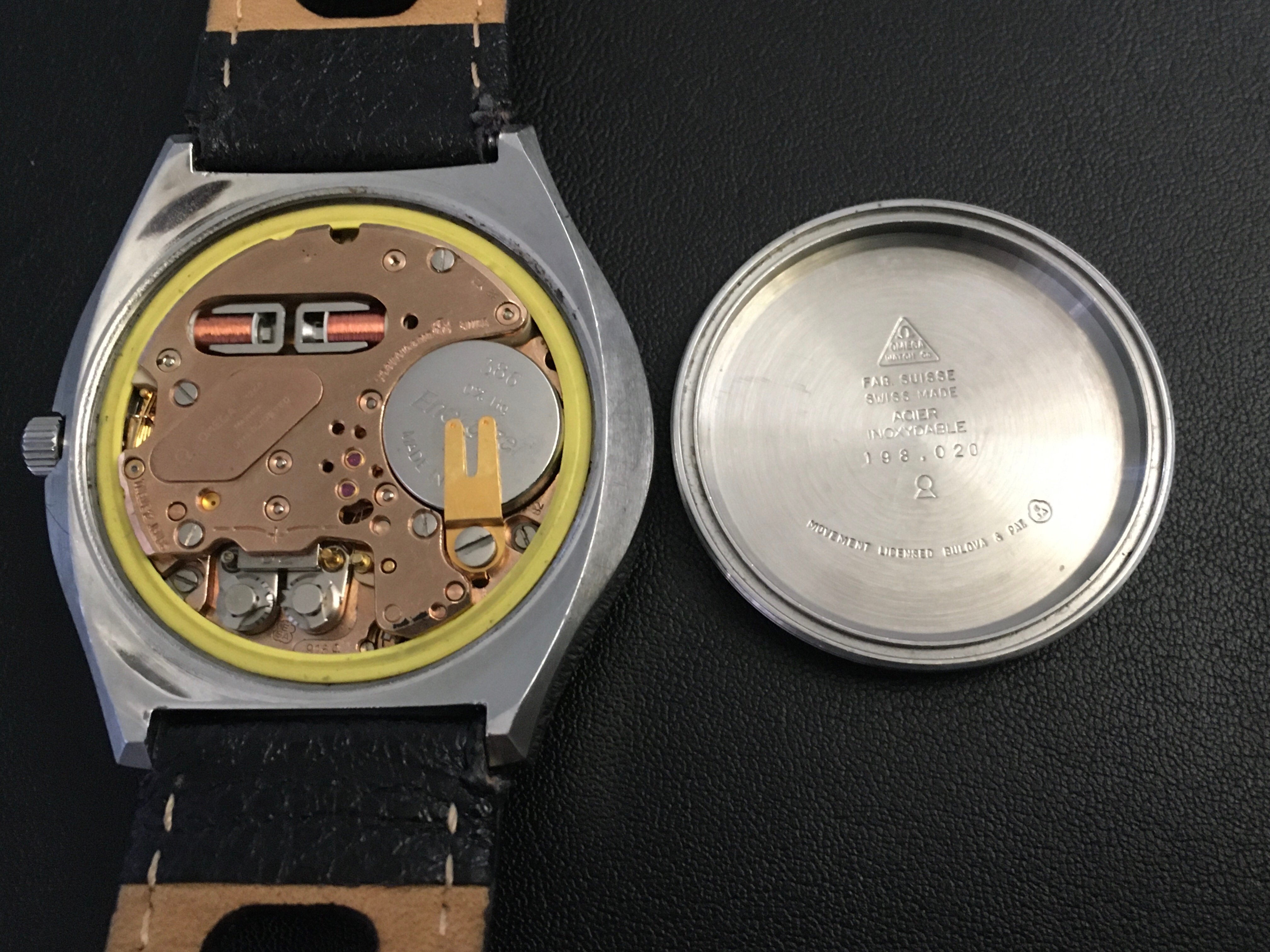

I was ready to buy the black gasket that fits in the caseback channel but then realized there's also already a yellow gasket on the case side. When I searched images online for the 198.020 I can't find another with the yellow gasket, but they all have the black one on the caseback. It seems clear I should still install the black one, but is the yellow gasket correct, and should there be anything there at all?
Somewhat confusingly it feels like it is snugging down against the yellow gasket, rather than metal to metal as I would have expected without the black caseback one in place. If I add the black one would it be wrong since it might then double up gaskets, something that's generally avoided in most situations?
Also, I did ask the seller about the gasket and he said, "We installed a new yellow gasket in watch, its possible case back ring, got loose in shipping, we only snug on accutron movements, as you can damage them if too tight, just snug it up, and you should be good thanks."
Here's the full view of what I'm working with:

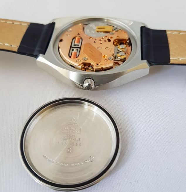

However, this seems more typical of what I'm finding with online pics, no gasket on the case side:

Should be only the o-ring fitted to the case back.
Looks like someone who didn't have access to the correct part bodged it with the yellow thing.

Thank you, I will remove it once the correct seal arrives and toss that yellow bit in the "may need this never" drawer.
