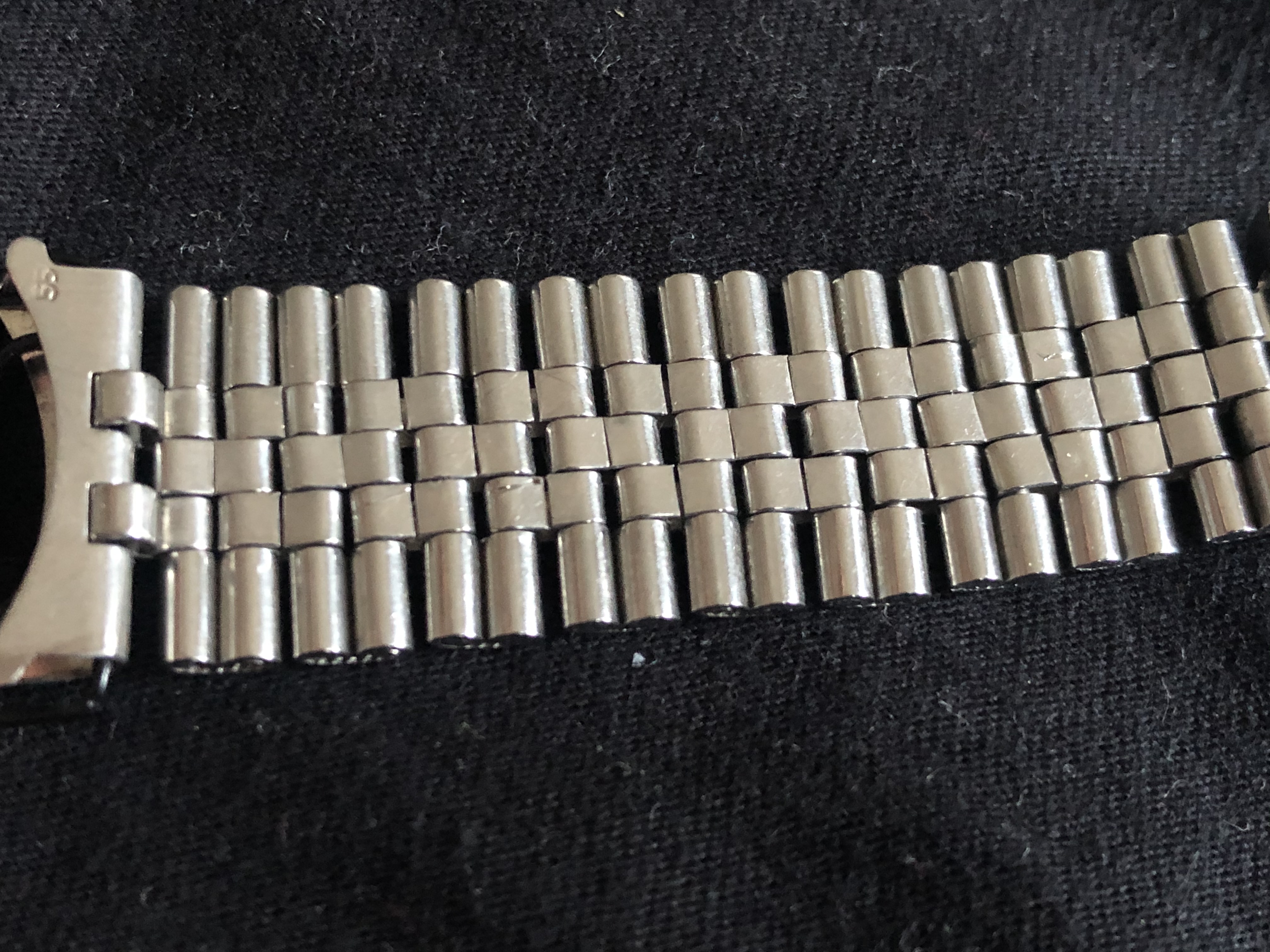

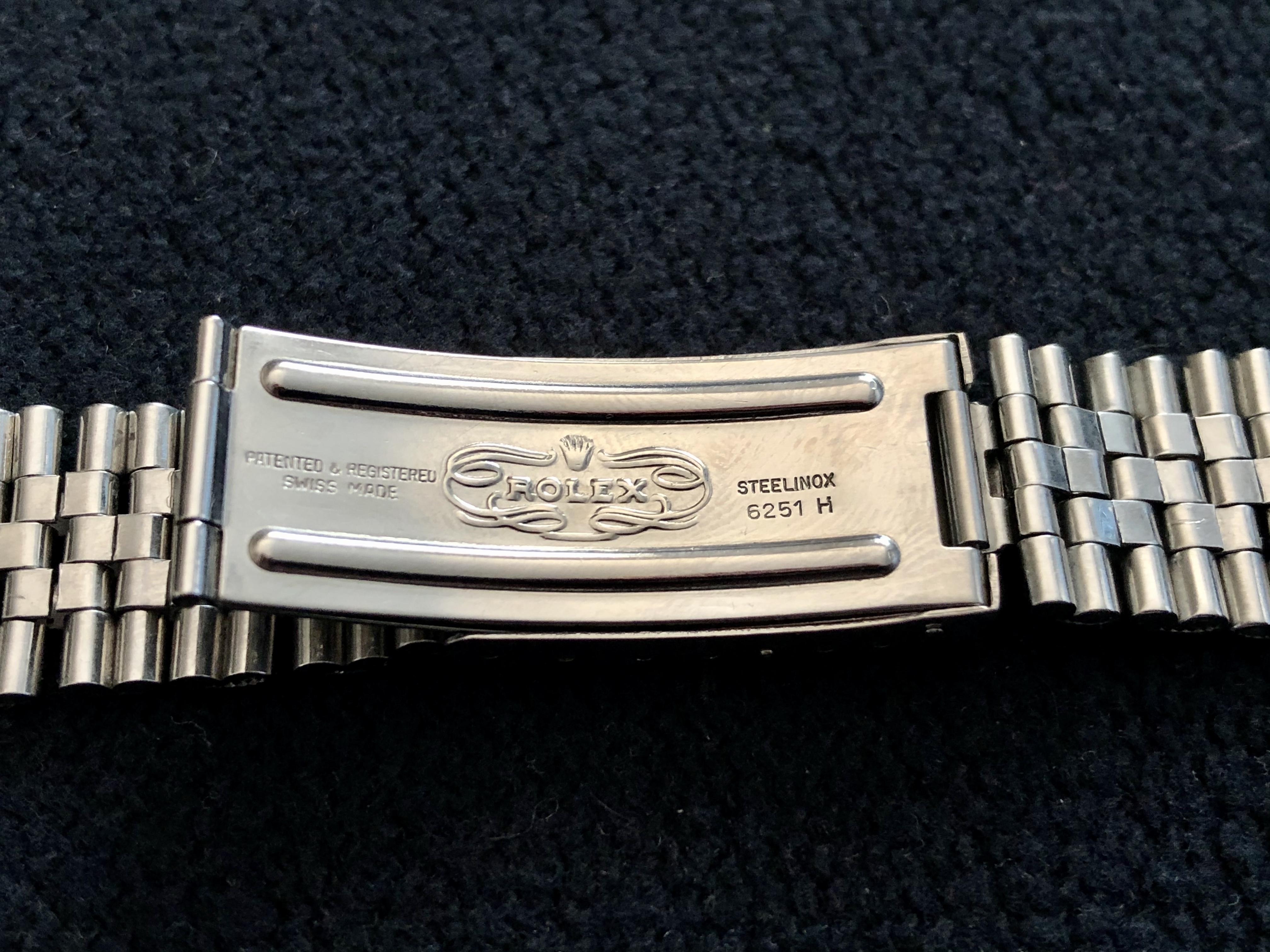

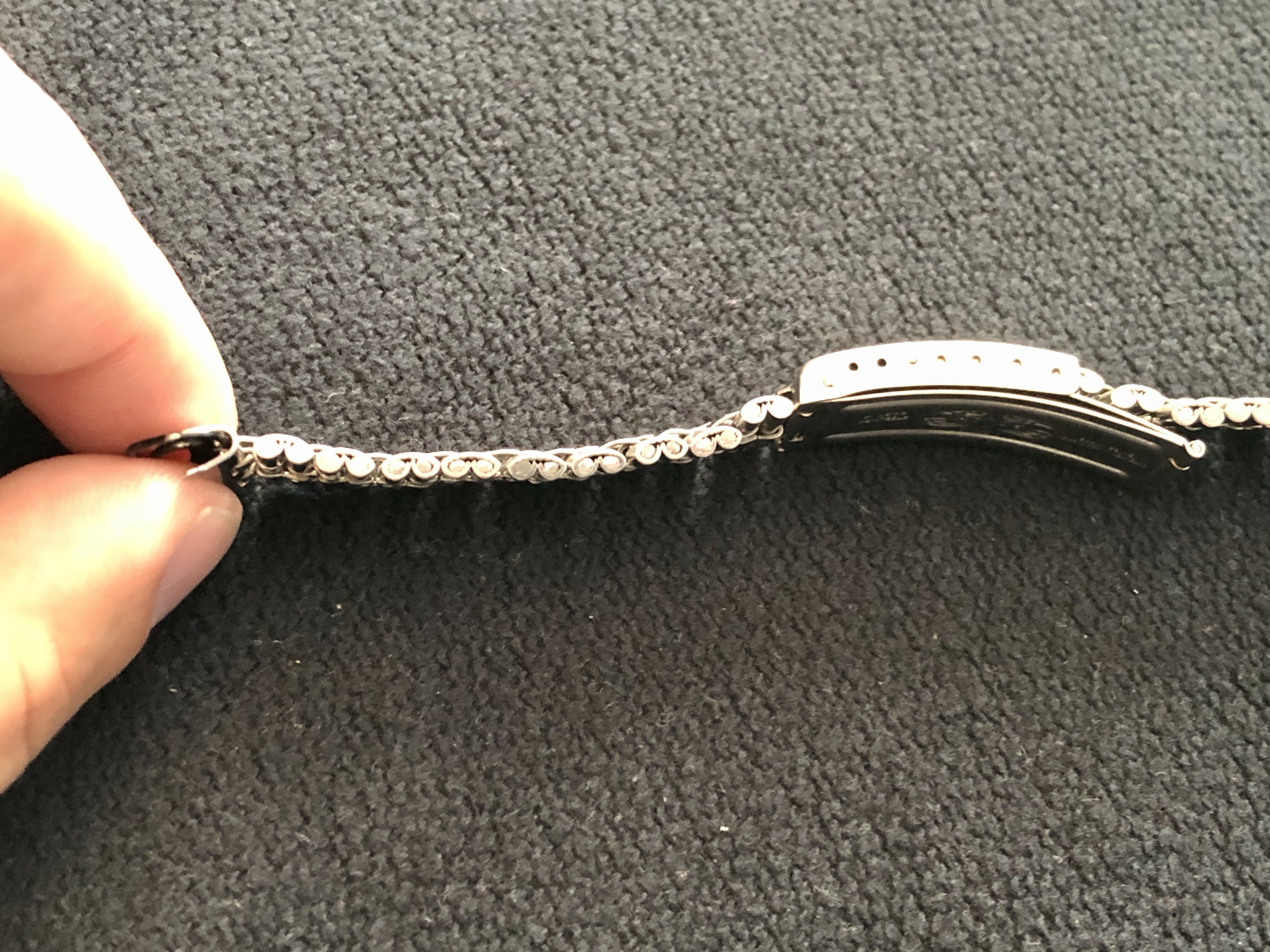

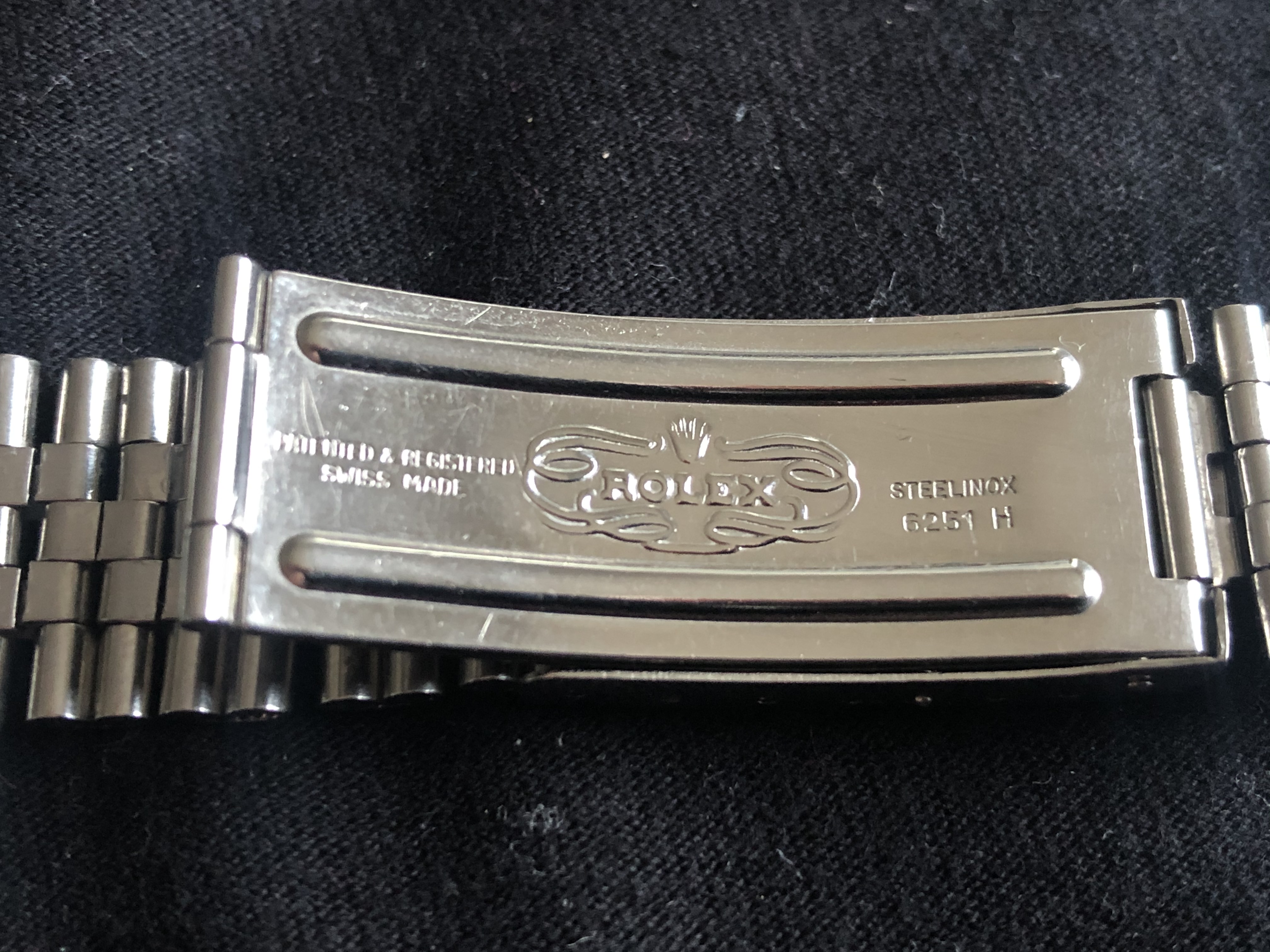

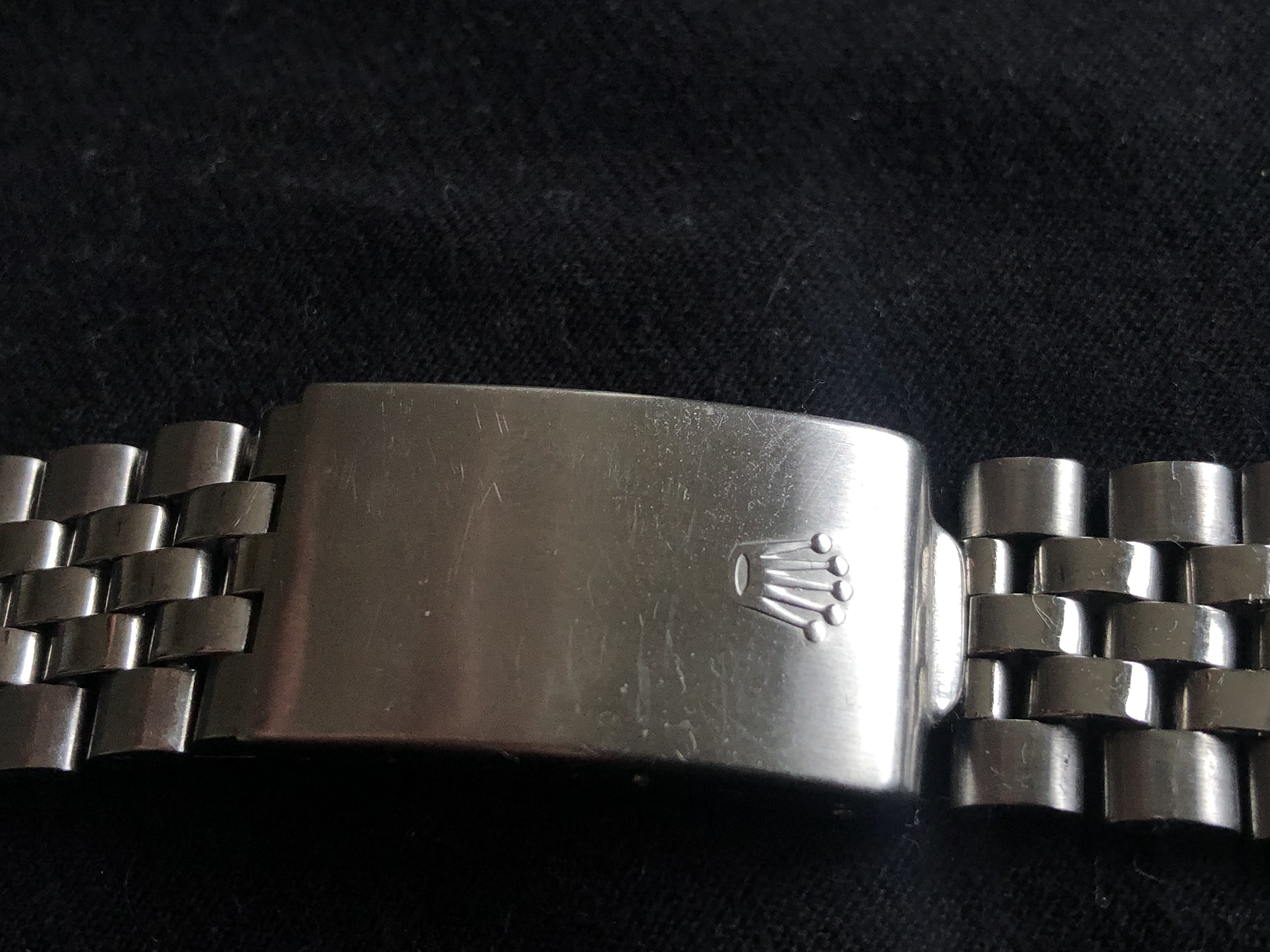

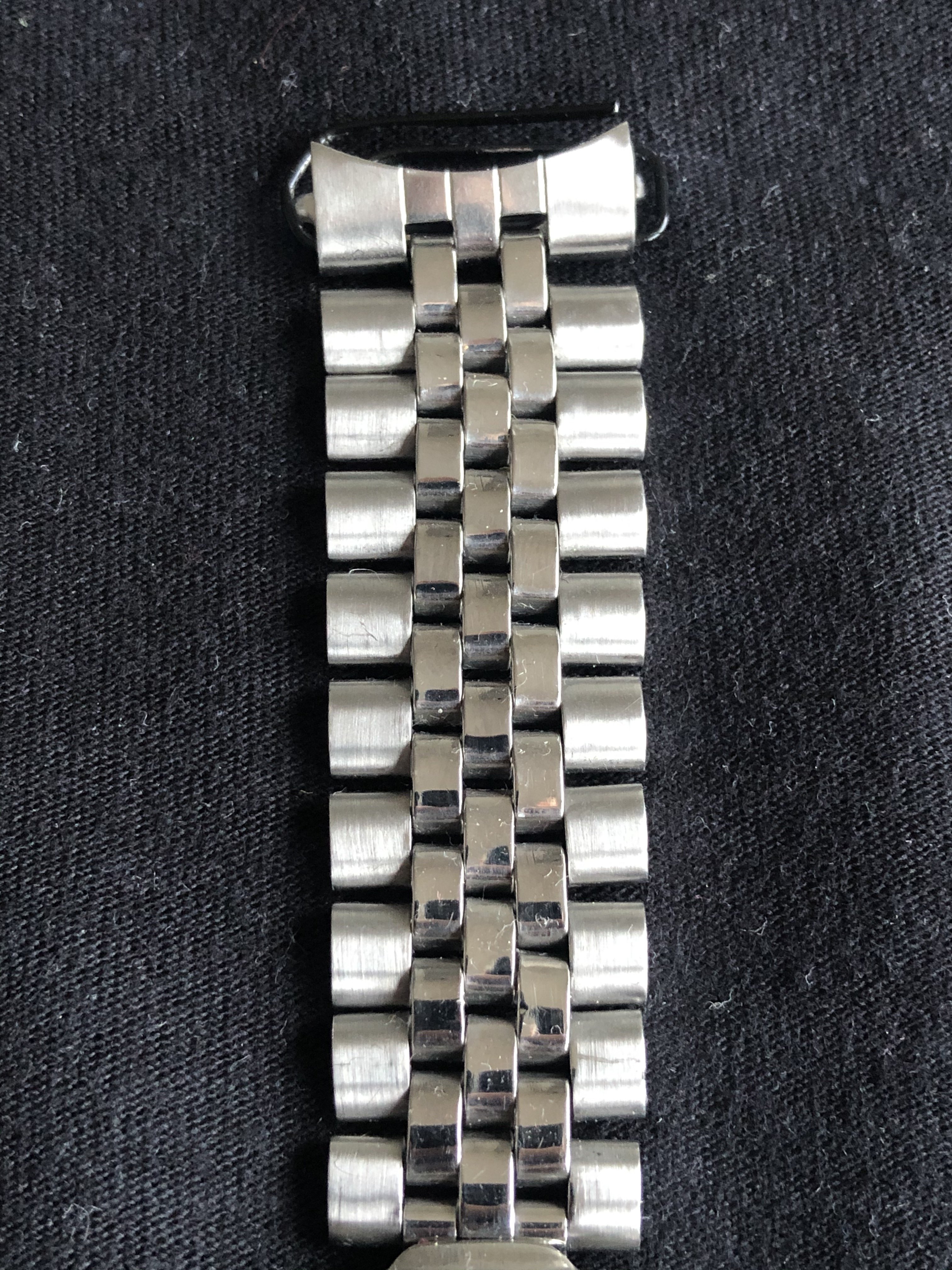

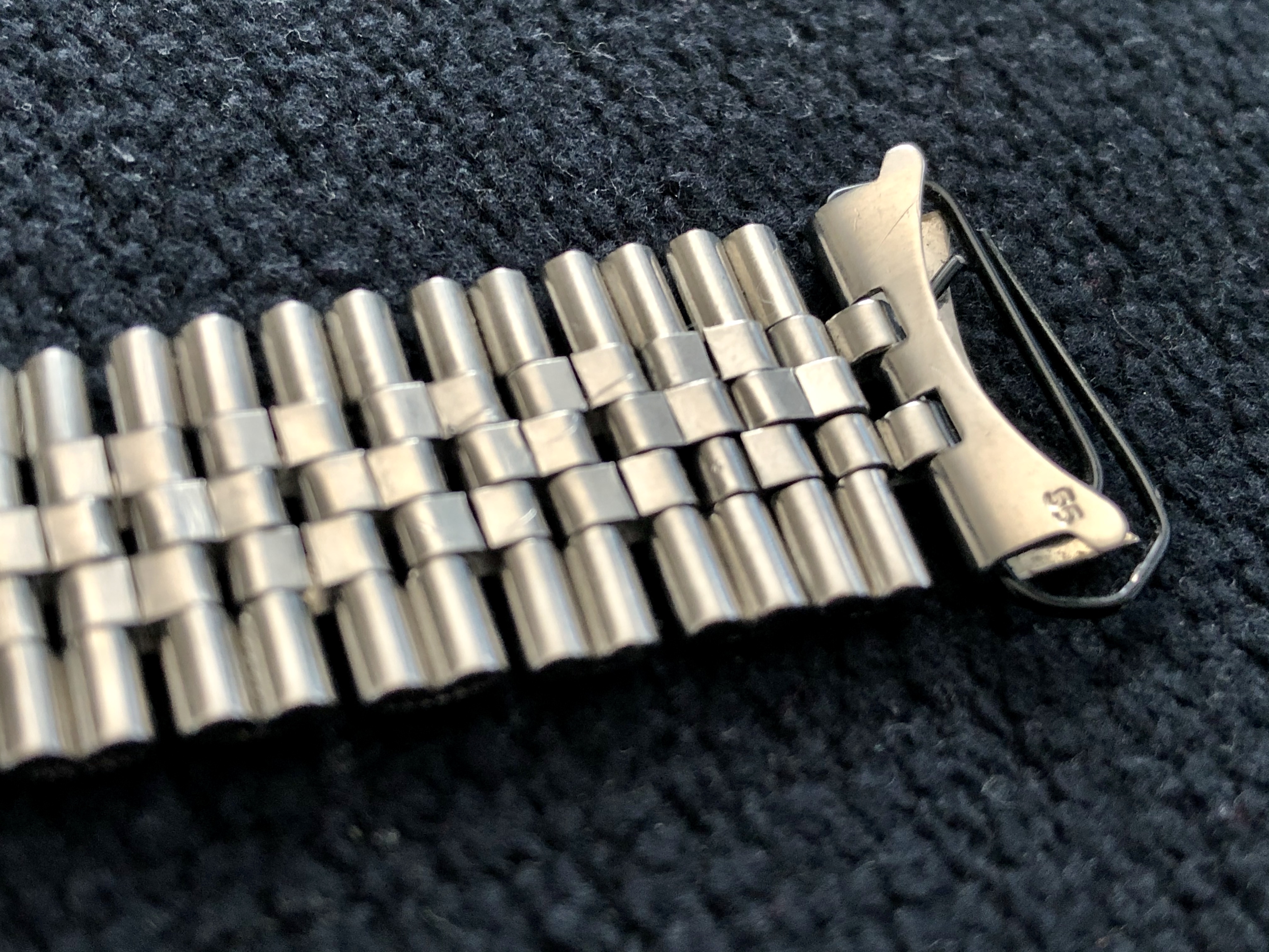

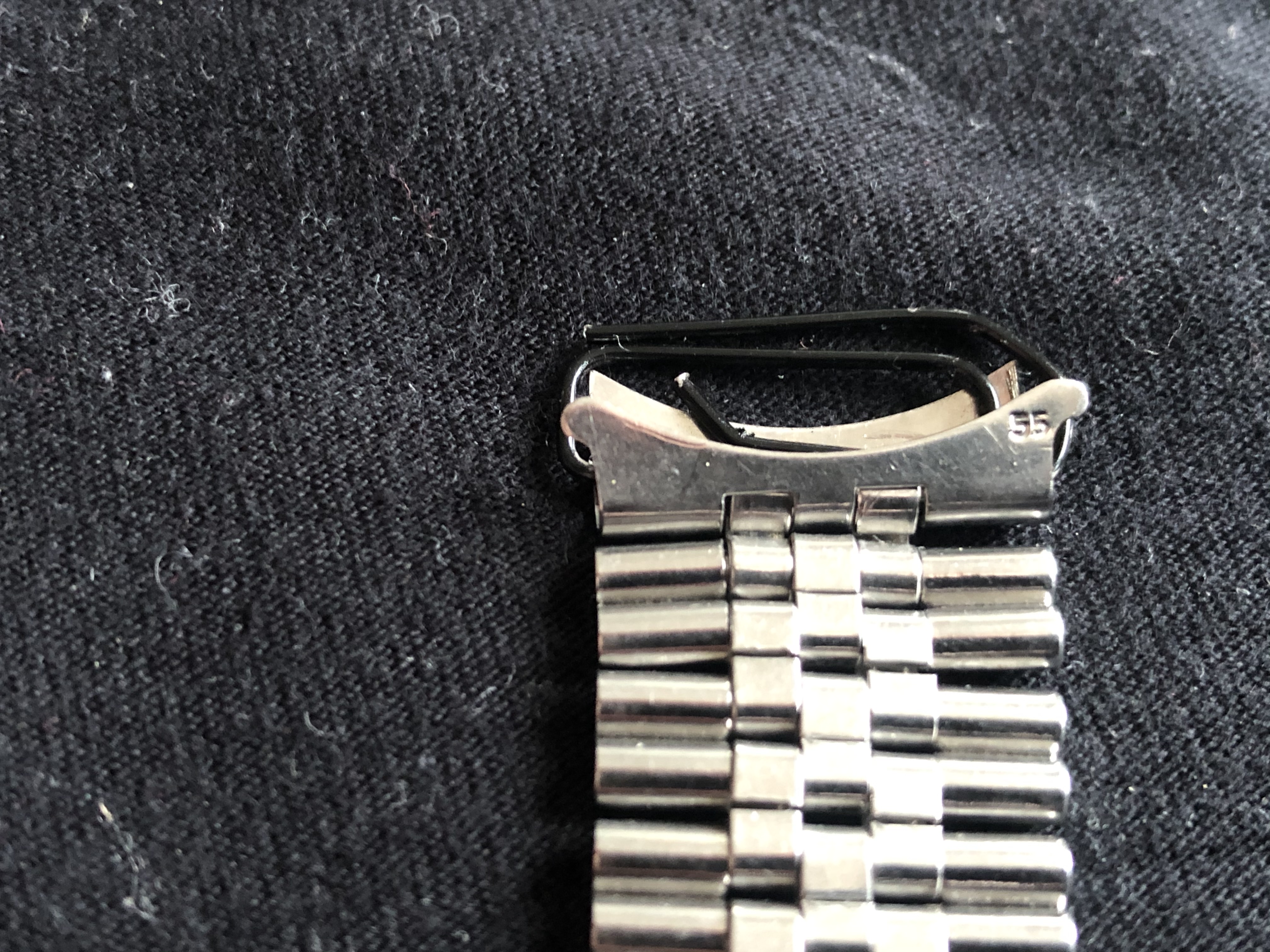

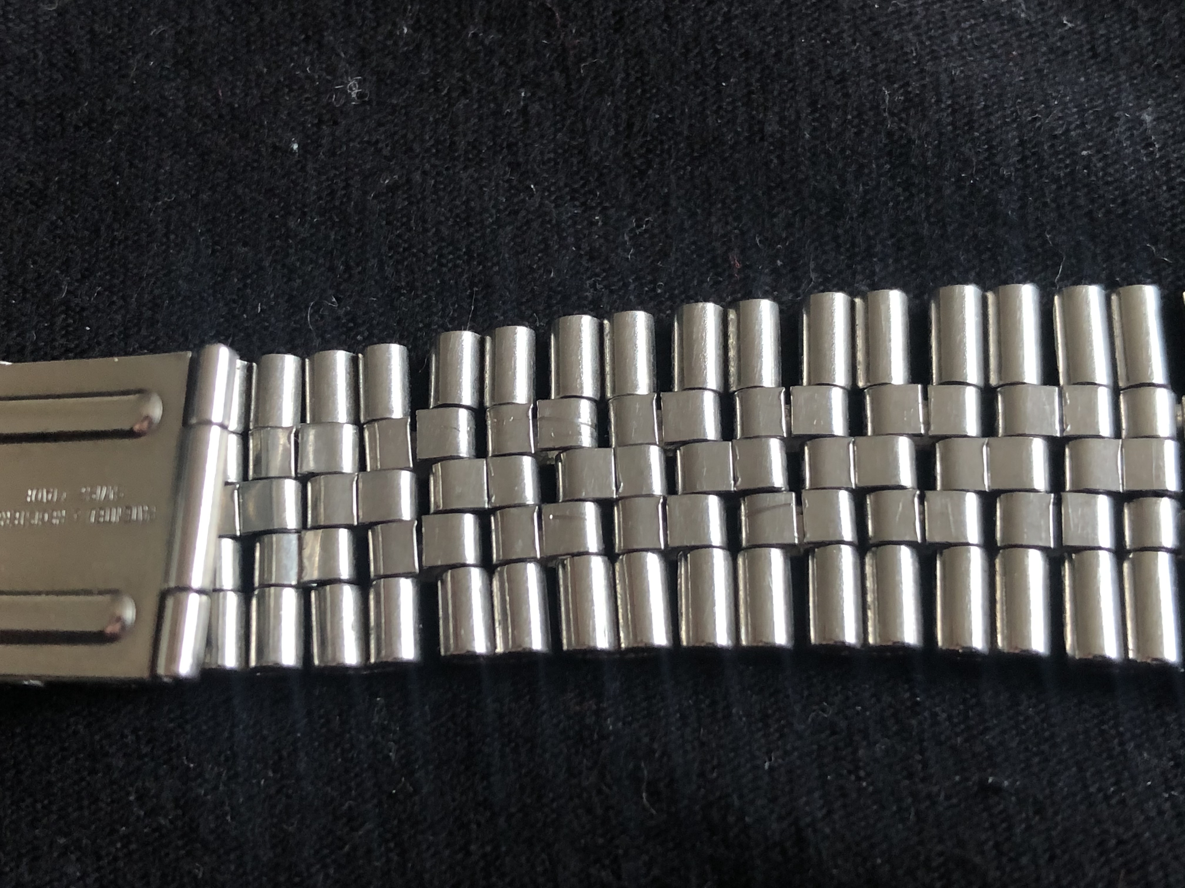

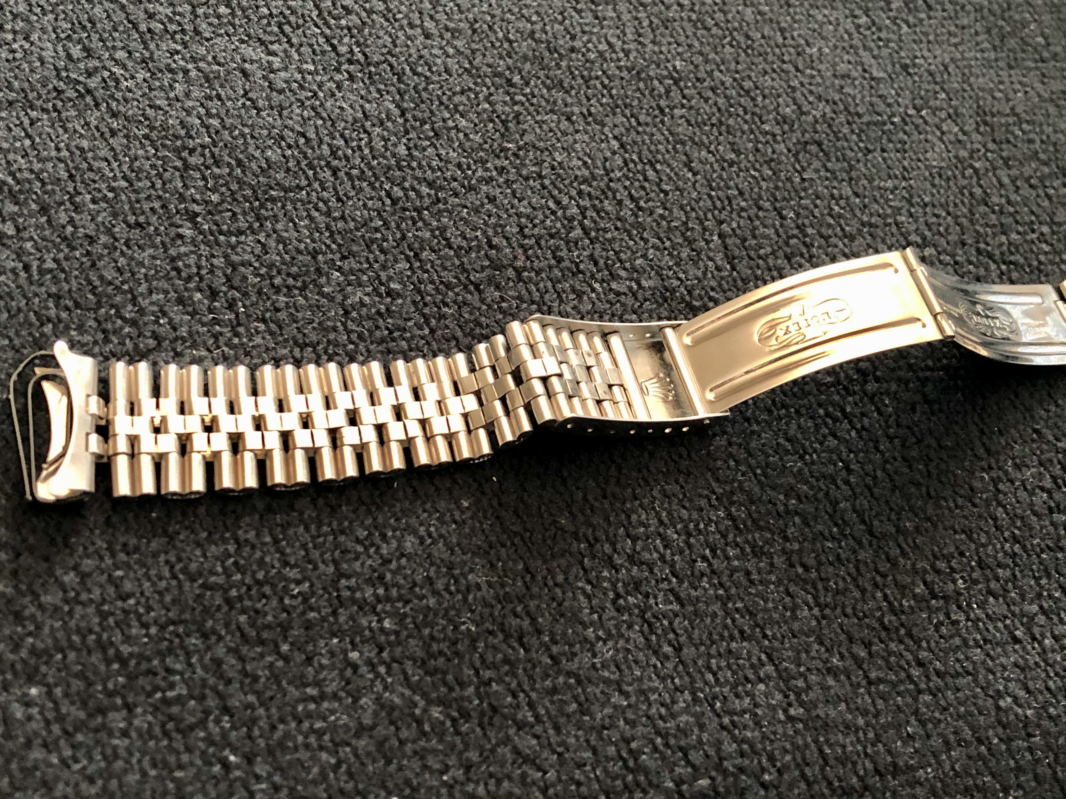

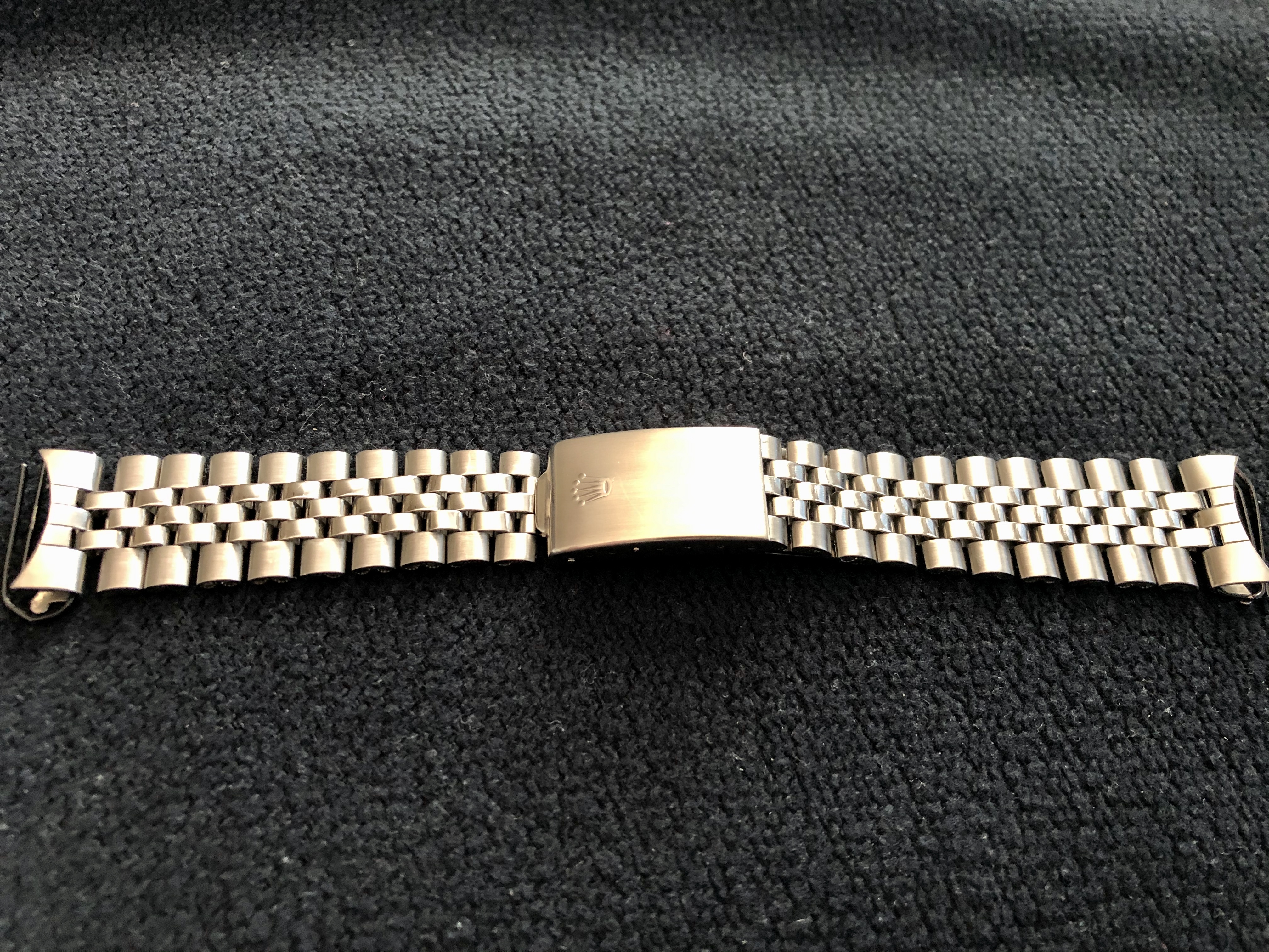

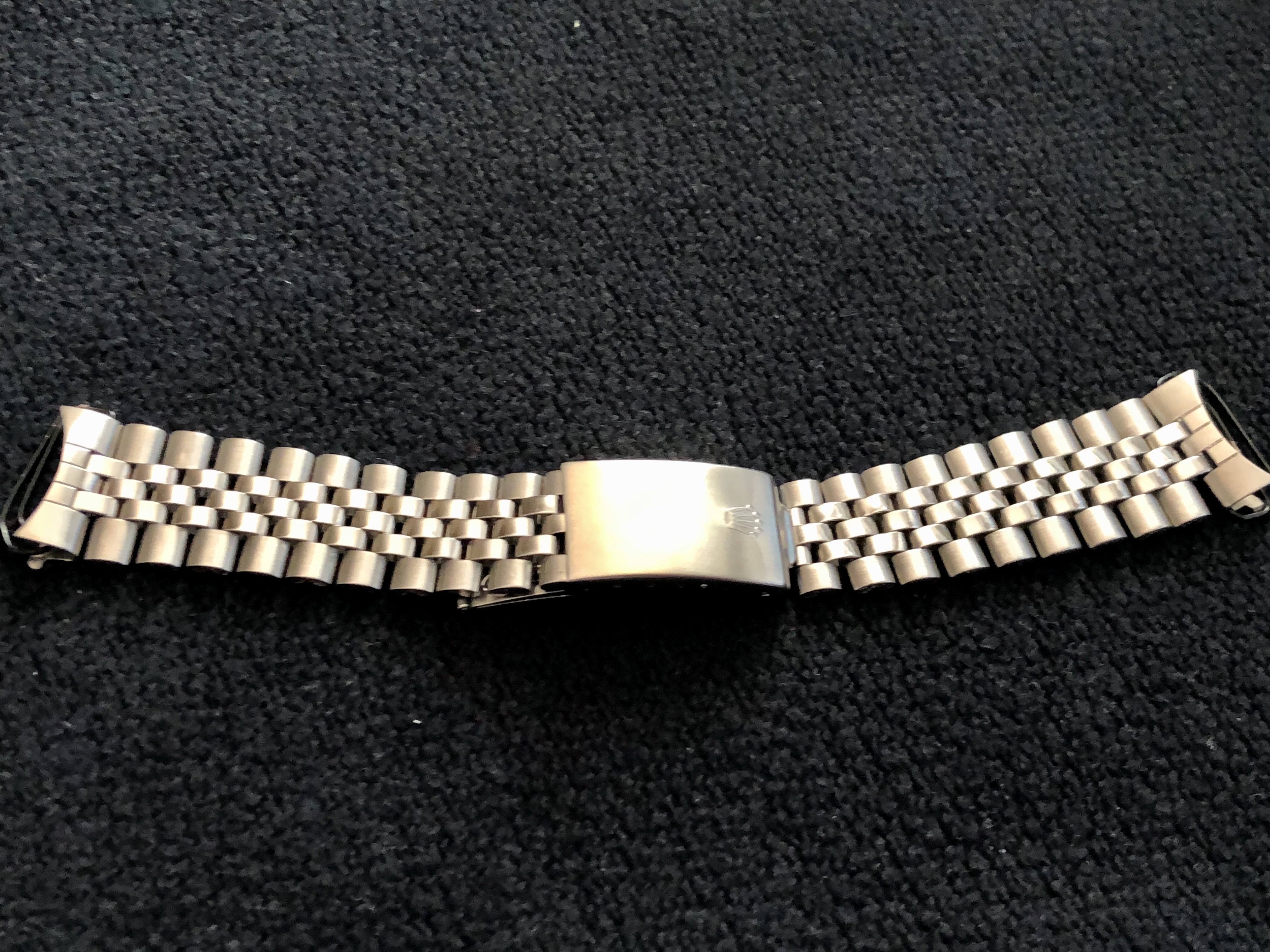

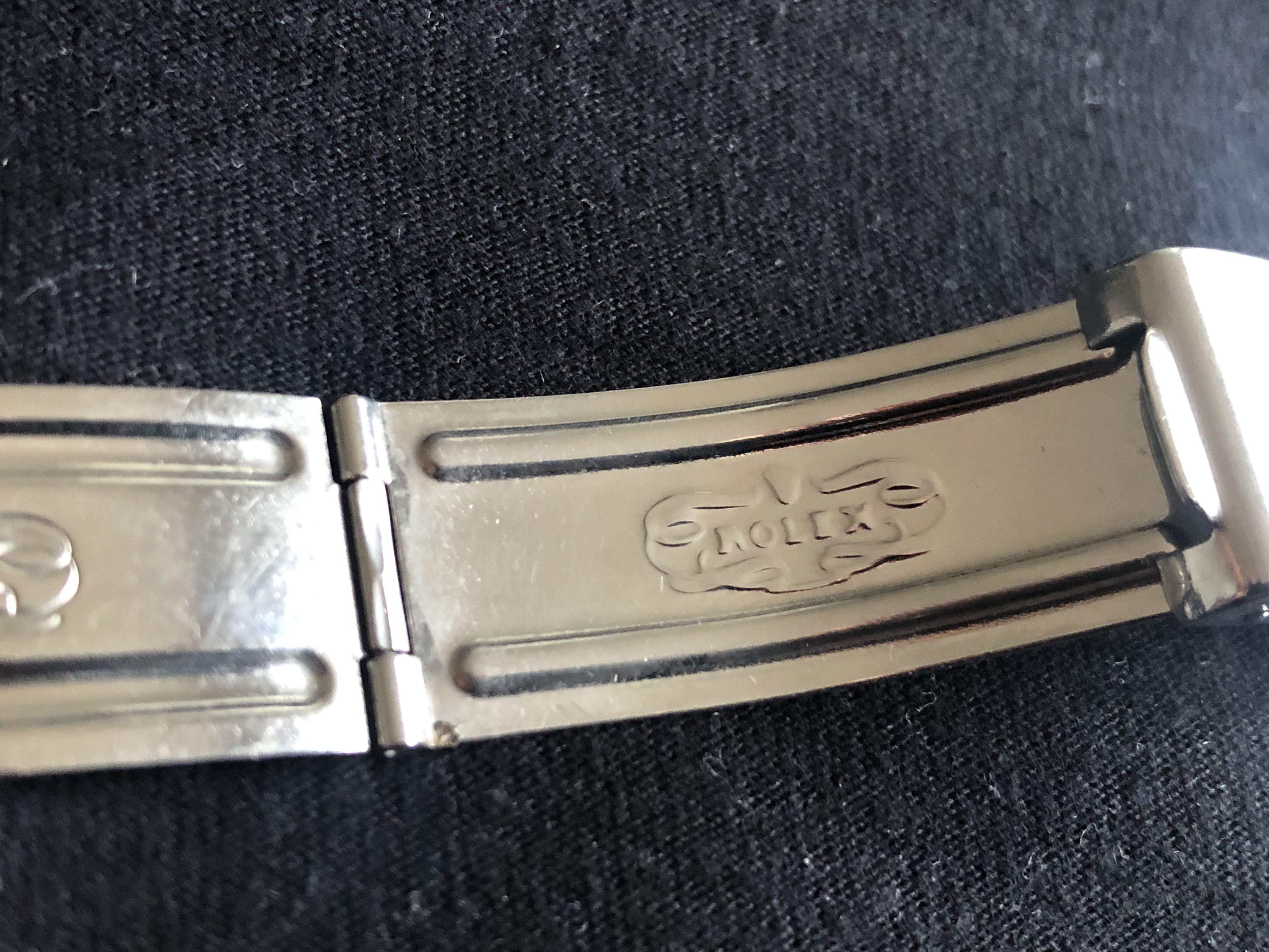

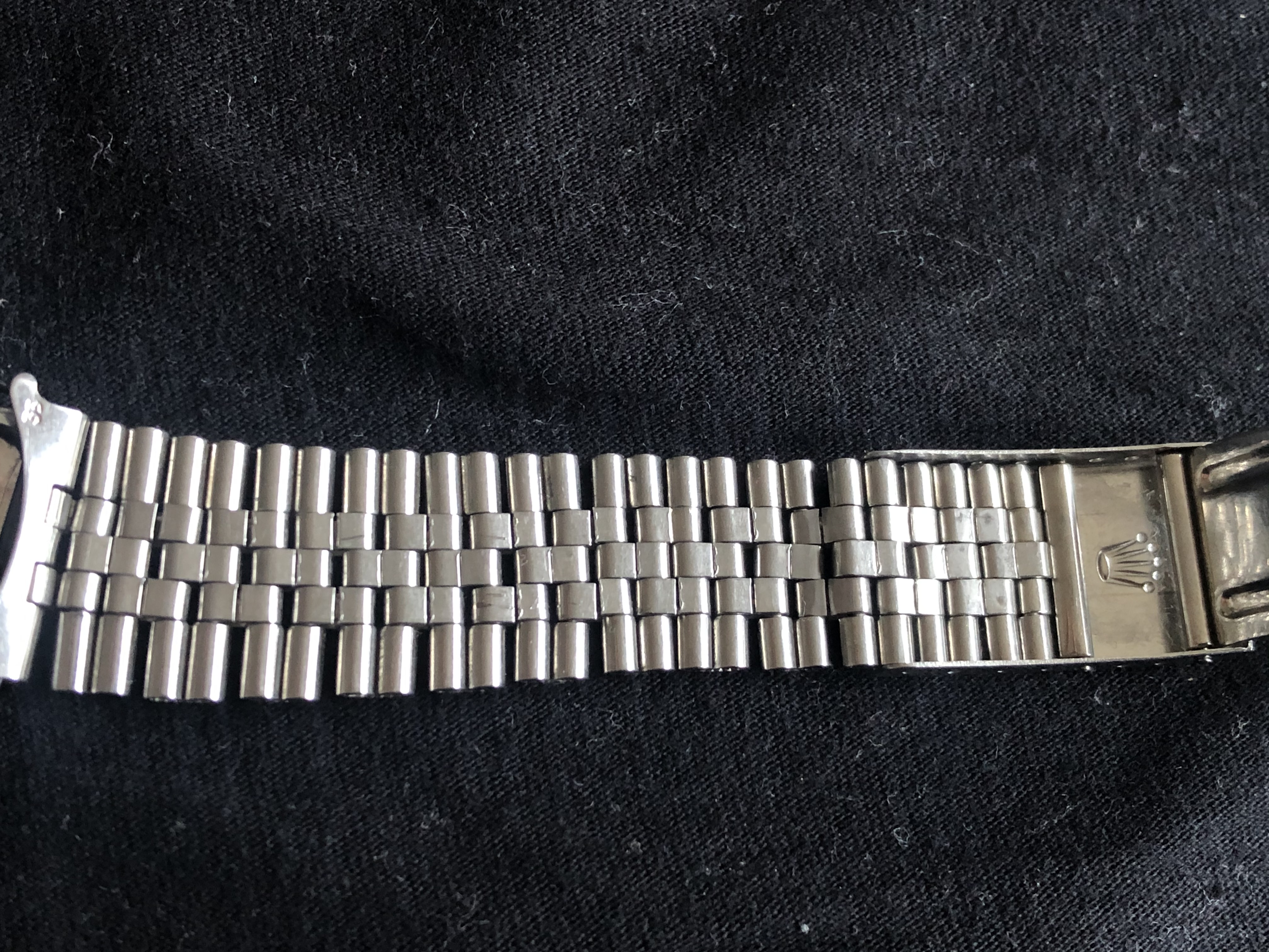

I'm considering purchasing an jubilee bracelet to my 1675 from 1971 - please find attached pictures and if you can tell me what do you think on it? Will be ok for 1675 and what do you think about condition?

The 55 endlinks won’t be a natural fit for the case of the 1675 as they are made for the 36mm Datejust case.
The folded links bracelets are not to everyone’s liking. Many find them too flimsy, rattly and fragile. The condition of that one looks fine enough but expect some amount of “stretch”

A 1675 GMT Jubilee bracelet from that era should have 50 end links fitted. Echo comments above.

As mentioned above, the end-links are not correct for a 1675, but they can be made to fit. It's not possible to judge the condition (i.e. stretch) from those photos, so I would assume that it is substantially stretched.
