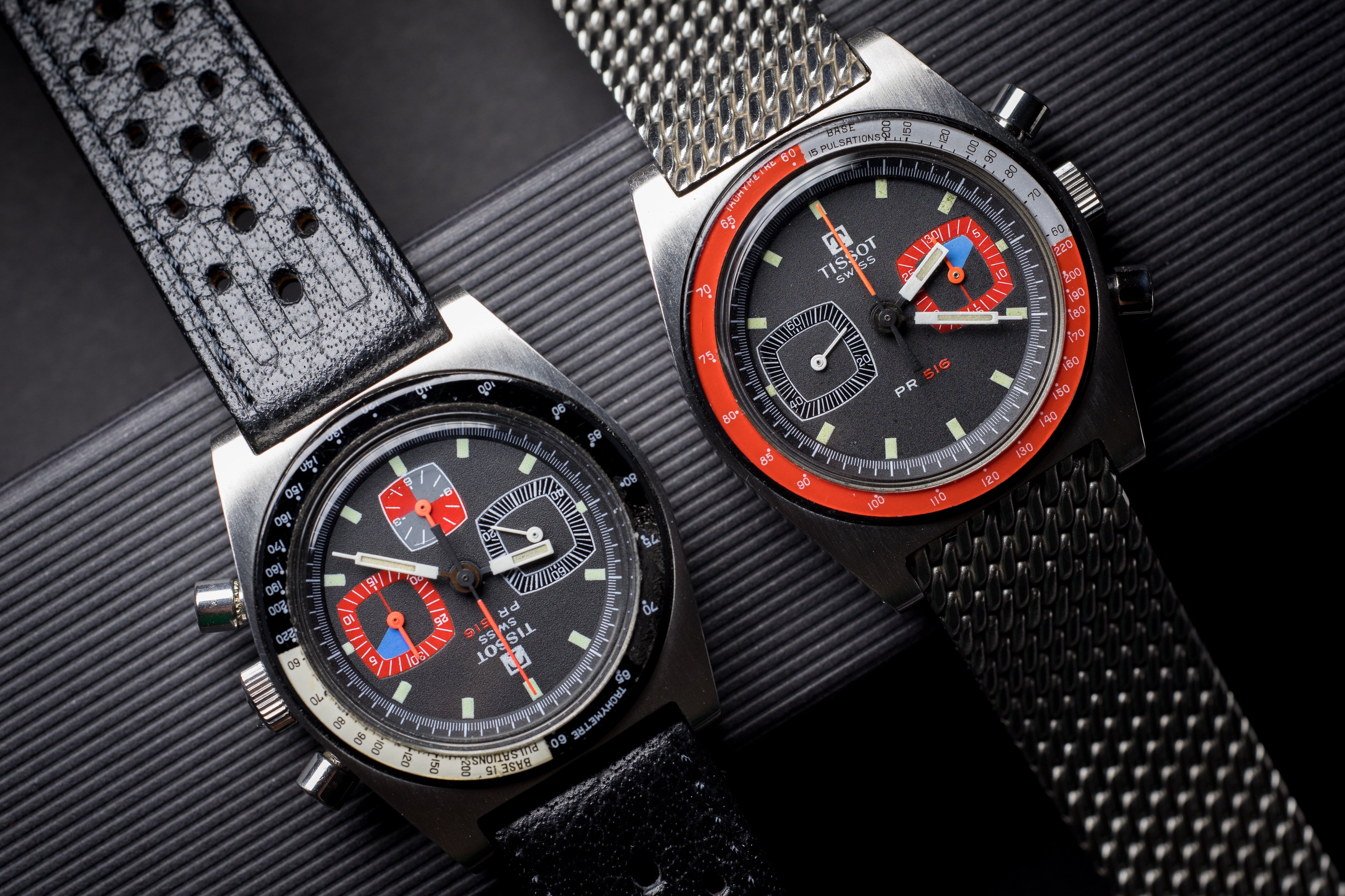

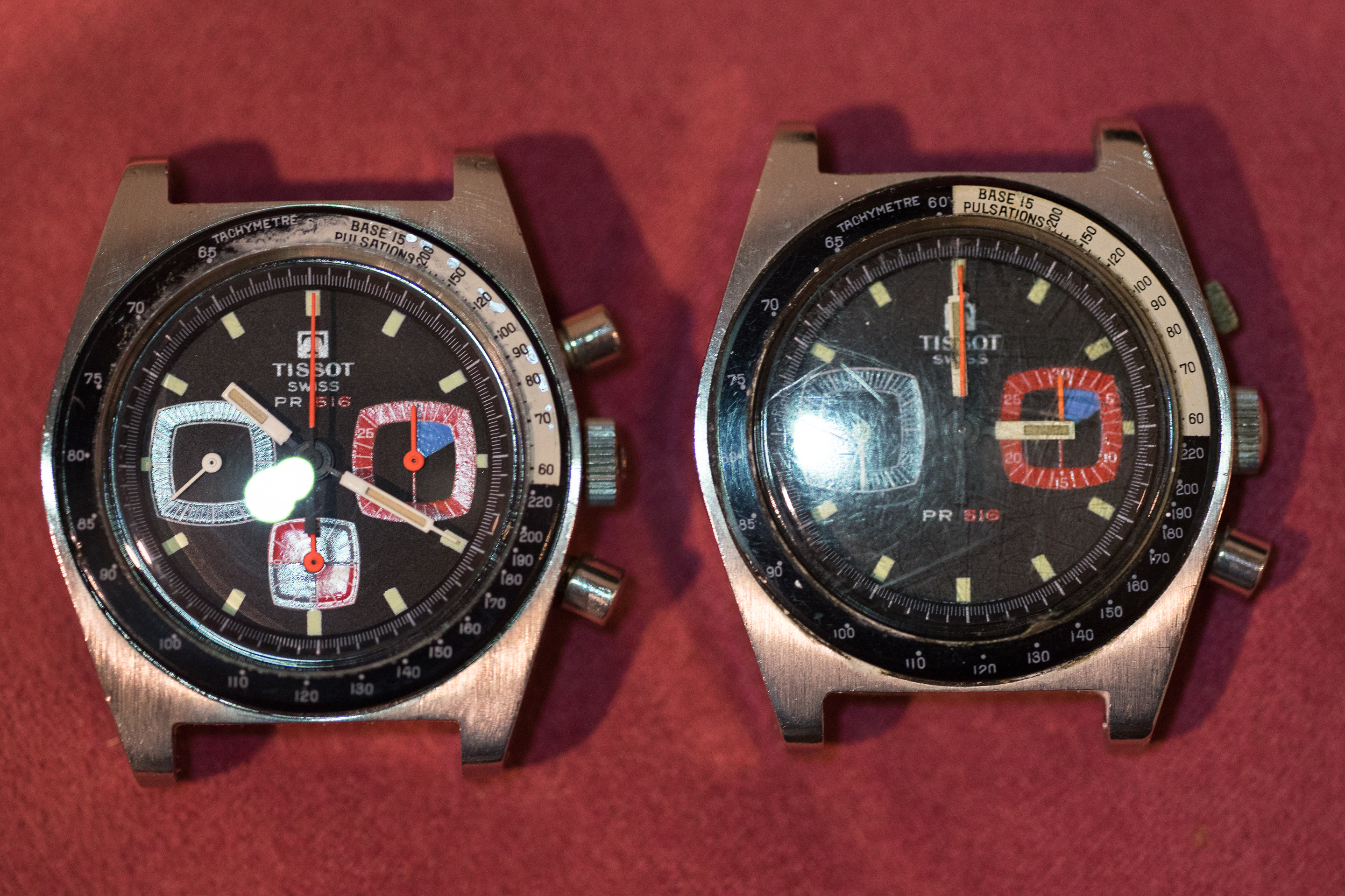

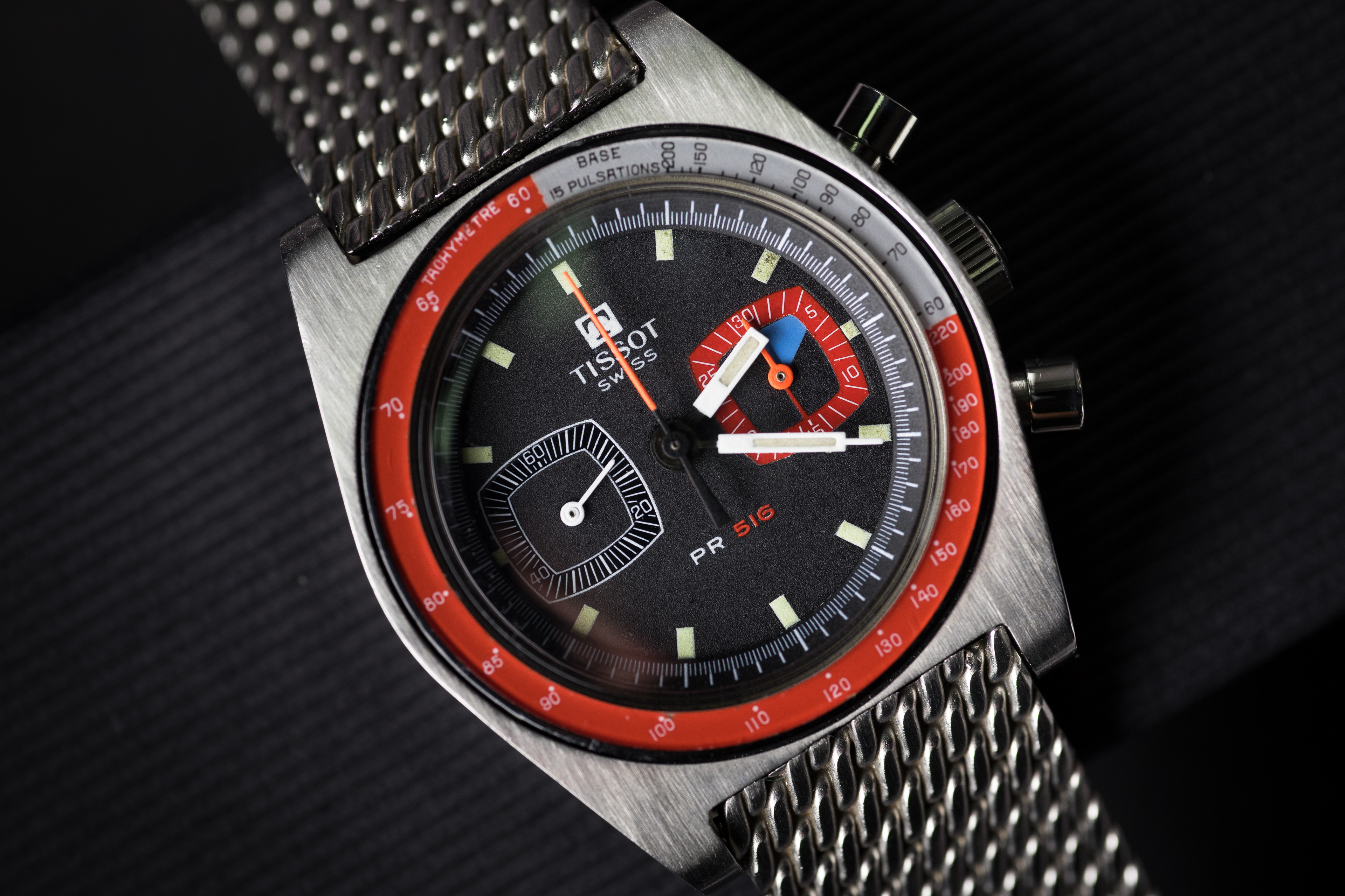

I am planing to restore this pair of vintage Tissot PR 516 Chronographs (sorry for the bad image):
Unfortunately both of them need a new crystal, I know they are super rare but one OF-member told me he probably may have some in his stock. But at first i need to know the part number.
Who knows the part-number for the original Tissot plexi matching Ref 40528-1x / Ref 40526-1x
best regards,
Timo

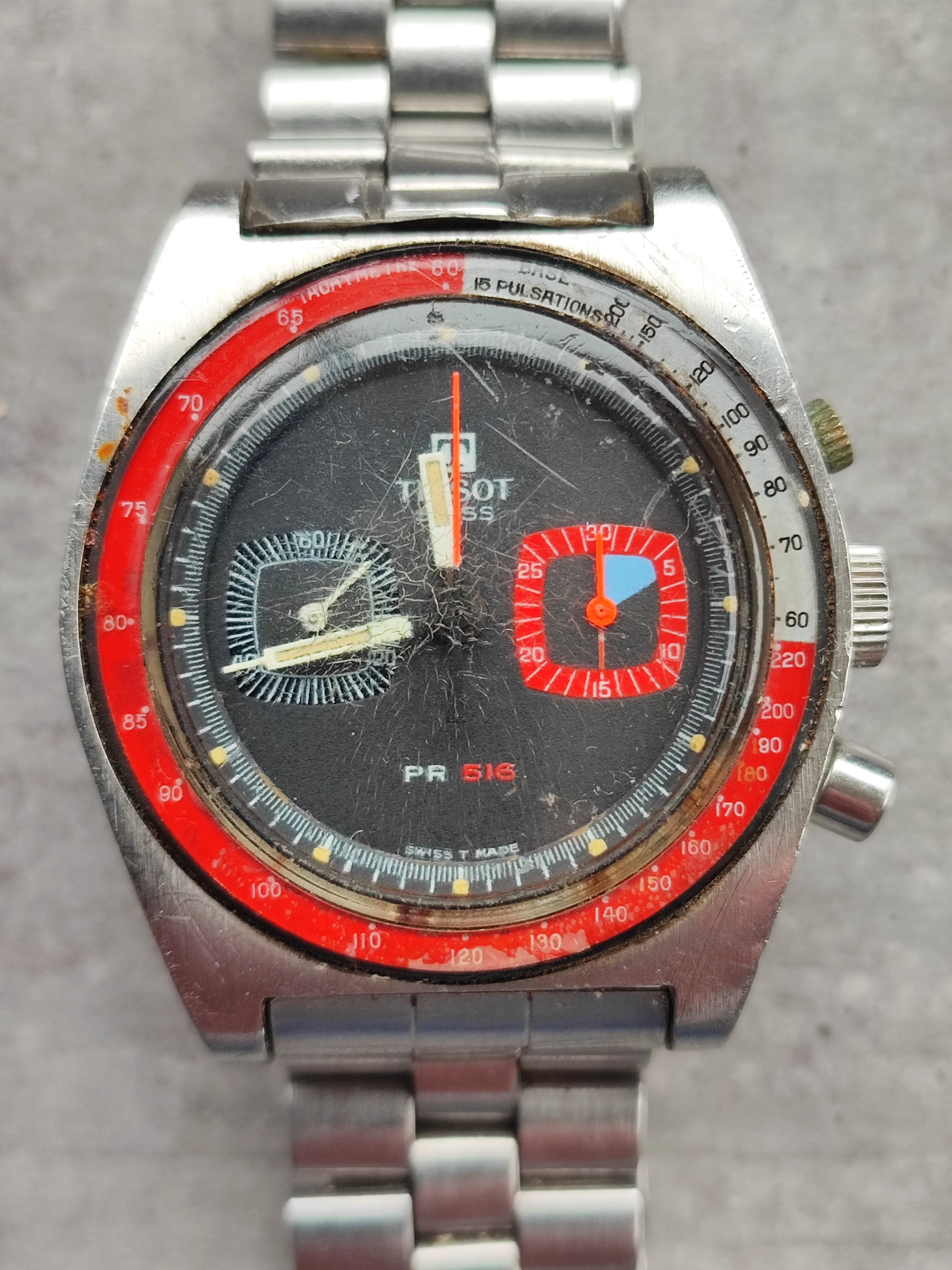

Are the crystals cracked or chipped? You might be able to polish out the scratches with some elbow grease and Polywatch
4,593
10,813
Yes I was also wondering as from the picture I think they are quite salvageable.
69
120
No, unfortunately Not. One is missing an edge, the other one is in better shape but shows some white marks inside the plexi that are under the surface. I believe it has been deformed a bit.
Ofcourse I have already tried to polish it...

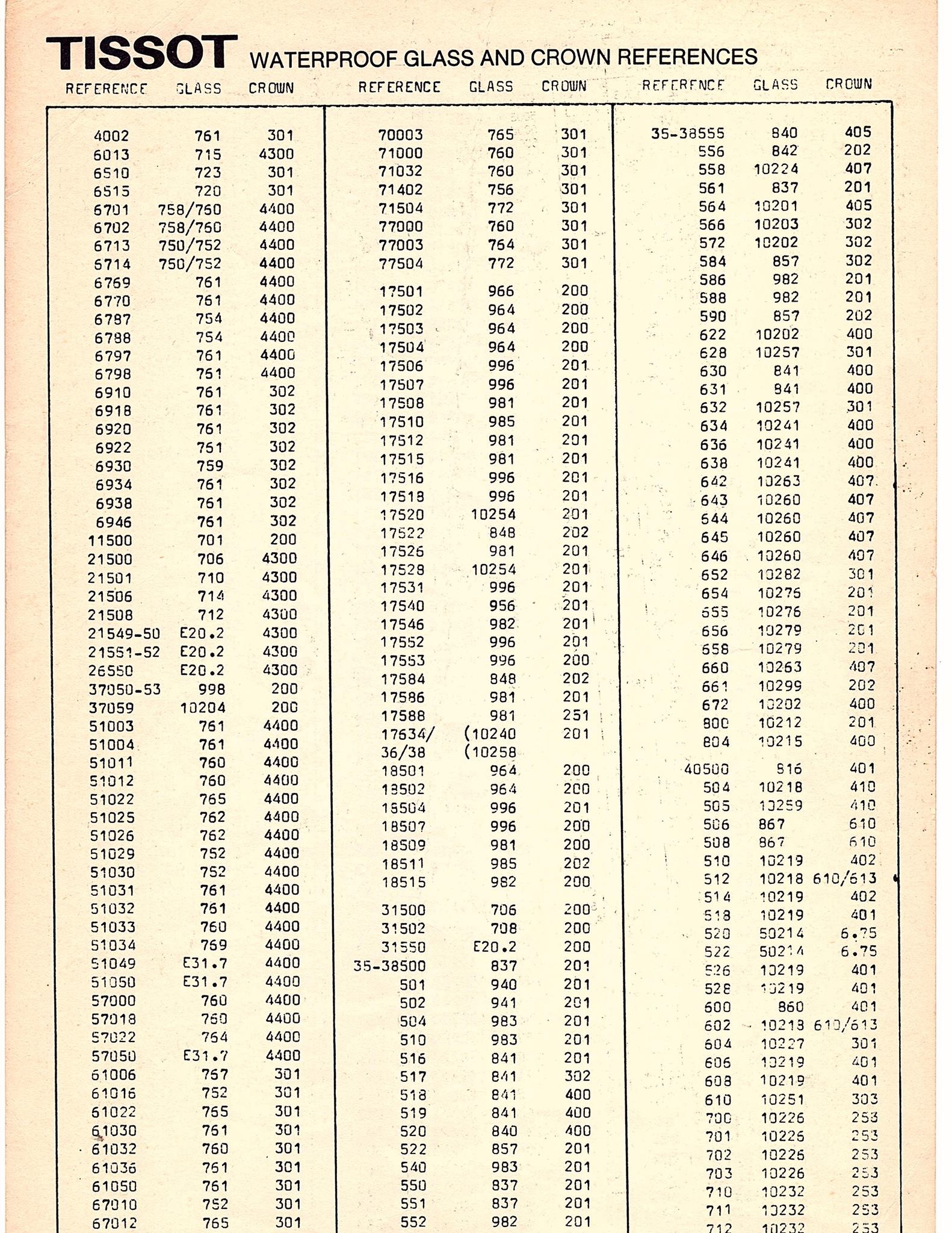

Finding a part number and source for these crystals is a real pain in the arse. It took me two years to get a part number, and then a little longer to find my crystal for the two register model.
I eventually found the crystal by digging around in the back end of the Cousins website. I'll see if I can dig up the info again - it was a couple of years ago.

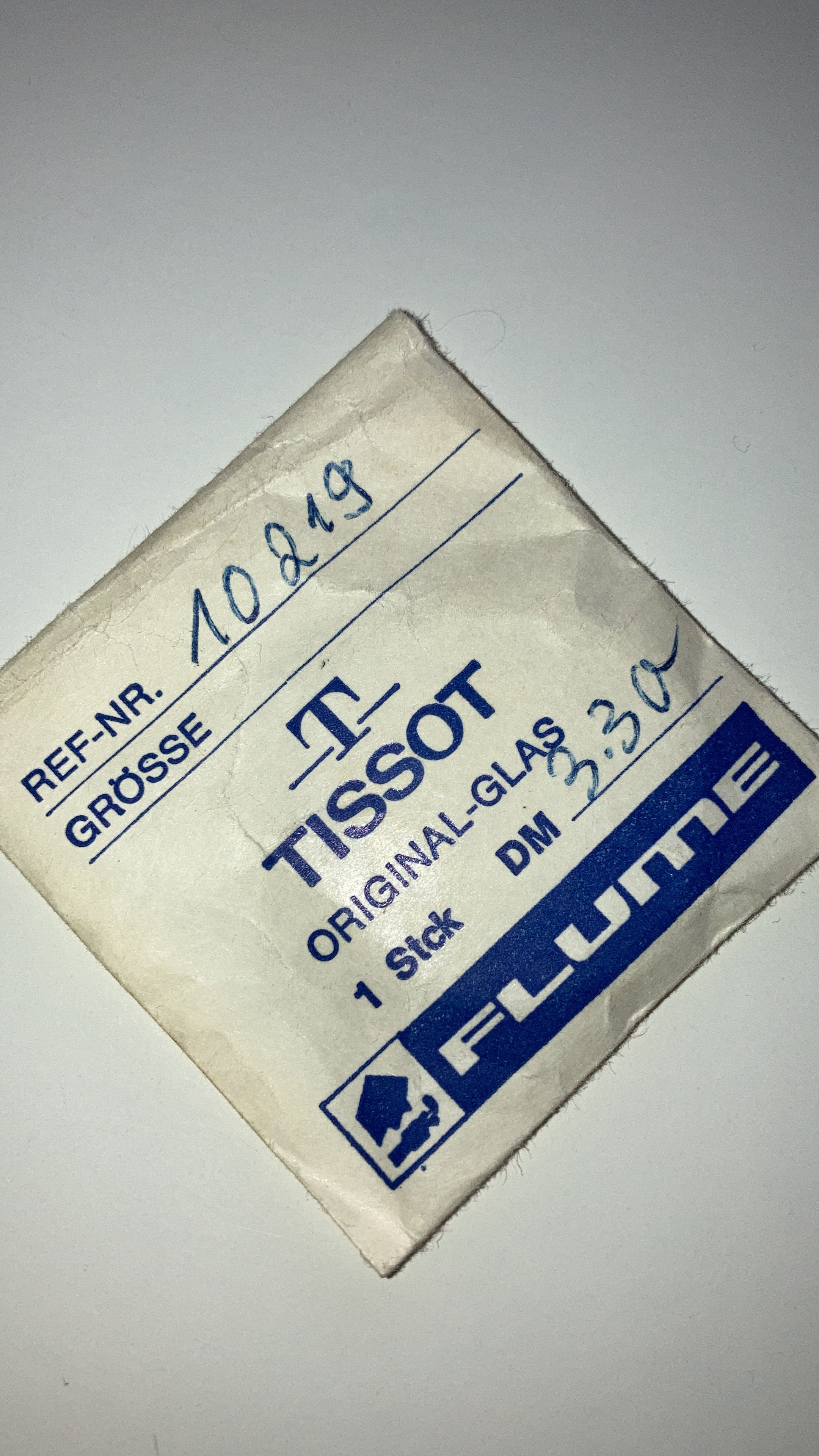

I found one on German Ebay... and to my surprise it already arrived
So I am on the hunt for a second one.

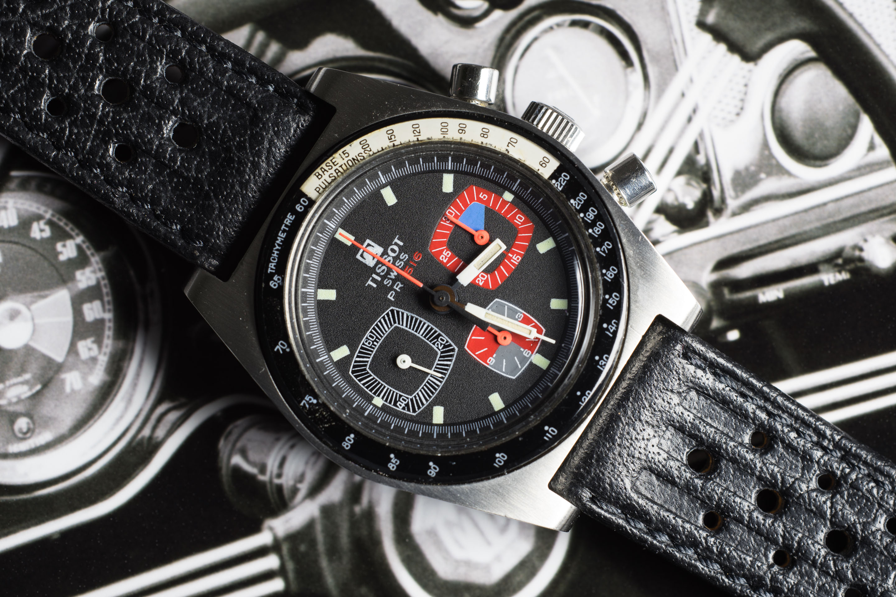

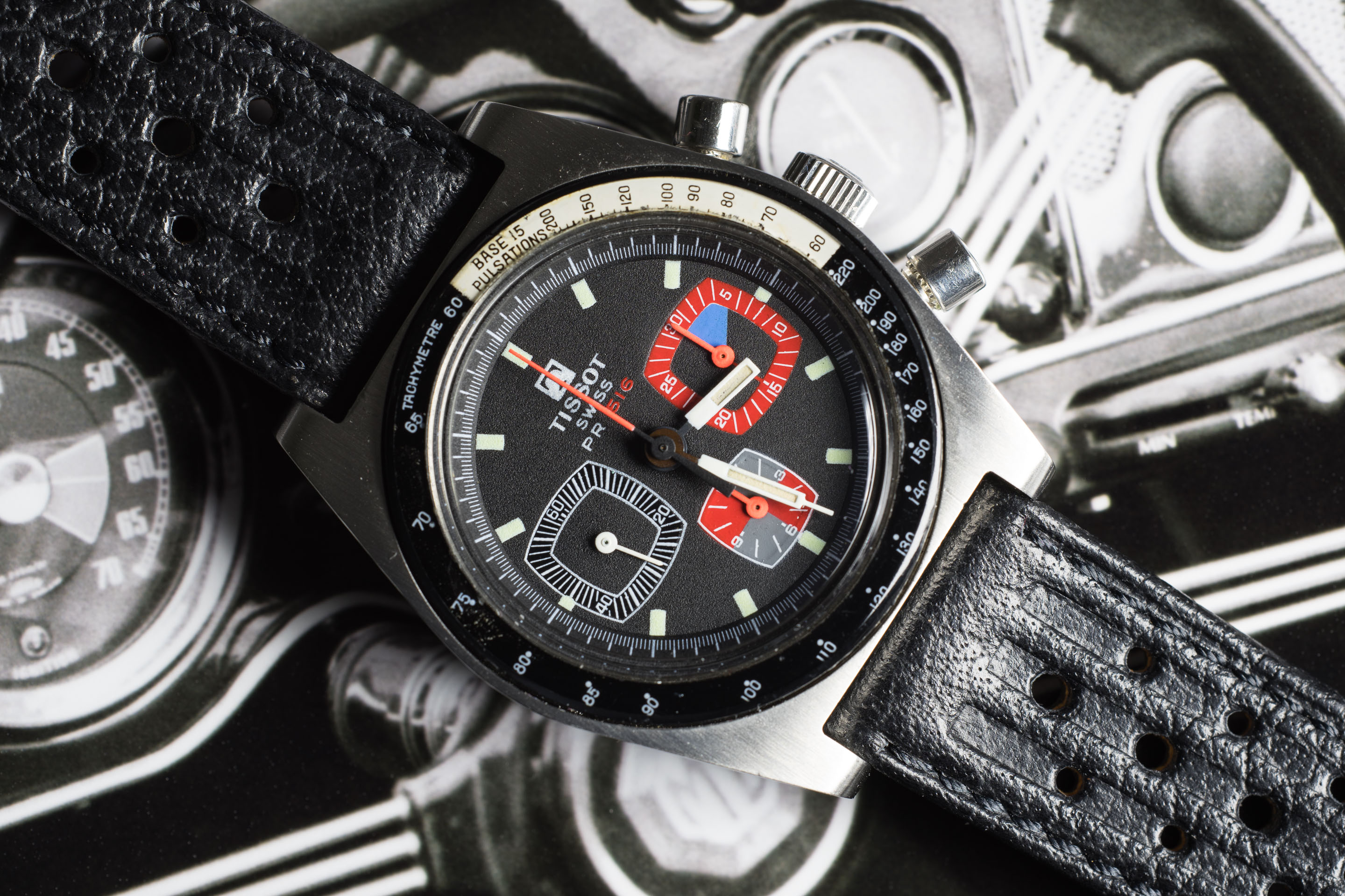

Here we go, the first watch arrived today.
Thanks to Mr. Prenzel for restoring this beauty...

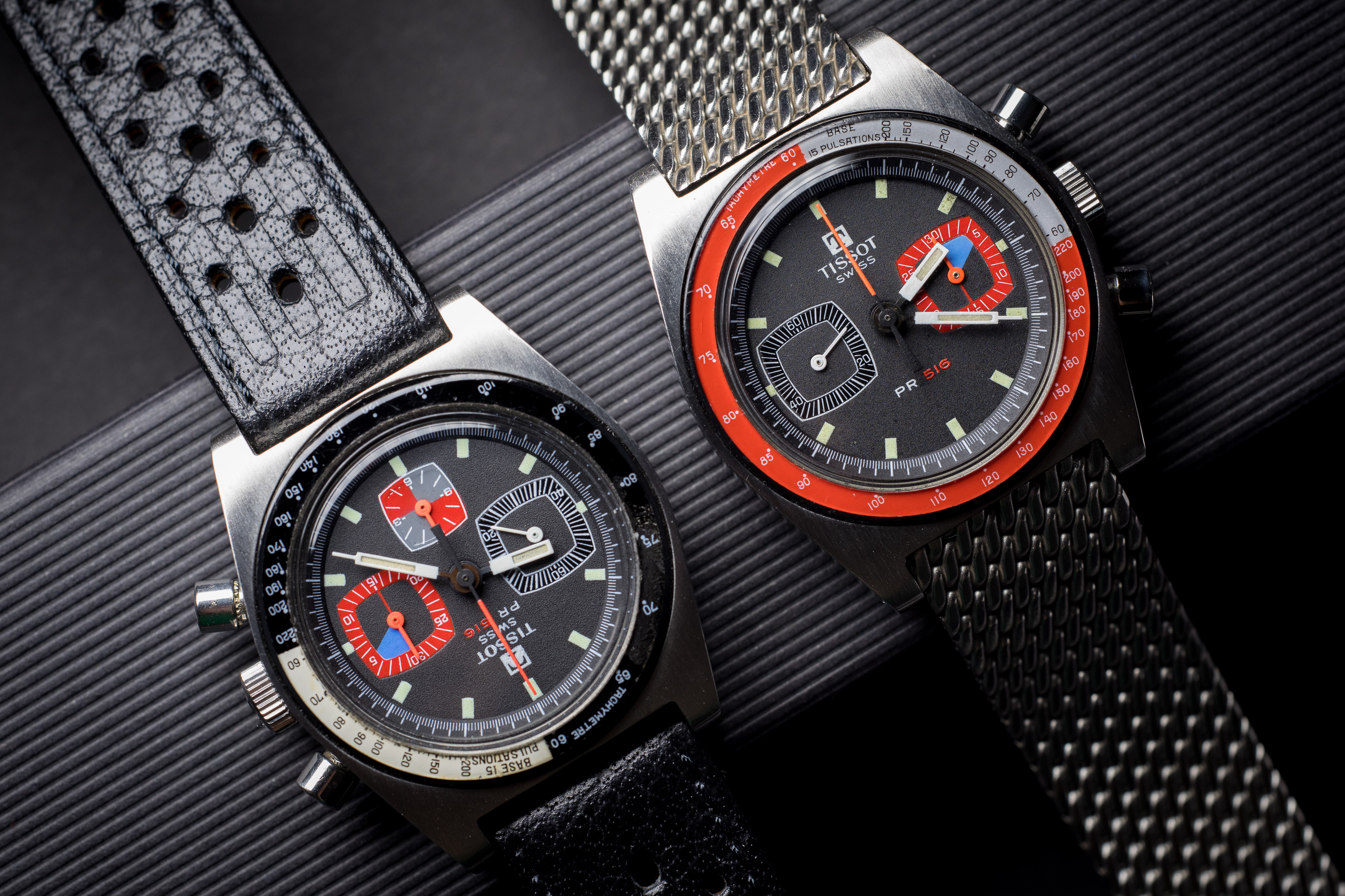

I still love to wear those watches even after years of owning them. I would love to add a see-through caseback to my ref 40528-1x. Any ideas how to get one without sacrificing the original caseback? Will casebacks of other tissot PR516 references fit my watch?
