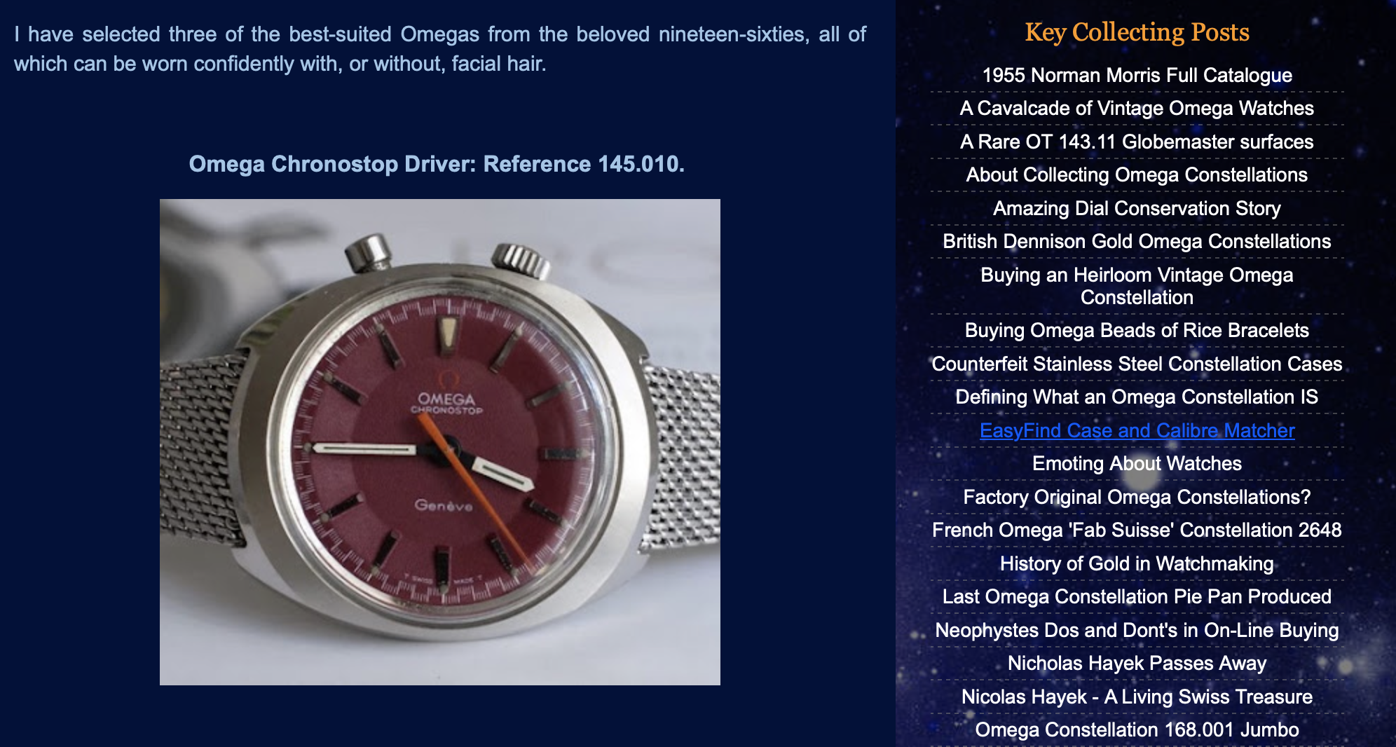

The 'easy find case and calibre matcher' is still working on Desmond's site.

Yes : this list given by Desmond is a real reference for me since the beginning of my Connie hunt ! It is a true help but again does not help to check whether a 564 is legit in a early 70s 168.005 SS case for example. Only option seems to check for further similar combinations on the market as you rightly pointed.
