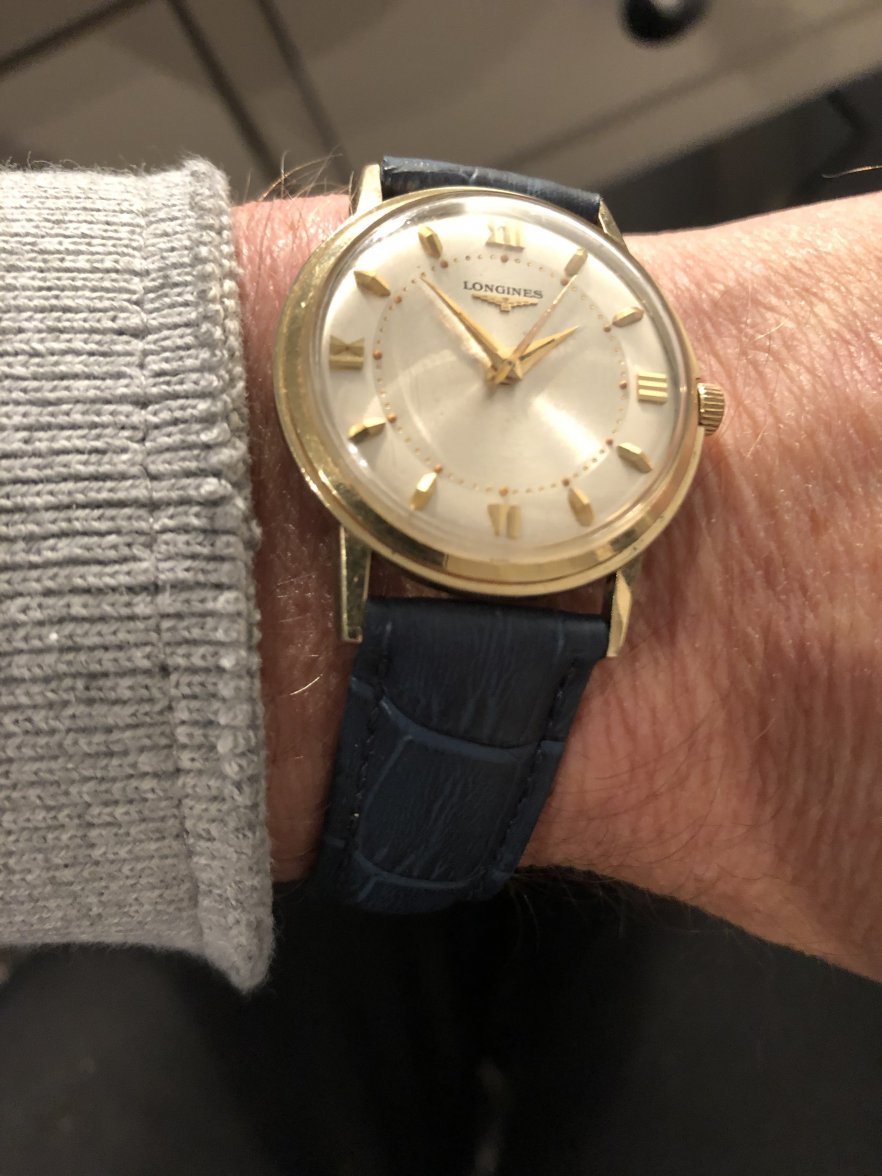

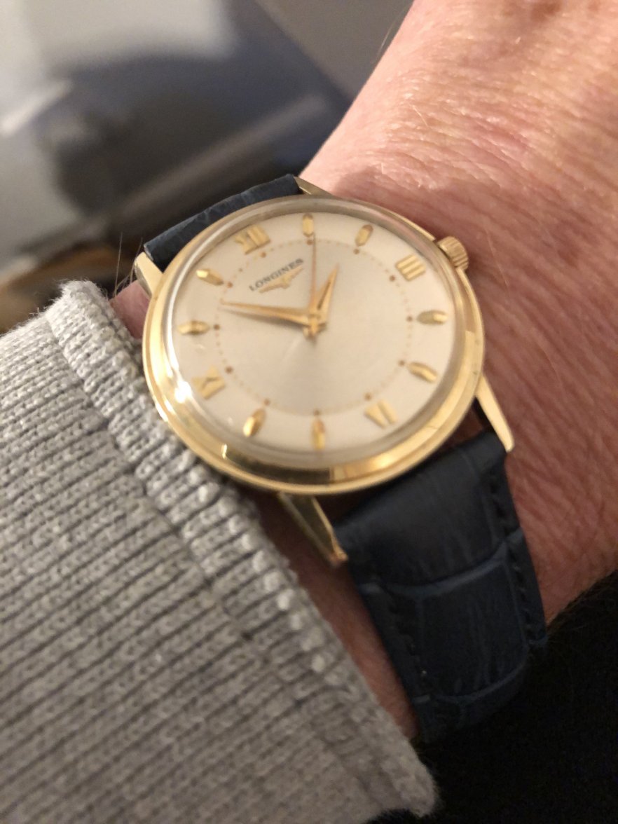

Hi
I have a good looking manual confirmed by Longines to have been supplied to their Canadian distributor in 1957 which looks like a Conquest but others around seem to be automatics
Would anyone know the identity of my watch ?
Any help gratefully received

Hi, surely no Conquest. Could be an american gold-filled case, so possibly no reference inside caseback.
Any further Longines' comments on the Extract?
2,829
4,945

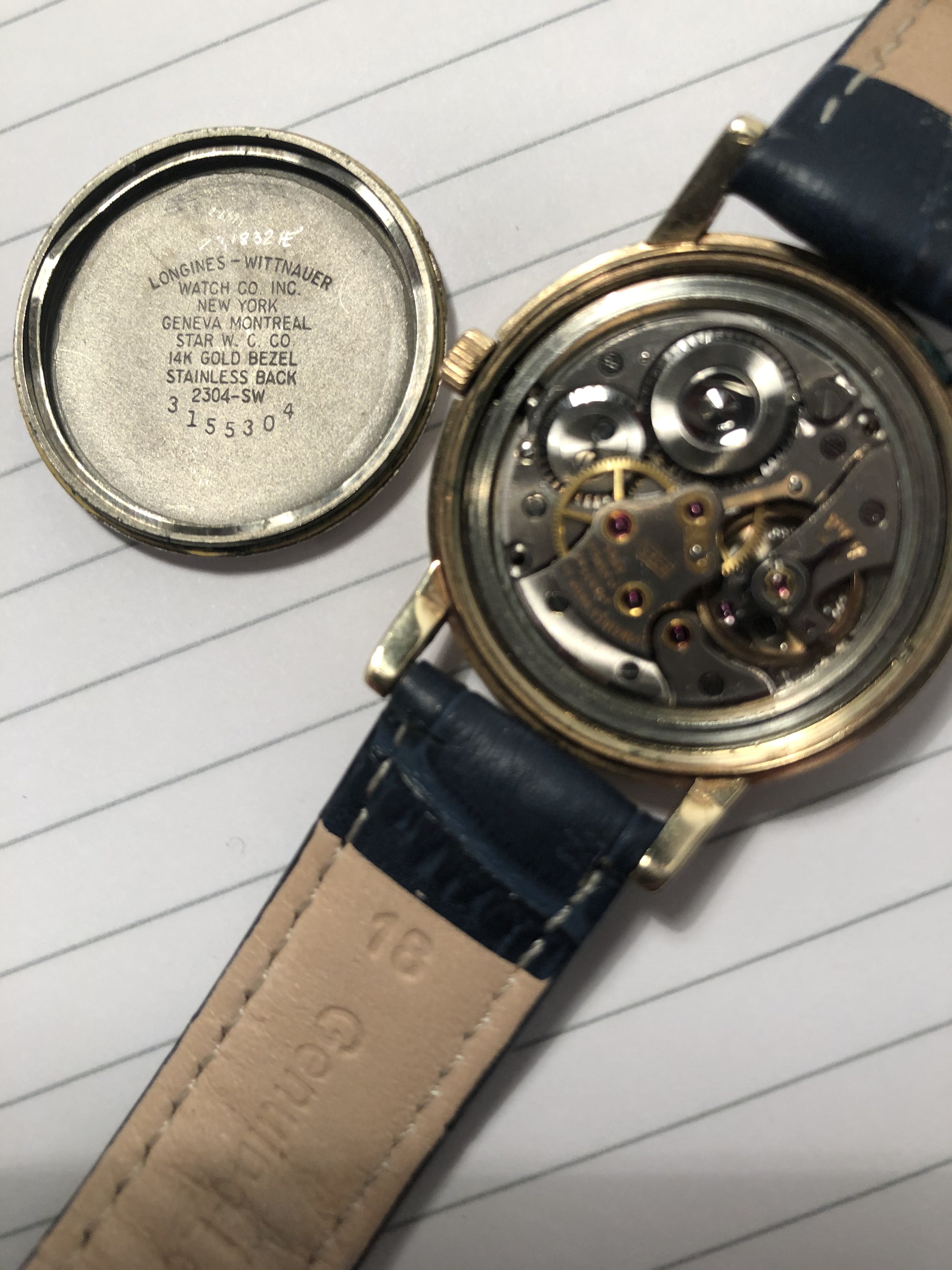

As stated above, this bears no relation to a Conquest. Movement is not automatic (probably a caliber 23ZS), and case is neither waterproof nor Swiss-made. However, it is still a nice piece with those substantial applied markers and a high-quality movement.
Edit: I suppose that the case could have a screw-back but it has no identity in terms of Longines' nomenclature as non-Swiss cases do not have Longines reference numbers. The watch probably does have a name in an American catalog.

Reference number is strange to me
Bezel is marked as 14k
2,829
4,945
The case was made in the USA by Star Watch Case Company and the movement is a 23ZS. Non-Swiss cases have no Longines reference numbers.

Love the black and yellow graphics. Thanks for posting this, Tony!
374
344
Beautiful. I love the stylized numerals at 12, 3, 6 and 9. I have a few with the inner ring. Such a great design. It seems wonderfully indulgent to not have the hands go closer to the edge.
