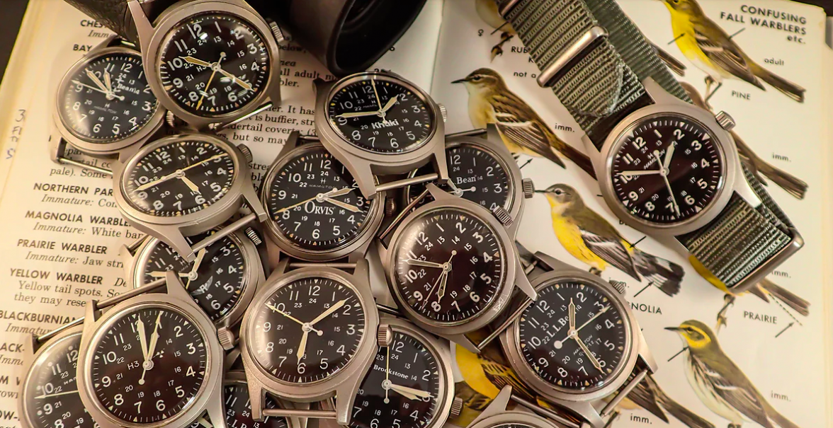

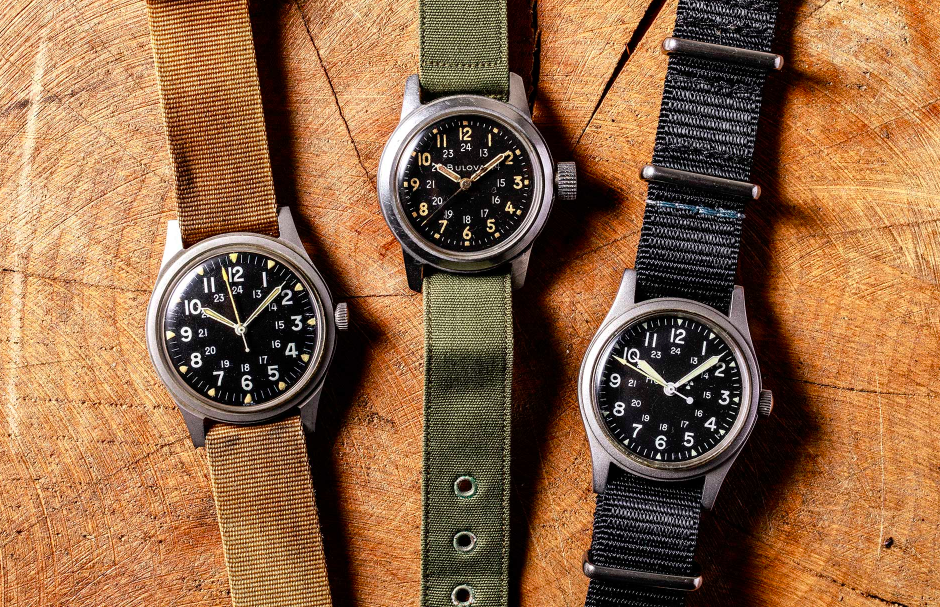

    Hi all, I'm a hiking and outdoor enthusiast who recently picked up a G-Shock for use in the field but I'd rather wear a vintage MoD or mil spec issued watch by Hamilton, CWC, Benrus, Precista etc. like a MIL-W-46374, GG-W-113, G10, W10, DTU-2A/P etc.
    Here's the problem - I need the watch to be water resistant for light water activities (rain, brief submerging of water in creeks and rivers, etc). The watches I've listed are required per mil spec to be water resistant at least for these kinds of activities.
    So 2 questions:
    1) can these vintage watches be used for these kinds of activities without replacing the gaskets/O-rings?
    2) how difficult would it be to restore the water resistance to mil spec? would I have to get the exact same gaskets, O-rings, replace the tube for the crown etc?
    And pics because all threads need pics:
    Screen Shot 2019-02-26 at 11.29.26 AM.png Screen Shot 2019-02-26 at 11.31.44 AM.png Screen Shot 2019-02-26 at 11.34.56 AM.png

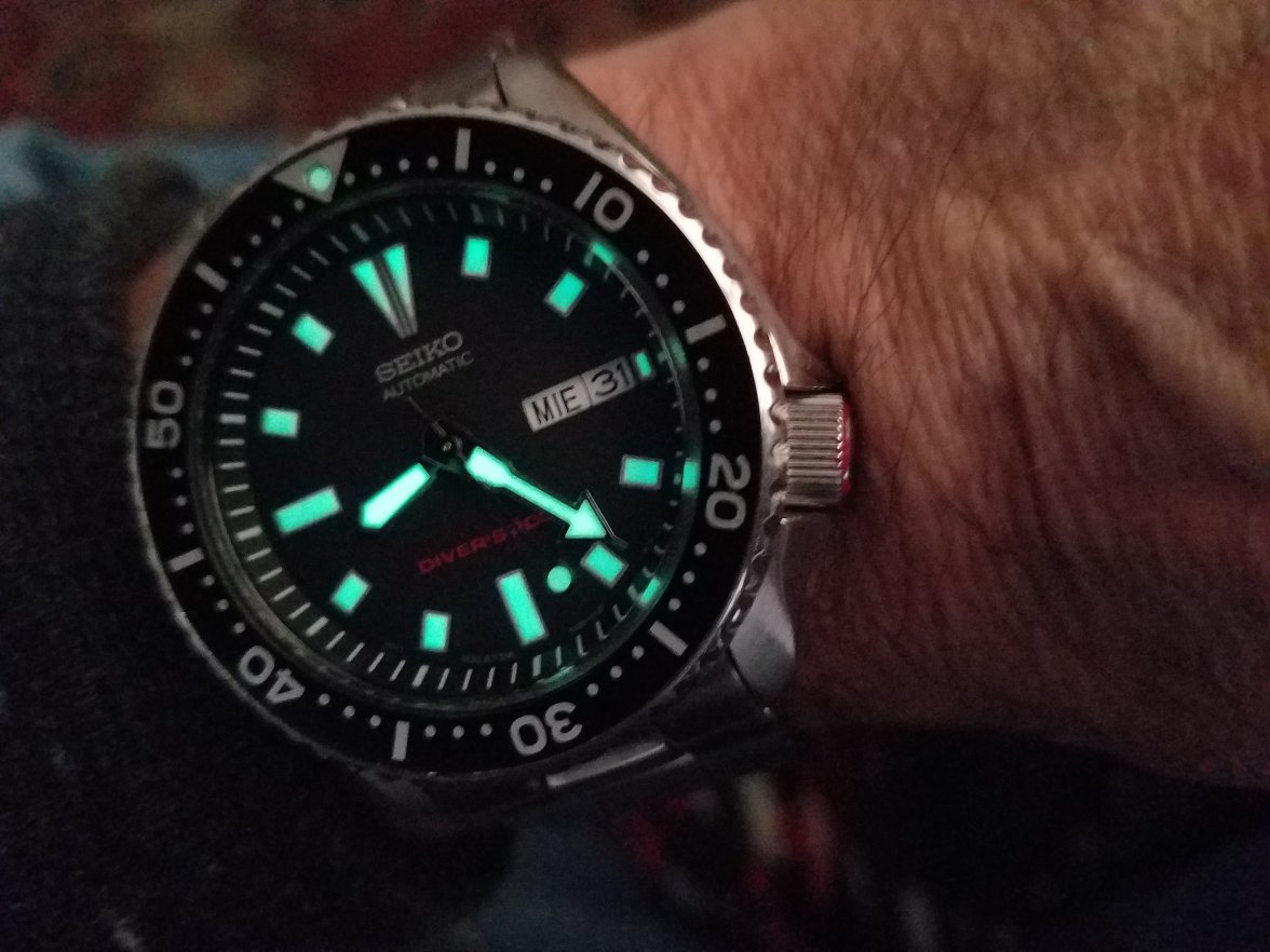

    I understand the urge of using a field watch for what it was designed for but frankly, it is quite simpler to buy a 10-100$ waterproof quartz for the outdoors. A seiko SKX might also do the trick for some more. They glow at night, they are almost disposable. For me, in most cases, a good dependable WR means a modern/new watch. Keep it simple.

    +1 20180313_072951.jpg 20180122_142407.jpg have fun

    SKX is my field watch. I work in the field daily.
