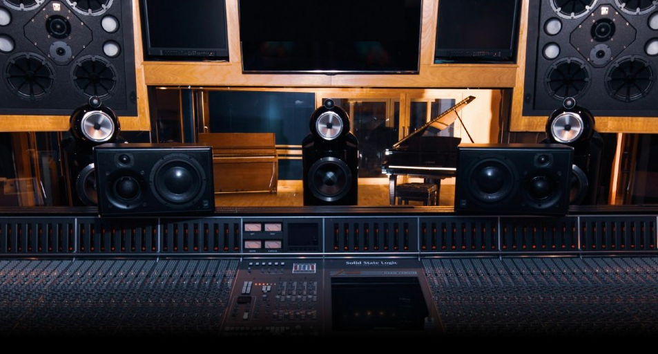

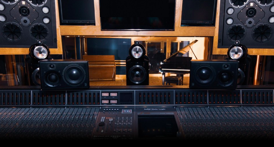

I work in music and am in recording studios packed with powerful monitor speakers almost every day.
Never had a problem. Have a few friends in that circle who are also watch nerds and haven't heard of them having any issues either. Every single one of these speaker cones has a big fat magnet behind it!
50
46
SSL, B&W?
Yep... not my photo (it's a composite) from a certain well known studio I've had the pleasure of recording in London, St. John's Wood 😉
The magnetic effect falls off really fast, so I would have no issues in that room. Placing my hand right next to the cone of a speaker for more than a few seconds then I would be worried.
50
46
You're right just being present in the room shouldn't cause any concern but we are constantly patching and moving speakers around etc... nevertheless I've never experienced any problems.

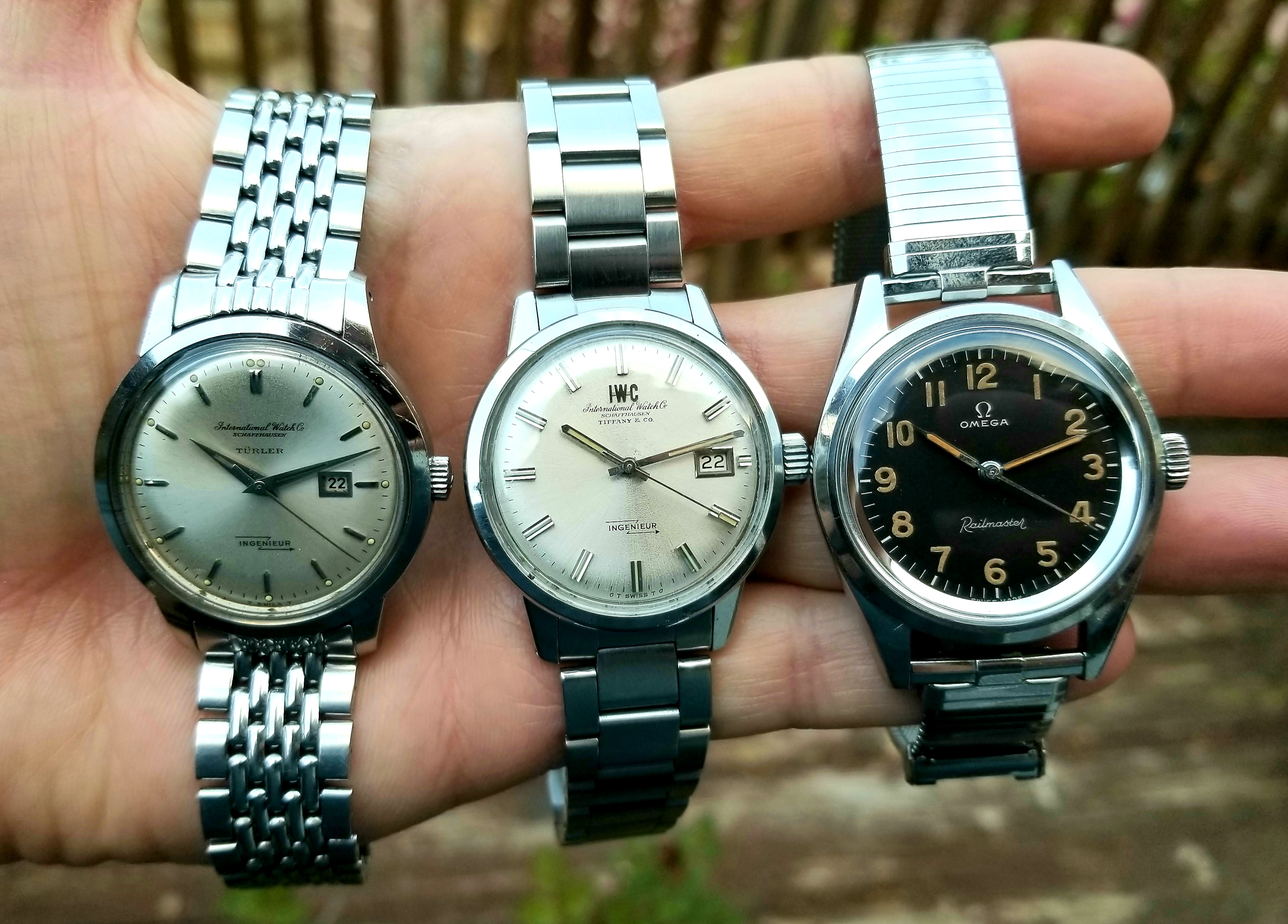

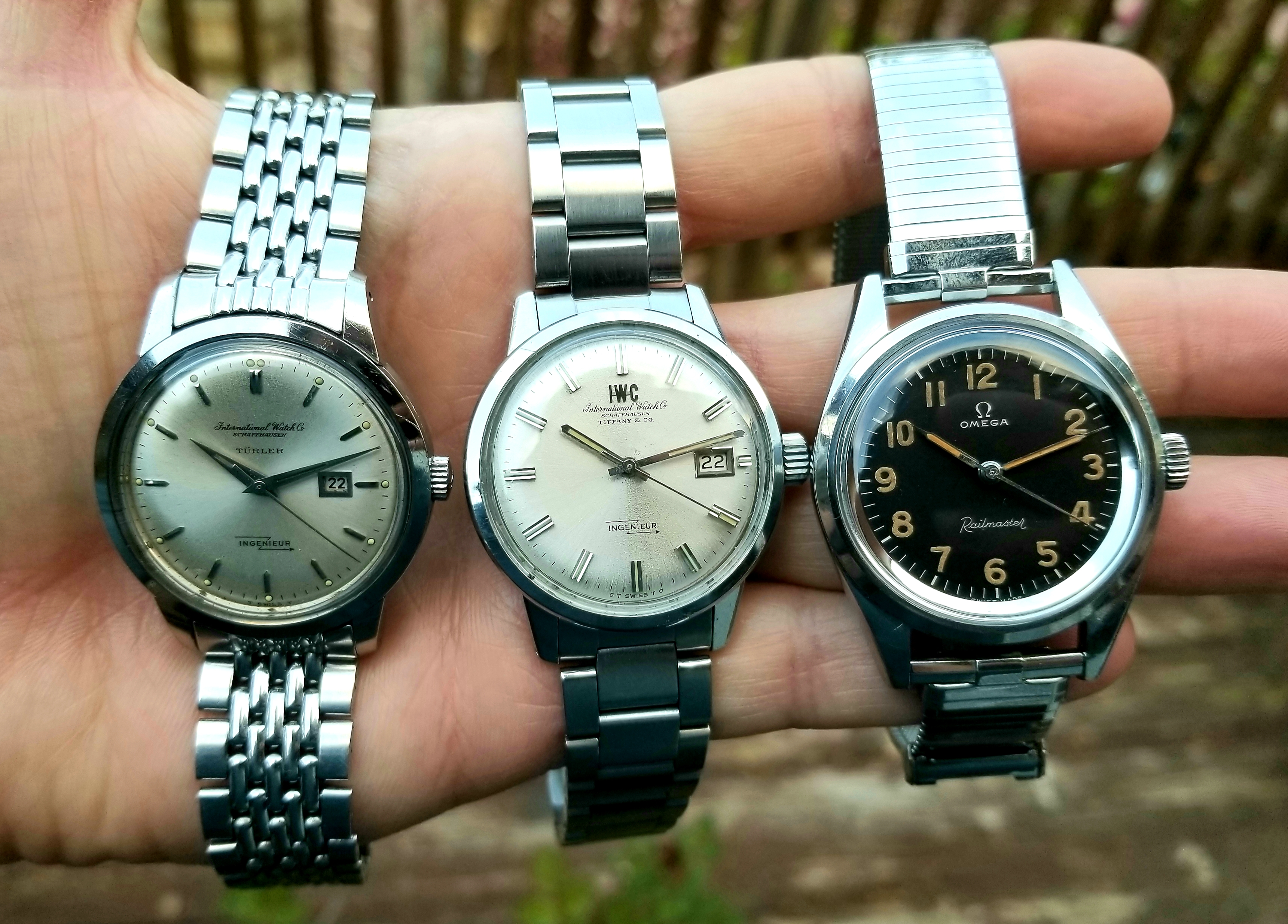

I say bring on the magnets!
Be careful with the Railmaster. That is an early experimental dial and maybe not Mu Metal. Thin normal plate possibly....
