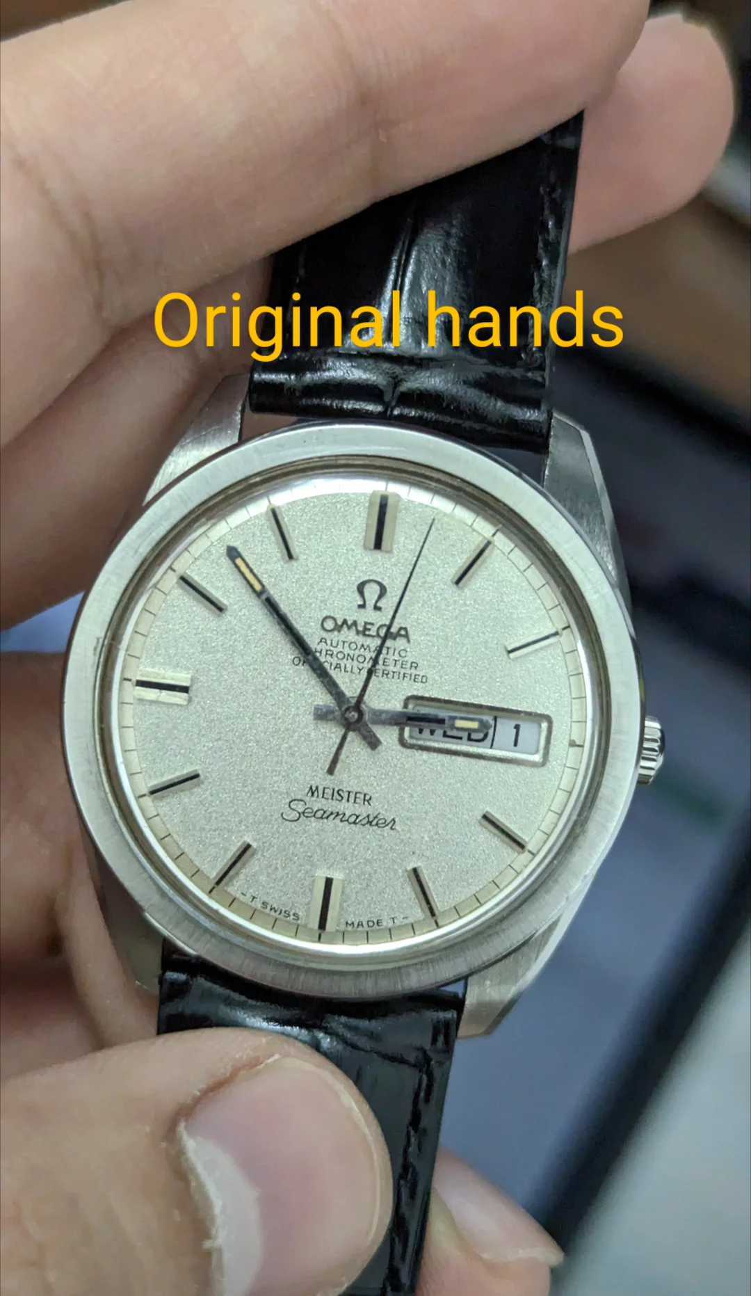

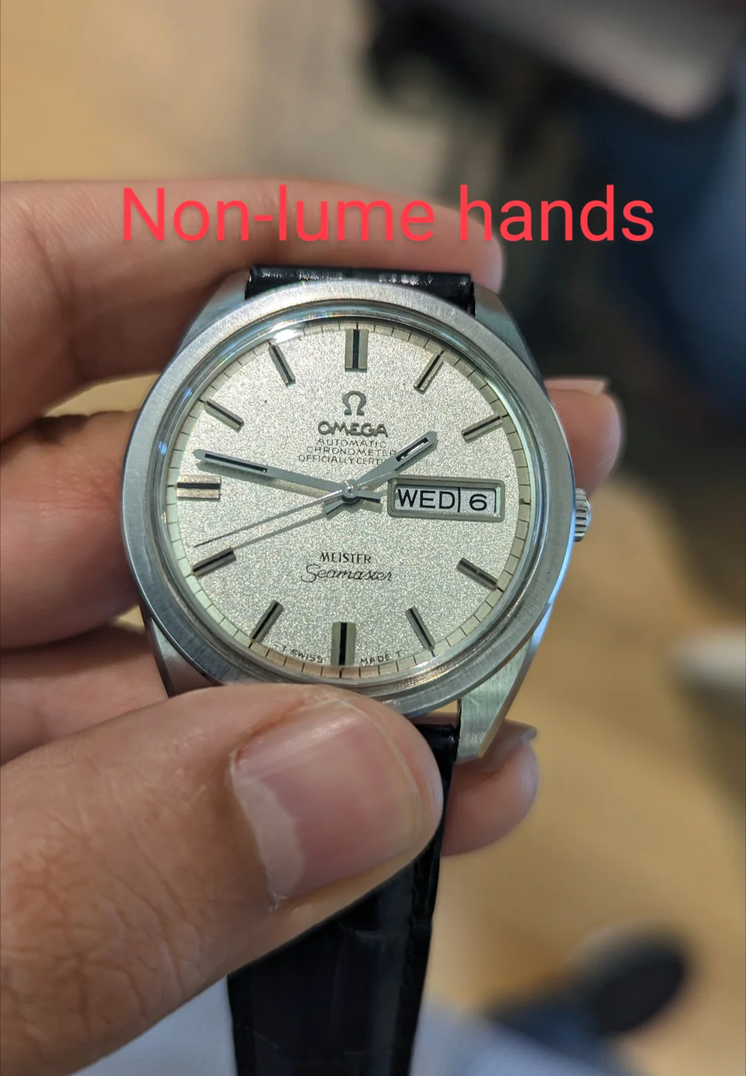

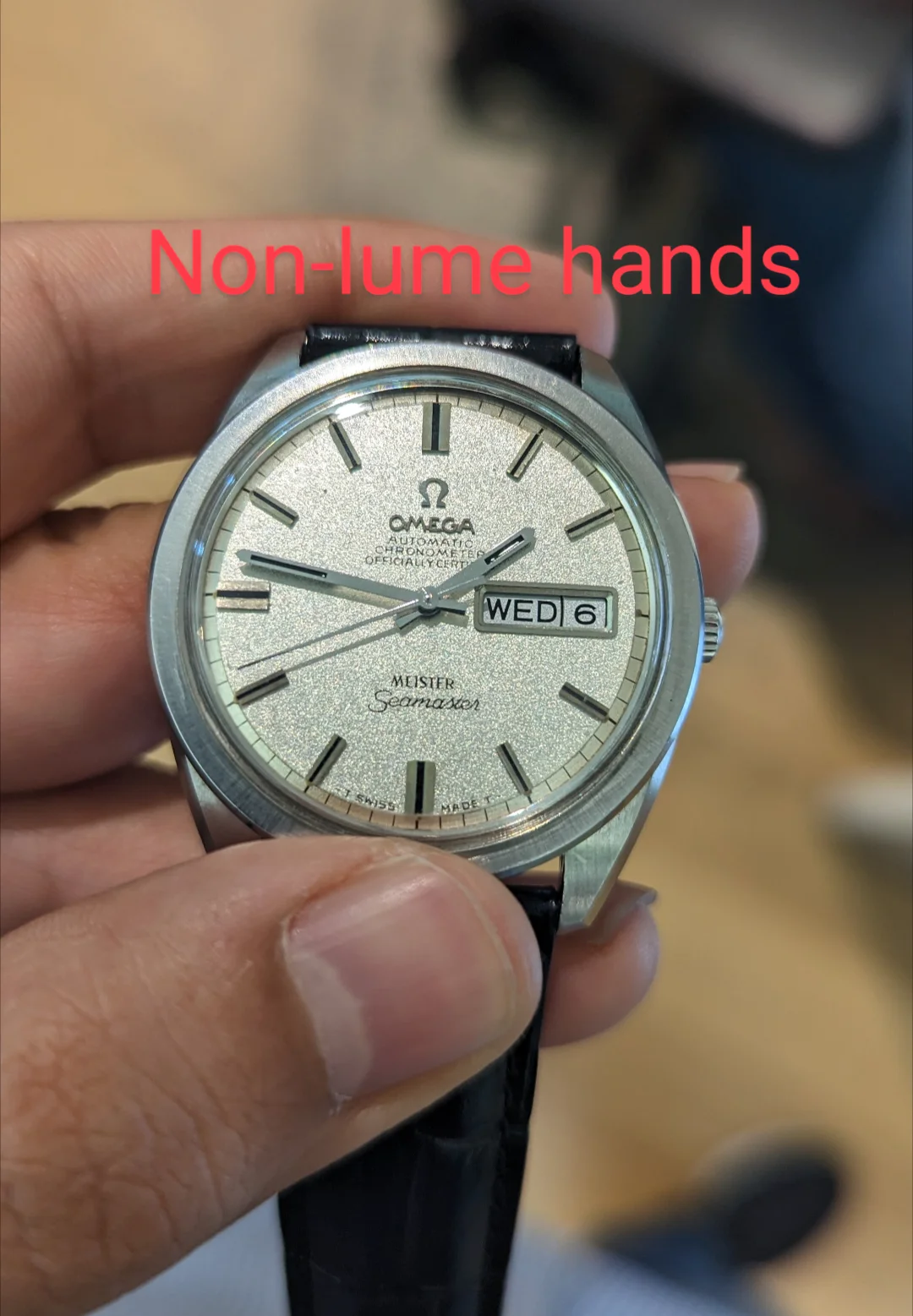

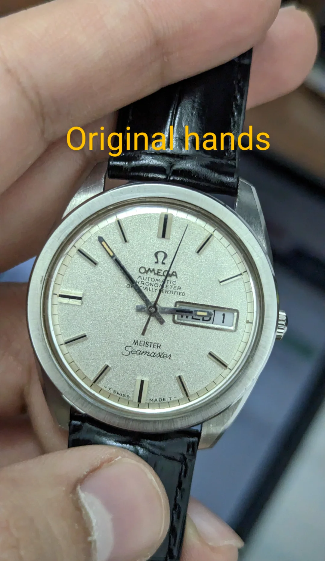

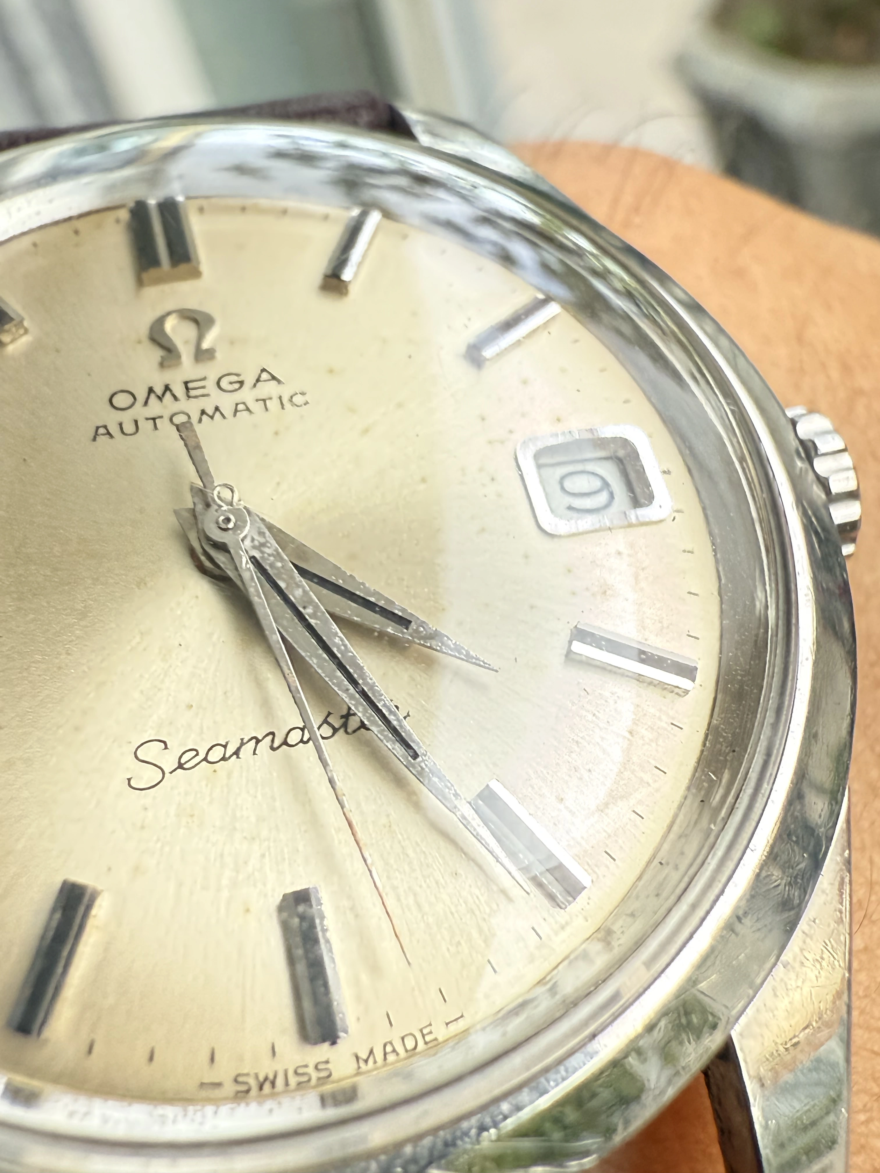

Hi everyone,
I recently gave my grandfather's Omega Seamaster "sparkle" ref 168.023 , 36mm to an authorised centre for service.
They changed the pretty corroded hands with new ones- however they are without lume.

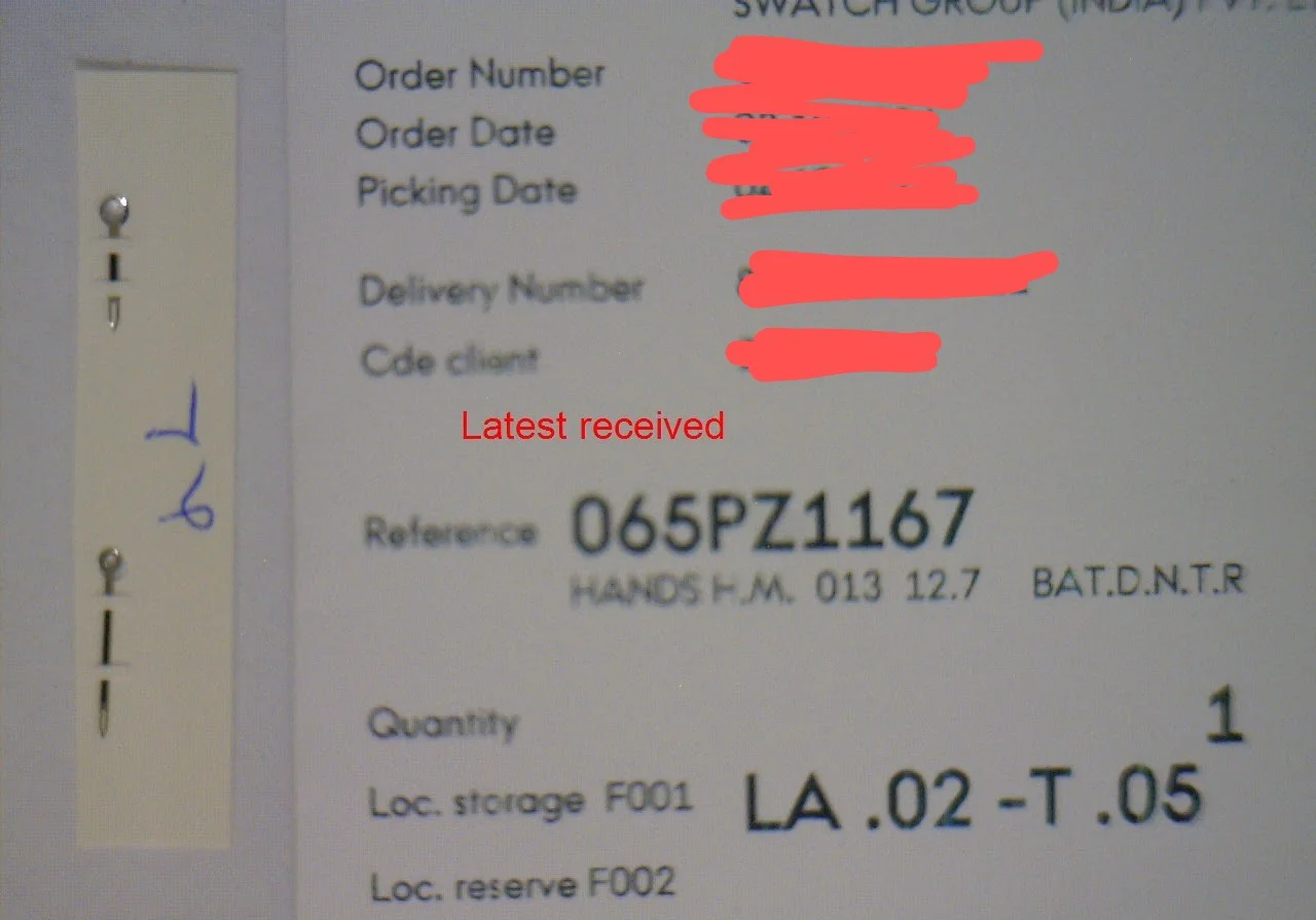

I wonder if this is normal? Because they say no lume hands are available for this model.

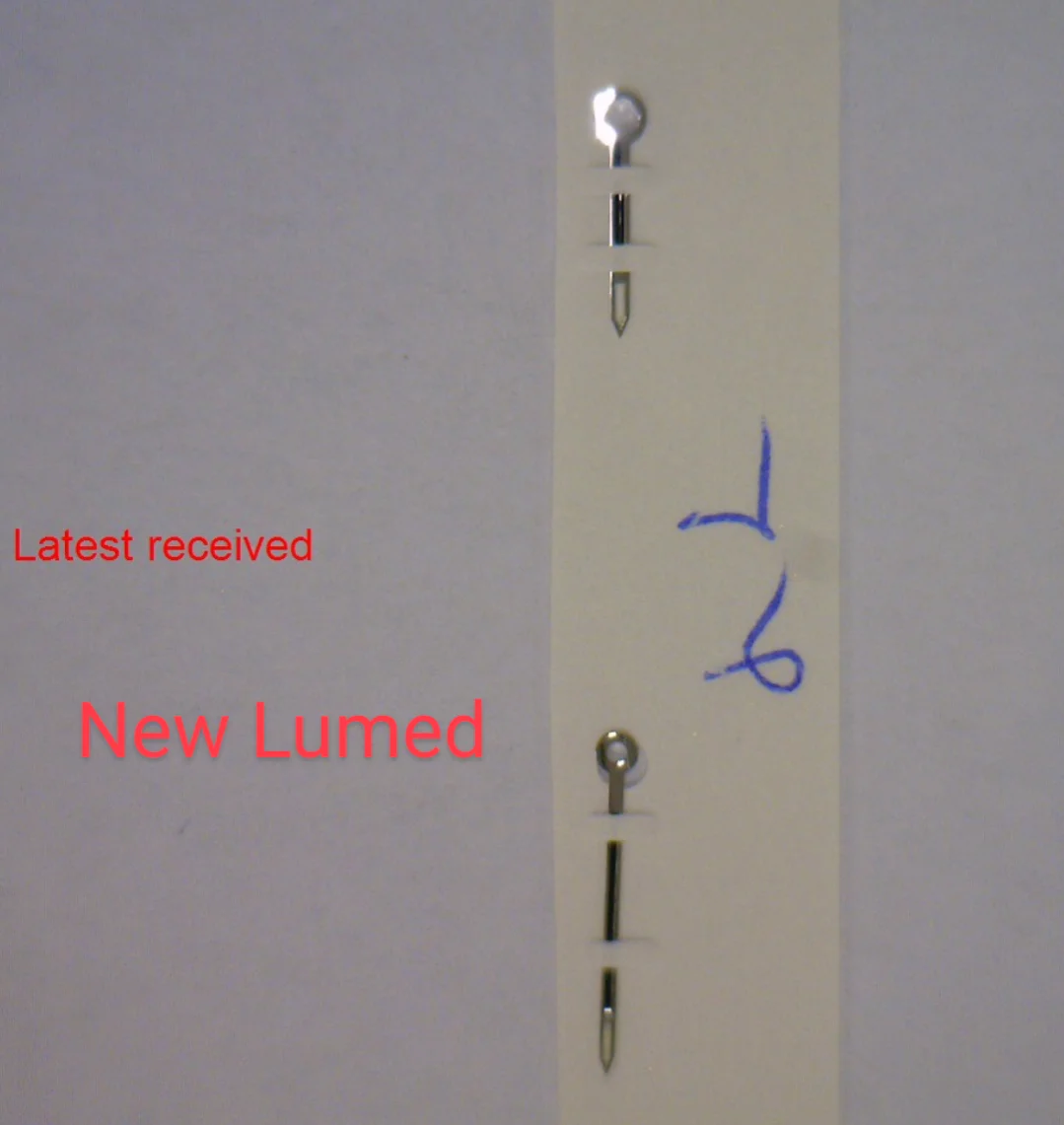

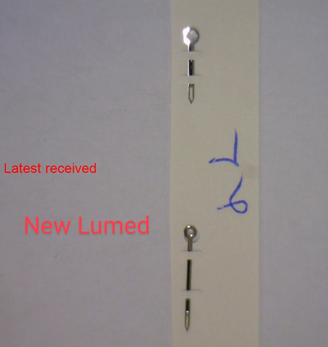

And if I want, i can get another pair of lumed hands, which belong to the same caliber (cal 751) , but not exactly the same watch. I've usually seen these ones on smaller dial constellations.
What do you recommend i do?
1. Keep original
2. Keep non lumed replacement
3. Change to newer lumed variant
Appreciate your help! 😀

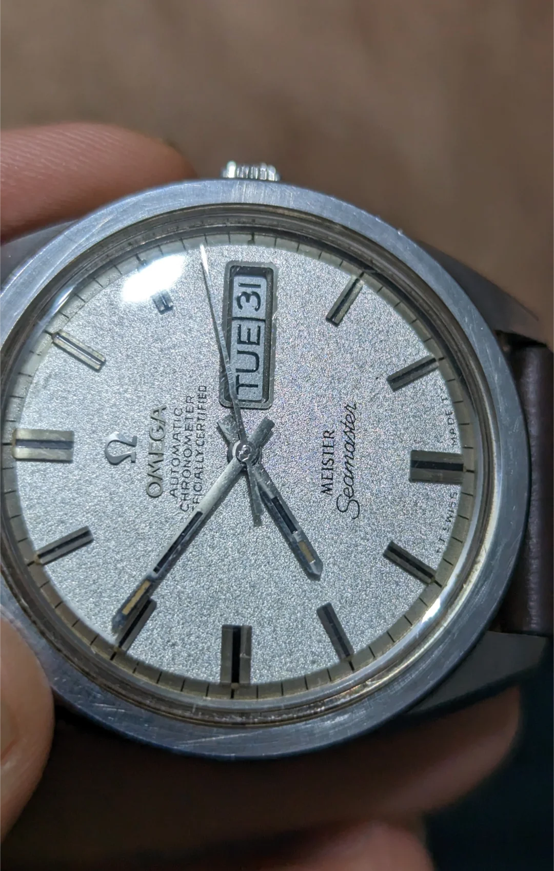

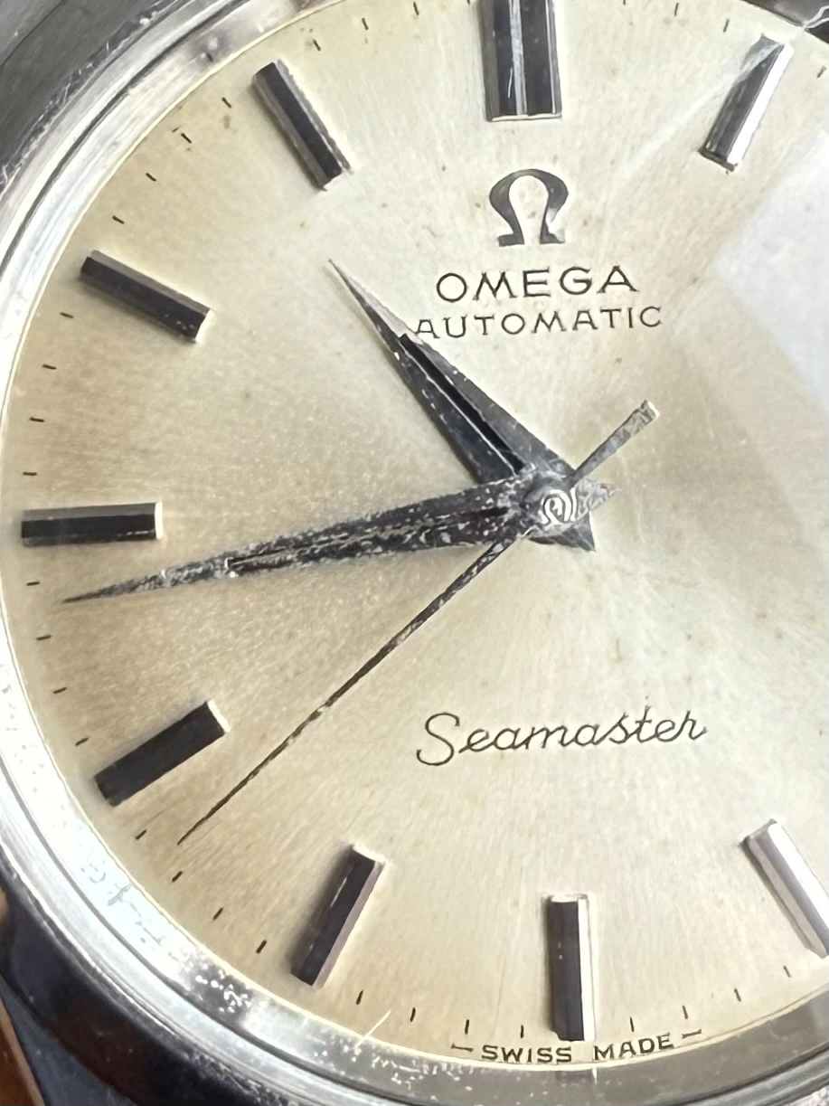

Another photo of original hands which might show the corrosion better.

I’m OCD so I ahould choose hand with lume to matched the hour markers and the “T swiss made T” dial
24,836
55,255

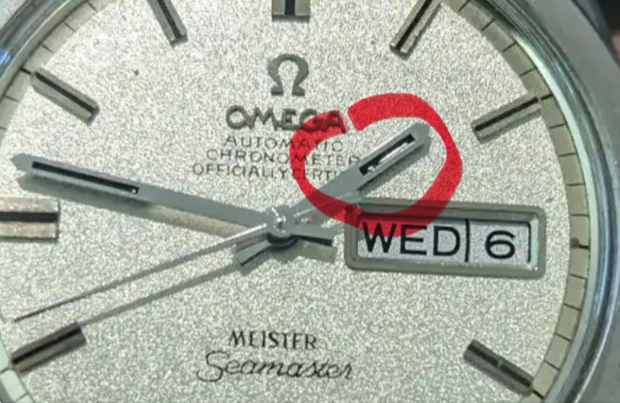

Can't you just reinstall the original hands? I would be happy to accept the minor oxidation to keep it original and matching - no brainer. Aging like that is pretty common on a 55 year old watch and doesn't bother me.
5,076
15,713
The new non-lumedhour hand is missing its fill?
620
1,969
No. It’s just light reflected on glossy paint

I've swiped worse hands than your original hands on a microfiber cloth that already has some polishing compound and 2-3 swipes is enough to take away surface oxidization like yours
I'd consider your original hands top condition as a collector, I'd just stabilise the lume, take away the surface oxidization and reinstall
Some watches it's even better to keep them original and oxidized, since you have some coating damage on your dial indices (9'o clock) as well, I think just go back to the original and use them as they are, it will be very balanced
Thanks a lot for the input, kaplan! Very informative.
I'm not sure what "stabilize the lume" and "take way surface oxidation" mean. If you could help by explaining it a bit - I'll be sure to communicate that to the service house.
I'd prefer the original hands as well, just wanted then to be clean and not too corroded.

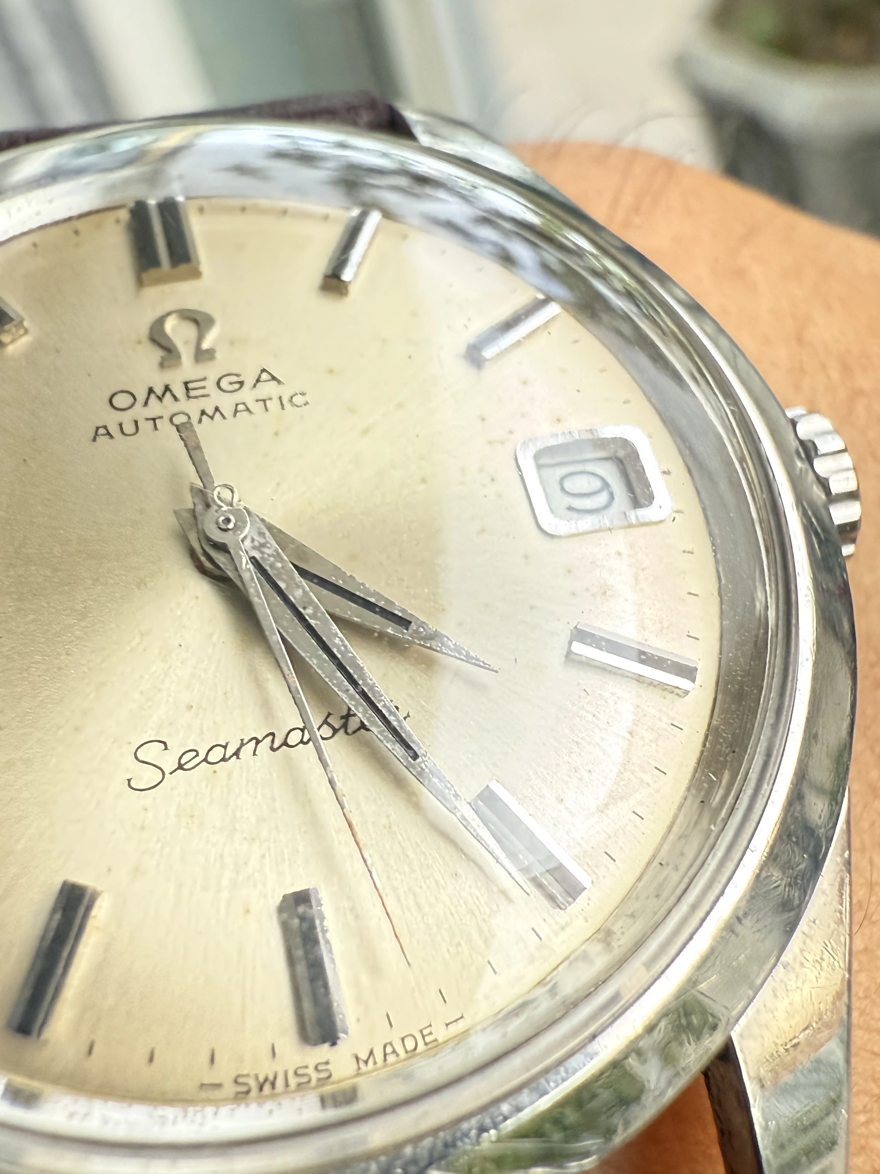

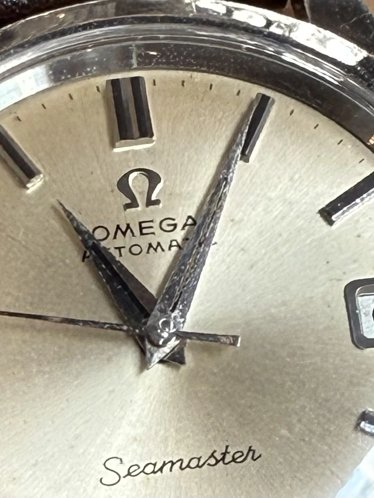

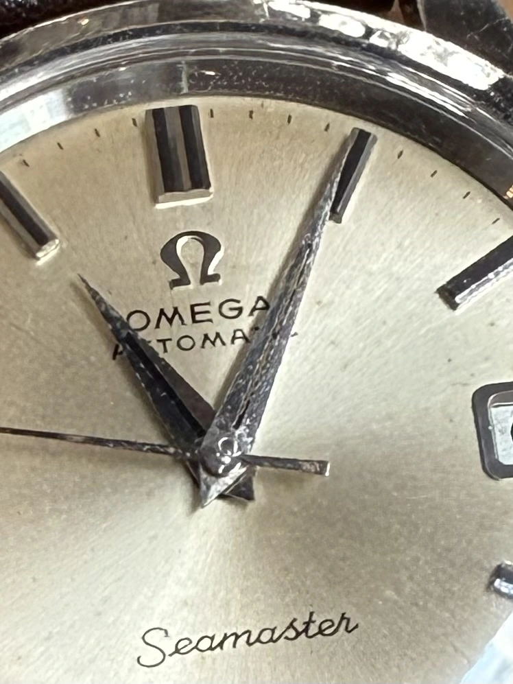

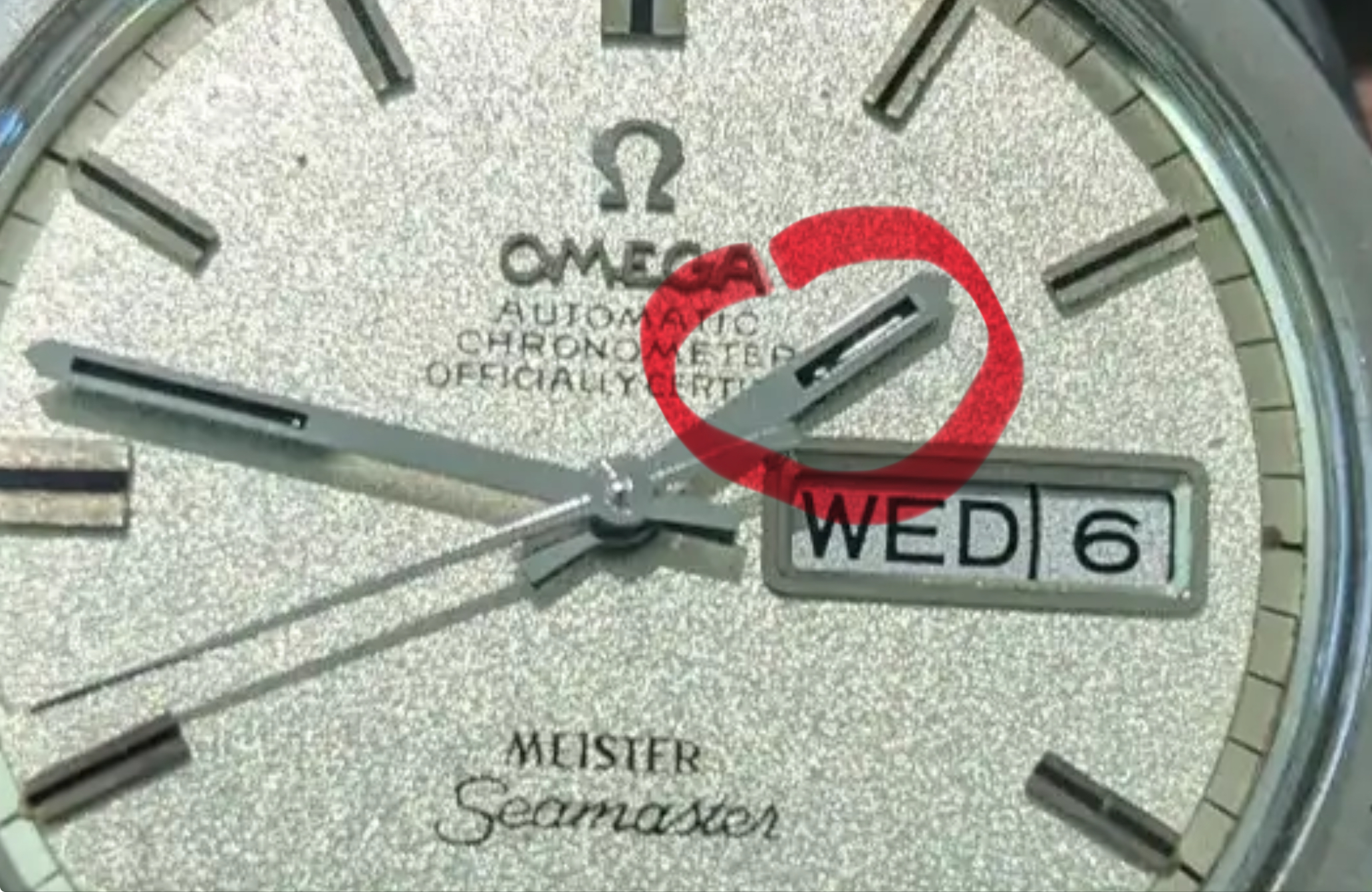

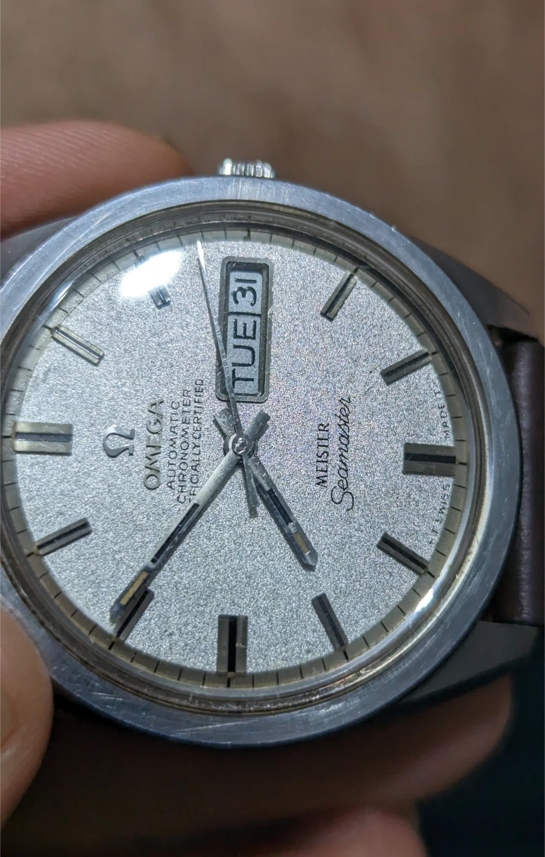

Hi guys. I have an example here. This is my 166.010, the minute hand has lost the black paint in the central to the point we can see through it. Today, I bring it to a watchmaker to repaint it. It just take 10 mins and here is the result.
Before
And after

I think it’s important to add that there is risk in cleaning these hands. AFAIK they’re not steel but plated and I’ve had two different watchmakers tell me they’re hesitant to clean surface oxidation from these types of hands as it’s easy to strip the plating off.
I’d still keep the original hands though.

Thanks for this explanation!
I think most likely I'll get the non-lume ones, hoping that they'll last longer.
At least they'll be closest to the original while being new.
Plus, i don't really trust the watchmakers in my country too much with the "stabilizing lume" bit. We don't have many experienced watchmakers here, and i feel the best they'll be able to do is replace the hands.
