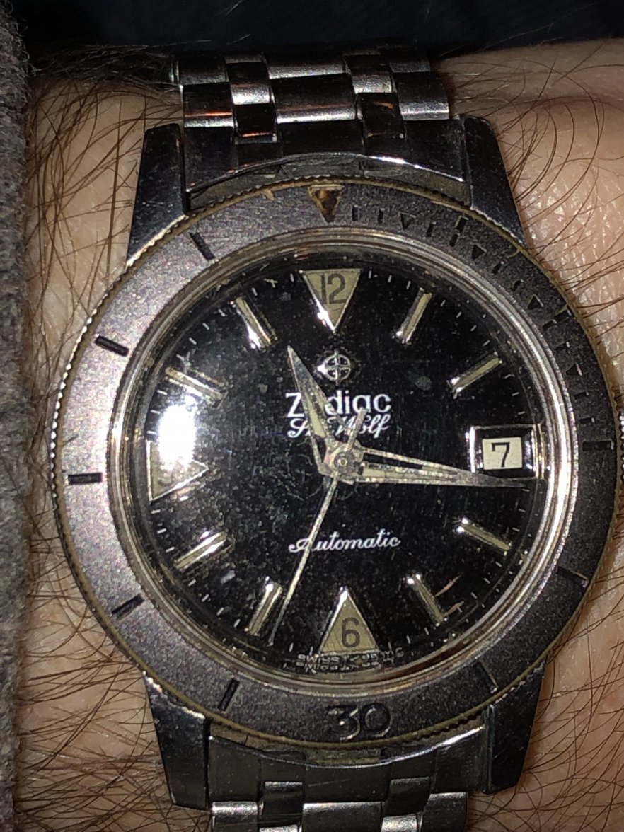

See photo below of a 1960s UG dial. I am trying to determine what happened to this lume. The green coloration is not so unusual or woirrisome to me (I have others like this) but what might be causing the lume to move beyond the hour marker? Is this water damage? Was it a bad relume that is disintegrating? Is it normal age-related disintegration of the original lume? Is it mold? Something else?
I have not run across this type of degradation before, so any insights will be appreciated!

That lume got really wet.
That is what I figured but then why does the rest of the dial look so good? I would expect other moisture damage. As far as I can tell, it is original and clean.
16,305
45,025
Lume is like a sponge. It will absorb moisture like a desiccant. It will swell and shift like you see on this watch, then dry out and shrink back up leaving traces of its movement, sometimes getting blobby. Depending how long it stayed damp will determine if it gets moldy.
Depending on the surface of the dial, moisture may have evaporated from the surface without trace (you see this sometimes with matte or satin dials like on Speedmasters), but I’m sure if you look at that dial without a crystal, you will see some traces of spotting if it was damp enough.
Great insight, thank you! It's always tricky dealing with just photos.

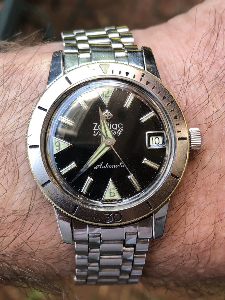

If the dial is in nice shape and the watch is “worth it”, a sympathetic relume can do wonders. Some collectors cringe at the idea of removing original material, but I would frankly prefer a relumed dial/hands over a nasty one
468
6,285
Well said. I feel the same. Of course original is best but if it's really rough like this one, a good relume is better to me. This lume is no longer in original condition anyway. I think some collectors go overboard on originality.

Hard to argue with that restoration, especially the hands. Looks great.
Can you please PM me on who did the work?
16,305
45,025
Was done by a friend (not a watchmaker) who is very talented (and does insane color matching) but won’t do work for others as he doesn’t want the liability. I’ve told him he could do well at watch restoration as a side gig but he enjoys the hobby and doesn’t want to make it a “job”. This was early work from him, he’s gotten better.
Not sure who does relume work in the US, but James Hyman is the go-to in the UK.
