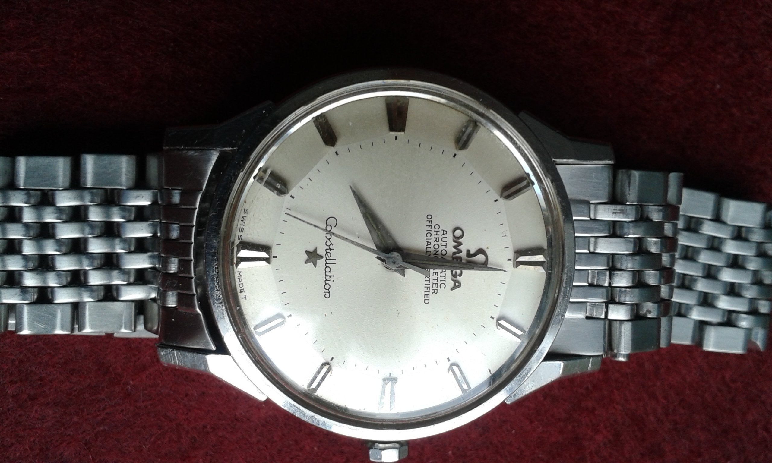

    Hi,
    bought today nearly the same watch as being offered on OF right now at Private Sales, same year 1962, same reference, not so common one with most other pie pans have different indicies
    (of course "mine" doesn't have a BOR Bracelet :()
    Pictures are crappy but I hope I will turn out to be a good one.
    Especially the bottom lugs on this one could be quite sharp and unpolished hopefully.
    [​IMG]
    [​IMG]
    Could have issues with the dial also :(,
    Paid 530€, I will post pictures as soon as possible
    Really hope it will turn out to be good one...

  2. ahsposo Most fun screen name at ΩF Jan 20, 2018
    3,745
    19,993
    Very nice. BOR bracelets are pretty easy to find if you want one.
  3. ConElPueblo Jan 20, 2018
    9,587
    26,978
    Looks nice from here :thumbsup:
    Good price, too!
  4. Peemacgee Purrrr-veyor of luxury cat box loungers Jan 20, 2018
    5,159
    7,890
    Good looking case.
    Fingers crossed on the dial
  5. Damo Jan 21, 2018
    377
    2,949
    Looks very good at a very reasonable price :)
  6. Passover Feb 4, 2018
    1,854
    2,528
    Hi,
    meanwhile I had incoming a nice 1503 BOR barcelet with 70 endlinks and attachted it...
    Next step is to change the crystal.
    Its not original and when I removed it I realized it has no tension ring and is damaged at the bottom (not visiable here)
    This is the incoming replacement crystal, I hope I figured out the right one
    [​IMG]
    It is the first time I carry out that kind of work and I hope I will succeed.
