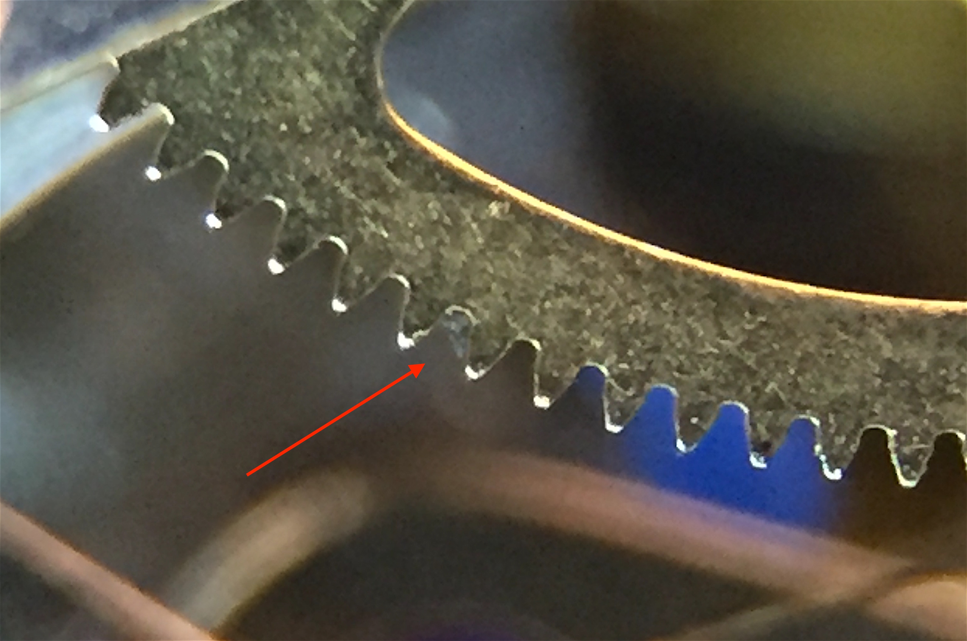

I removed the caseback again and with the watch running, put it under the microscope to look for symptoms. All was working fine and then while face down it stopped, but with nothing obvious. I gave the crown a couple of forward/backward twists and off it went and then stopped a minute later, another jiggle got it going and then I noticed a dried lump of black grease lodged in the gap between two teeth of the fourth wheel.
This caused the blocked gap to come up against the pinion of the escape wheel and jam. There was also a lack of power which would have overcome the blockage, and as the watch had never been serviced in its 20 year life I decided to look further.

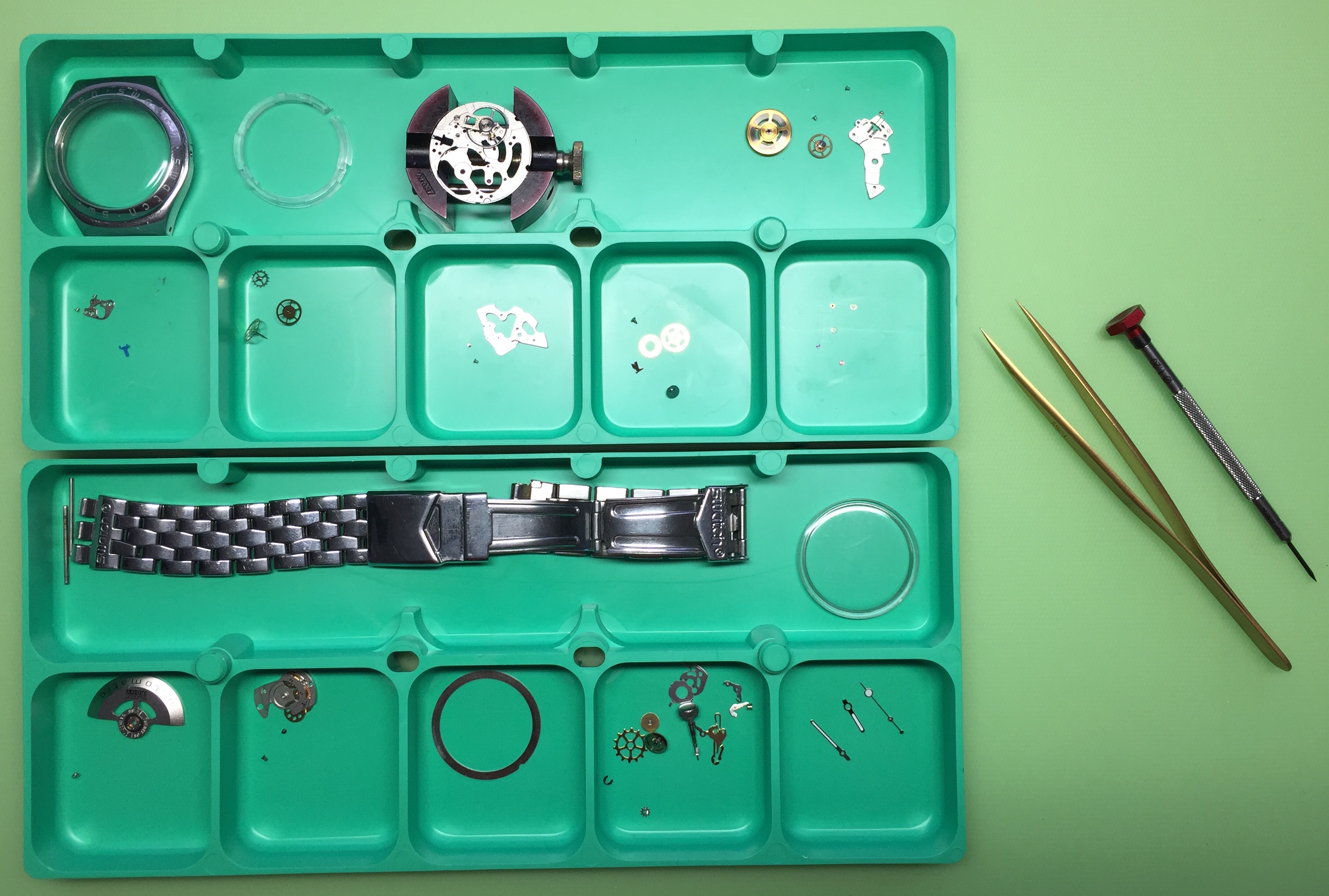

The source of the black grease appeared to come from the autowind gear area, it was very dry and crumbly. With the watch pulled apart I could see that the oil on the jewels had become very dry and was almost the consistency of grease.
So now we're at this stage.
My question to @Archer and my other mentors is; do I lubricate the escape/pallets as normal or is no lubrication required due to the plastic pallet assy?

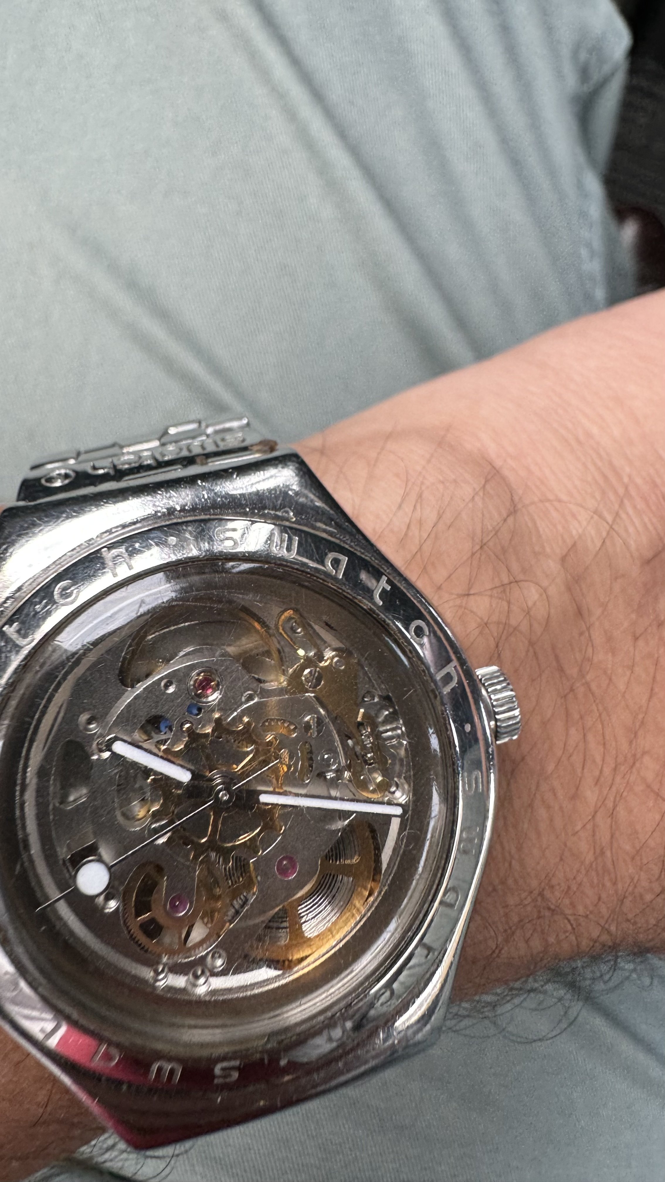

I have this watch since 23 years. Used regularly, not serviced and works well. palette fork of this ETA 2841-1 movement has two other variations.
mine has metal palette fork with blue steel like jewels. I have seen another with rubies on palette fork.
3
mine has metal palette fork with blue steel like jewels. I have seen another with rubies on palette fork. IMG_6265.jpeg
3
