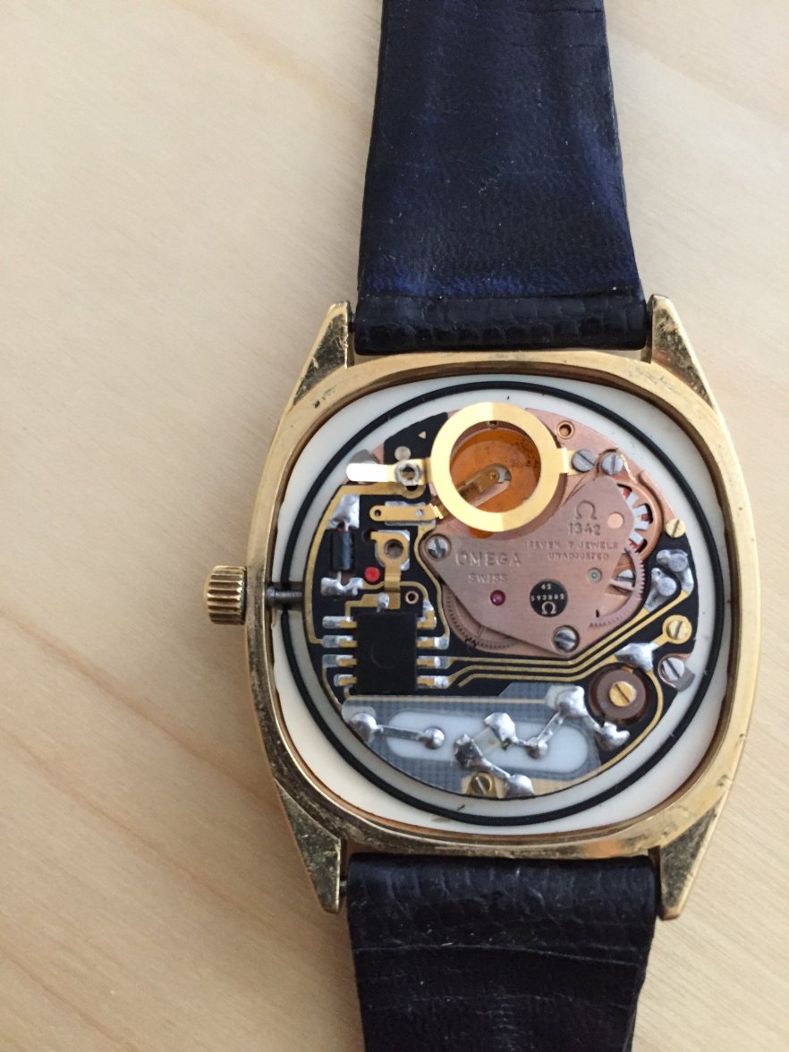

    I wonder if someone might be able to help me. I've rather foolishly lost the tiny screw that secured the battery in an old Omega De Ville that my father gave me a few years back. I don't know too much about the watch other than he owned it from new and I guess would have been bought in the 80s when he was working. I'm reluctant to visit my local Omega Boutique to buy a replacement screw, particularly for a watch I rarely wear. Does anyone have any recommendations for a place to source a replacement, either online or locally to Birmingham, UK?

    It's the same as the one on the other end of the clamp, so any local watchmaker/jeweller ought to be able to measure and match it quite easily - I'm guessing also that the battery change places probably lose these all the time and will have a stack of them to fit all sorts of movements. Otherwise drop into HS Walsh in Warstone Mews - not far from the Jewellery Quarter Metro and rail stop.

    This is the screw you need:
    1072396 | SCREW S0.80 ØH1.6 L2.6
