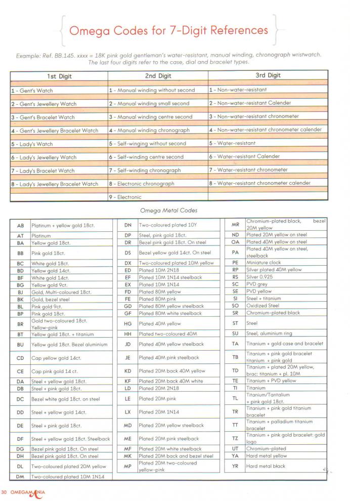

    Hahahahahahahahahaha! I think the OP needs a lesson in what post-1962 Omega reference numbers mean! Here's the first 3 digits:
    1 = man's watch
    6 = self winding center seconds
    6 = water resistant case w/ date
    @jrhave2 - you bought a frankenwatch, and the quack / butcher who created it didn't even bother putting an automatic inside. No freakin' wonder it doesn't fit correctly!
    Edited May 16, 2018

    Here's a scan of the page in AJTT (originally from the OmegaMania auction) that shows the codes, courtesy of www.omega-fanatics.com:
