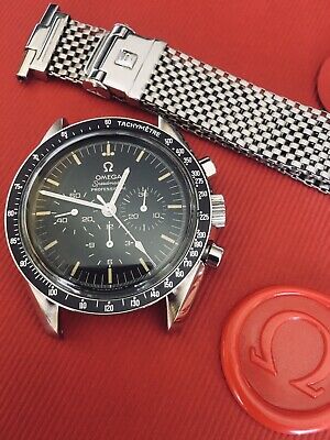

No pictures no answers my friend. How can we give you advice about a watch we've never seen?

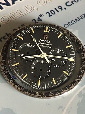

I'm no expert, but is that not a relumed service dial as it has the short indices?

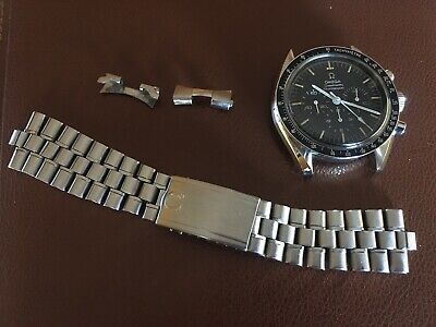

The original parts don't look too bad and I would prefer the hands over the service hands. Hard to tell much though without better pictures and an idea of the pricing.

The dial looks like a 70's service dial as it has 'T marks'. Then again, so does the dial that's on the watch.

That's the one!
Let me guess: there is no laser technique

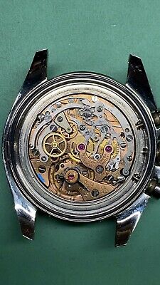

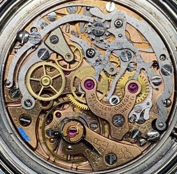

laser welding is a genuine method of repairing watch cases. If a case has needed laser welding, the dial, hands and bezel have been replaced and the movement looks like that, It’s easy to to conclude the watch was an absolute wreck before it was restored.
Buying a fully restored watch is fine if we’re talking about a rare model, but this kind of heavy restoration on a vintage speedmaster, which are quite plentiful? I’d rather wait for an original one.

If someone one day ask me for a definition of frankenwatch could show him this watch? 😲
To be honest there is nothing I like about it... It is priced (according to speedmaster101) as it was in good condition... Couldn't be farther from the truth.
There's only one dial but it's pictured both in and out of the case
Ah - that makes more sense.
It's clearly just a well used Speedmaster that's been restored using various methods and parts.
