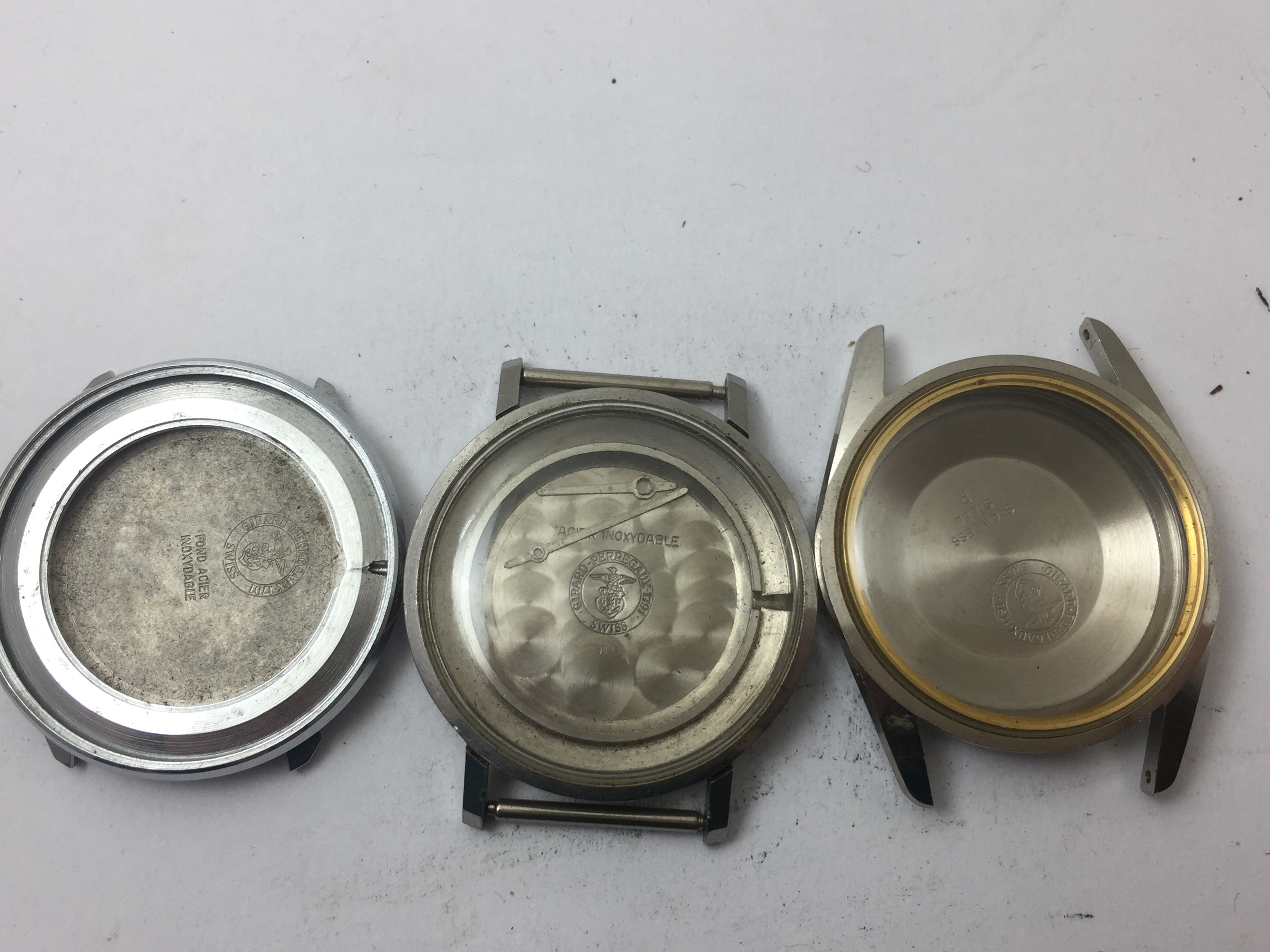

    This is clearly a snap together watch with little water resistance, but I was a little surprised to see that the case has no case tube:
    [​IMG]
    So for anyone who is familiar with these, is this case missing a case tube, or is the crown supposed to have a part of it's diameter that goes into this hole in the case frame? If you have examples of what a properly marked crown would be for this sort of case, that would be helpful also thanks.

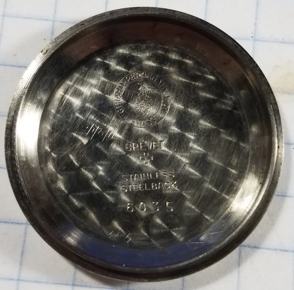

    If inside the case back is not marked GP, I would guess that the movement came from a scrapped gold watch and was fitted into a contractor case.
    I vote case tube and water tight crown. Best engineering solution.

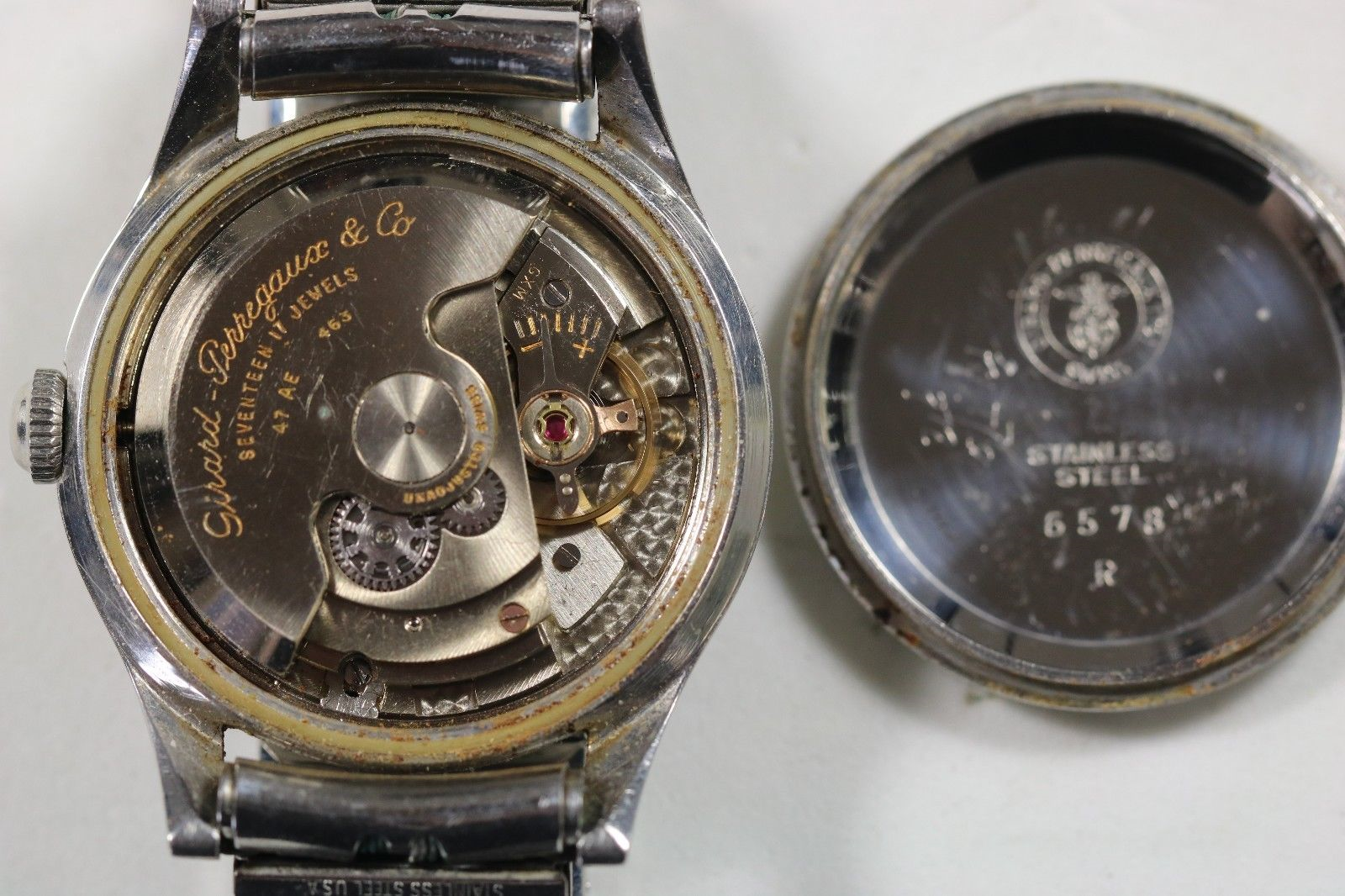

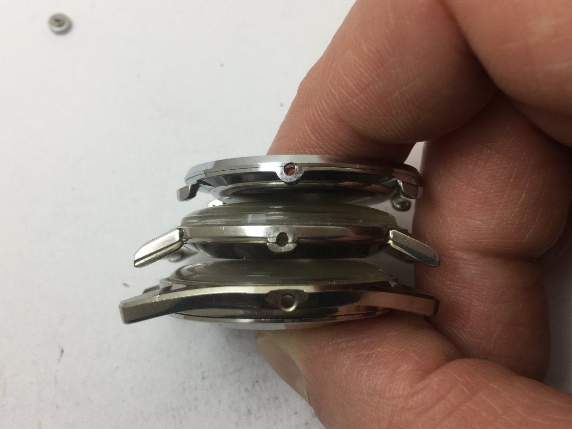

    Here's a pic of inside a generic GP that I have.

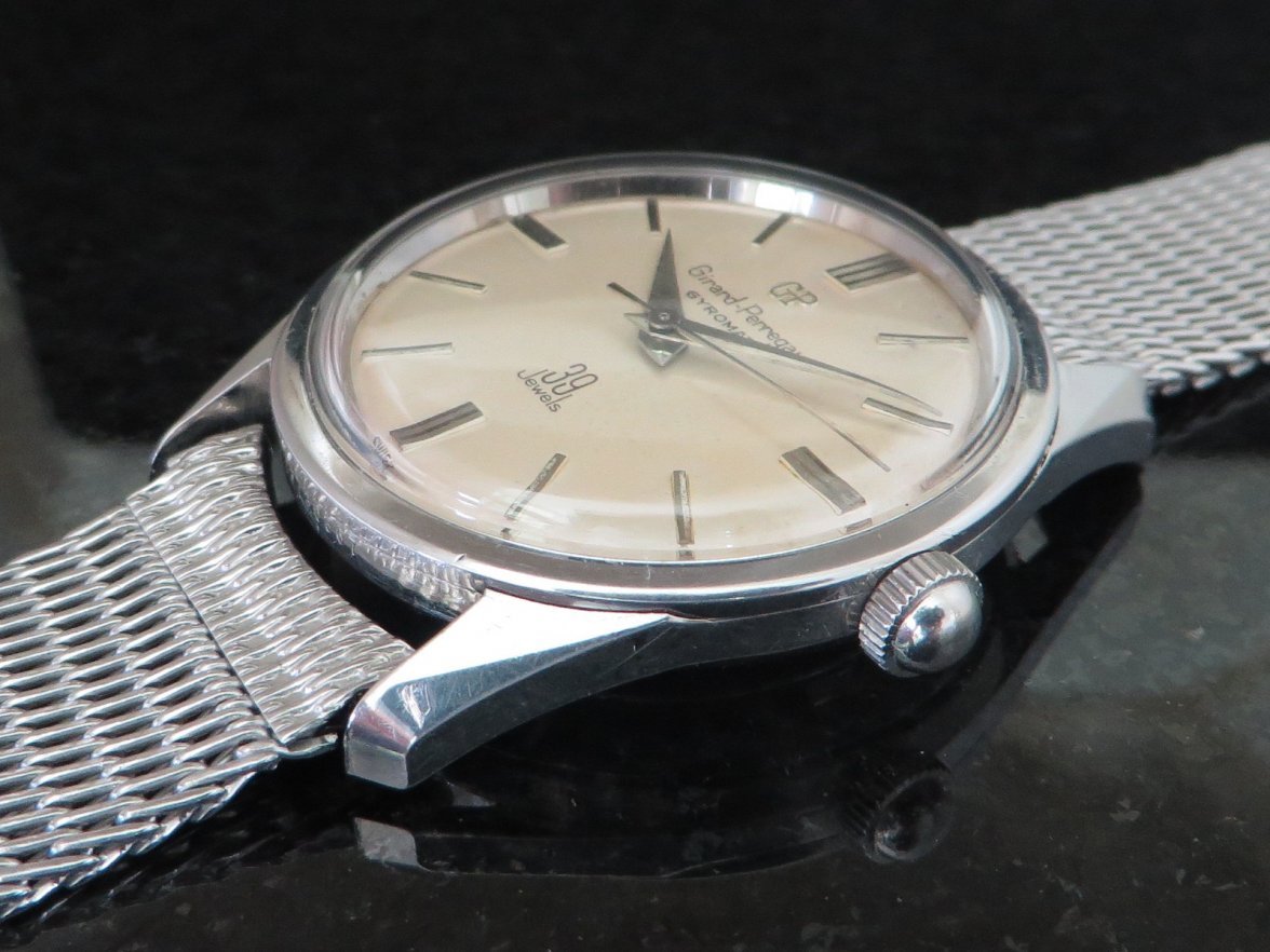

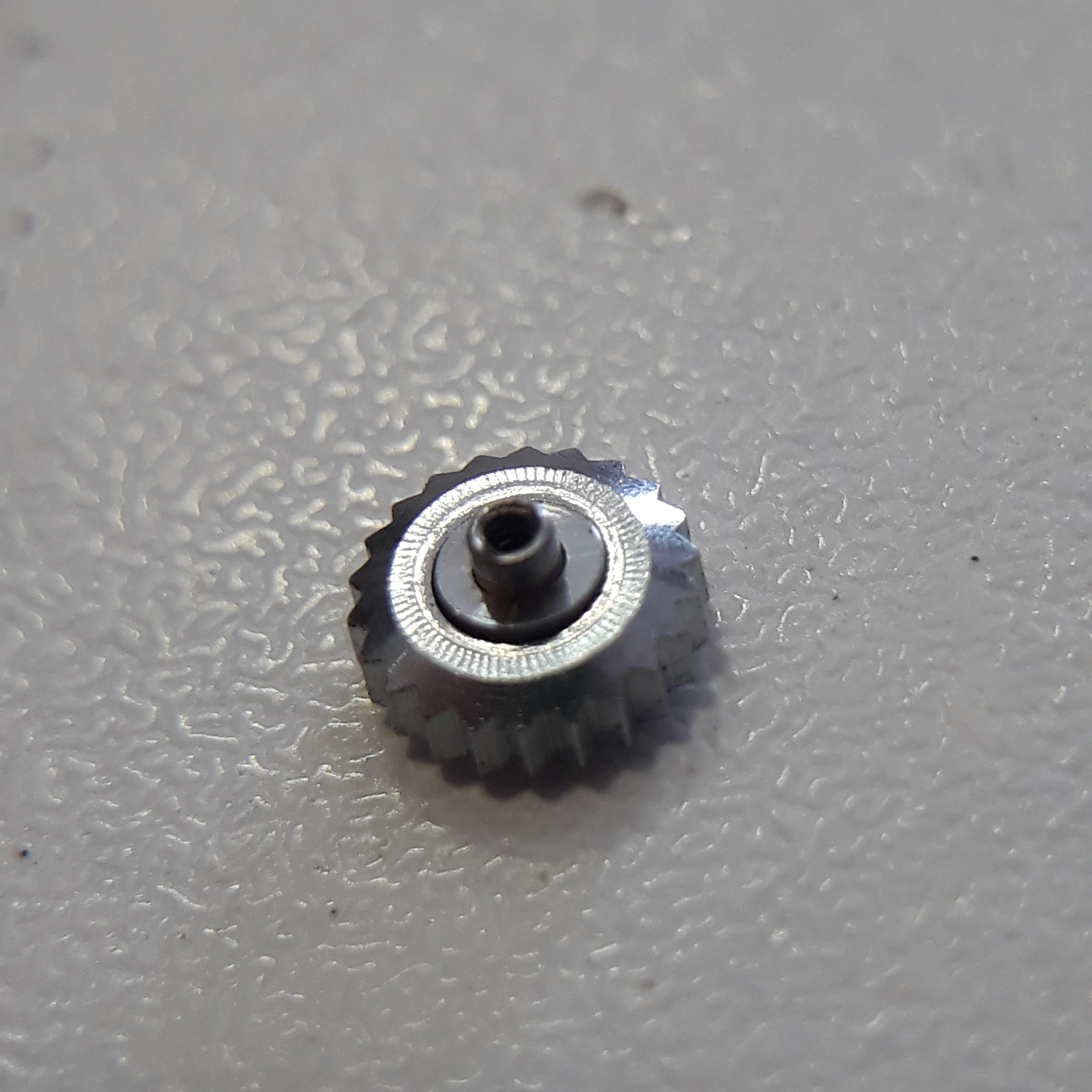

    Maybe this style would be ok? It has spring inside. On picture spring does not work but you get an idea how it works

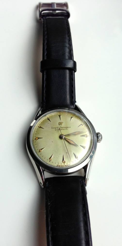

    Below is a similar bowlers cap unsigned also.

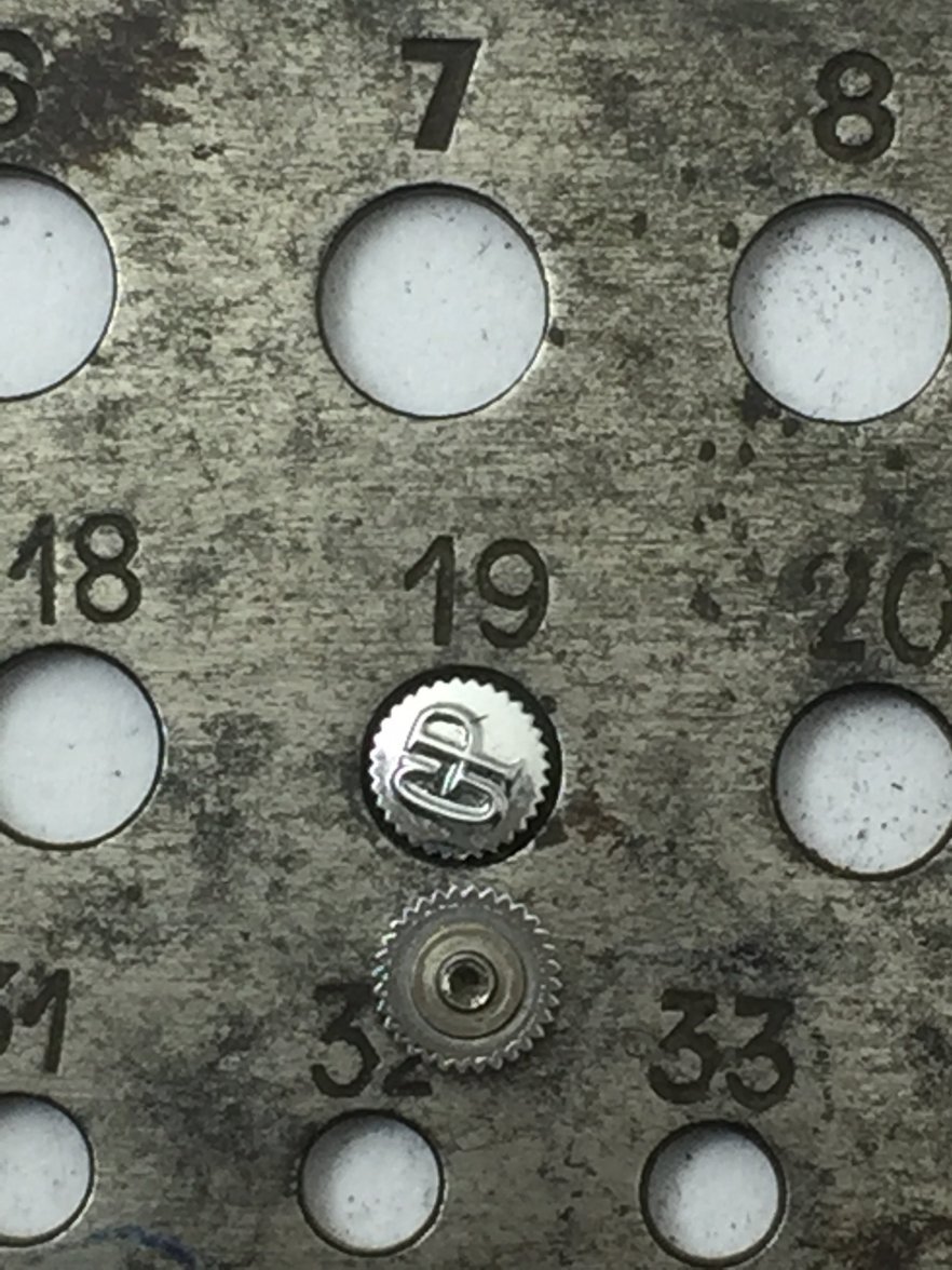

  6. Amadeus Sep 3, 2018
    106
    100
    First let me start by saying that your case is not missing the case tube, those cases were originally designed like that, it was a "dust proof" system which supposedly prevented dust from entering the case (in reality this was the exact opposite, the cases always ended up full of dust and dirt)
    All Girard-Perregaux cases should be marked with the Girard-Perregaux logo:
    Some case backs aren't marked on the back.

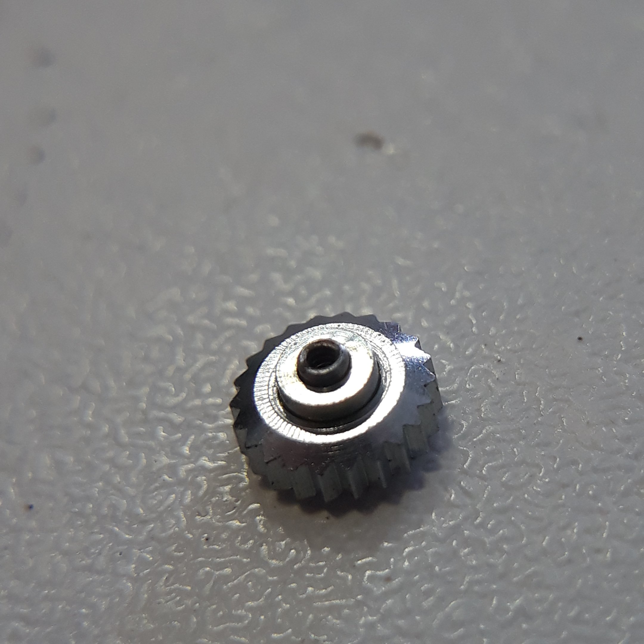

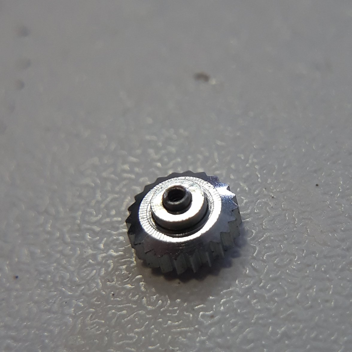

    Regarding the crown, this is the correct crown for the watch you're repairing:
    PS: If you need one I can send you the crown from the picture free of charge (I would only charge the shipping), I'd be glad to help a fellow watchmaker.

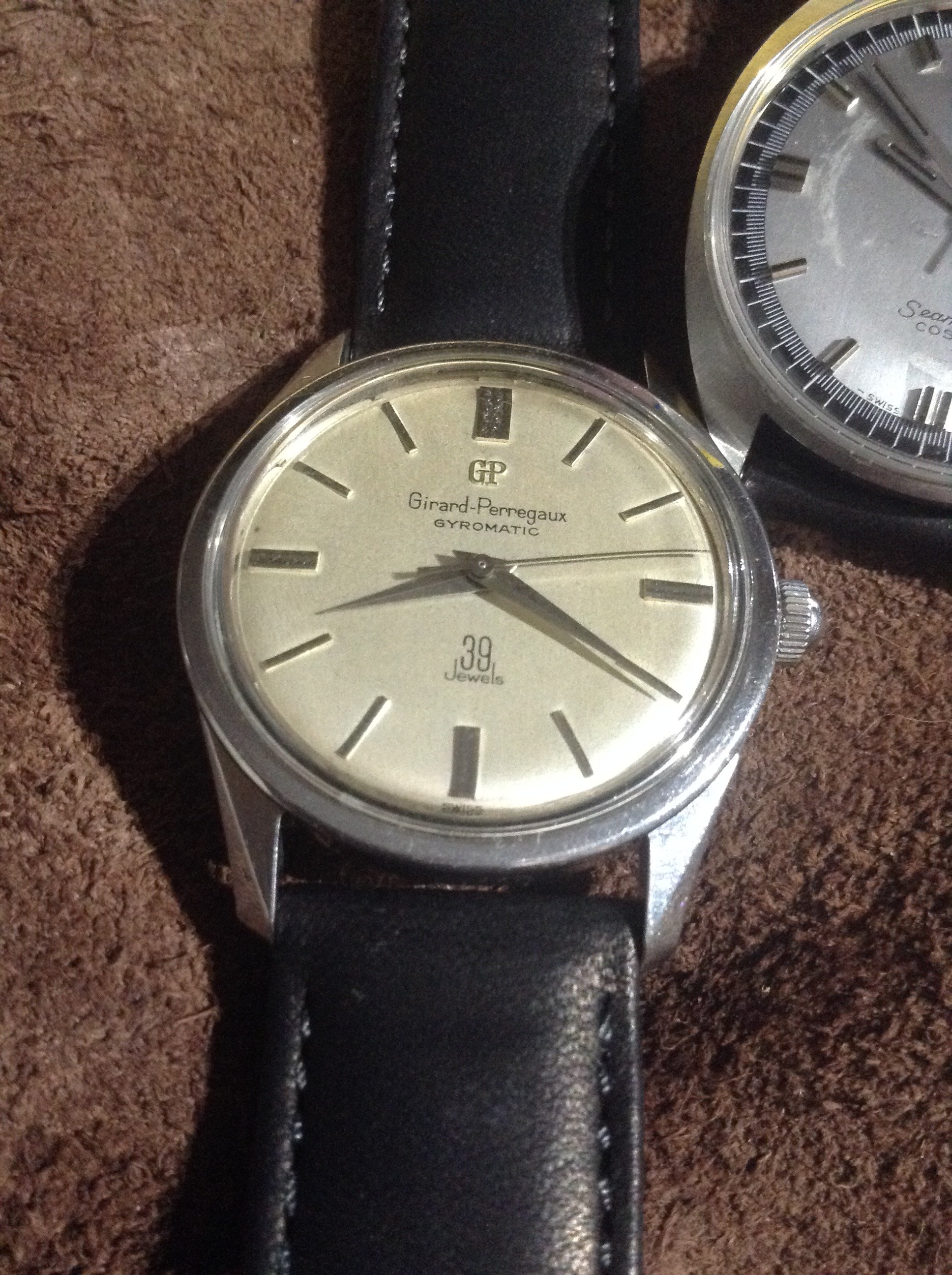

  8. Deafboy His Holiness Puer Surdus Sep 4, 2018
    2,179
    6,142

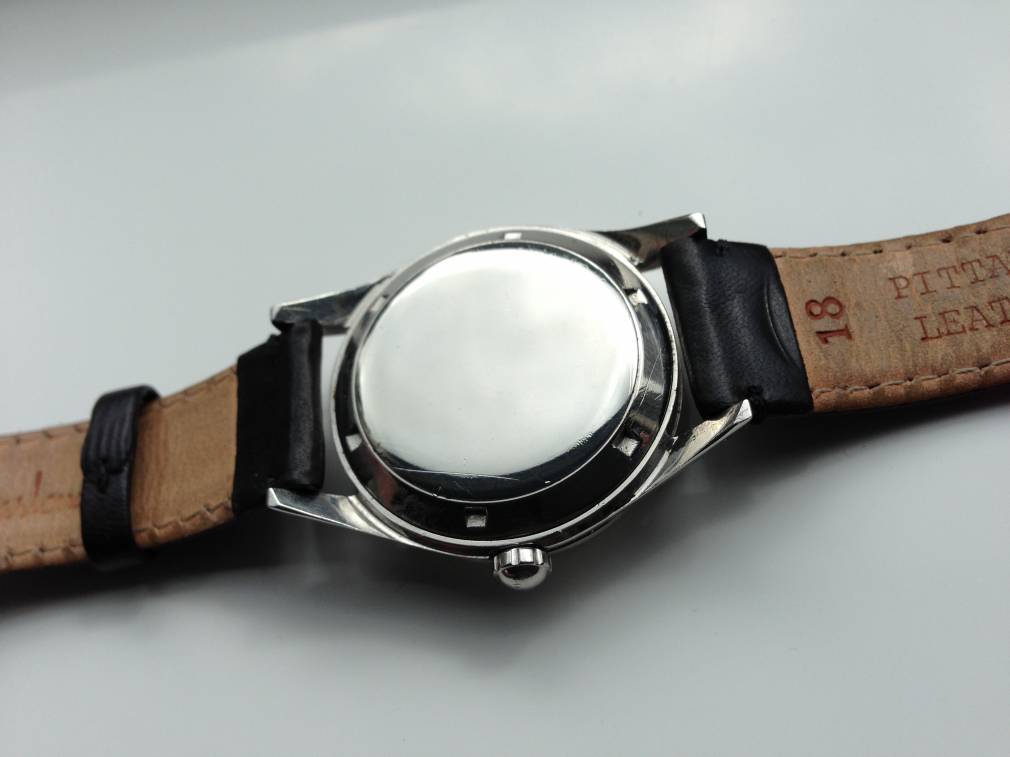

    Here's mine for reference
