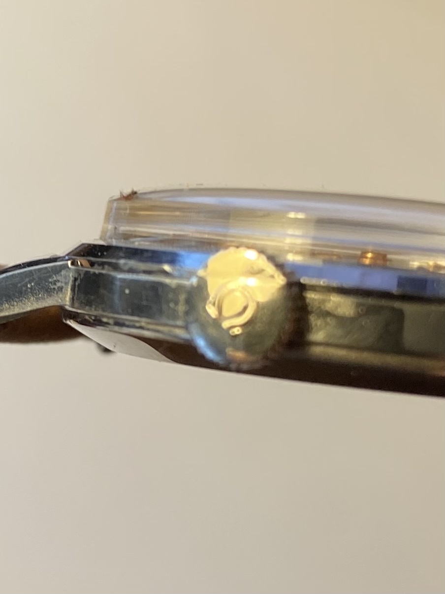

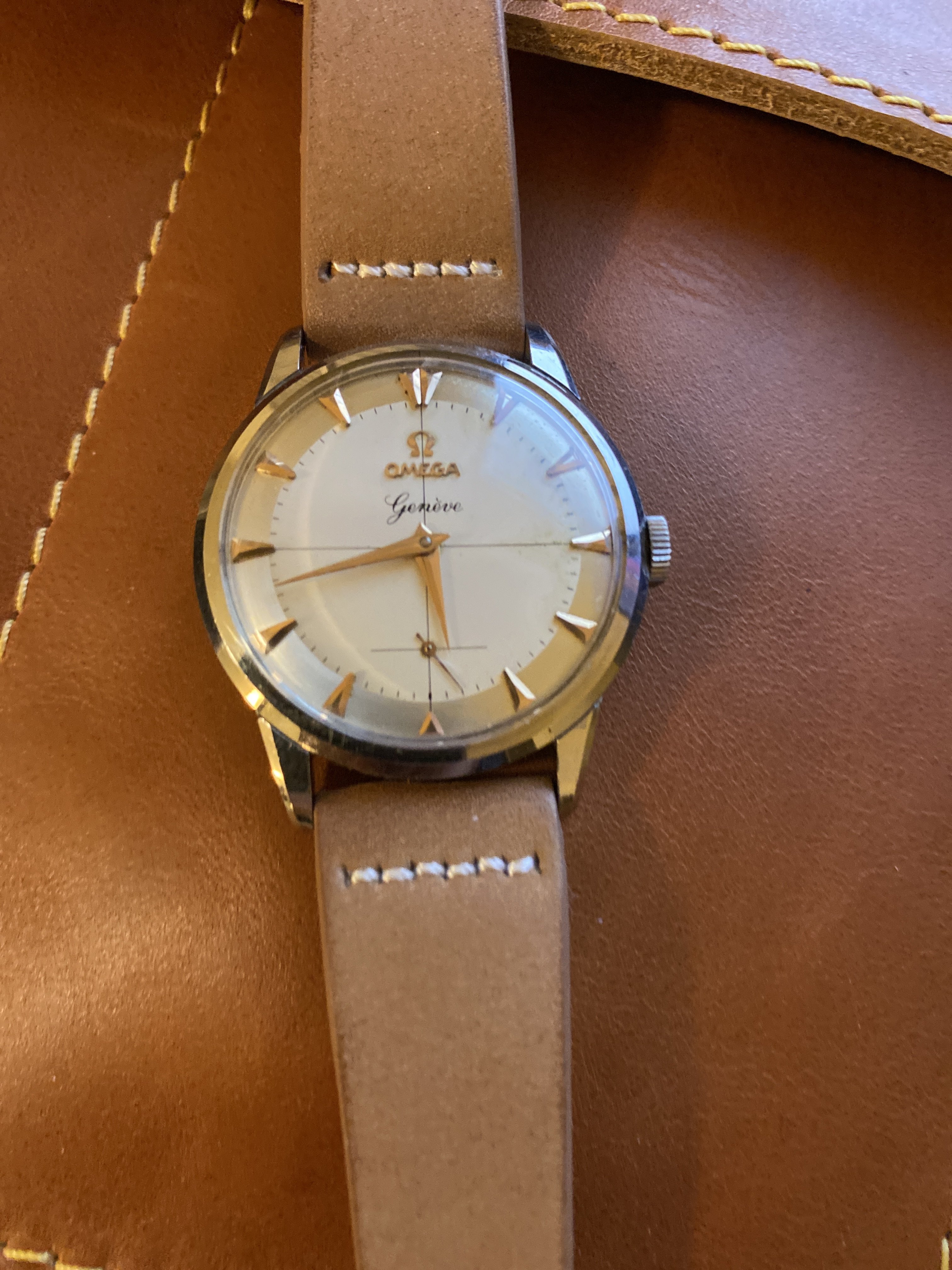

Any ideas about where I might find them? The existing crown has a small dent/crease over the Omega logo. It’s not that noticeable and the crown is functional, but the watch is otherwise mint, I’m OCD, and I want to make it as close to perfect as I can get it. I also need an original NOS etched hesalite crystal. If anyone knows the part numbers or where I might source the crown and the crystal, I’d certainly appreciate it. Thanks.

Have you spoken with a watchmaker yet?
Mine has reminded me numerous times that he has sources for parts that I will never learn of because they're not necessarily found online. I generally look only when he says he can't find something. Then we're splitting the labor.
I understand being proactive, and I want to do similar things, but talk with your watchmaker first, you might be surprised.

Try researching on Jules Borel and Bailey.de sites for part numbers, and ask @new_heuer
He has a pile of NOS crowns.

Do you know the measurements? I can have a look.
nico
Cousins UK says:
  • Tap 12 (Ø1.20mm)
  • Crown Ø5.00mm
  • Pendant Tube Ø2.00mm
  • Crown Depth 1.80mm
  • Stainless Steel
35002ST

I will have a look tmrw, but I am afraid I just have tap9 ones.

Sorry forgot to come back to you. Unfortunately I don't have a matching crown 🙁 Good luck on your hunt!

Case reference number and caliber number. Email that to Otto Frei or Jules Borel. They use these numbers to locate the correct crown.
Didn't see where you are, but Cousins in the UK and H W Perrin in Toronto
