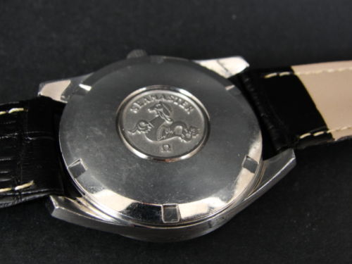

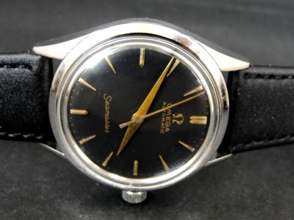

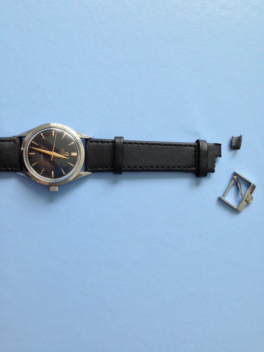

    Now, 15 years later, finally I made my way and the time has come to make my dream come true. Last week I received my first Omega Seamaster cal. 471, according the seller, same as in the pictures, everything original with black refinished dial from the 50's. God, it was from the first instant a disappointment. I'm not an expert but I had not a good sensation, the watch seems too "new", too "light", and it was not the same as on the pictures on ebay. Finally as I wanted to fasten the strap it brokes in one second without effort. The band was for sure the cheapest thing I ever seen in my life (see the second pic attached). The price I have paid? $425.......
    I contacted the seller immediately and I told him that I would send his piece of shit back and claim back the money. He replied that he was sorry (wow!) for the whole story. He said that I can have the money back but he also said that he wants to make it good with a second honest offer. The offer is a Seamaster cal. 752 from around 1969-1972, exactly as shown in the pics (hope this is the truth). The price is $525. I like this model but before I give my ok and pay the difference of $100 I would ask for your help.

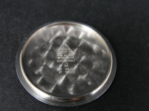

    I am grateful for every opinion and tip you could give me. The first thing I will make is to verify the serial numbers on the case (here in this case we have two on the case, ST 166032 and ST 168023, the number on the movement is not 100% readable, I suppose that it's 307807XX) Please help me to find the way to my first authentic Omega. Thank you all for reading my post.

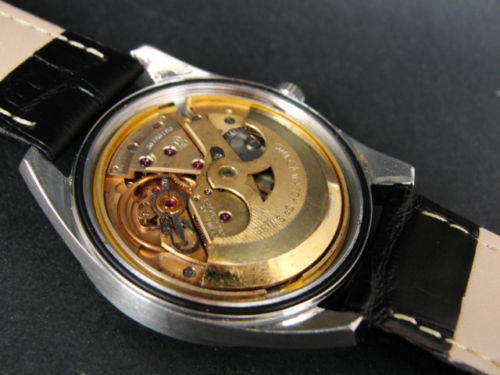

    Here first the garbage the seller sent me, the first picture is as it was presented on ebay and the seller told to my question that it was exactly the same he would send. Make your own conclusion on comparing with the second pic.
    5 minutes after the delivery of the Omega 471.

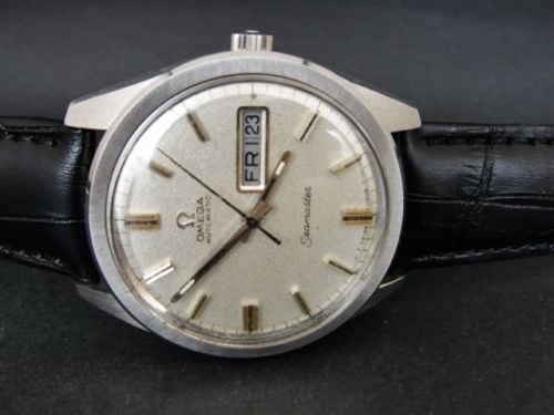

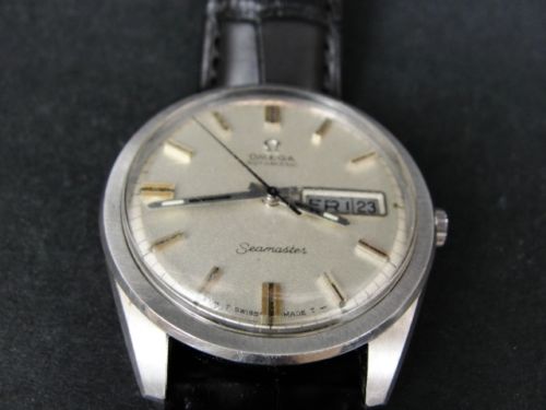

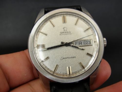

    The next pics are about the OMEGA Seamaster cal. 752. Every comment is very appreciated :)
    $_12 (4).JPG $_12 (3).JPG $_12 (6).JPG $_12 (8).JPG $_12 (9).JPG $_12 (10).JPG $_12 (11).JPG

    I would ask for my money back for the simple,reason that I would not feel comfortable that what he was sending was any better. There are plenty of watches on the for sale section that are reasonably priced and most of sellers here are collectors and ask fair prices for their watches.

    I can't see the differences in pictures of the first watch except the broken strap. The price is high for a refinished dial though.
    Pictures are small and blurry for the second watch, but it appears to be Ok with reasonable price. Hands may be new replacements, and make sure the hour markers are silver looking instead of yellowish like in the above pictures. Ask for bigger and clearer pictures. If you can, try to bring down the price a bit and keep the first buckle.
    piero likes this.

    Hey TNTwatch, thank you very much for your tips! I also thought that the hour markers on the Seamaster 752 looks strange, in fact I only saw silver markers on similar models. Yes, the cal. 752 looks really nice and I would love to have one....
  6. dsio Ash @ ΩF Staff Member May 24, 2015
    26,951
    32,636
    There's a gold cap version with gold markers and a solid gold version, thing is gold dial furniture with silver hands is not what's done, something's odd there.
    piero likes this.
  7. wwhntr May 24, 2015
    542
    365
    Everything looks correct on the Seamaster 752, may be a clean, unpolished case...hard to tell from the quality of pictures. The color of the hour markers is questionable as previously noted. I would ask for better pictures and for clarification that they are silver not gold. The dial finish is original and many collectors like these "sparkly" Seamasters.
    If the markers are silver, you can keep the original buckle from first watch, and possibly get seller to come down to $475-500, it would be a nice deal. (If the markers are yellow/gold this would kill the deal for me.) The "sparkly" finished dials were available in same case style in day/date and date only. May just be my preference, but I think the date only version is a little more desirable/valuable.
    This finish dial is also found more rarely in chronometer versions in both day/date and date only! In my opinion, Chronometer Seamasters are much more uncommon than same period Constellations, which were all chronometer movements. If I had to estimate, the ratio of Seamaster Chronometers to Constellations that I see may be 1 to 100.
    piero likes this.
