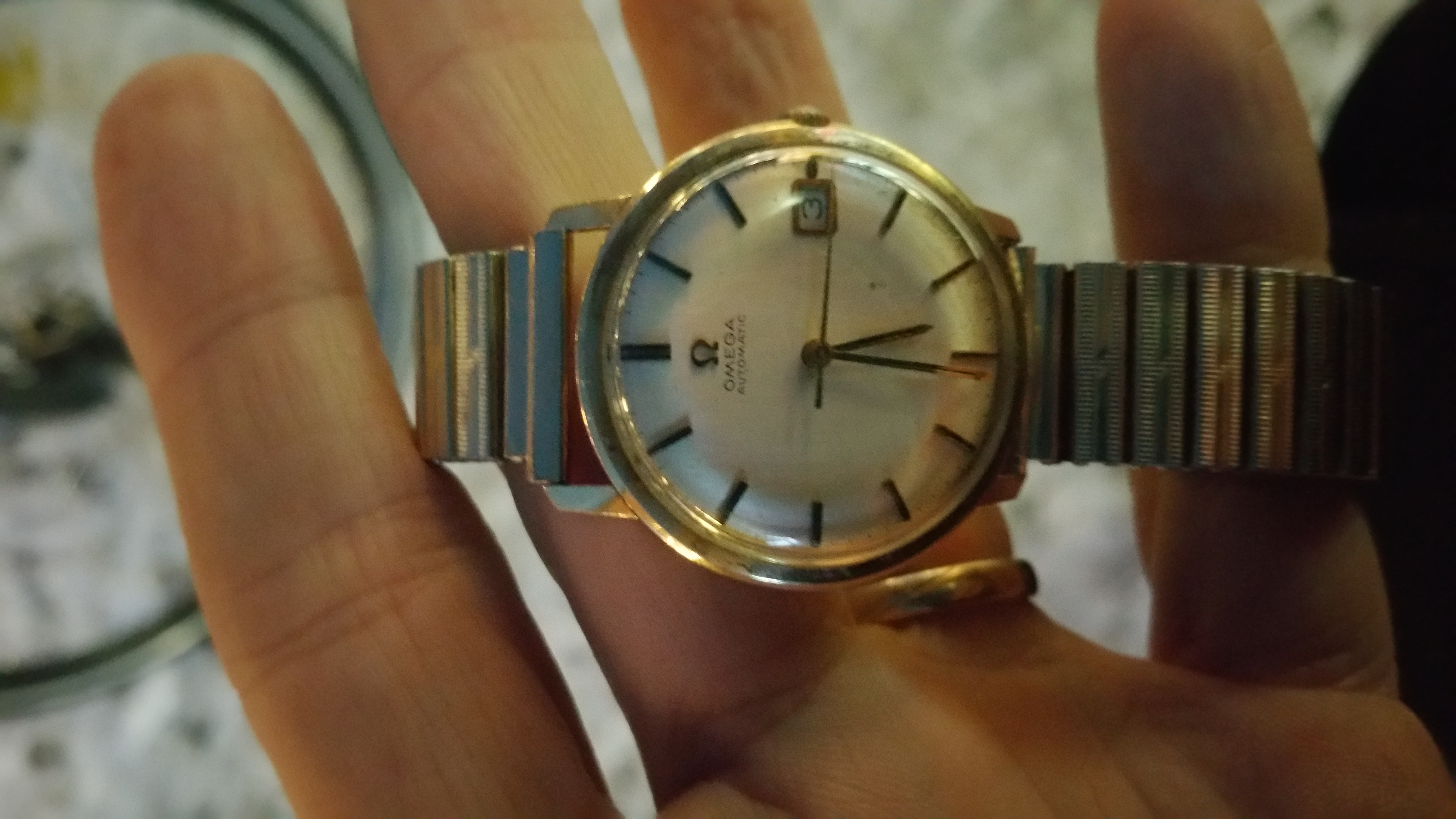

    omega1969.jpg Hi
    I just found my dad's old watch he used to wear until the 90s (he died last year). It is still running and I am wondering if anybody could tell me more on the watch. It was bought in 1969. It shows the day of the month and there is no text below the center. My mother told me that it is a gold (plated?) watch. I have a picture attached.
    I think it's monetary value is not very high, but for me the emotional value is.
    I have added a picture.
    Cheers
    Renger
    Edited Jan 3, 2017

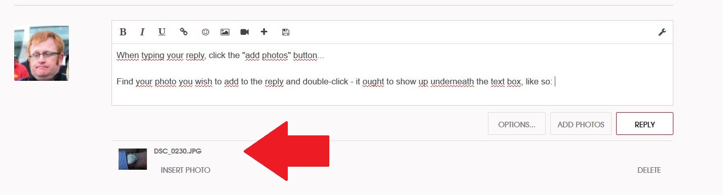

    Hi
    I added a picture, but I don't see it.

    it was too big, therefore the "insert photo" didn't show up...

    Hi Arney and welcome!
    As mentioned above, we need more to tell more, please follow the guides and we will be able to give you much more help.
    Based on the picture you show, it might be a reference166.0037 with the caliber 565 automatic movement.
    This one would normally say Seamaster on the dial but not all of them did or perhaps your dial may have been repainted during a service.
    Value is based on Dad's memory.
    Unless this happens to be solid gold, it's value without memories is probably a few hundred at best.
    With memories, it's priceless!
    Please don't wear/wind it until servicing as you can cause damage.
    Get us some good pictures and we will try to help you get the watch ready for another 50 years!

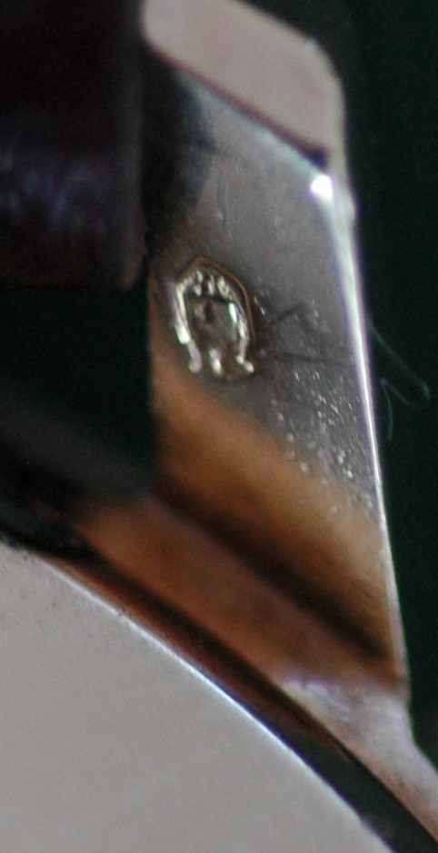

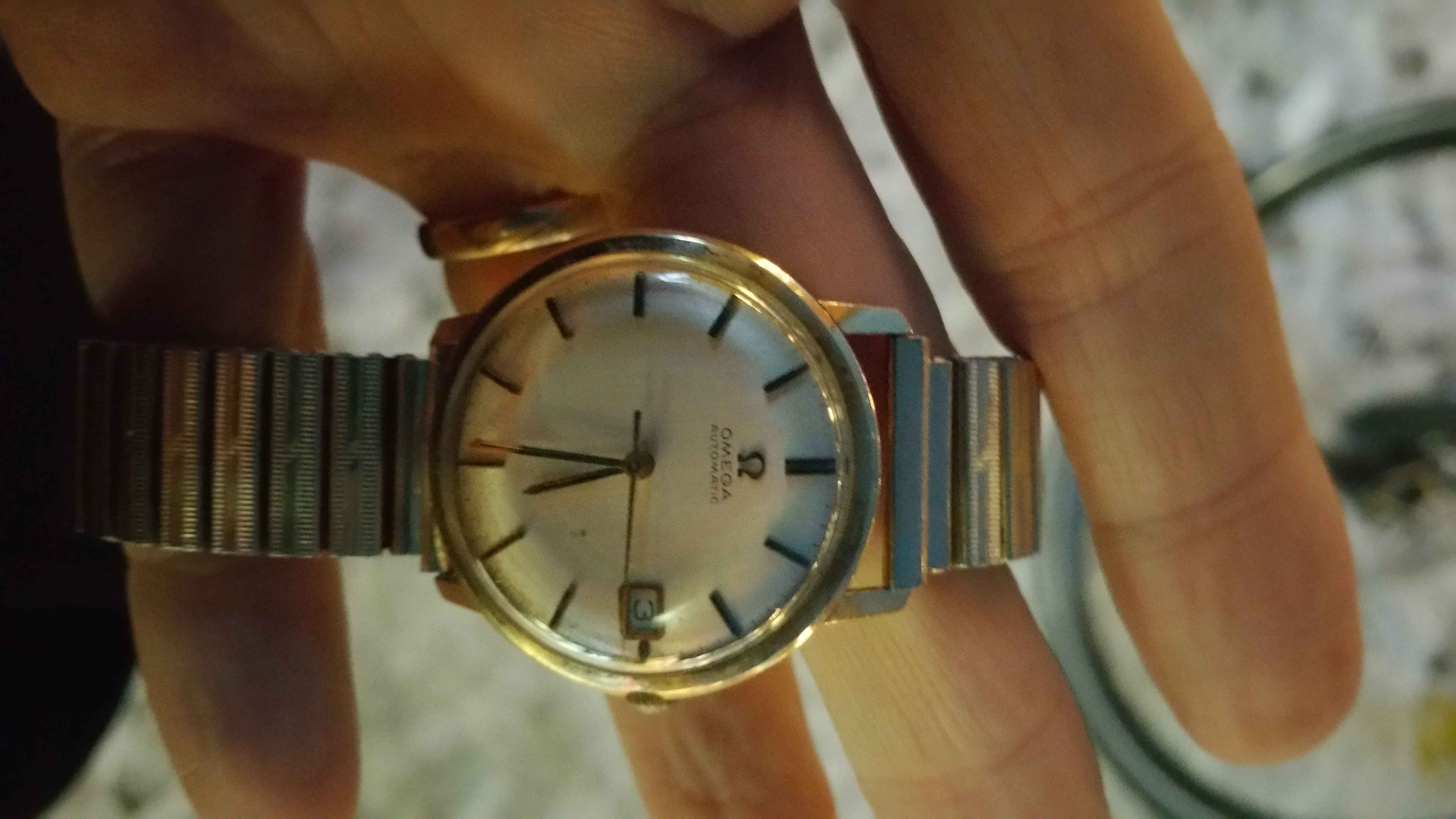

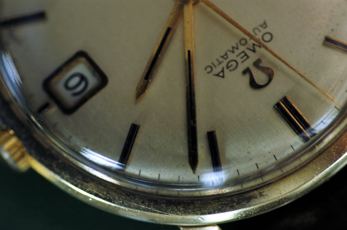

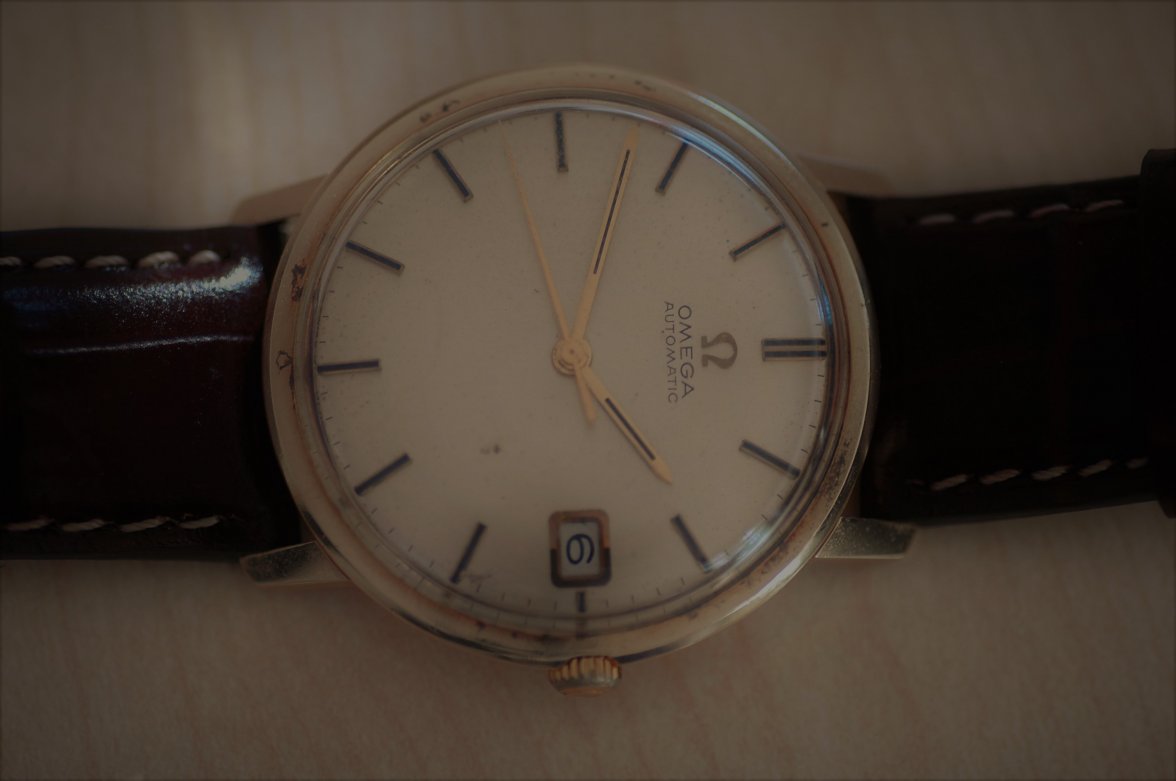

    So, here we go with all possible information on my watch (incl. better pictures; if I don't know the exact english term, I have put " " aroudn the word)
    - It is a gold watch (there is a small "imprint" at one of the extending parts at the back (see picture)
    - There is no type given (just Omega automatic).
    - bought in 1969
    - It looks like a deville (if that is a type). The 6 (1 bar) is however not like the 12 (two bars)
    - the back doesn't have anything on it
    - the "screw" has the omega sign on it.
    I hope one of you is able to tell me what kind of Omega this is (although, I am already very happy having it as a reminder of my father).
    Cheers
  17. ConElPueblo Jan 6, 2017
    9,587
    26,978
    - It is solid gold, the "imprint" is called a hallmark, and is a stamp that denotes that it is gold. It looks like a squirrel (upside down...) and means it's 14K gold.
    - It's pretty normal that there aren't any names on the dial or inscriptions on the rear. Not all Omegas have model names.
    - The "screw" is called a crown :) It looks like it could be the original, it is very worn, however.
    Looks fine.
