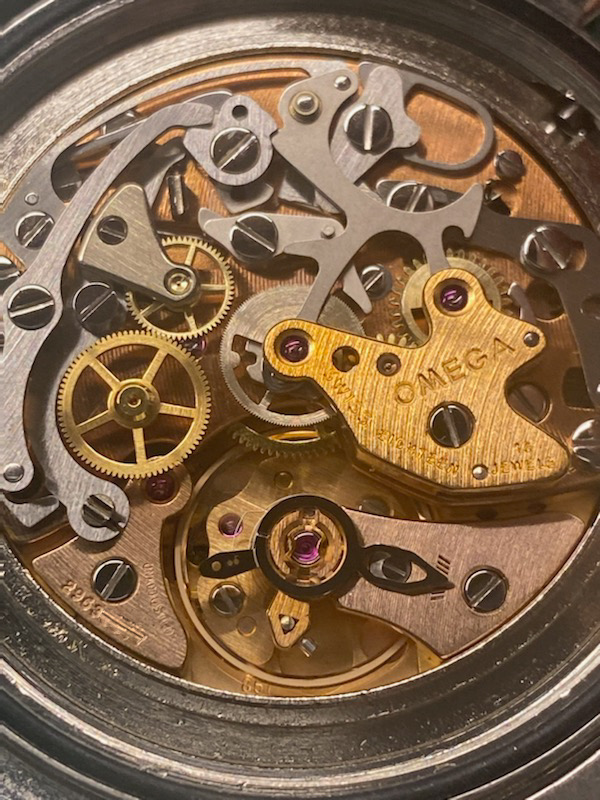

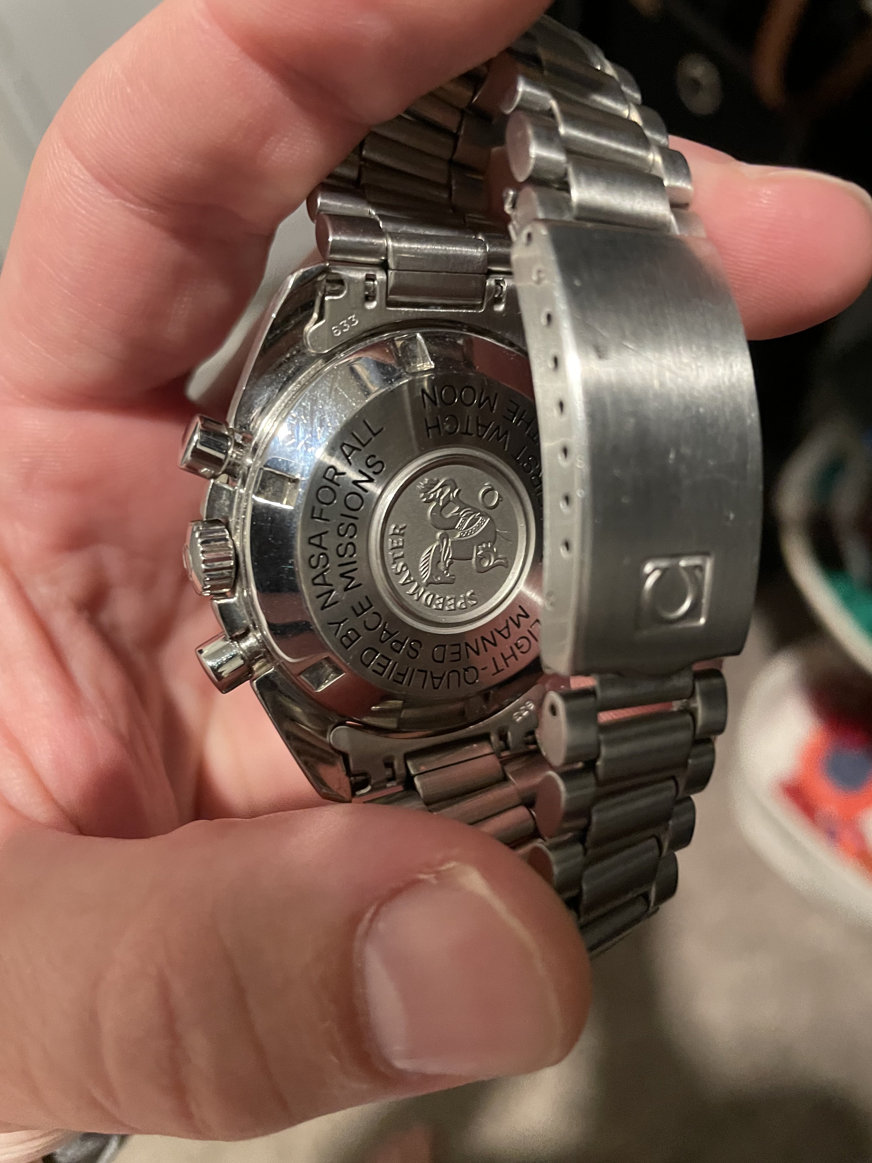

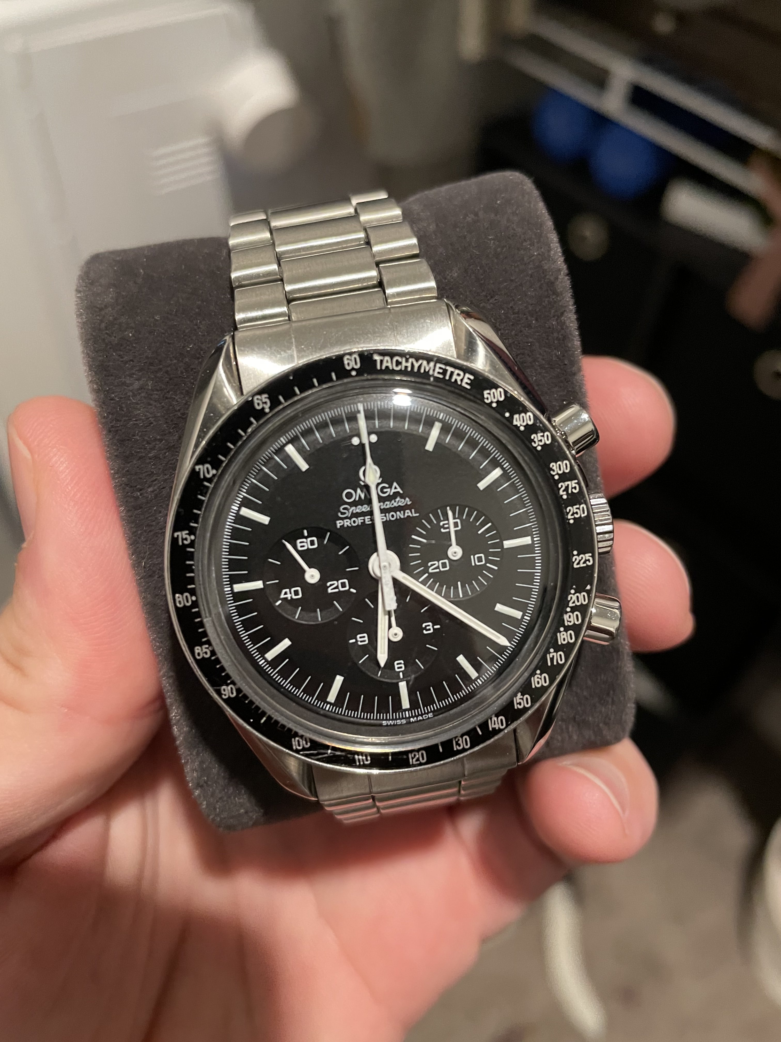

New here and looking for some insight on a Speedmaster I have purchased from a reputable Rolex dealer in my area. I am new to vintage watches and this is my first Omega. I’ve noticed a few oddities about this watch since purchase a day ago. The watch was listed as a 145.0022, but I’ve dated the movement (serial obscured in pictures but you can see the first 4 digits) to a 1970 145.022. The movement engraving "861" does not have the Omega symbol before it like I've seen in other images online. The chronograph bridge also looks different than other images I’ve seen online with the “Swiss” engraving to the side of the Omega engraving instead of below it and seems to be gold instead of the copper color. The case back also appears to be non original but I am less sure about that. It is a moon watch case back as one might see on a 145.0022 and current. Lastly, the dial and lume are in impeccable condition. I feel I got a great deal on a watch I’ve really wanted but want to make sure I know really what it is. I am also aware that a watch of this age is sure to have seen service and not sure if that would explain any of these oddities. Any thoughts or insights would be greatly appreciated!

It has a service dial, hands, and caseback. That would explain why the movement is from 1970, but those parts are all newer.

The reason why the dial and hands are impeccable is that they are modern Superluminova replacements. This is a bitsa watch with lots of mismatched replacement parts. It may have been a 145.022-69 at some point but now it is a mashup of 1970 movement and bezel with a modern dial, hands, bracelet and caseback. Or is is a modern 2000s Speedy into which someone has dropped an older 861 movement and swapped on an older DNN bezel, both are possible though the latter is less likely. If it was truly cheap then all is well, but if it was more than, say, a 10 year old model then it was overpriced.
Looking again I think the movement has been messed about too. The 1970 era 861 was a 17 jewel count movement, it went over to 18 jewels in the 1990s AFAIK. Maybe some of the bridges have been changed, that would explain the colour mismatch.
In summary, I hope it was cheap!

Also, the bracelet is an 1171 that shows considerable age so I’m thinking that is original

The square logo and 633 end link slot design says it is not a 1970s 1171, those had trapezoid logs and screw links. The clasp engraving will tell you more but I bet it is a 1171/1 or later 1171/633 from within the past decade. This is why I called it modern above.
clasp does indeed say 1171/1.

IMHO, 3900 for a parts speedy is a bit strong. You can definitely find an unmolested example for that, though it won't look as clean. All depends on what you're going for.
