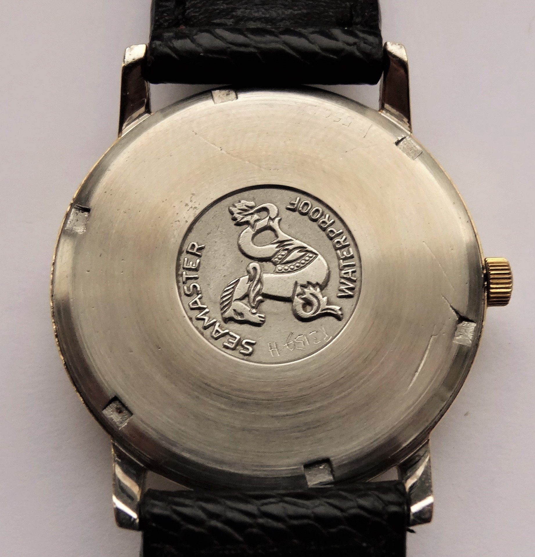

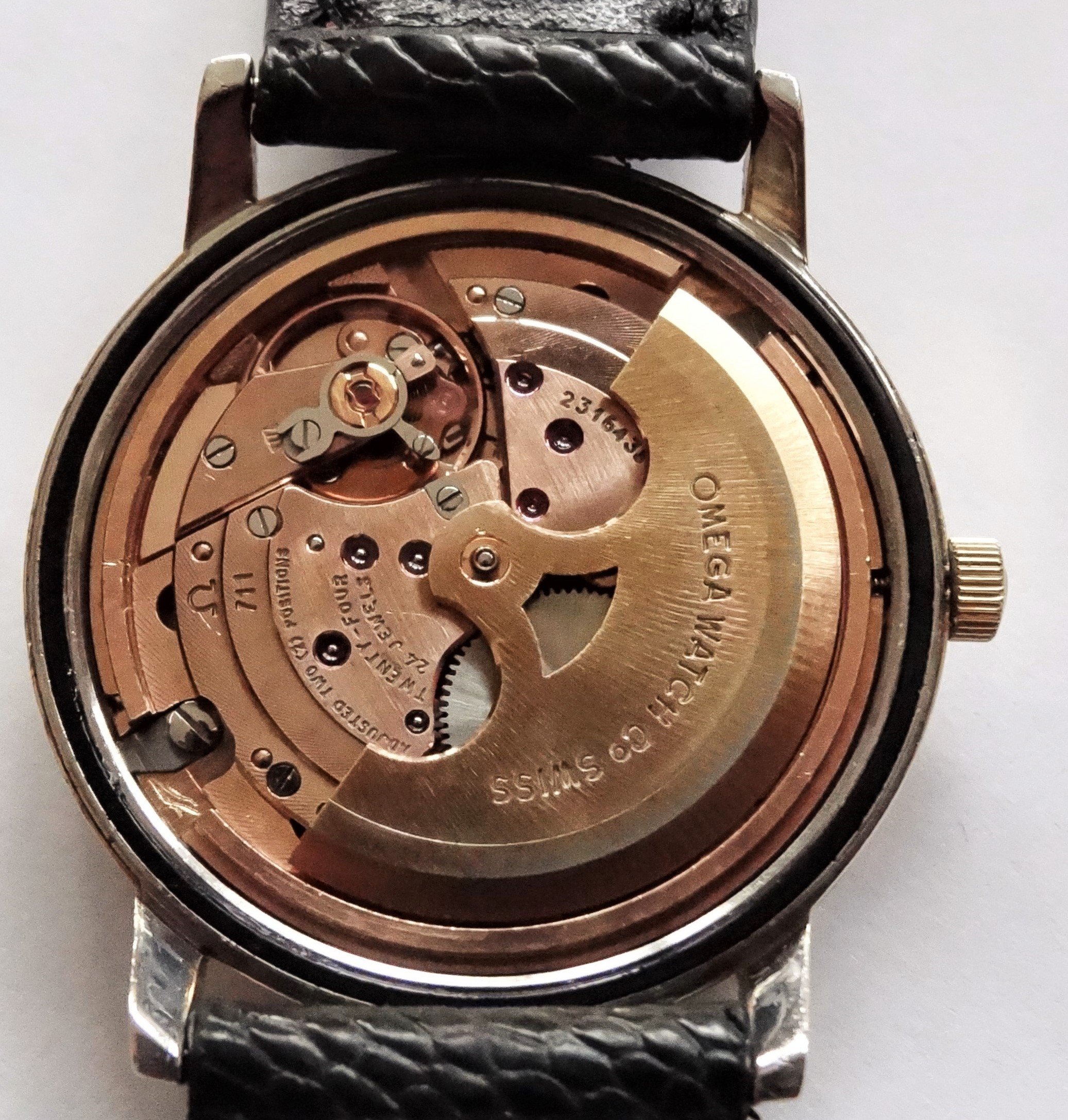

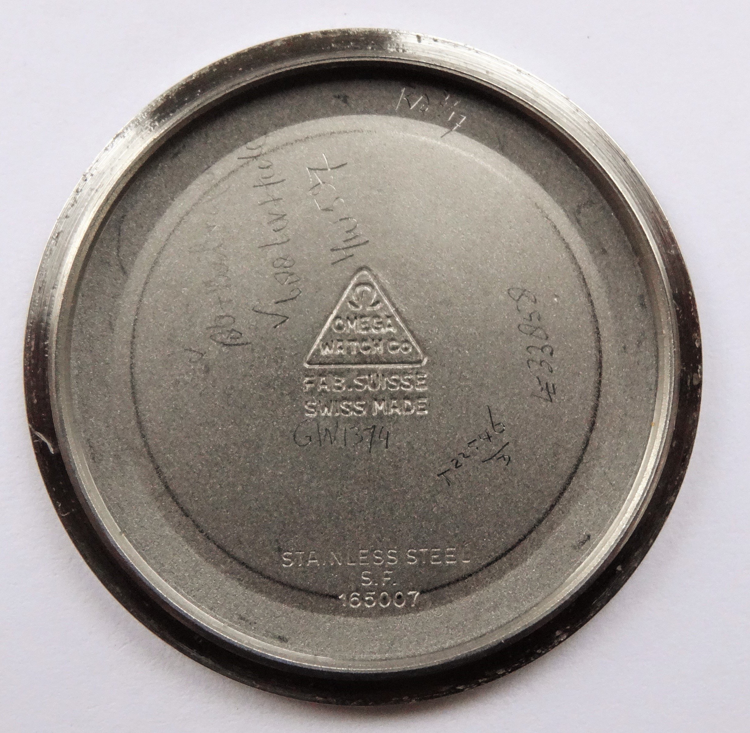

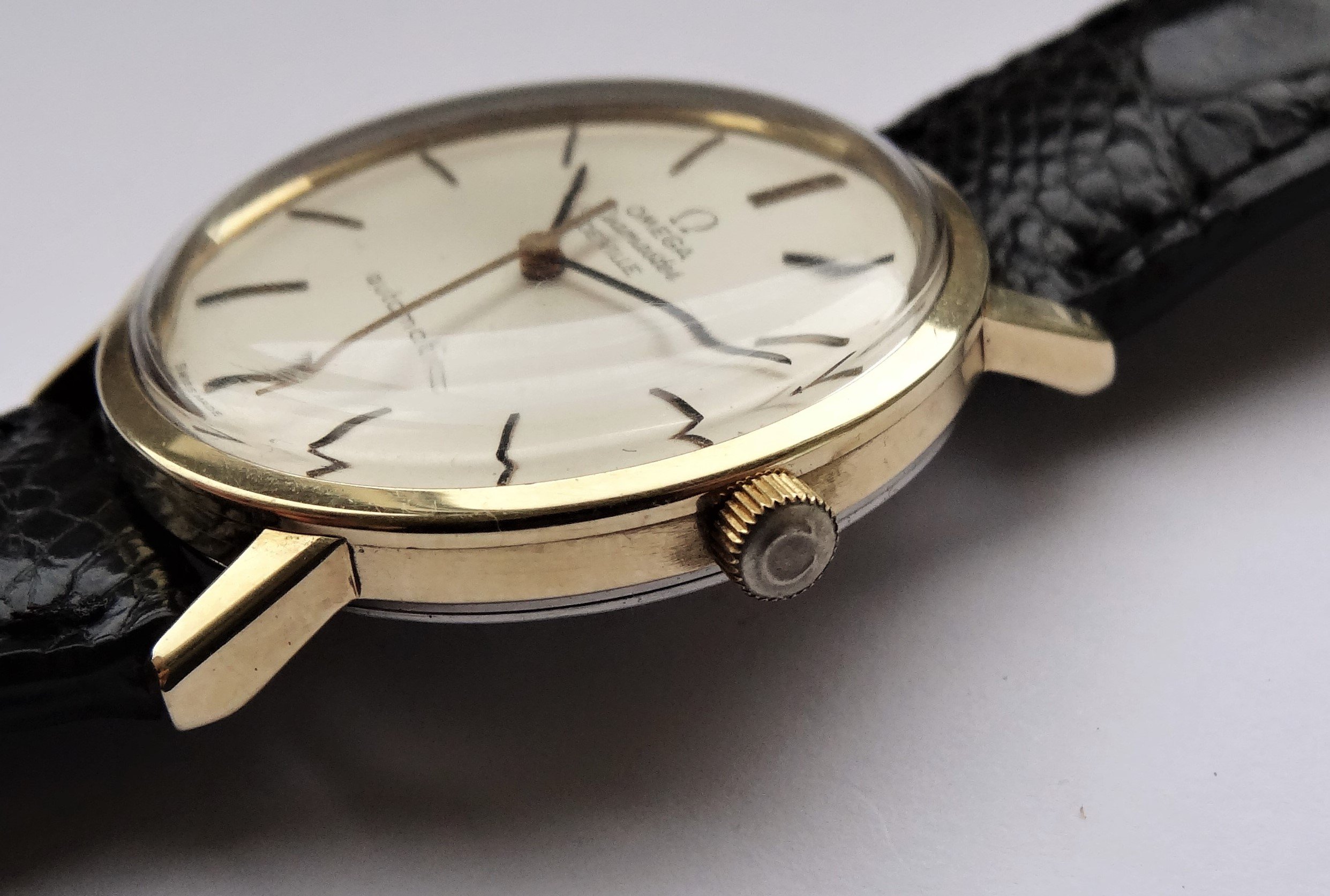

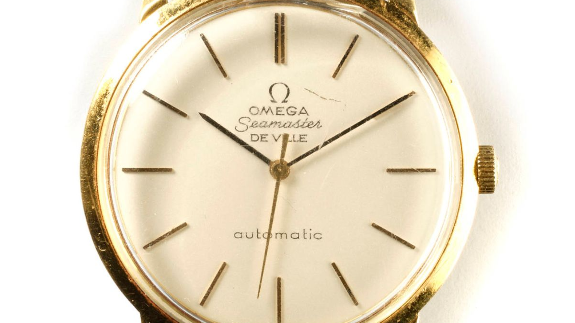

Hi everyone,
Currently I am looking to buy my first serious watch. After a while I made my mind up and decided what I am looking for: a vintage Omega, with a strong preference for the Seamaster model. And a specific model caught my eye; a Seamaster Deville, from around 1966 / 1967 with the reference 165.007.
Obviously, I have done research myself. First of all I have checked the given info on the Omega database and that all was what it should be. I also googled the model, series etcetera to get aware of any flaws by comparing it to other watches.
But before I decide to make a bid, I still have some questions for you guys:
* First of all, does this model look legit to you?
* Does the crown look original?
* Do you see any flaws, that my unexperienced eye did not notice?
* And last, but not least: what value would you give this piece?
Info:
Model: Seamaster Deville
Reference: 165.007 / 165.0007
Caliber: 711
Movement: automatic
Material: Stainless steel & 14k gold
Size: 32,5 mm (without crown)
Thanks in advance for your help!
3,651
7,968
Looks like you have done some homework. What do you think? How would you answer your 4 questions? What is asking price?
how do you assess the dial, case and movement?
Welcome to OF
5
Thanks for your quick response!
To answer the questions myself:

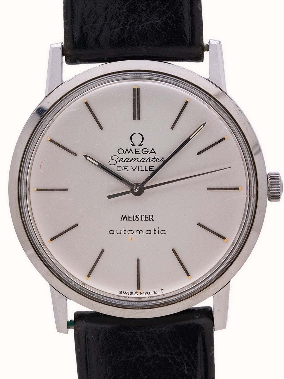

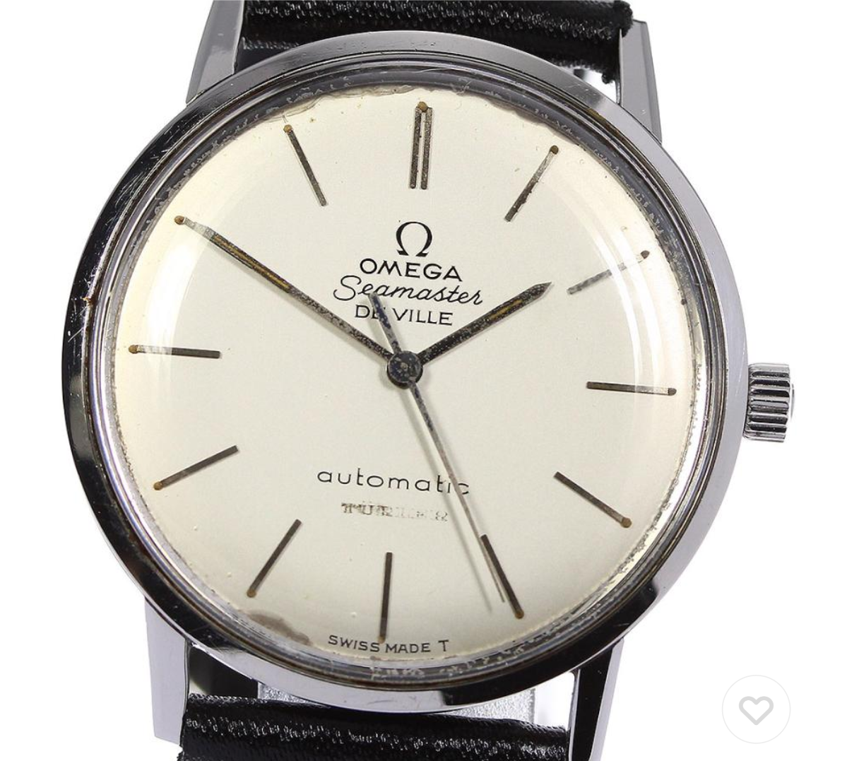

* To me looks the watch legit. I was specifically looking at 2 things that drew my attention: the fact that "automatic" was written at the downside of the dial and the fact that the watch has no indication per minute. But for both questions, I found watches in this serie with the same specs.
The dial looks quite fresh, but also some signs of usage. Which comforts me as well, that is not renovated etc.

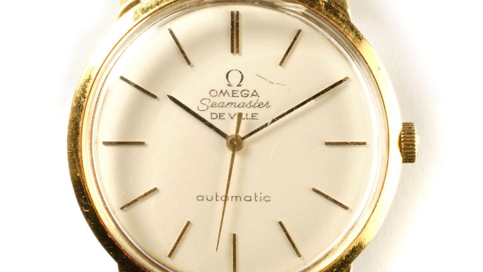

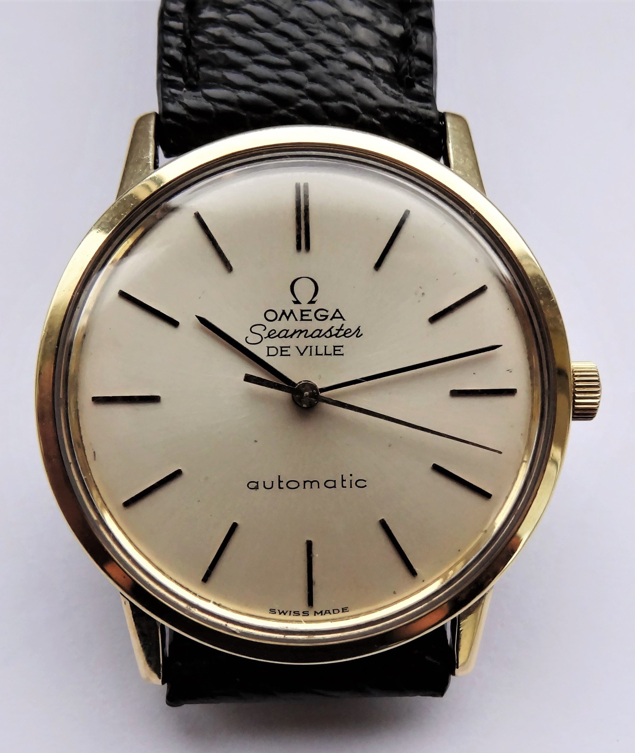

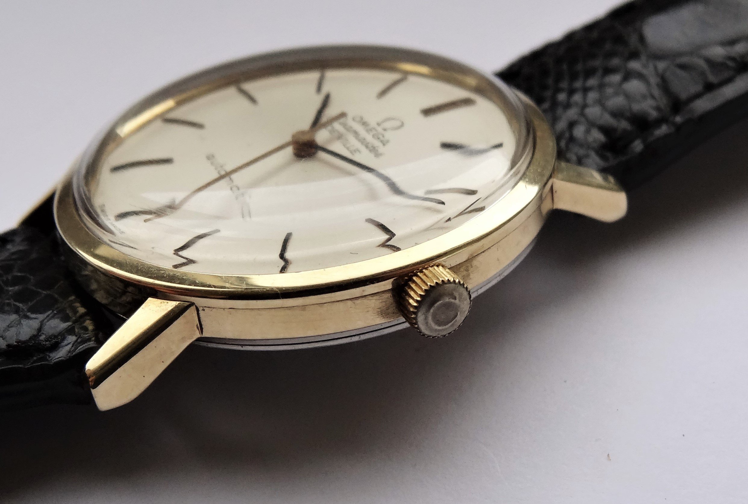

* The crown is something I can not really assess to be honest. On the second picture the crown looks kind of old, but on the 4th and 5th pic the crown looks a bit more shiny (perhaps newer?).
* I don`t see any flaws myself
* Regarding the price, I would say somewhere between 800 and 1100 dollar
Overall: the watch looks in good condition to me. Used, but not damaged. Just how I personally would consider vintage.
But than the question: am I missing something or is my observation legit?

Are you aware that this is a very small watch? At 32 mm many would find this too small, but may be suitable if you have small wrist. While it may not seem a significant difference 32 mm wears way smaller than 34-35 mm which is more common vintage size.
I would share some concern about absence of minute track which can be indicator of redial. But not sure
5
Actually, I am aware of that. And since I have small wrists, that could work out perfectly. But I have to see it on though.
Is there a way to determine if the minute track should be absent on this model?
Other than comparing to other models in the same series I mean. I have checked this model and I have seen 2 of the same watches, also with the minute track non excistent.
3,651
7,968
I’m not sure about minute track. Personally I would prefer a minute track, but I suppose absence has a dressier look. How do you feel about that?
See if others have opinion about dial originality. I would wait before buying for other opinions.
5
Personally, I think it looks good on this specific watch. But that is just a matter of taste, I guess.
I found 3 other watches from the same series, with all no minute track. And the details of the text on the dial (position, way of writing, detail of the font etc) all look the same.
So my personal judgement would be that this one looks correct.
But very curious to see other observations.

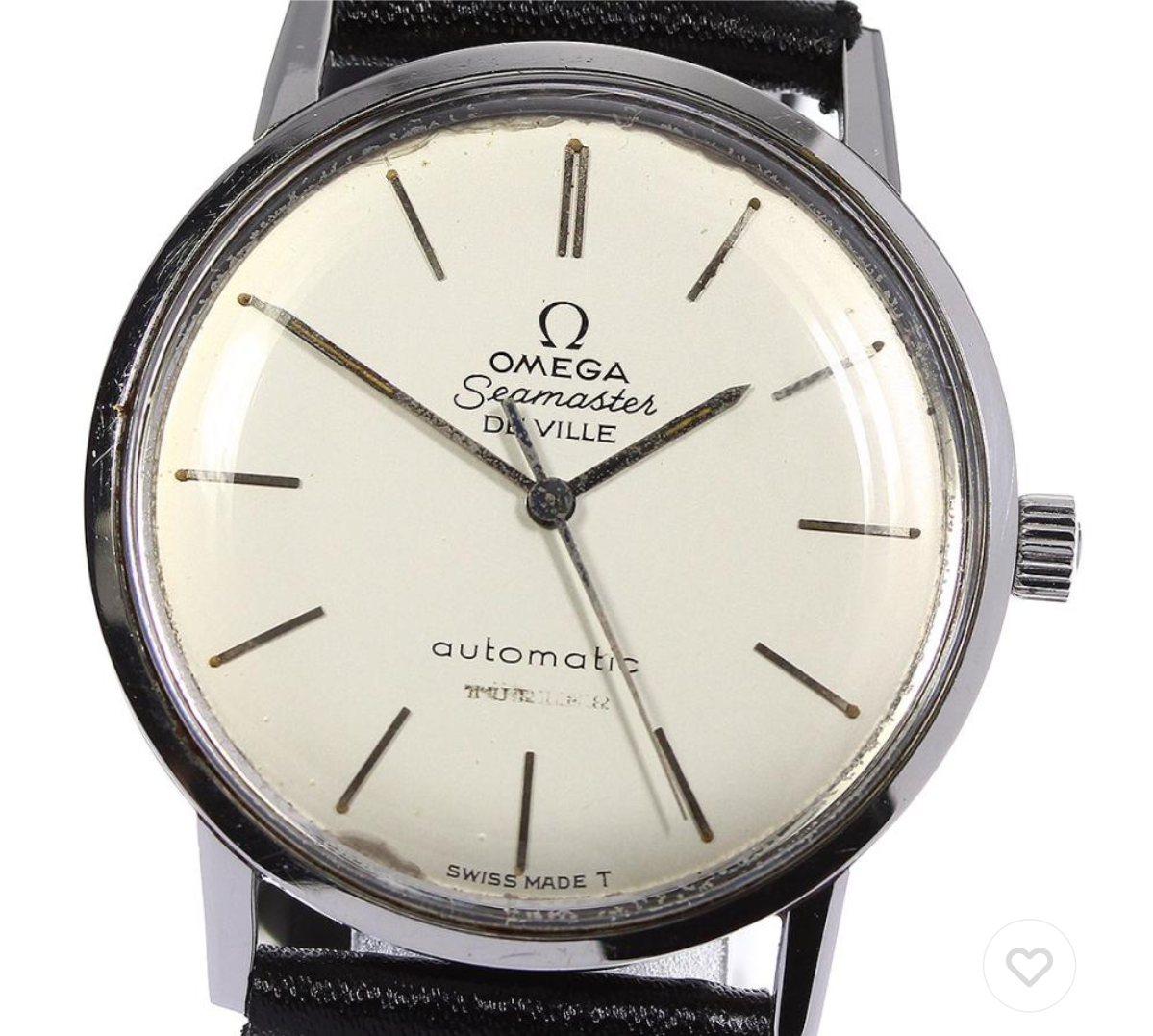

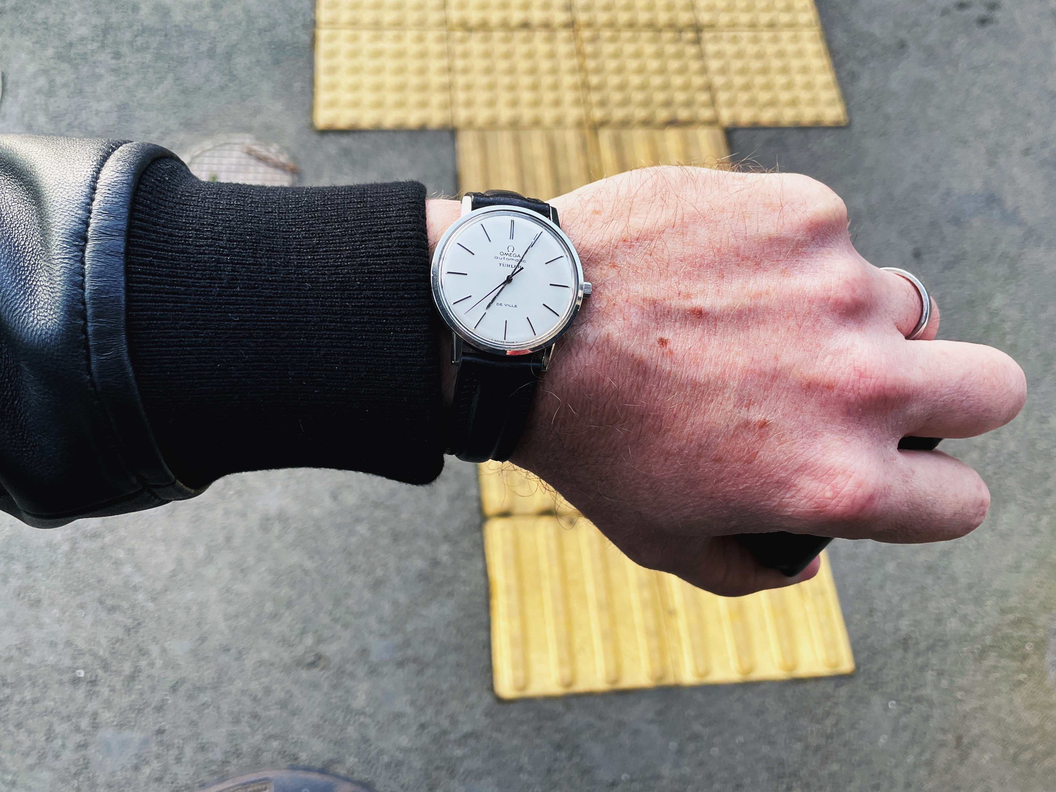

I have a Reference: 165.0008 from 1966 with a Cal: 711. This caliber was the thinnest automatic watch Omega ever produced, hence the strange lower case 'automatic'.
I love the simplicity of the dial and lack of minute markers... As a result of this minimalism it's one of the few Omega watches that comes close to the elegance and simplicity of a Nomos or Max Bill Junghans.
I'm a fan.
5
Yours looks great as well! Totally agree on the elegance and simplicity. What size is yours? 34,5 mm?
So you think that the one I posted looks legit as well?
678
5,569

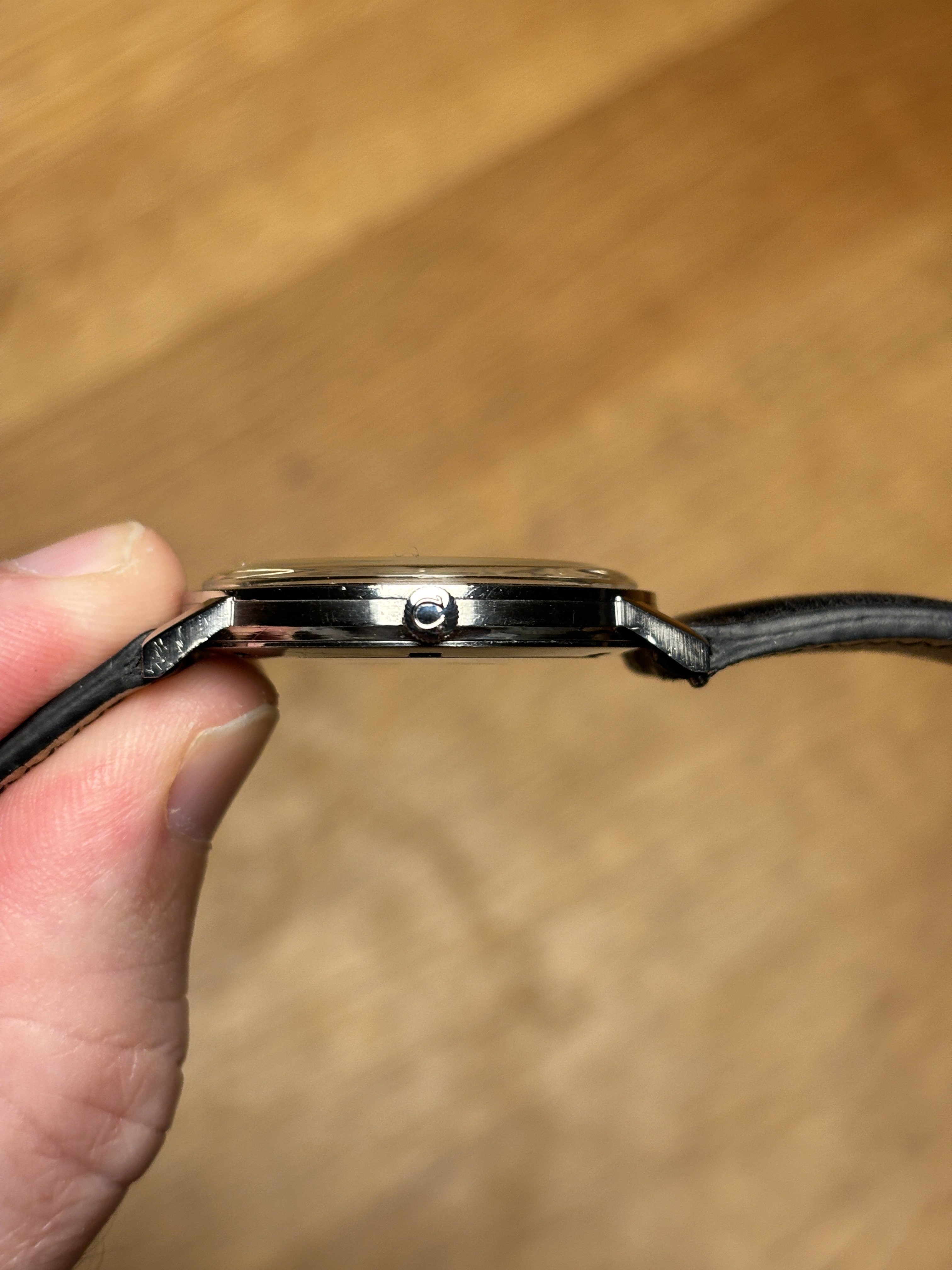

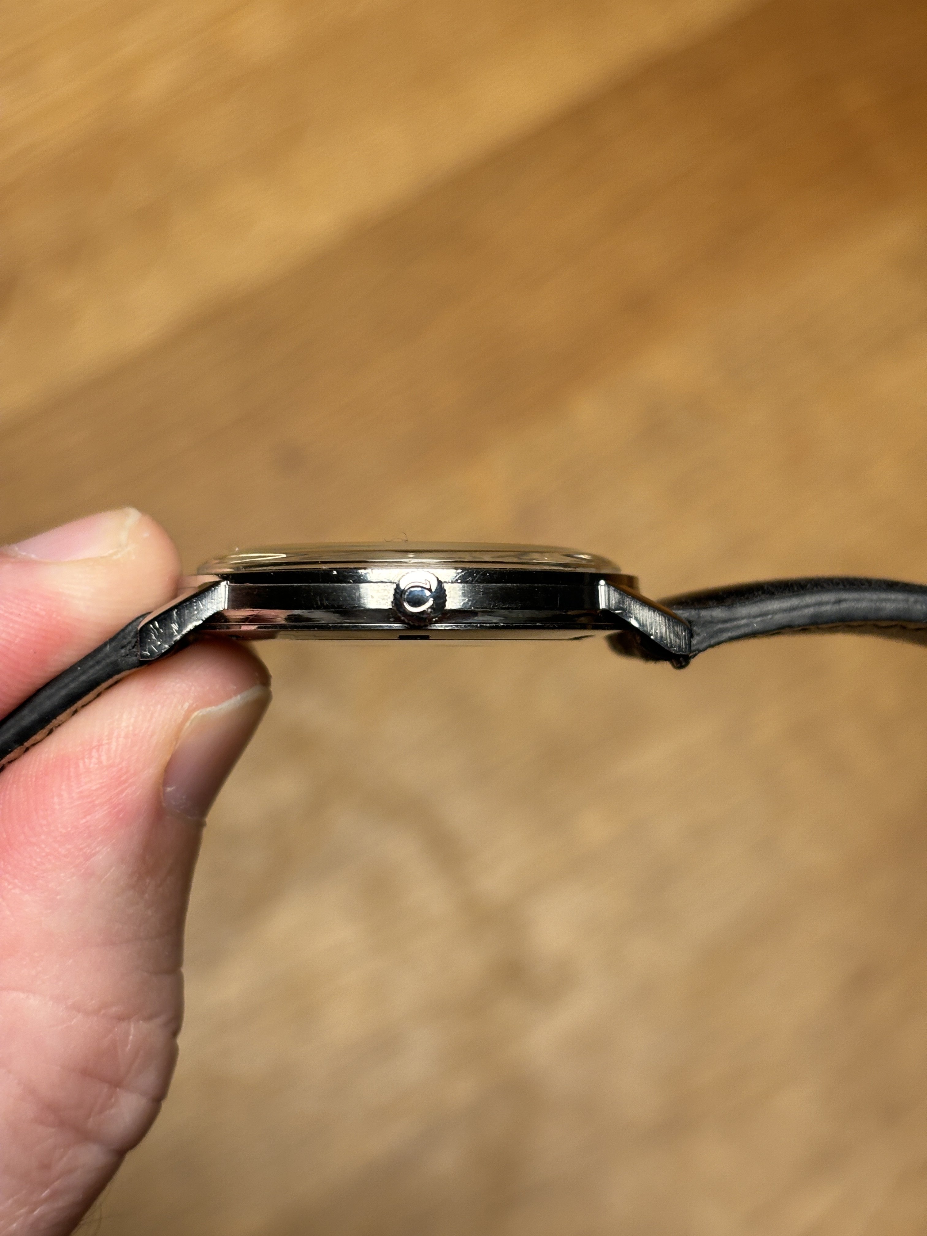

Yes, it's 34.5mm... which if you have massive wrists might not be the watch for you. In regards to legitimacy I'm no pro, but using my Dunning-Kruger fuled wisdom I would say that the one you posted looks legit...
Here's a side shot of mine to give you a feeling of the thinness... crazy to think there's an automatic movement in there.
