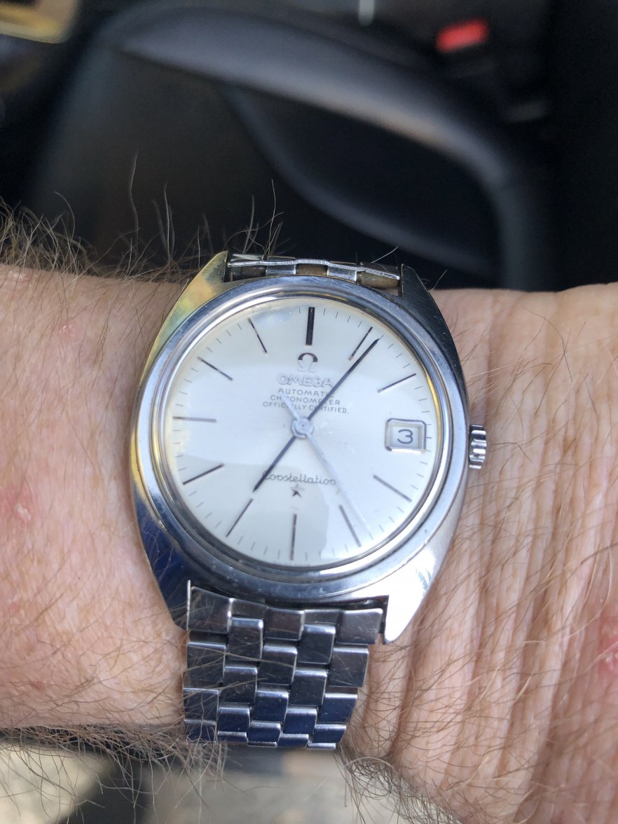

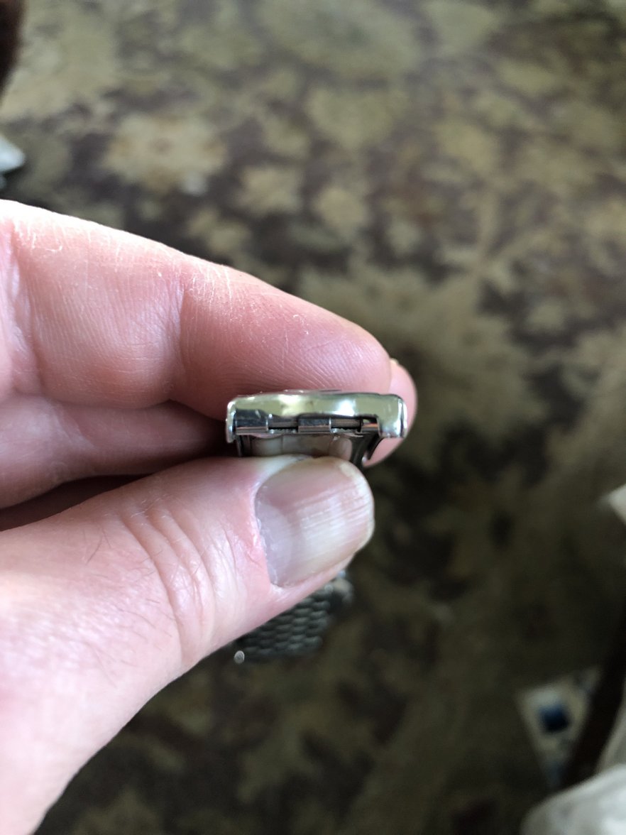

    Hello. I picked this up about a month ago. Finally got it out of service. Watch cost 350, service 180. Only issue I have is with the clasp. One side is missing a tooth so it only catches half way. I can hunt down the clasp when I figure the size but I I’m thinking of getting leather as well. I was hoping one of you learned here can tell me the year and the movement and any other info. The date changes simply by pulling out the crown. One day for each pull. I don’t know the value of the watch either. So far I’m in around 430 which included the service probably got to drop some cash on the clasp. No way an I selling it but I’d just like to know 9F218E09-2CCD-4534-87AA-7F489044F671.jpeg

    Should be a 564 movement. Year can be known from serial number, whch is inside. Price is a huge bargain, congrats!

    Cool thanks. Do you know a ballpark figure. There is a little damage on the dial right on the edge I think from an idiot changing the crystal but it’s not that bad. Do you think it would be dumb to but leather on it when I have the original brick. I’m more concerned about security and it’s a little tight.

    Hey walrus, looks great and congrats. Post a pic of the broken clasp-if it's just the top cover, that’s easily replaced. I had a bad one on a bracelet and bought the cover part on eBay for $18, took 5 minutes to swap out.

    Yes it is just the top cover part. How did you buy it did you just go by size?

    Yes, I measured it and compared it to ones on eBay, found one that was minty clean and it was identical, fit right up when I got it

    It’s important to note that they are two kinds of closures on these clasps, the ones that pinch in the sides and have the open front and the ones with the hooded fronts that clamp the bar on under the omega logo. If you know which one you have you can compare and find a match.
    Here’s an example of one- never dealt with this seller and don’t know if it’s the same as yours but compare

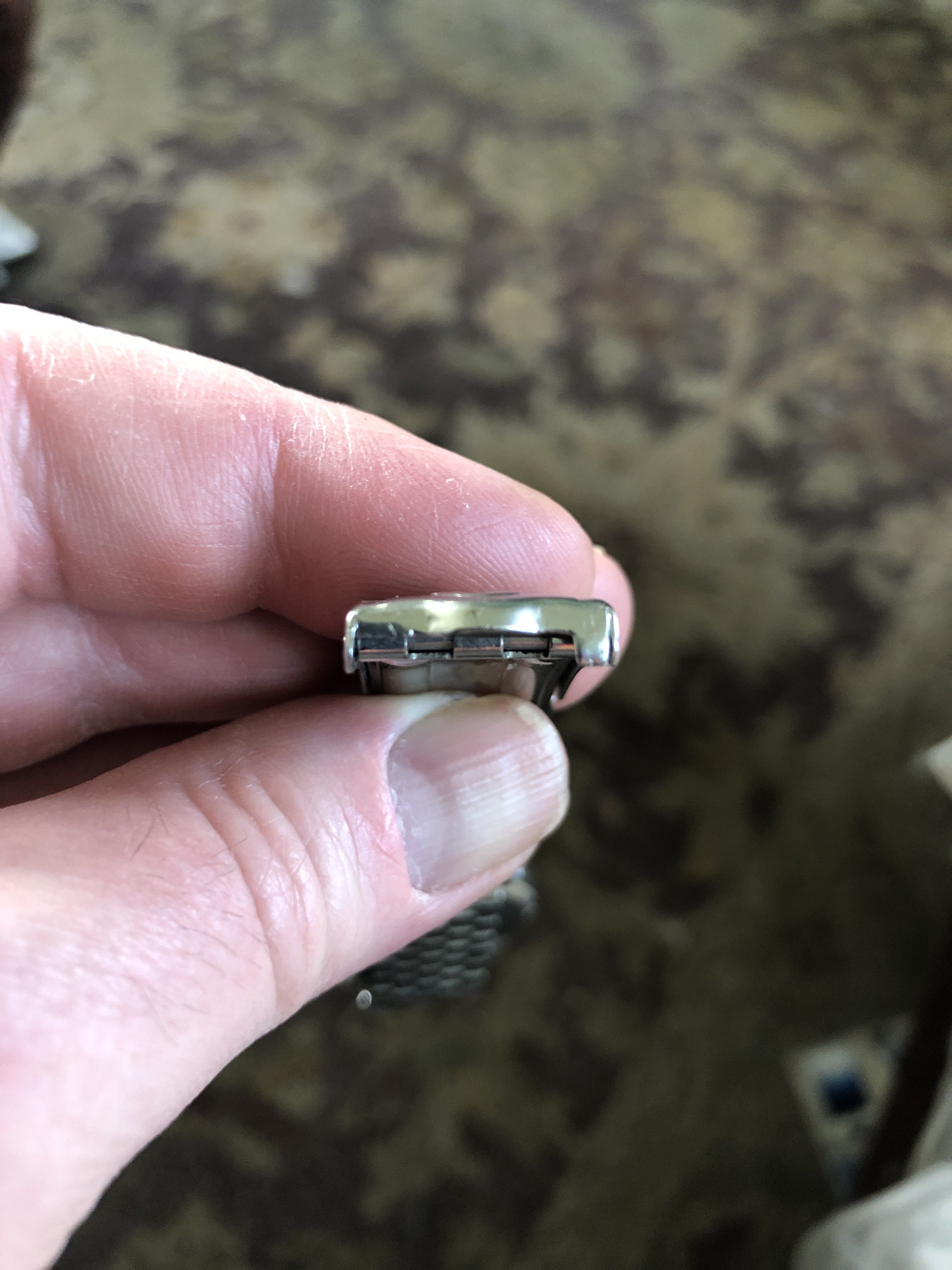

    Here it is I think you can see where one of the teeth is broken off image.jpg image.jpg

    Yup, it’s the hooded. One like the second link I sent is what you need. Just search “omega bracelet clasp” and you should see them mixed in with generic and modern crap

    You could also contact @No Mercy who deals in lots of bracelets in the classified’s- he may have a clasp for you. Replacing the cover is two pins and you’re done
