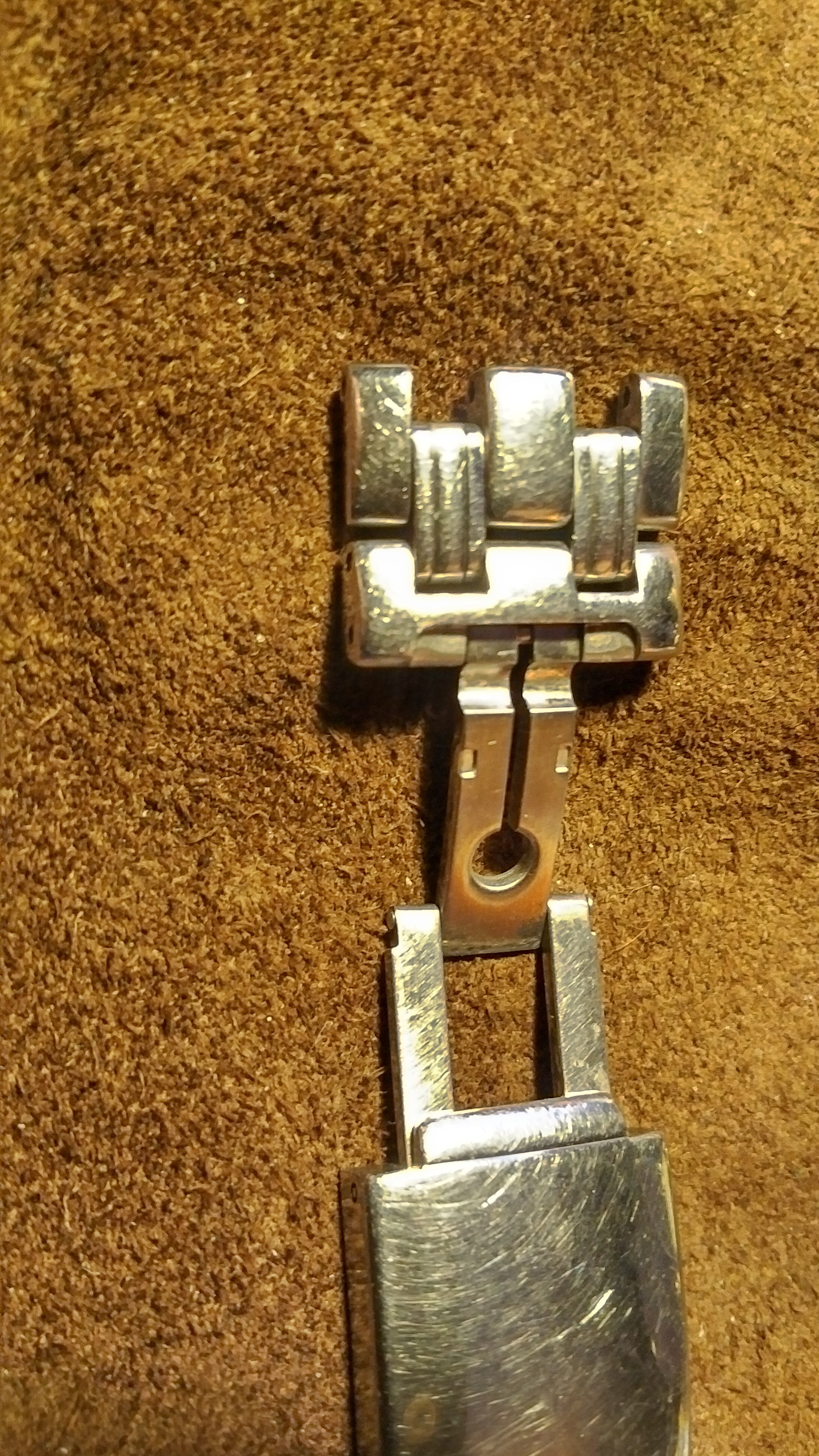

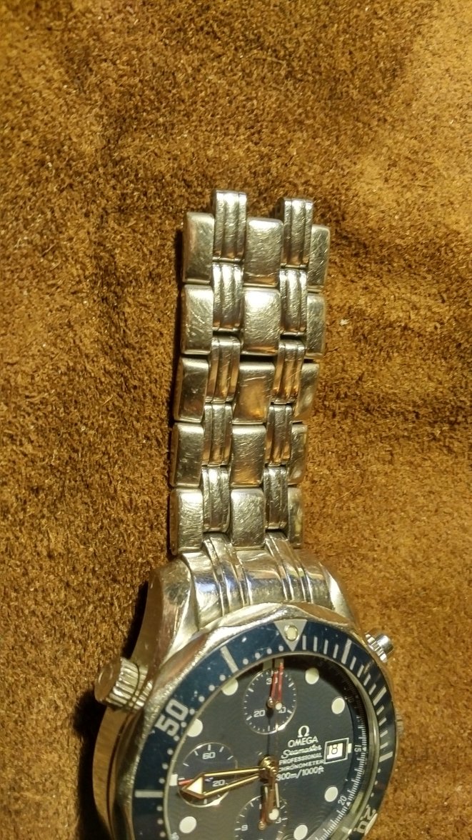

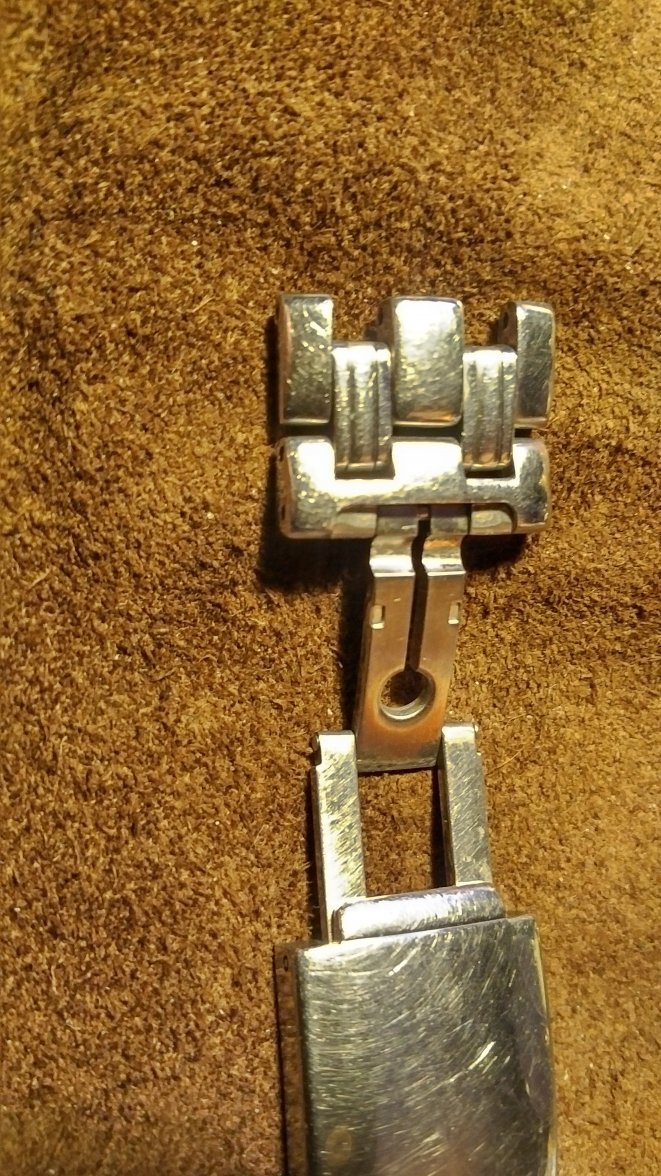

    It's been said before but it bears repeating - you're a godsend when it comes to finding part numbers (as well as sharing your experience and knowledge in all other aspects). That part number shows straight up on Cousins and they have them in stock. There are no tubes in the links, so that may well be the part that failed and then the pin fell out. I've had the bracelet off and run it through the ultrasonic cleaner but I think I'll run a cape cod cloth over the clasp for him too (he wears this every day in alsorts of conditions and it shows!).
    There's a couple of photos below if you wouldn't mind looking and please tell me if I'm doing anything wrong with ordering the regular pin and tubes.
  4. Archer Omega Qualified Watchmaker Jan 18, 2018
    26,440
    65,428
    Regular pins and tubes for that link - the others are for attaching the clasp to the bracelet. Just remember 2 tubes for every pin on this one.
    Cheers, Al
