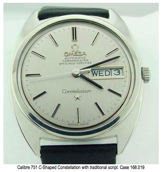

    the font is unusual in white -but looks pretty good to me -the photos aren't quite good enough to be sure
    pretty sure you are right to be worried about the hands

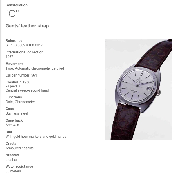

    hands should probably match the markers and look something like this
    Desmond's site does show some later 751s with solid black hands -but with silver second sweep hand
    Possibly a later service replacement set of hands on the eBay watch ? -but not right IMHO

    White printing on any Constellation dial scares me. Not sure if these originally dials came in black. Post 1970 cal. 564 models had many odd colors on the dial ( I've seen blue, green and grey), but early cal. 561 "C" cases? Not so sure.
    Pictures are so out of focus as to be virtually useless. Also, no movement shots, so you have no idea what is inside.
    The buckle and band are OEM Omega replacements, so that's good. Box is a older Omega service box, I think.
    Too much risk, not enough reward for me.

    While almost anything is possible with Omega, this one doesn't pass muster. The white hands just don't go (they were probably painted because they had no access to the correct hands after painting the dial black), if you look at the hands on the watch from Desmond's blog, the base of the hands is silver, with black over. I don't recall ever seeing a legitimate black C case dial either and as noted white printing is a big red flag.
    PASS at any price.
