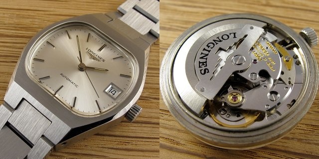

    The 890 and 990 series are the ones you'll find in the square / rectangular cases from the 70's and early 80's. Here's one with an 890 in it from 1977:

    The Conquest models used to have all in-house calibers when they were introduced in the 50's, but that changed in the early to mid 60's.
