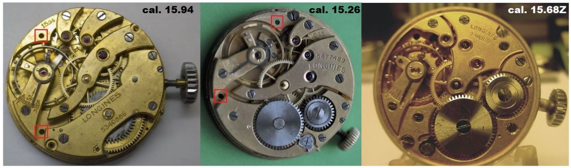

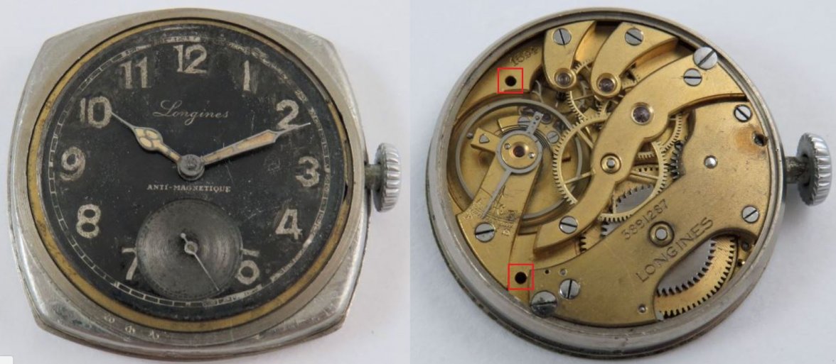

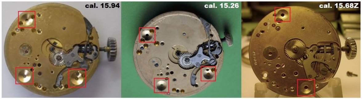

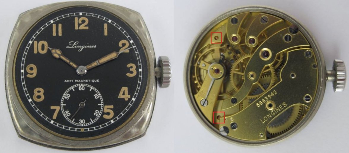

Much has been written about the so-called 'Majetek'. Apart from the history, it is well-known that three different calibers were used. It is also common knowledge that earlier examples, with the cal. 15.94, have enamel dials while later ones, with the cal. 15.68Z, are found with metal dials. Some may know that examples with the cal. 15.26 can be found with two very different enamel dials. However, the details surrounding dial variation and movement/dial pairings, are worth investigating further. Since dials must be mounted onto movements, we must first study the three calibers. Looking below, it becomes clear that the cal. 15.26 is an evolution of the cal. 15.94. The two movements share a number of traits including the quantity and location of the holes for dial feet (highlighted below). In contrast, the cal. 15.68Z is largely unrelated and has only two dial-foot holes, which do not overlap with the equivalent holes of the other two movements. This suggests that dials could theoretically be shared or swapped between first (cal. 15.94) and second series (cal. 15.26) watches but not between third (15.68Z) and second or third and first series watches. Based on my research, the third series is the most straightforward. No dials are shared with the other two series and only one dial variant seems to exist (M1). The second series is less cut and dry. The earliest examples are found with one type of enamel dial (E1), while later examples have another (E5). The dial variant (E1) that is found in early second series watches is also found in first series pieces across a wide range of serial numbers. The first series is the most complex. In my estimation, there appear to be four correct dial variants, all of which are enamel (E1, E2, E3, and E4). As of yet, there is no clear order or connection between these four dial types and the serial numbers of first series watches. Given the increasing value of the 3582, there is a strong temptation to replace a damaged dial with a better one. Immediately below is an enamel dial (E1), mounted on a first series movement. The dial feet are clearly visible (highlited below). Next is a metal dial (M1) that has been incorrectly mounted on a first series movement. As you can see, no dial feet are visible. Not only are dials being swapped, they are being refinished and possibly faked. Below is a small selection of inauthentic dials for your perusal. I hope that this has been informative.

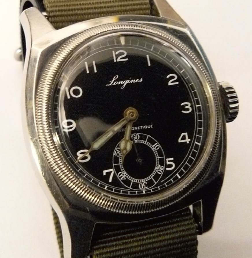

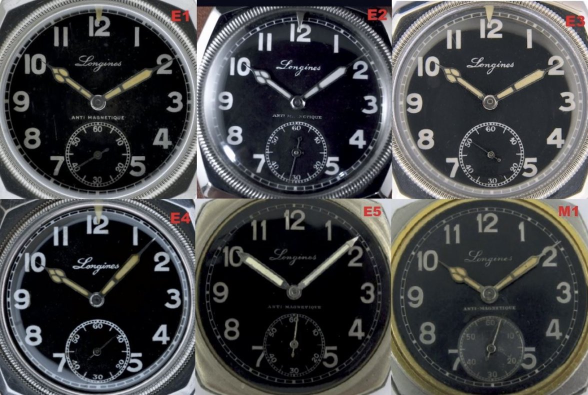

Great work! I have seen enamel dial that are shinny black glassy throughout and other that are matte black over white. Any thoughts about those variations?
I have observed similar variations in surface finish. I believe that this is an important detail and am presently looking into it.
As a preliminary response to @dodo44's inquiry, I have seen images of each, enamel dial variant that suggest there is a white layer of enamel underneath a black layer. However, this does not mean that all of the "printing" on the dial is exposed, white enamel from the bottom layer. It is clear that some of the "printing" on certain dial variants is on top of the black layer. Regarding surface finishes, I am still studying.

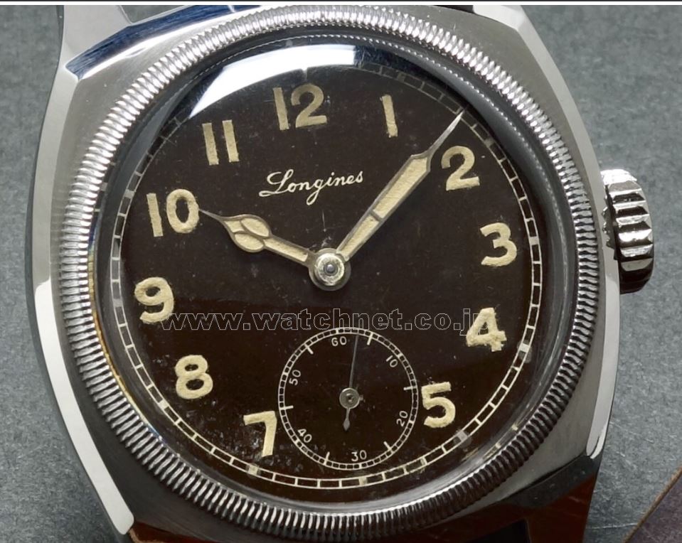

@DirtyDozen12 If you have time could you offer an opinion on a dial I have. There are plenty of pictures and some discussion over on MWR starting at post 32. https://www.mwrforum.net/forums/sho...gines-Ref-3582&p=349744&viewfull=1#post349744 I’m starting to wonder now if this is just an E1, but I thought all enamel dials had a glossy look and a kind of orange peel texture. This one is just completely smooth and matt black.
I thought I knew this thread well and didn’t re-read, but I’ve just re-read it and seen all the discussion regarding black printing over a white enamel base. This would make absolute sense for my dial as you can see a white line around the perimeter.
It’s what you would call an E1 then. Did you even see an E1 from the back ? I’ve searched but can’t find any images of loose dials and Ian’s dials that he just posted over on OF are the metal variant.
It was bought on eBay from a seller in Israel. I didn’t check until just now... simply thinking it was odd. But here’s an extract from the wiki page on Czech Republic–Israel relations. “Diplomatic relations between the countries were established on July 3, 1948, four months after the Communists seized power in Czechoslovakia. Czechoslovakia supported the newly created Israeli state for several months with military aircraft and weapons.” That’s a nice coincidence and the time frame is right. https://en.wikipedia.org/wiki/Czech_Republic–Israel_relations
looks good to me. had a few of these over the last 30 years. correct for the 1. and partly 2. movement variant. kind regards. achim
