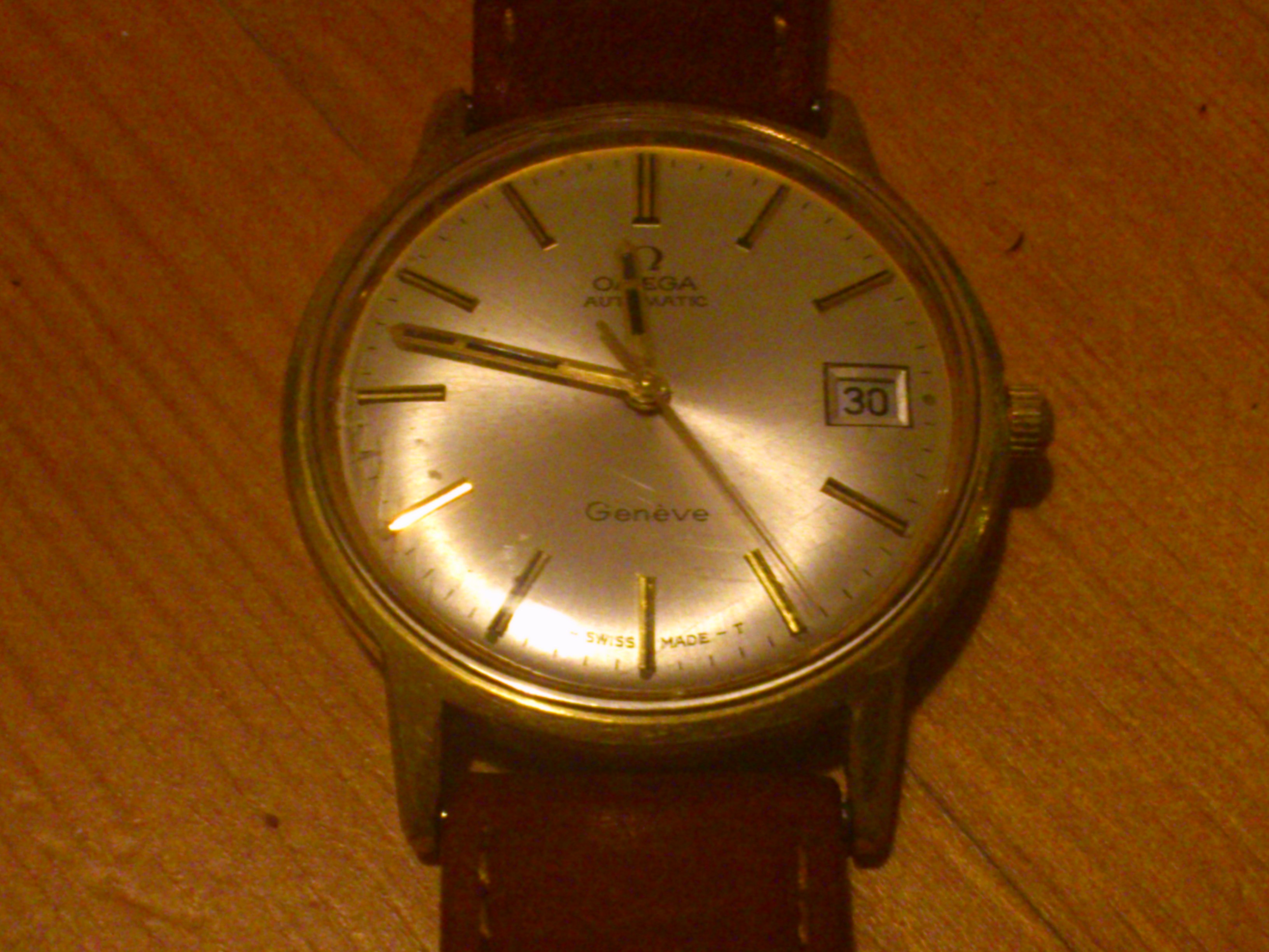

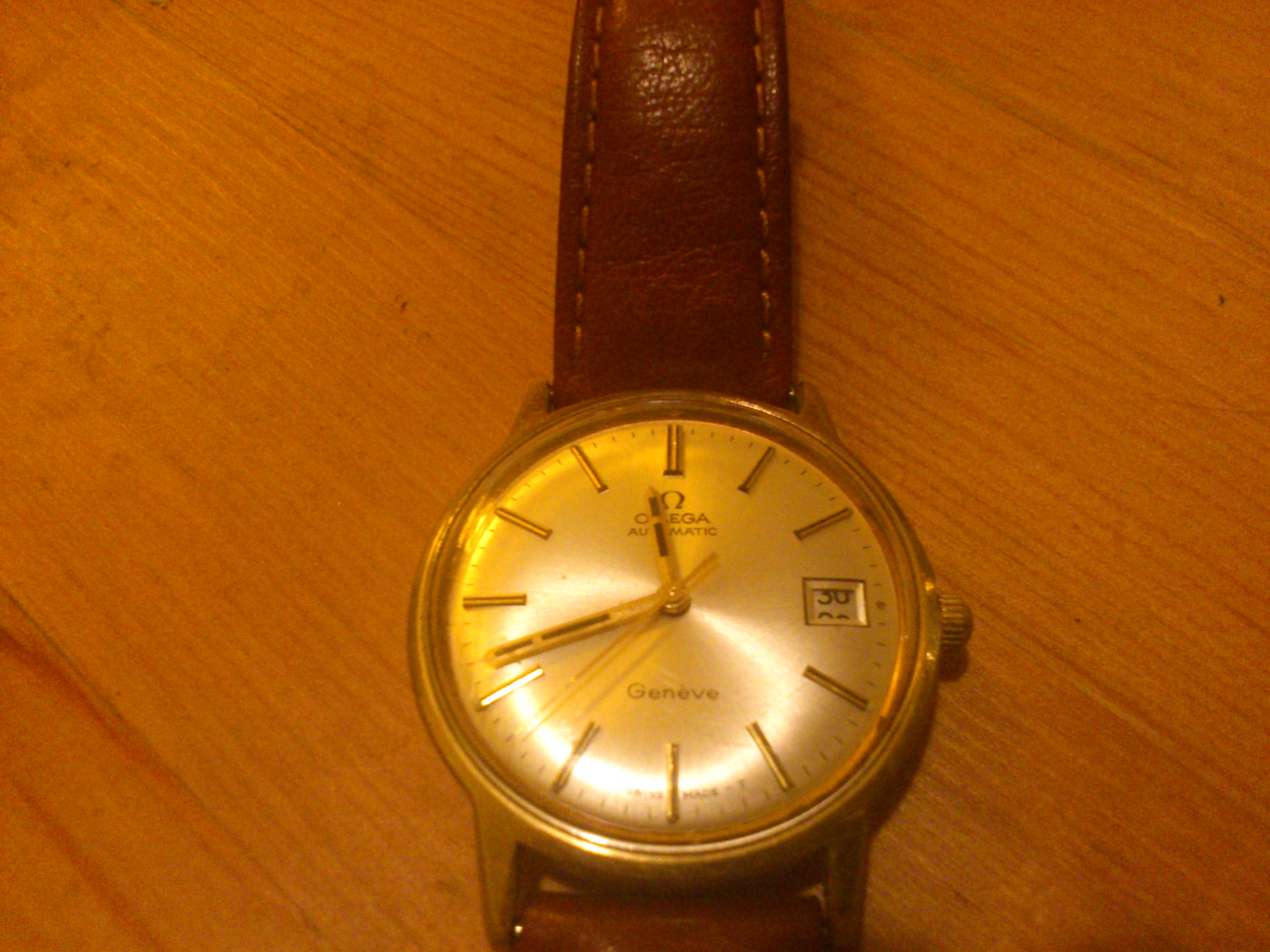

    Hi all,
    Brand new here so I'm going to introduce my watch. I was hoping you might be able to help me identify it better or point out any parts that are obviously not stock. Here's what I think I know: It's an Omega Automatic Geneve made around 1972. I believe it's gold plated on the front, dials, and number ticks, with a mother of pearl face, and stainless on the back.
    No here's the problem: It looses time. I just recently inherited it and set it but never checked to see if it was accurate. Then I took it off for a while and it died, so I reset it, although the date was a week back. It seemed like the dial only came out one position and I didn't want to pull to hard in case of breaking it so I just turned a week forward (which took a while) but now it seems to be loosing time. Also you can see that the date clicked over to the 30th before midnight. Is that unusual?
    I'm a little worried that all that cranking maybe damaged it? I hope not, my grandfather would not have been impressed.
  2. ulackfocus May 30, 2012
    25,983
    26,972
    Hi Stanley. Welcome to Omega Forums. Your watch looks authentic except for a replacement crown (winder). The reason it's performing so poorly is it needs to be serviced. Mechanical watches need to have their internals cleaned, oiled, and adjusted every 5 to 8 years. While it is an automatic, it needs motion to keep it running. Have a watchmaker do the service. It should cost you between $125 and $225 plus parts from an independent watchmaker. Then wear it proudly because heirlooms are awesome.
