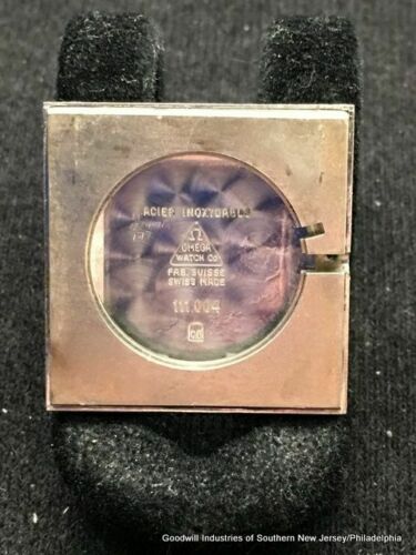

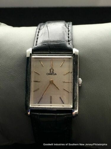

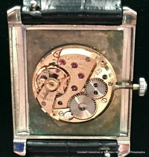

This watch was an eBay "win". Auctioned by Goodwill of southern NJ and PA. They didn't post very good photos - so I won with a bid of $183.50. I assume that's at least a bit below market for this - but don't really know.
Here are the auction listing pics...

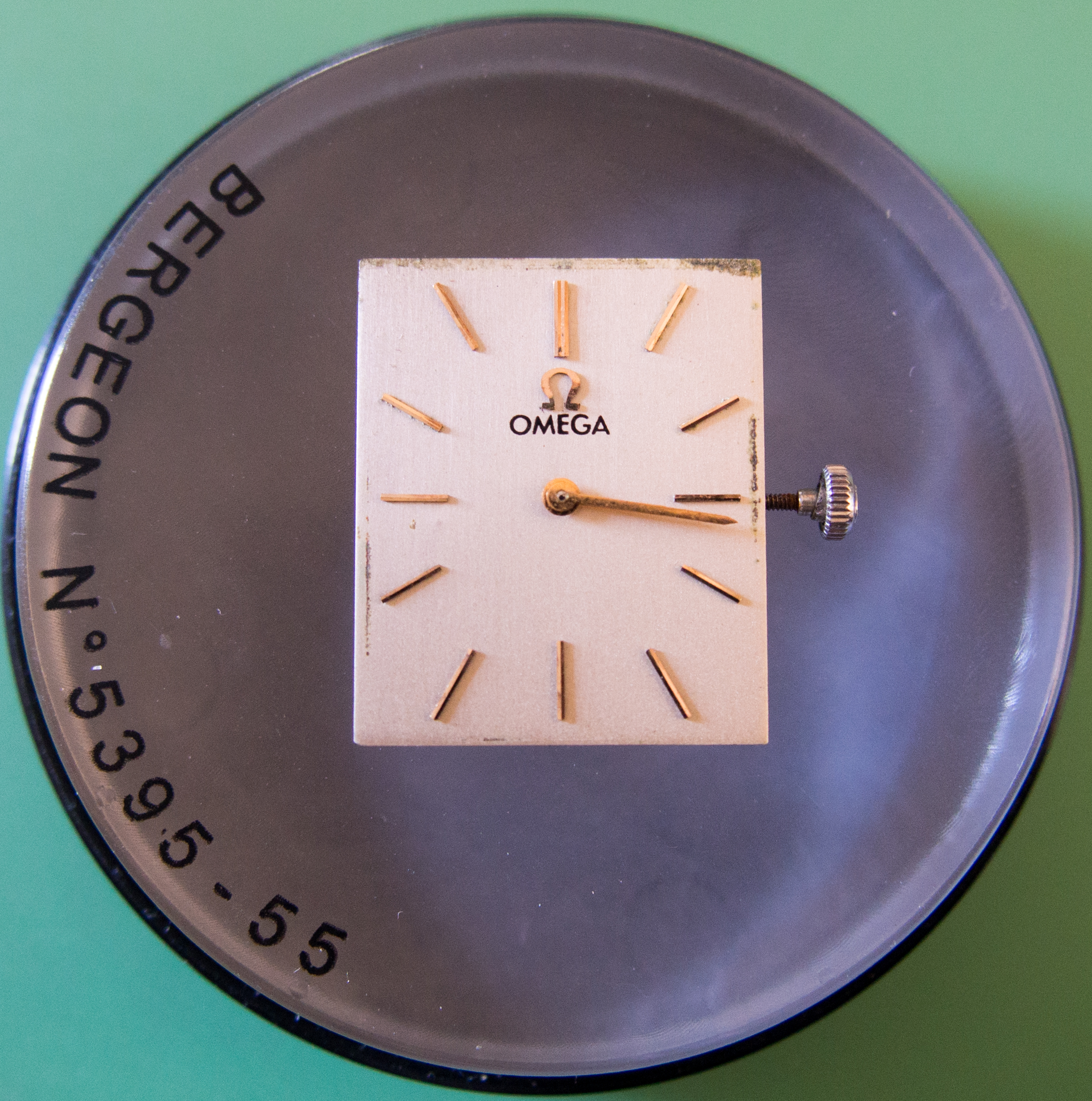

After receiving the watch, I was really happy to find that the photos weren't hiding anything. Overall, I consider it to be in really nice shape.

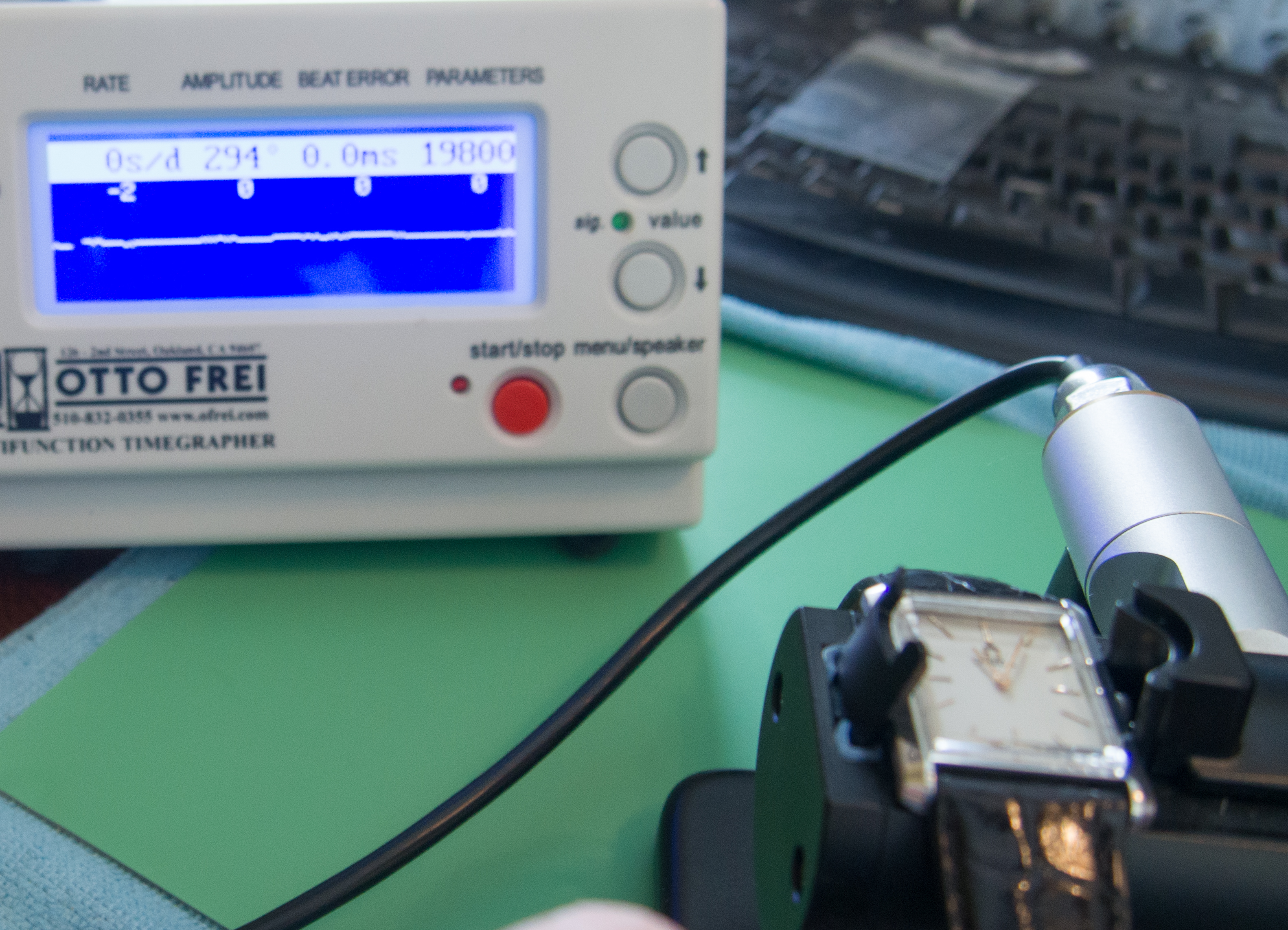

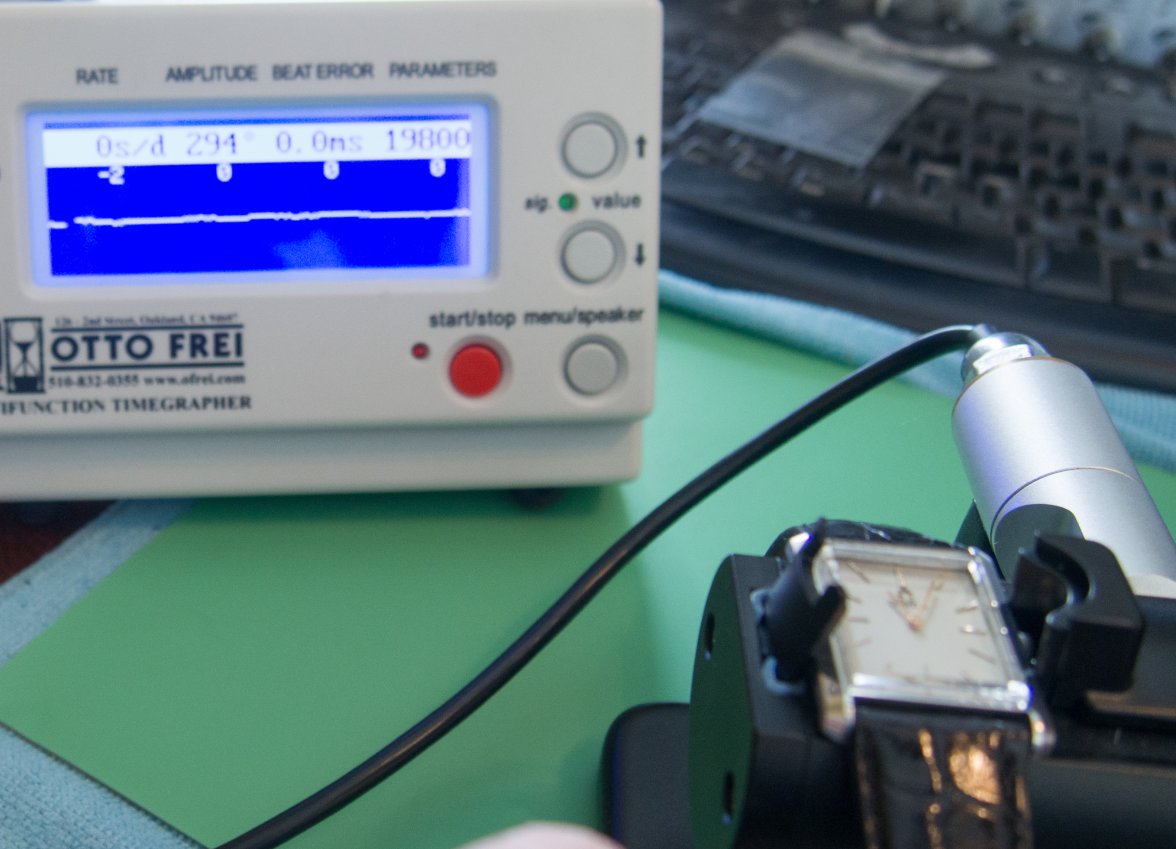

A quick look on the timegrapher showed less than stellar traces - but not terrible either. Sorry, but I don't have any "before" pics. The traces weren't all over the place - but they weren't straight lines either.
I was hoping a little cleaning would take care of it - and spoiler alert - I think it did.

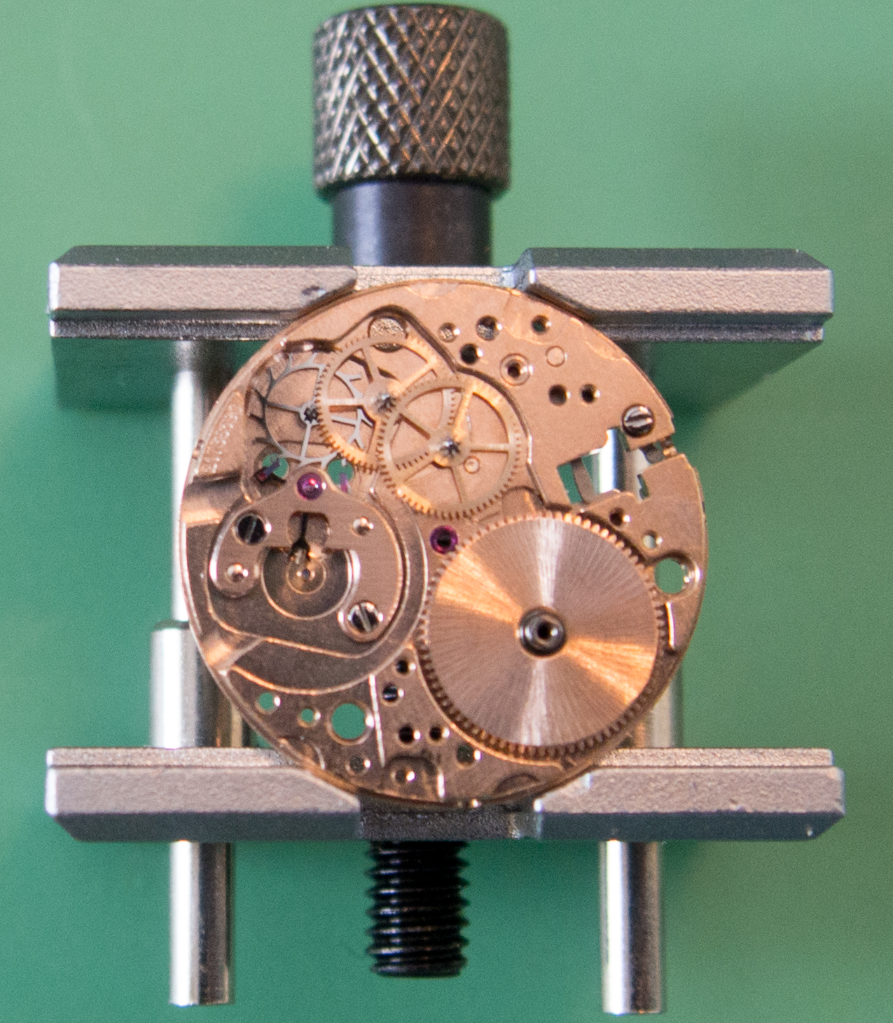

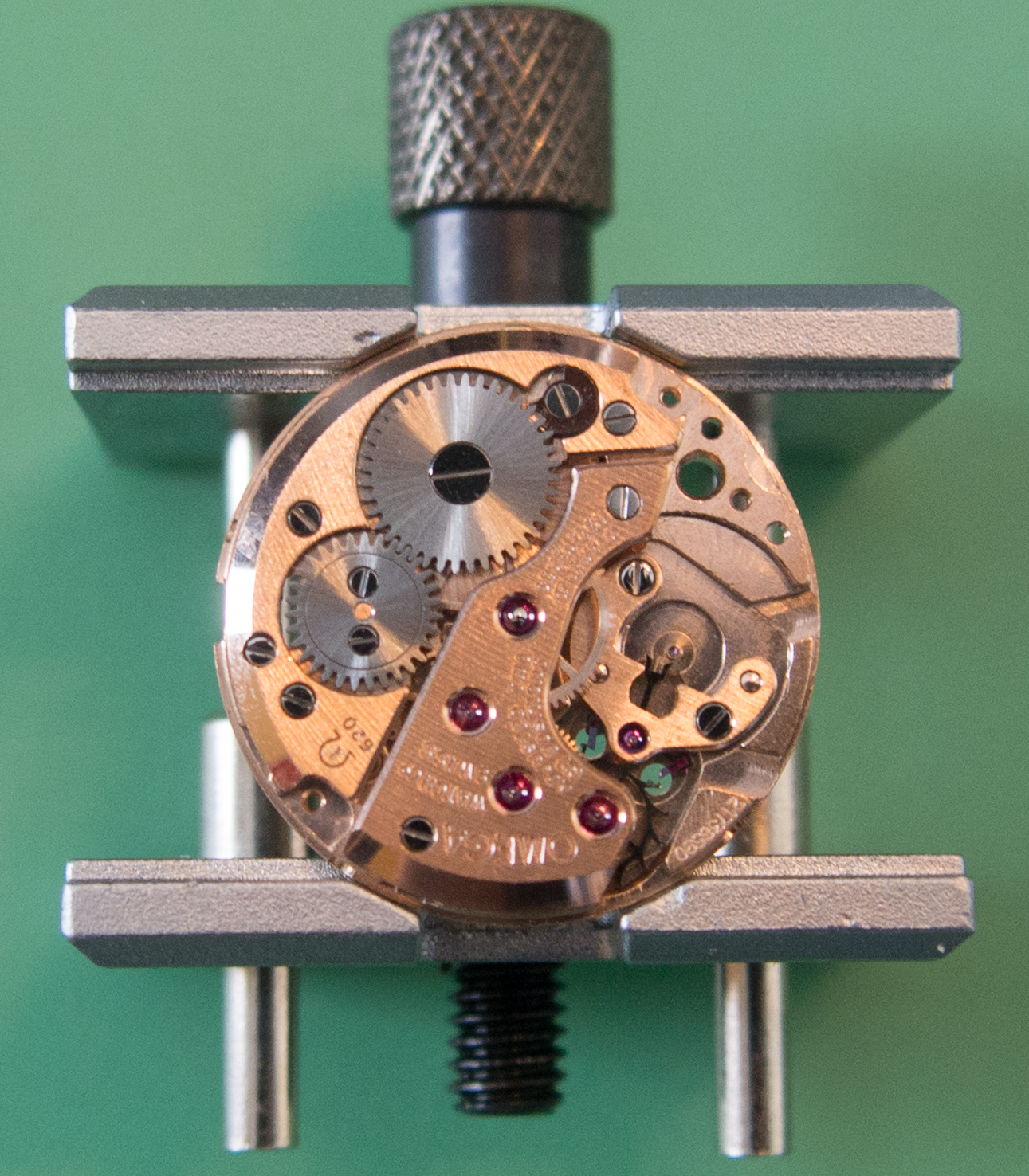

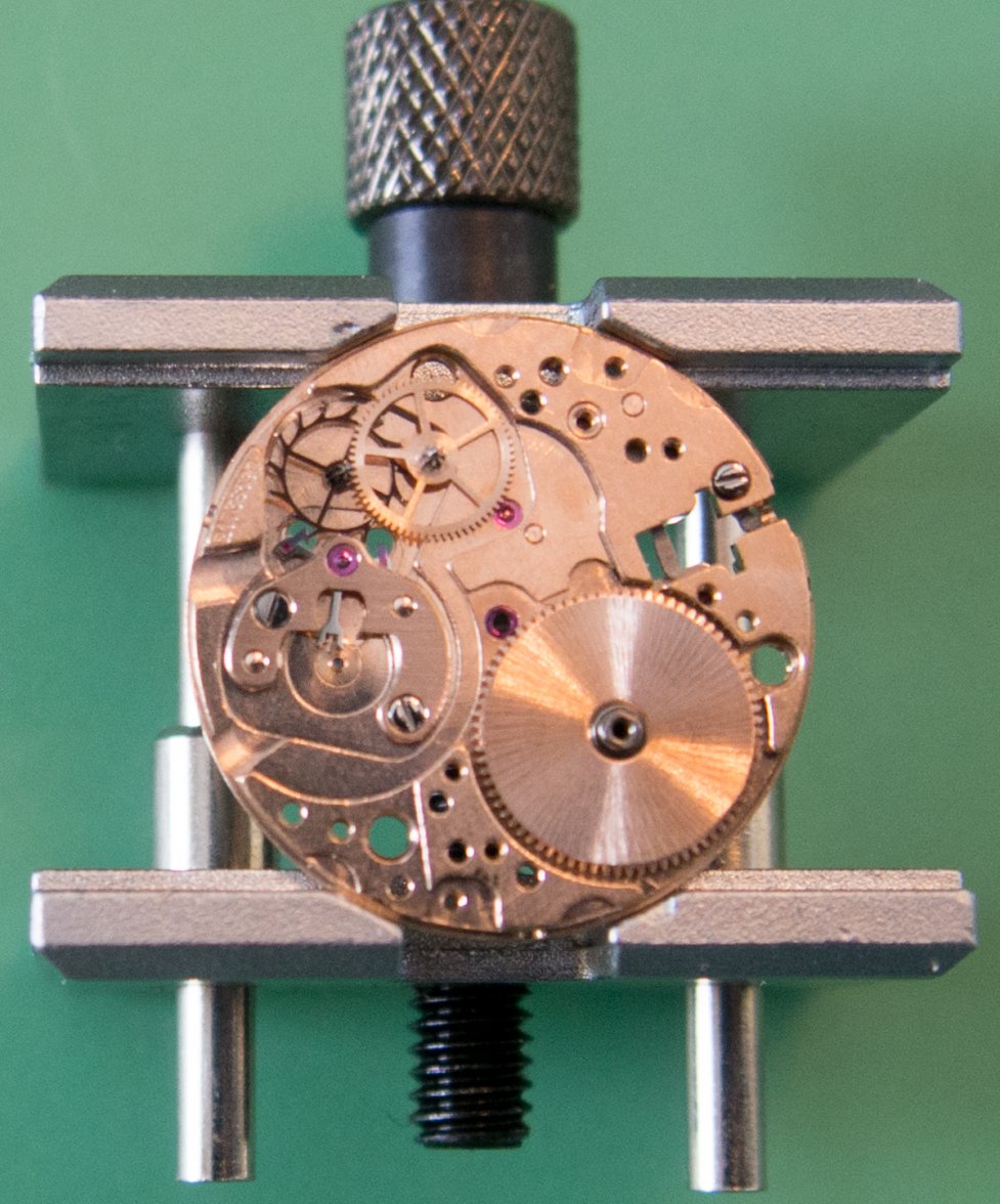

As I stripped the watch, my impression was that it was really clean (and it was) - and the oil was liquid and clean. Was probably a little over-oiled in most spots.
The one exception is - the escape wheel! 😲
The escape wheel had enough oil on it to drowned a small mammal. Consequently, it had a truck load of crap stuck to it. So, that ended up being the main "correction".

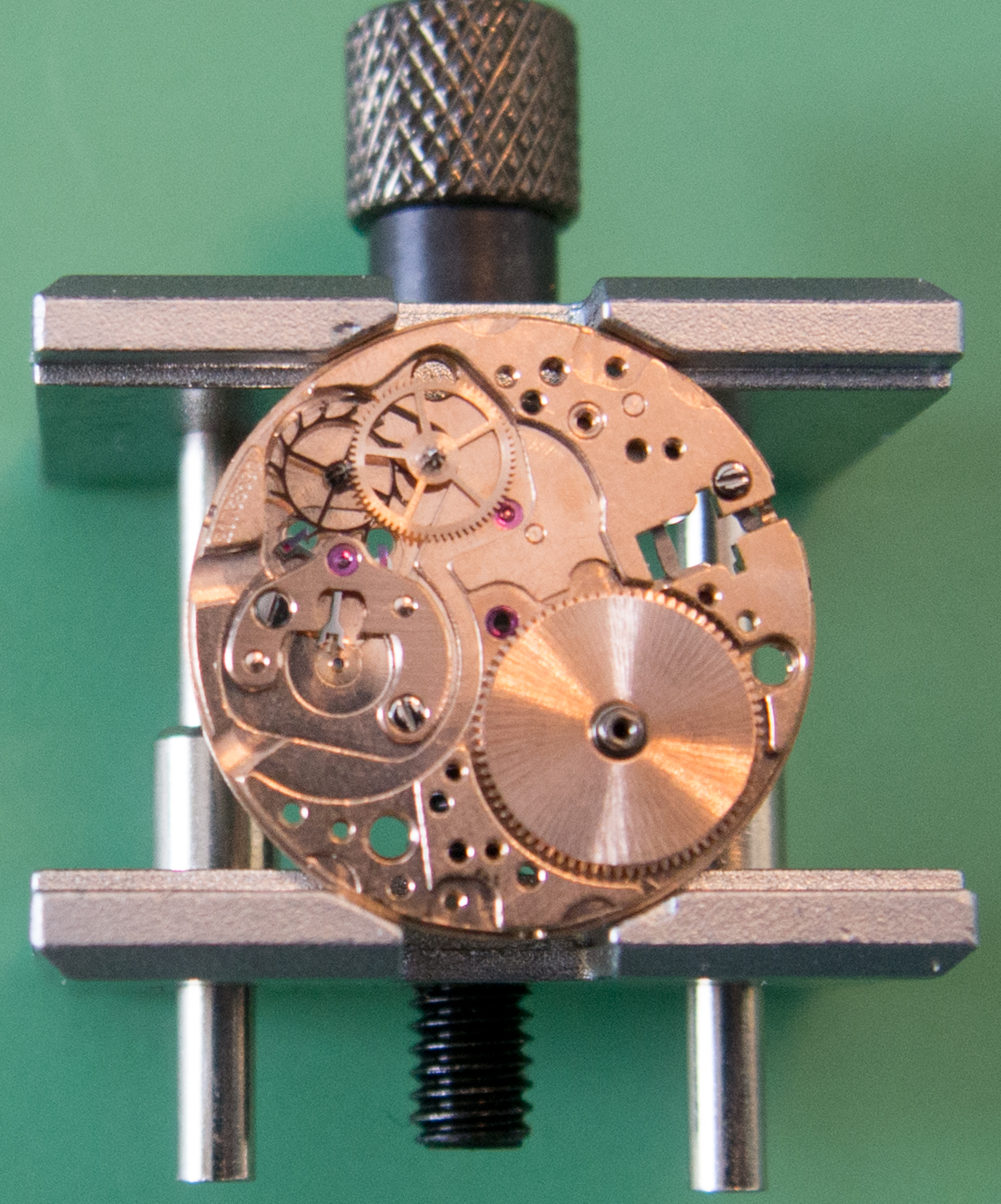

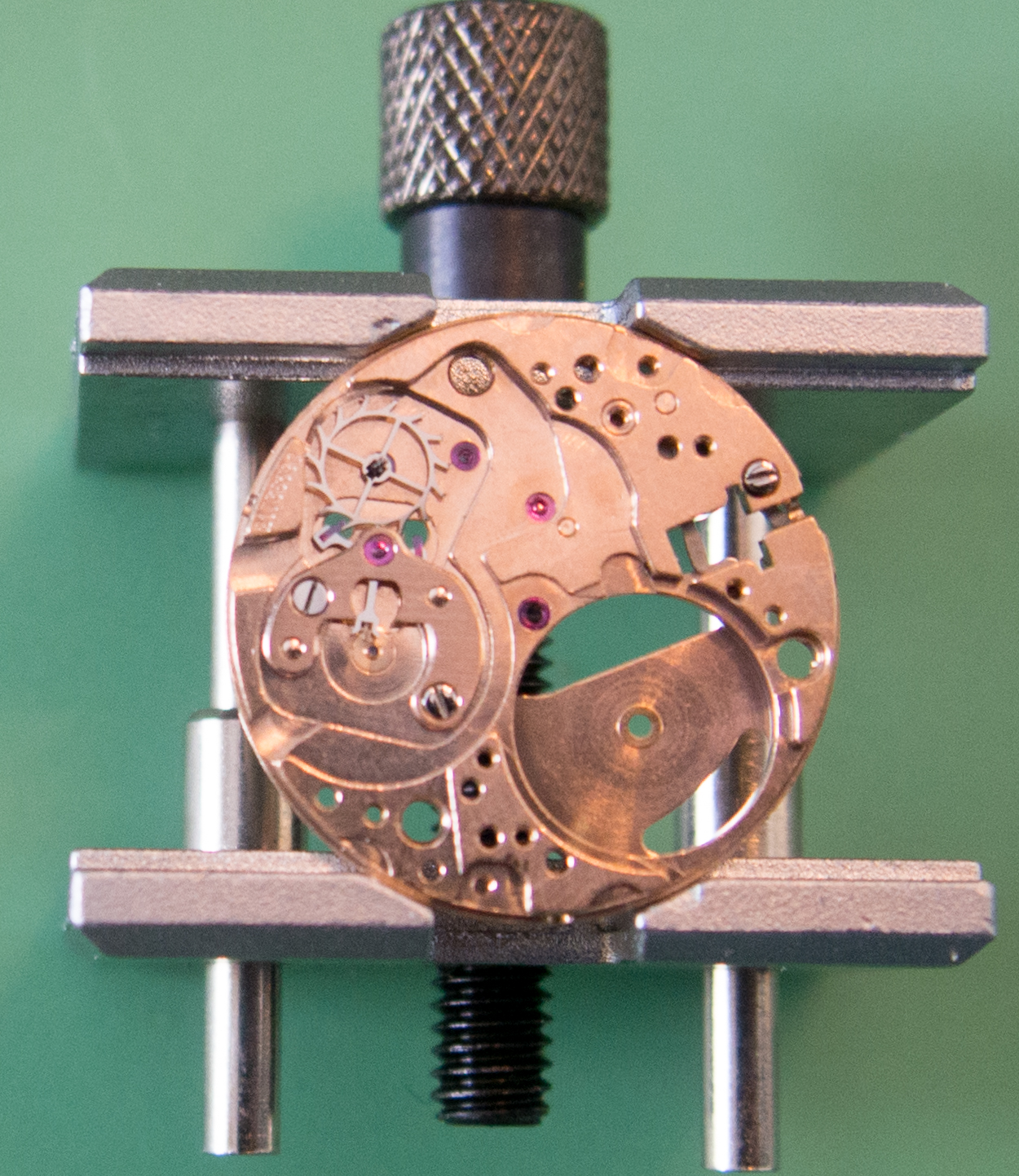

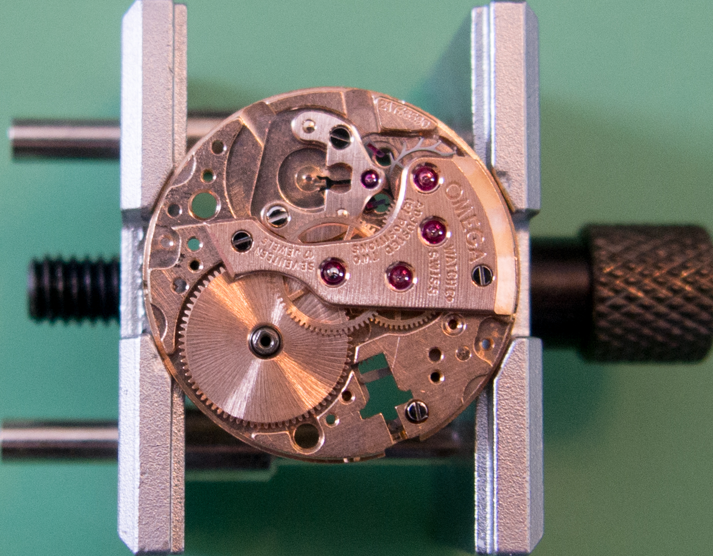

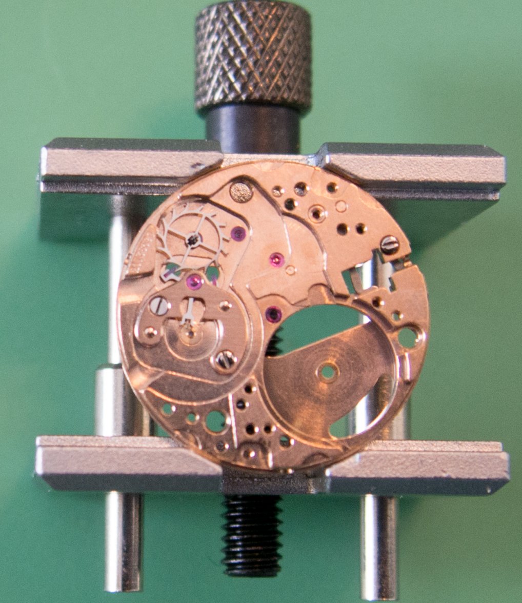

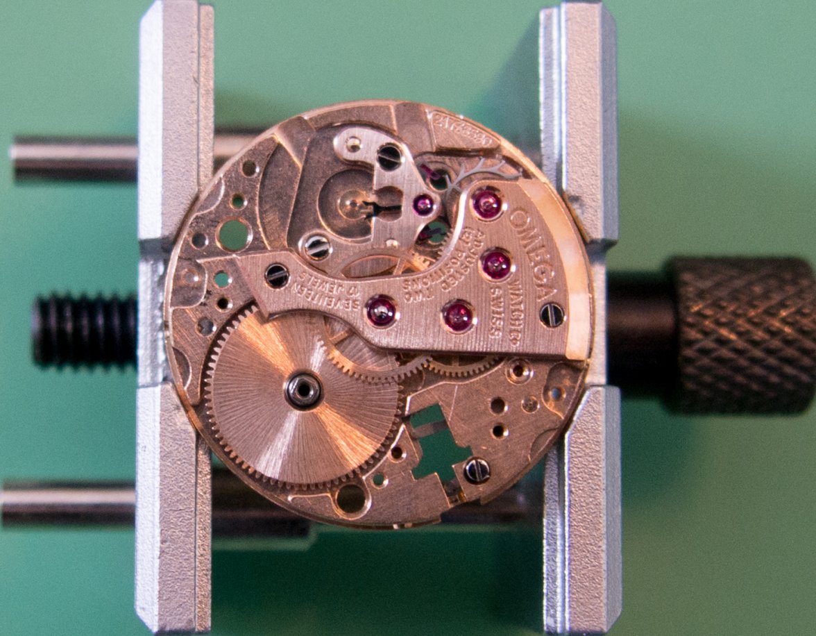

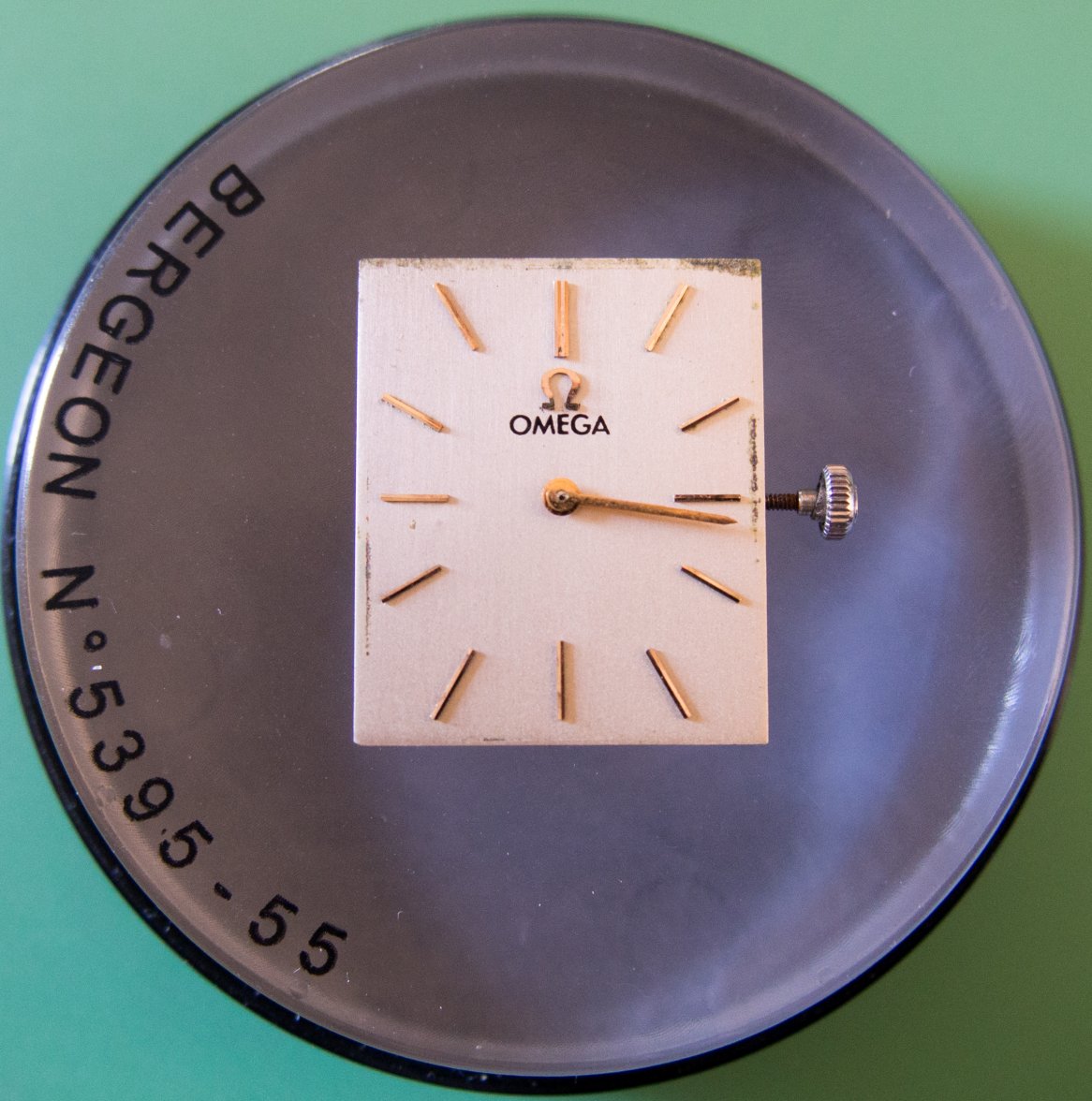

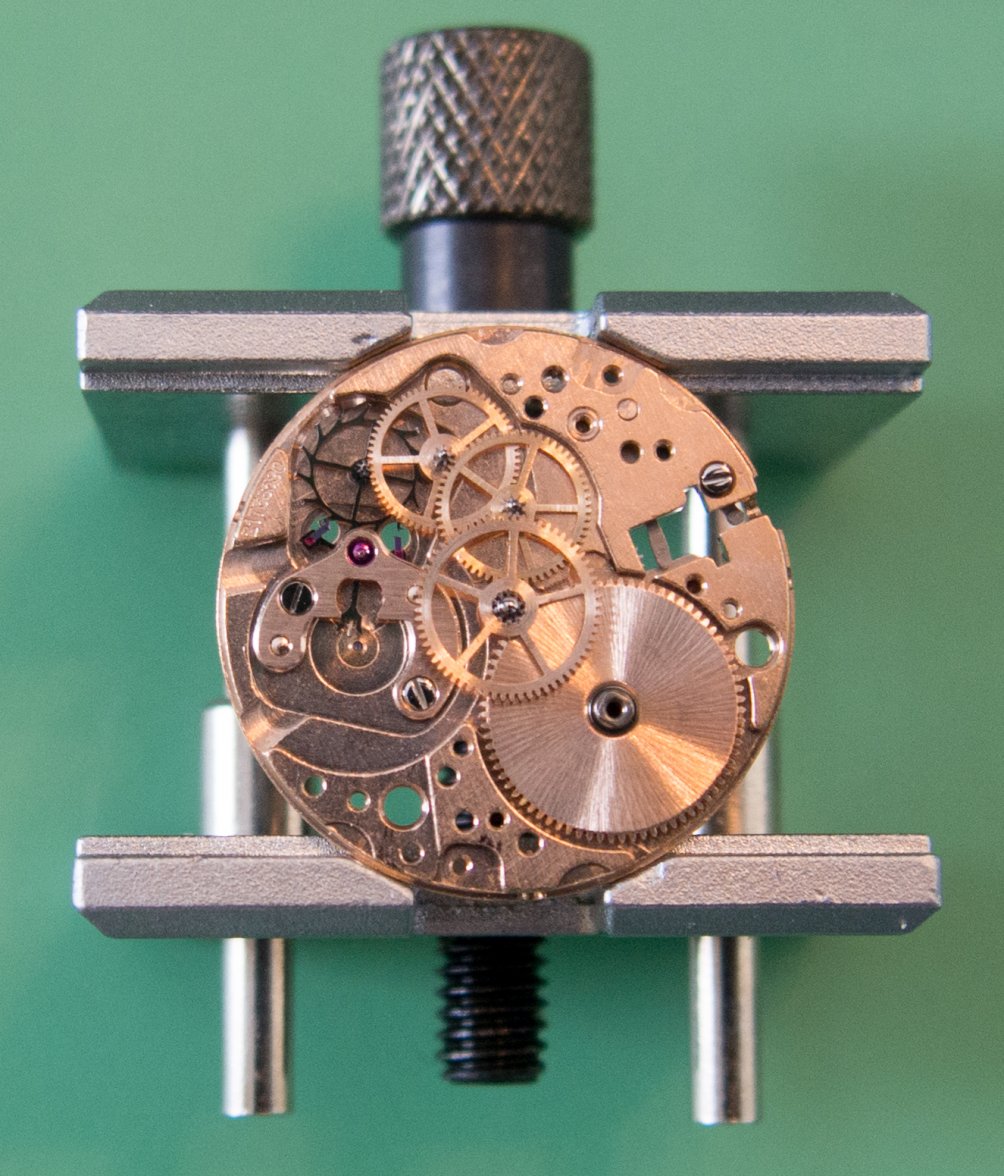

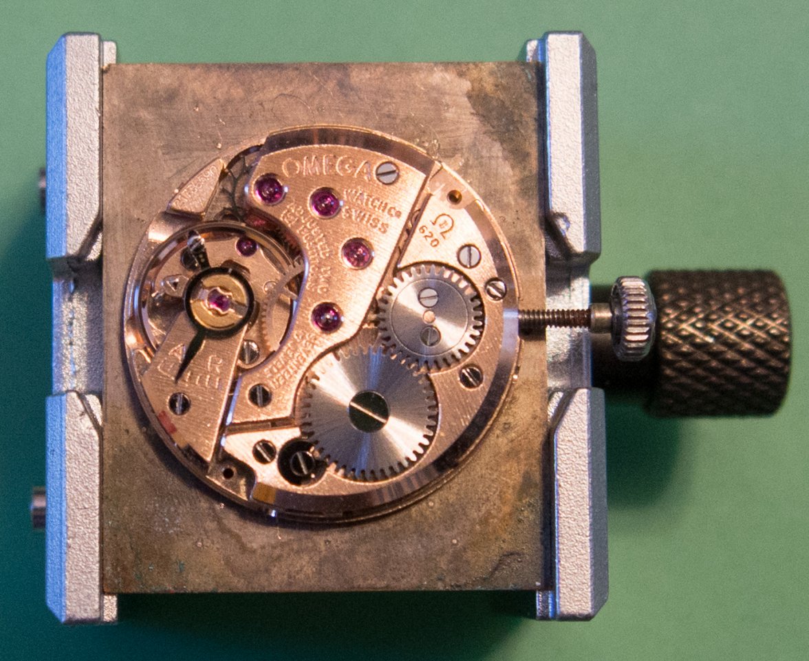

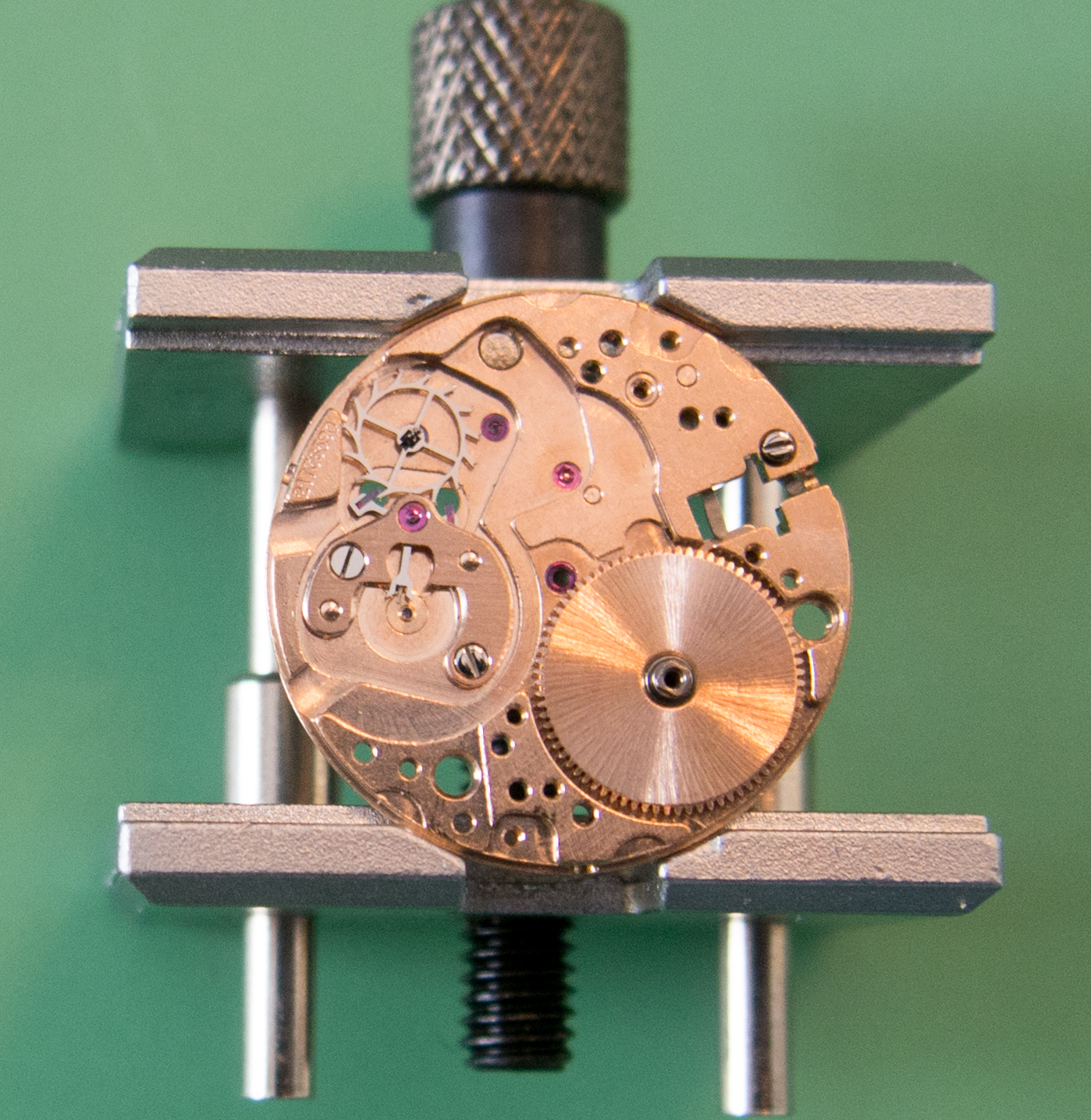

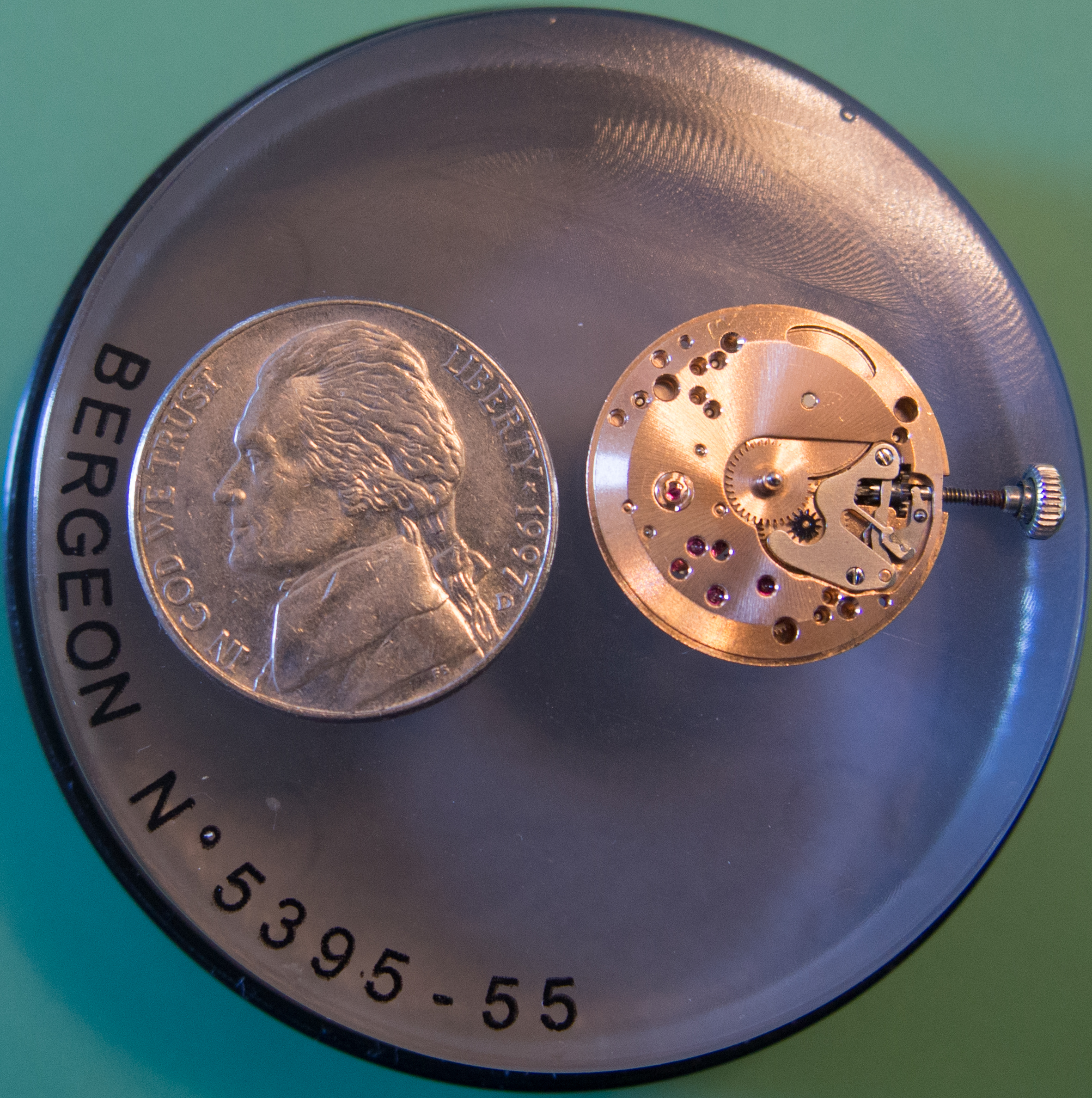

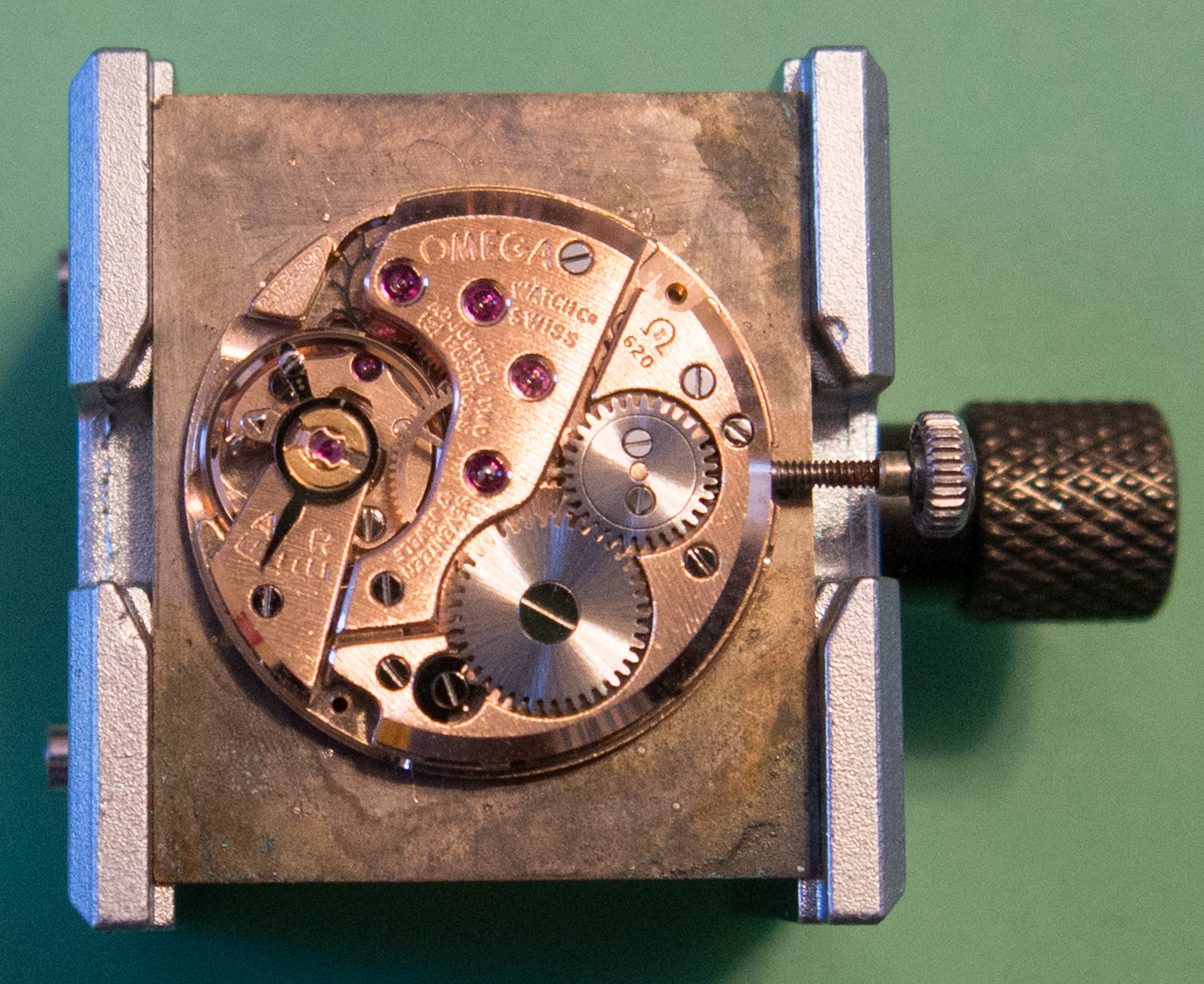

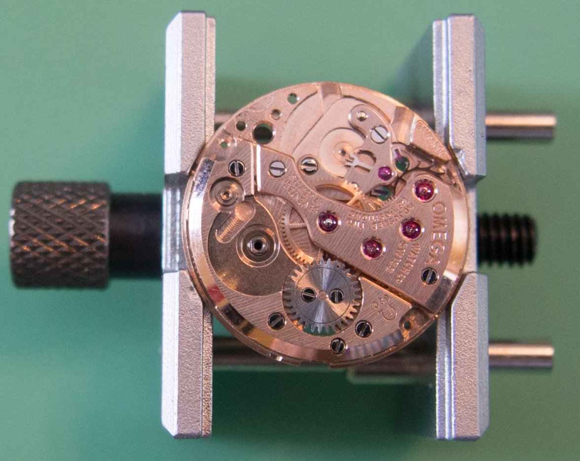

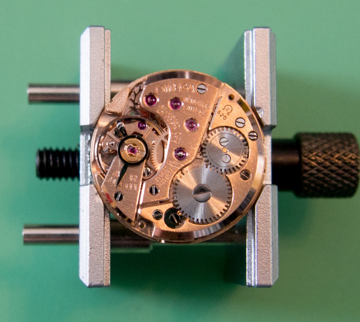

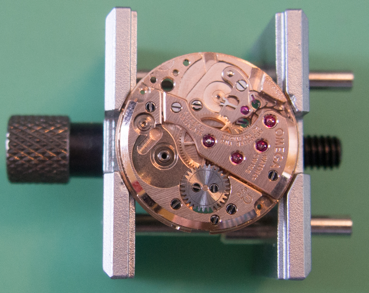

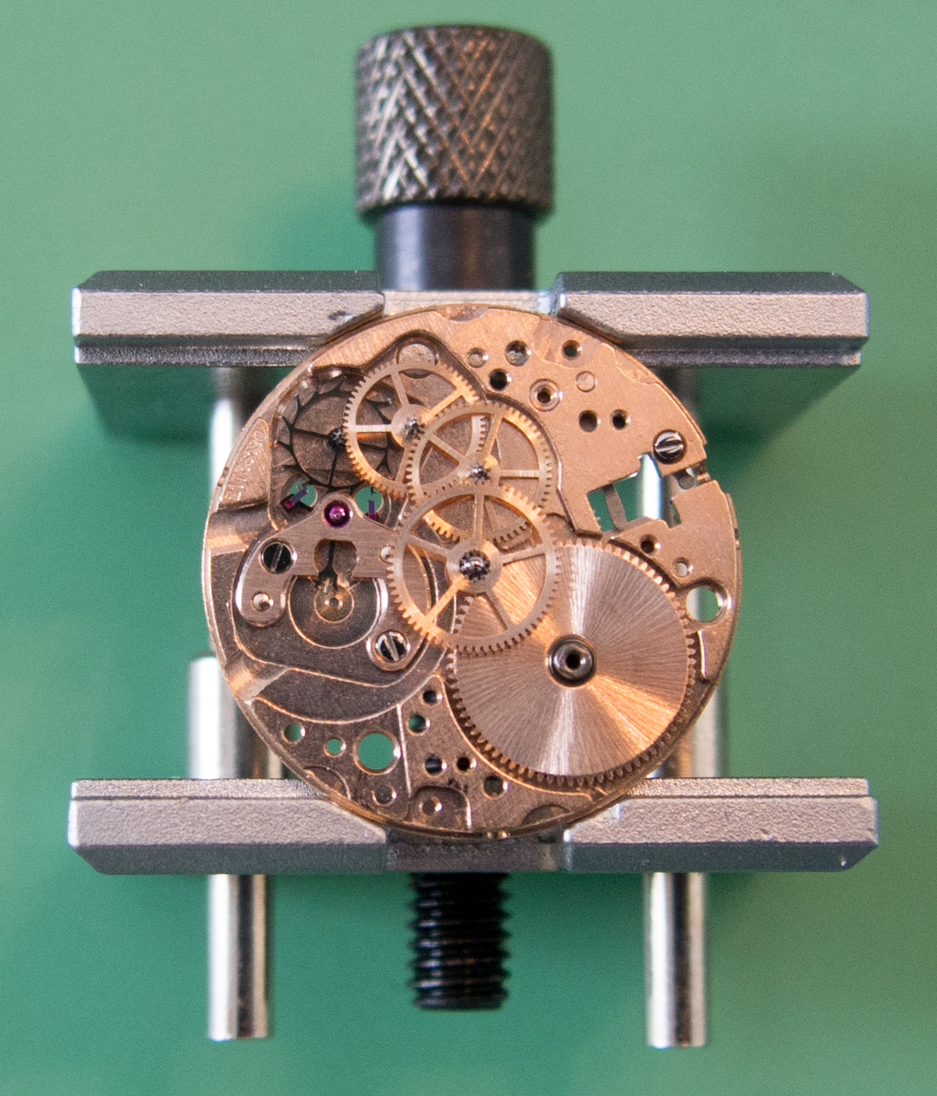

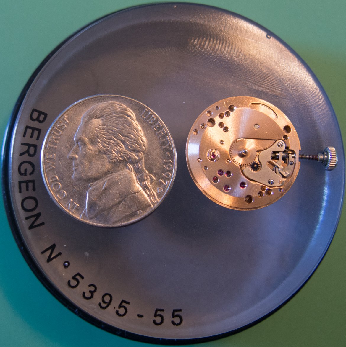

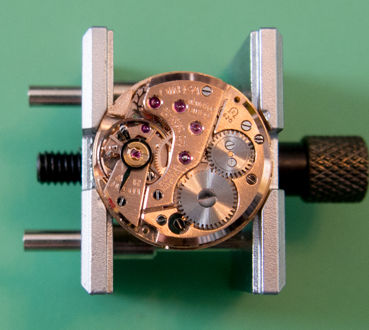

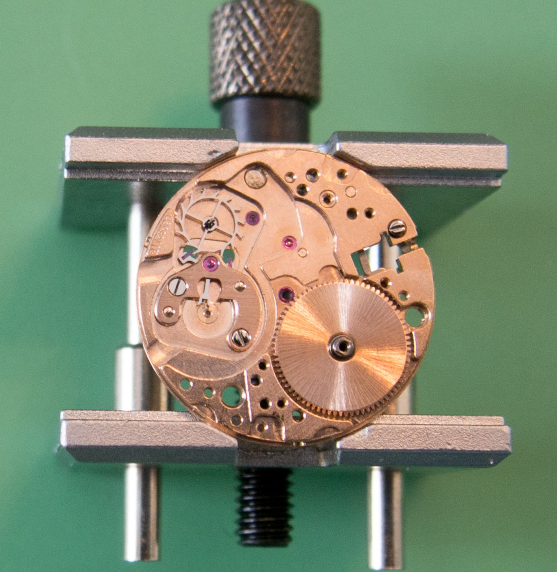

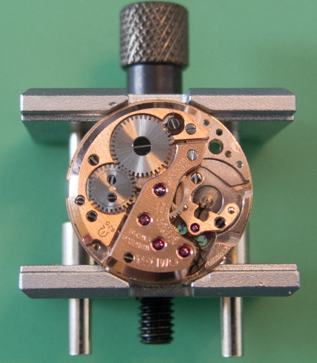

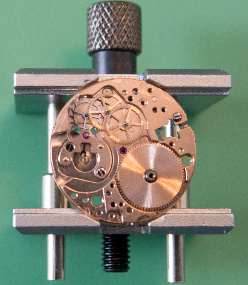

Here are the pics that I did take - for what they are worth. Focus on some is a little off - but still get a decent sense of the parts...
If you look closely at this pic - you can see a huge piece of crap stuck to a leg of the escape wheel on the exit side. There were actually a few such pieces "attached" (only by the oil) to the escape wheel. Yet the rest of the movement was very clean.

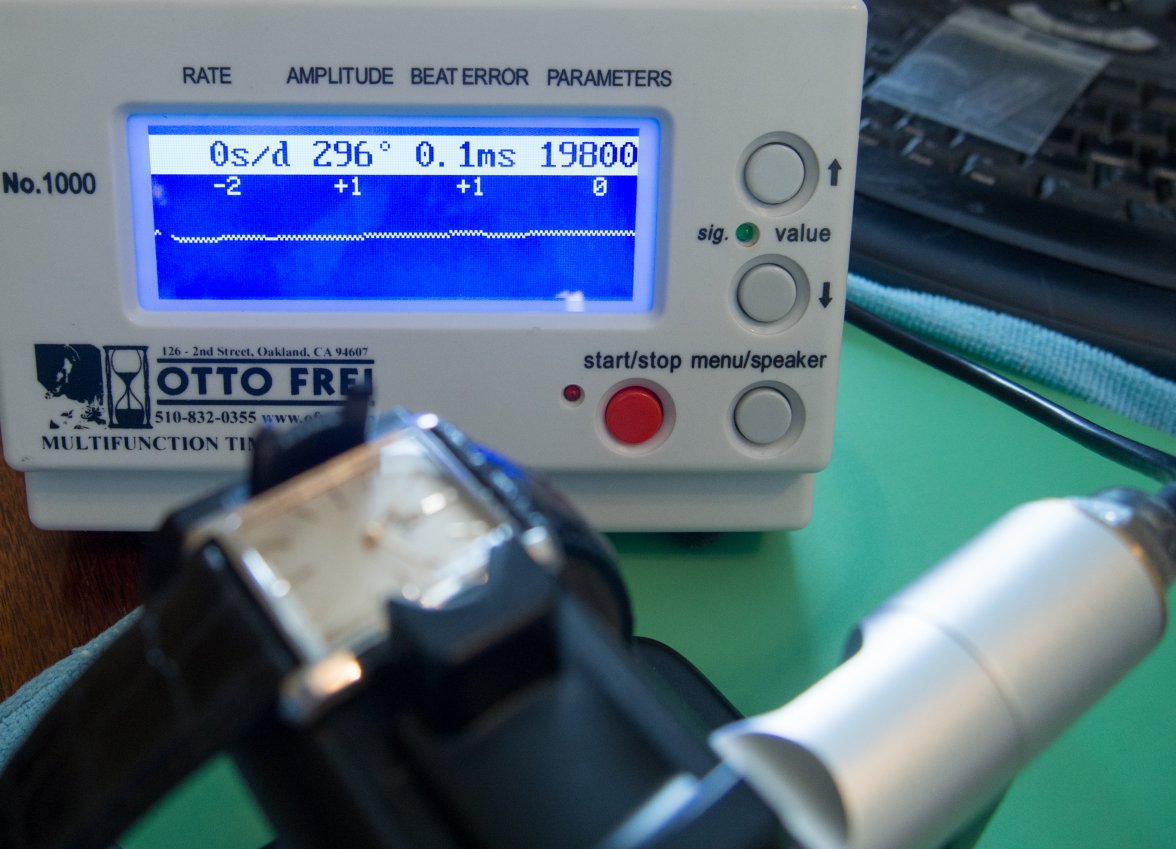

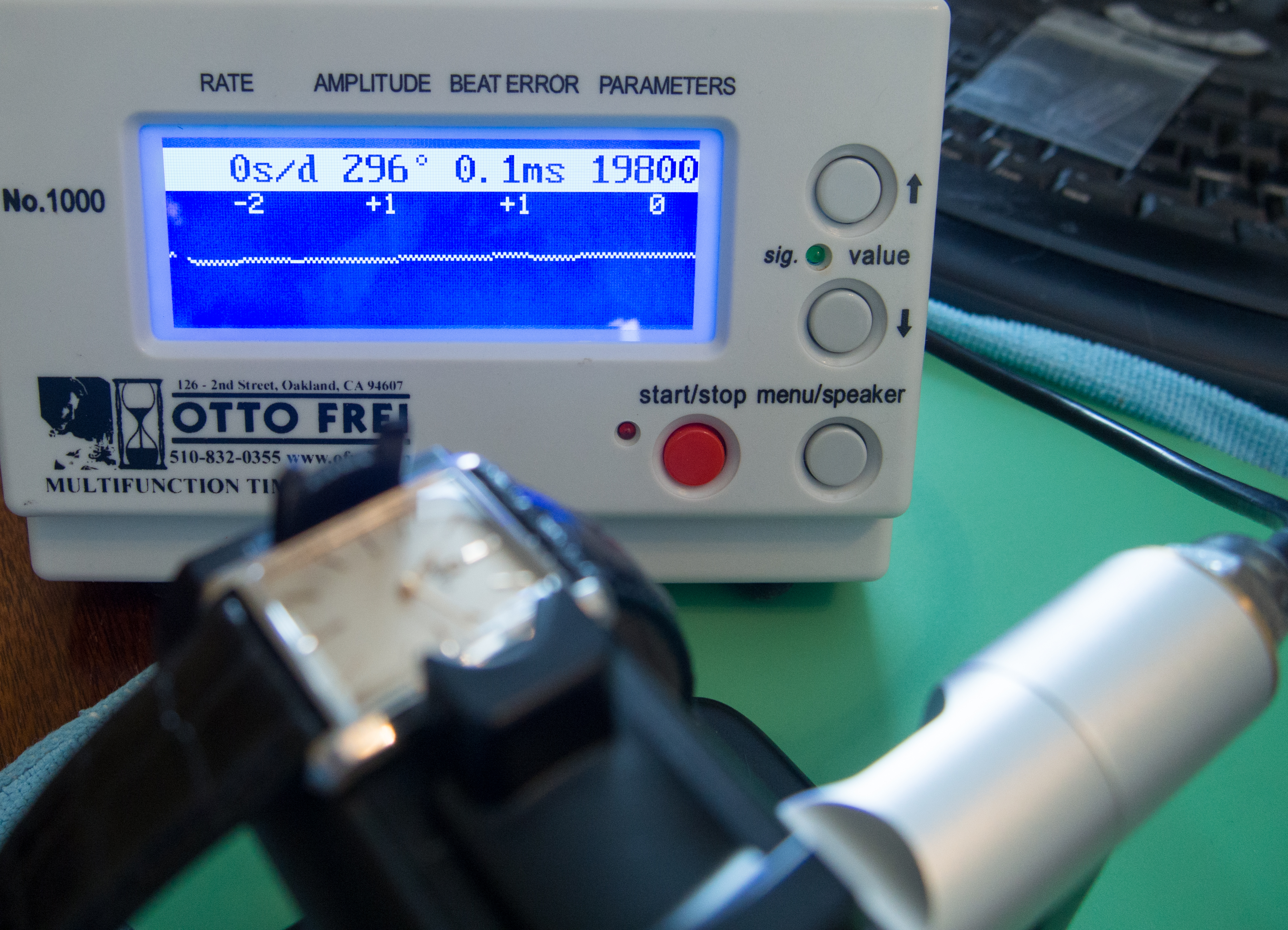

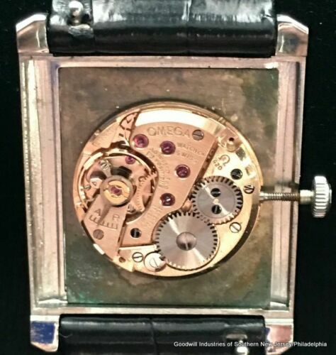

Following a little adjustment and reassembly - the traces now look great by comparison to where they started.
