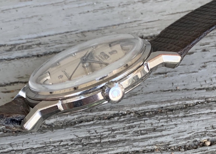

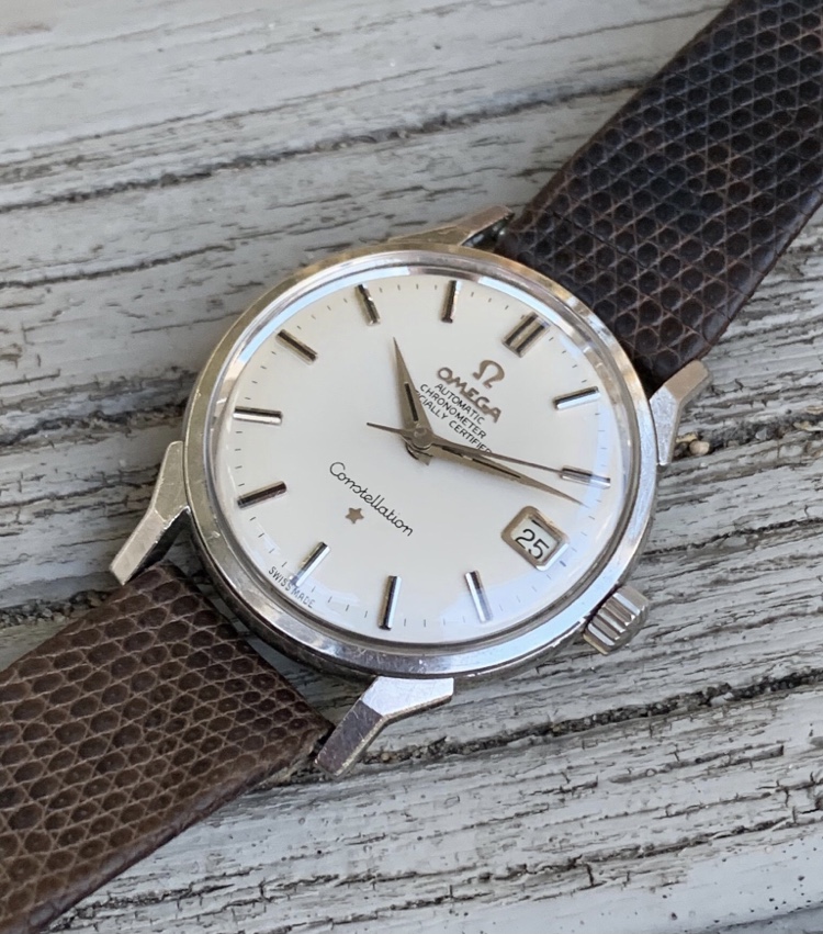

Is this an authentic piece with a re-dial? Is yes, what tells you it's been refinished?

Hi,
look at the font used, especially the word « Constellation ».
Comparing with an original dial, you will see that the font is not the good one

Pretty nice case but wrong crown and a pretty bad redial, stay away!
