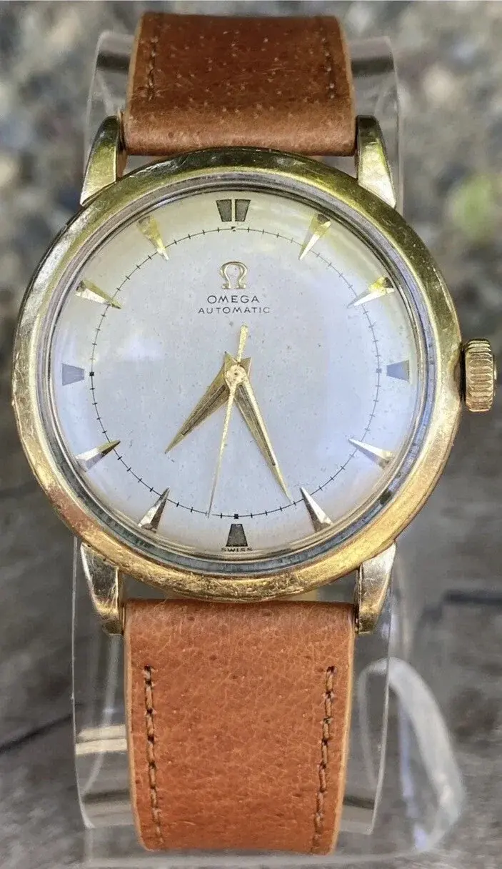

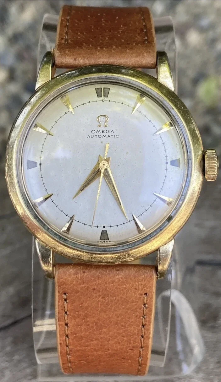

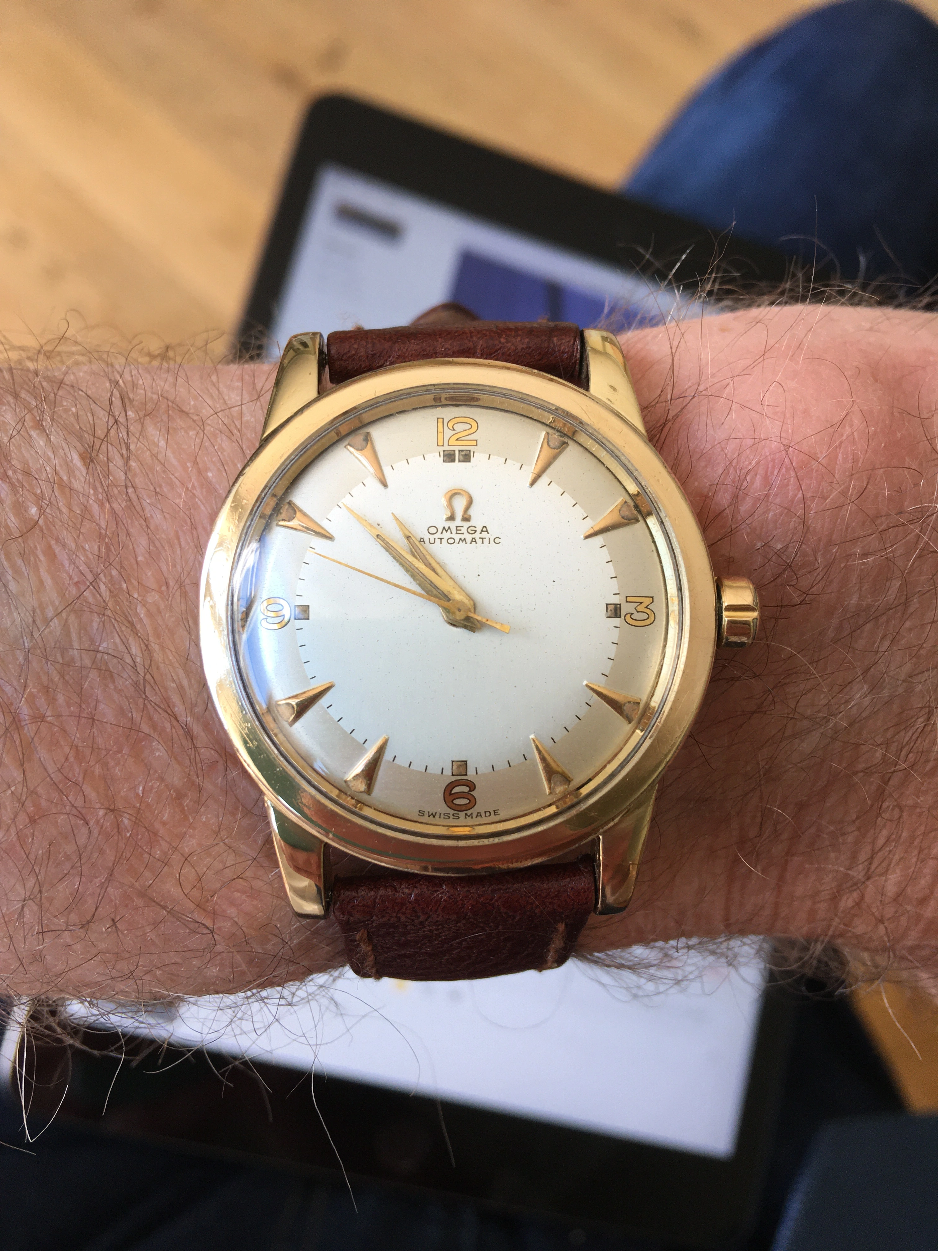

I am very new to vintage watches and recently started looking for a birth year watch for my dad's 75th birthday. Not looking to break the bank as he is not THAT into watches but I know this is something he would appreciate.

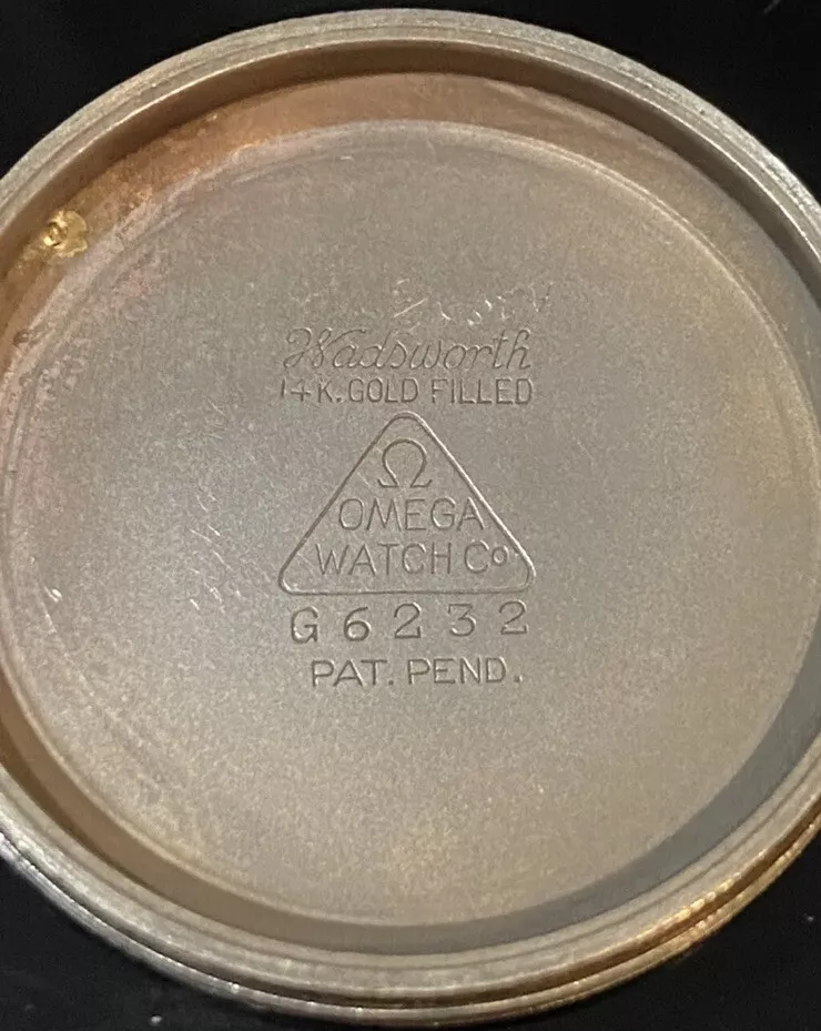

I am across the following watch (Omega Ref. G6232 Cal. 351) and was curious on thoughts on the watch itself and the dial. Untrained eye but hour markers arent lining up (i.e. 5 and 11) but could be the slight angle of the picture? Likely is me being overly paranoid. It was noted that the crown is not original to this watch and the seller is not a traditional vintage watch seller which comes with some additional scrunity.
I did find a very similar watch on sold by BirthYearWatches (https://www.birthyearwatches.com/product/1950-omega-bumper-automatic/) which gives me some reassurance that this dial exists and might not be a frankstein. I would just buy that the BirthYearWatches version was mentioned to have had dial completely redone.
I assume it wouldn't be an issue to polish this?

The watch appears to be legit. Crown is replaced and the case looks to be in rough shape. Also, as you probably know, gold-filled cases are not the most desirable, so the price should reflect that.

Thanks for the help. Yes definately see the case is in rough shape but was hoping that might be easier to polish to remove scratches given dial seems like in decent shape. Obviously polishing a GF watch not the most ideal but would most of the scratchs come out (does not have to look completely brand new)

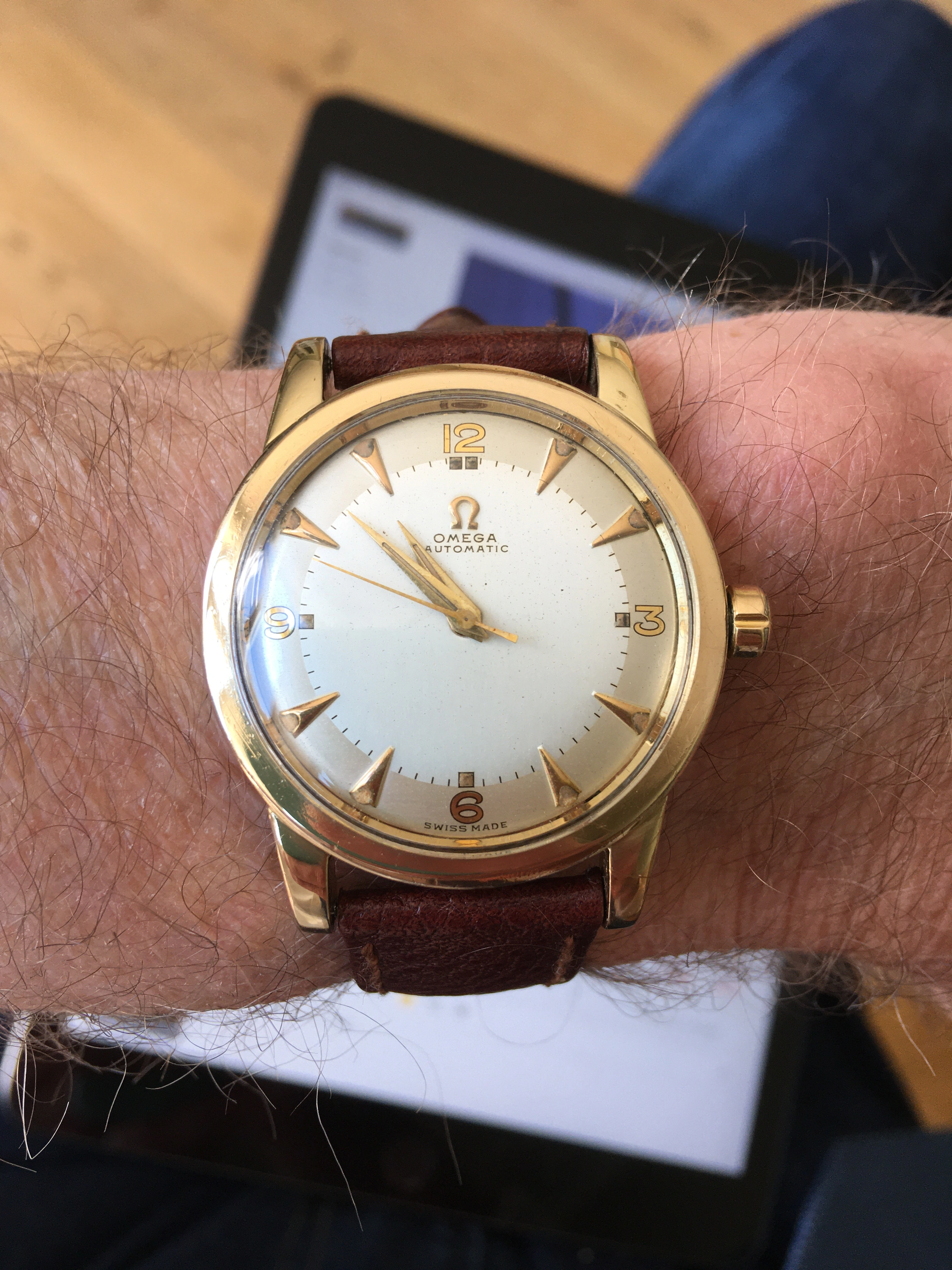

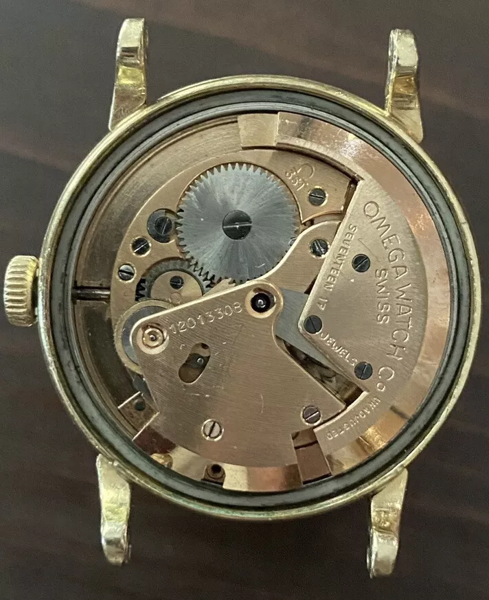

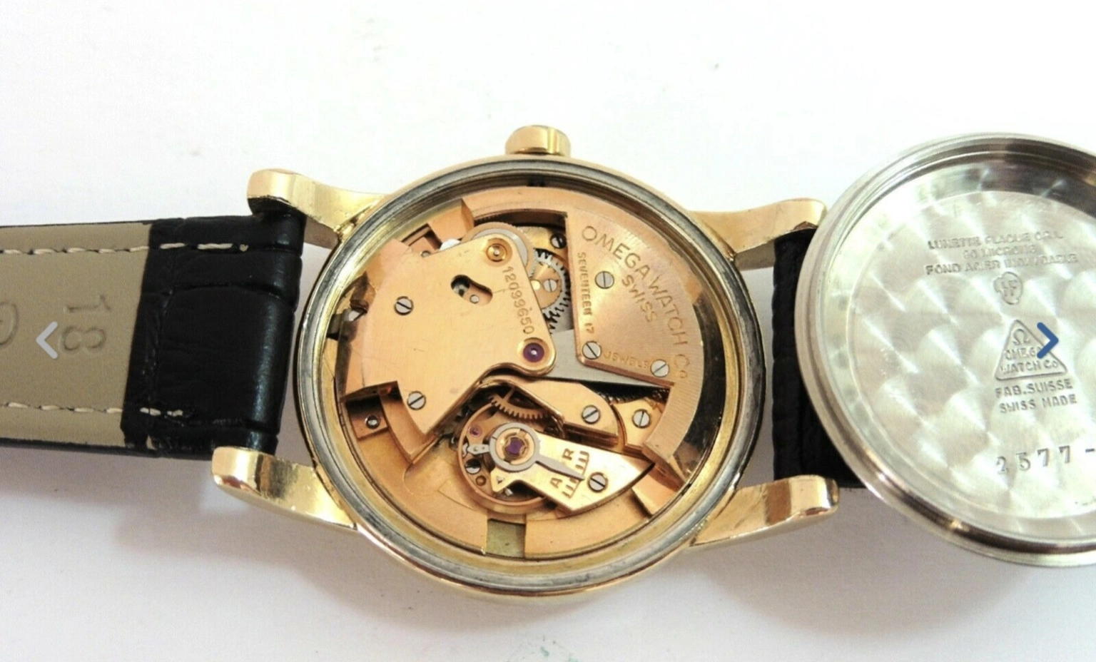

I think both the dial and the movement look nice. I also have a 1950 351 bumper and the plating has worn through in parts.
I only ever use a soft impregnated jewellers cloth to give it the gentlest rub before wearing.
At 75 years old, the watch is entitled to look its age - it’s earned its wrinkles 😀.
