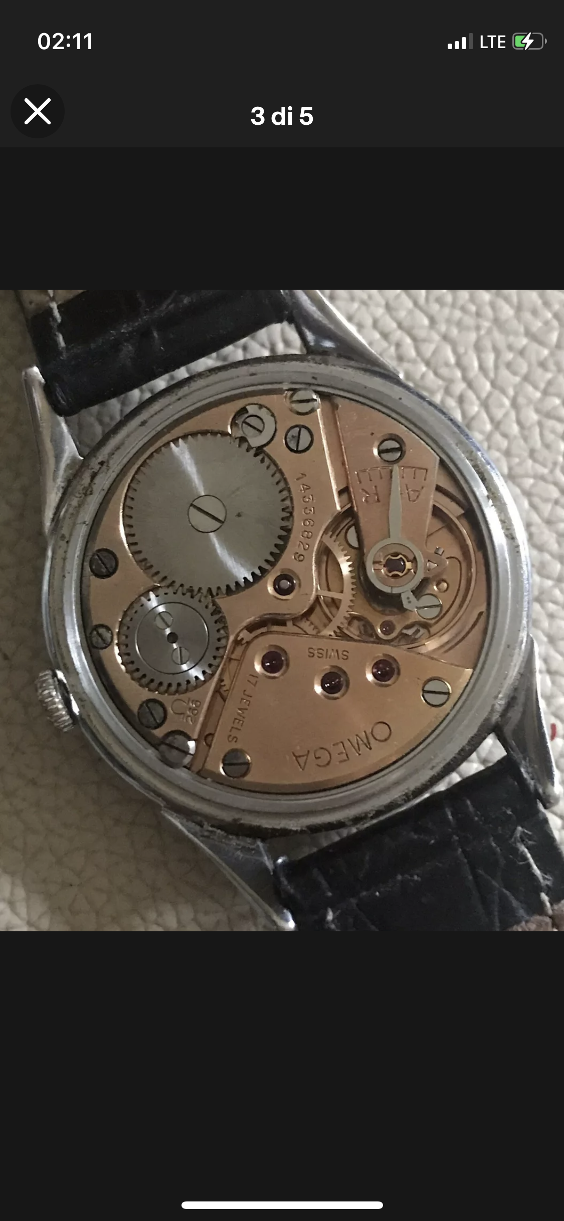

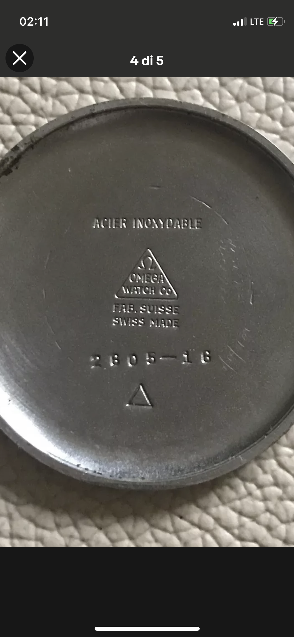

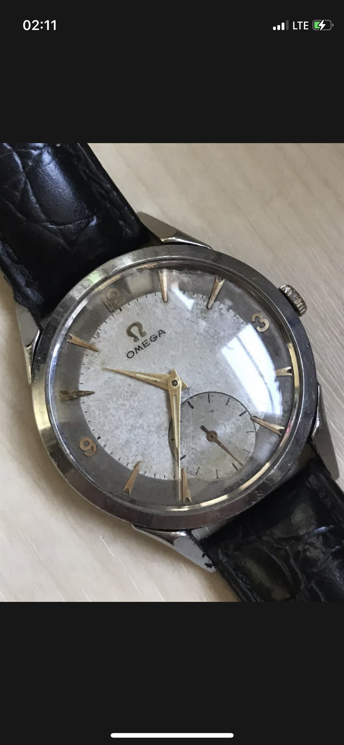

I just found this vintage Omeha and was wondering if it’s a legal dial, I’m also very interested in your opinions about the condition. Every information appreciated. It’s about an Omega 2605-16 with two-tone dial, images attached. Would you suggest me to buy it?

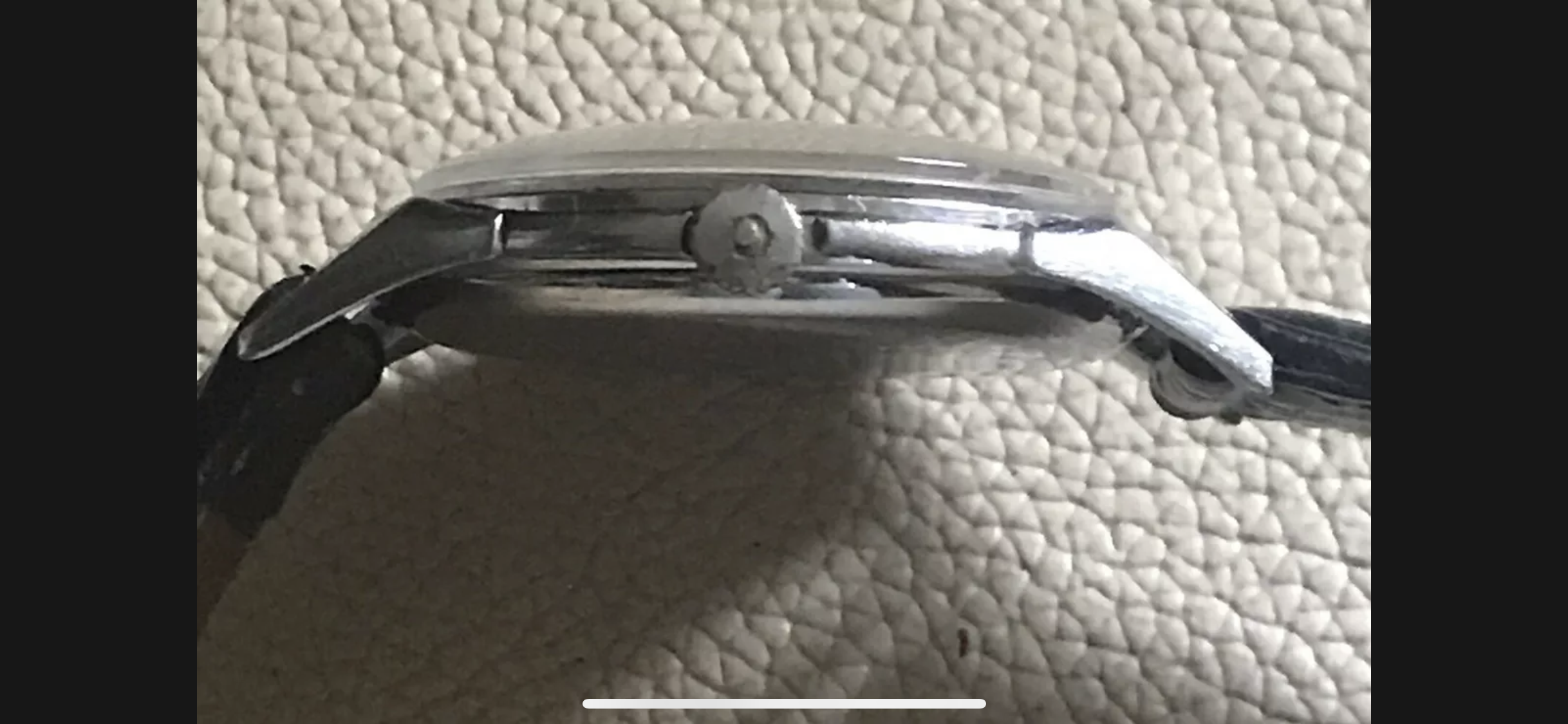

3/10 condition case and dial wise. 10:00 index not right. Hands relumed or not original. Crown not original.
One case clamp screw not original and balance bridge screw not original. If not the right thread. Could strip the main plate threads
I'd avoid it
