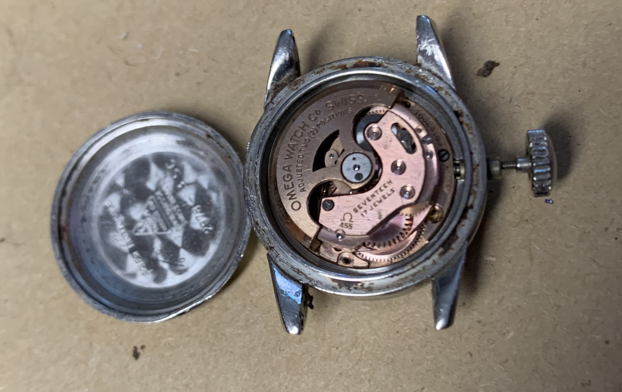

Also photographs are a must. Here is one I have of one of the 'triplets' I recently got on ebay. This did not have a stem. So I was testing it with a stem and crown I had in my omega spares. The crown is obviously incorrect, but it fit the stem well enough for a cursory test.
