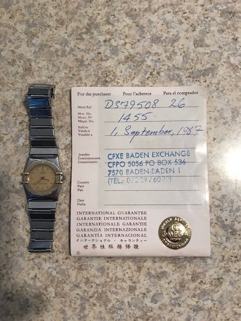

Looking for a replacement crystal for a ladies Constellation cal. 1455, ref# DS795.0826.
Watch was purchased in 1987. Does anyone know the Omega part # or an alternative compatible part #?

Case #7950826 appears to be for a gold plated ladies DeVille, not a Constellation. Can you double check that number?
3
Archer,

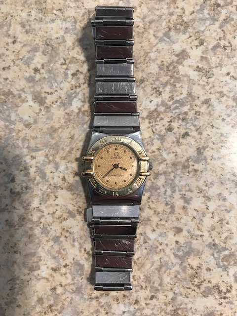

Thanks for your reply. See pictures. The crystal is 16mm, flat surface not domed, slightly beveled edge
29,405
76,093
I see a case number 055DS7980876 that is a Constellation with a 1455 movement, that uses a 16 mm diameter flat sapphire. I'm guessing there was maybe an error writing down the model number at the store...not sure but the crystal for that is 062SN0549.
To be sure I would get a watchmaker to pop open the case and verify the case number inside.
To do the replacement properly you will need a new case back gasket, and new crystal gasket. These are both hard plastic gaskets that due to compression are single use only.
Cheers, Al
