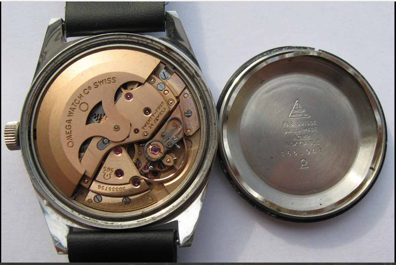

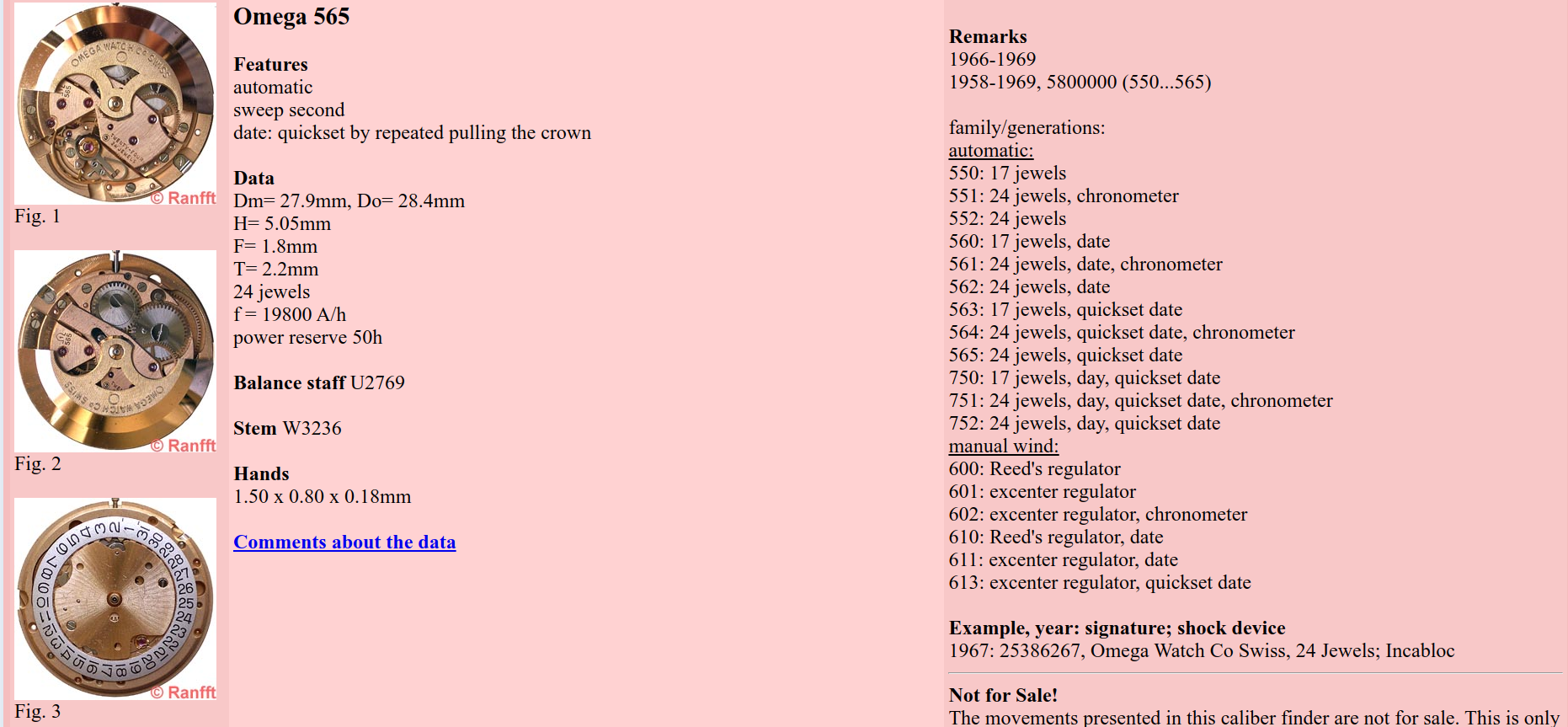

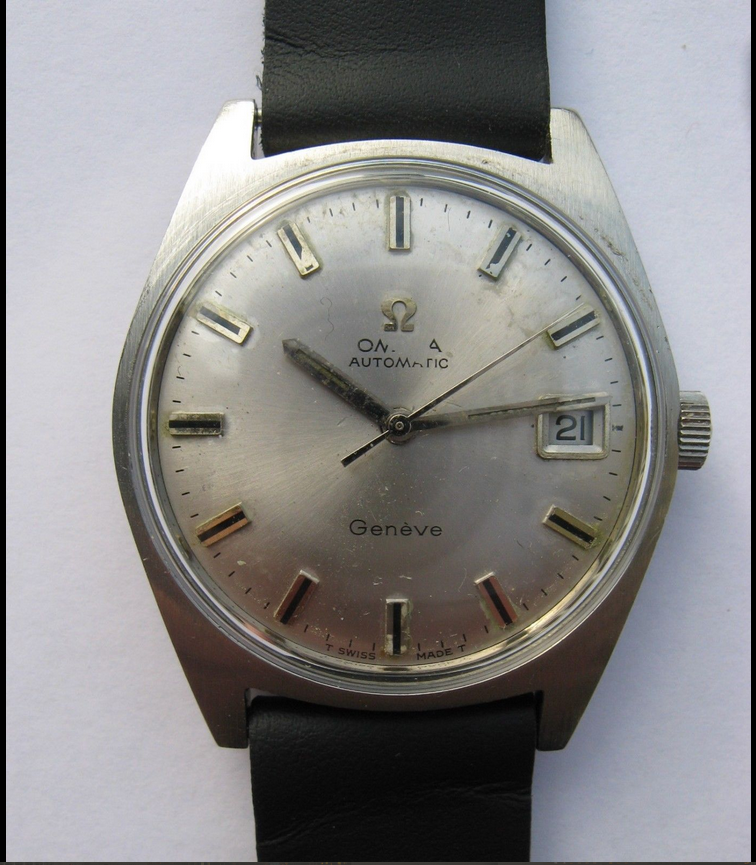

Hi ARCHER
I need a service on my 565 omega if you can help please ??? / can you inter change the parts of the 500 family series ???

Don't you have Google?
