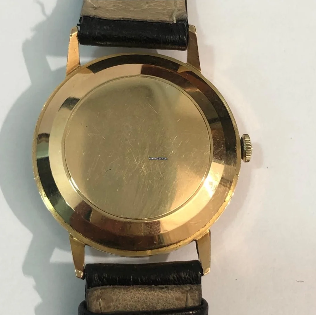

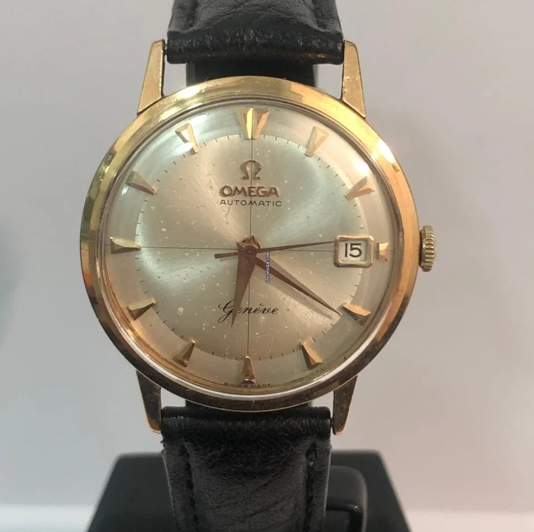

I see a lot of gold capped watches from Omega, and recognise them by their steel back lugs, and sometimes the gold medallion on the steel caseback. However, are there any things I can check that were only done on the solid gold models?
E.g. does this kind of gold caseback only appear on solid gold, or also on gold plated ones?

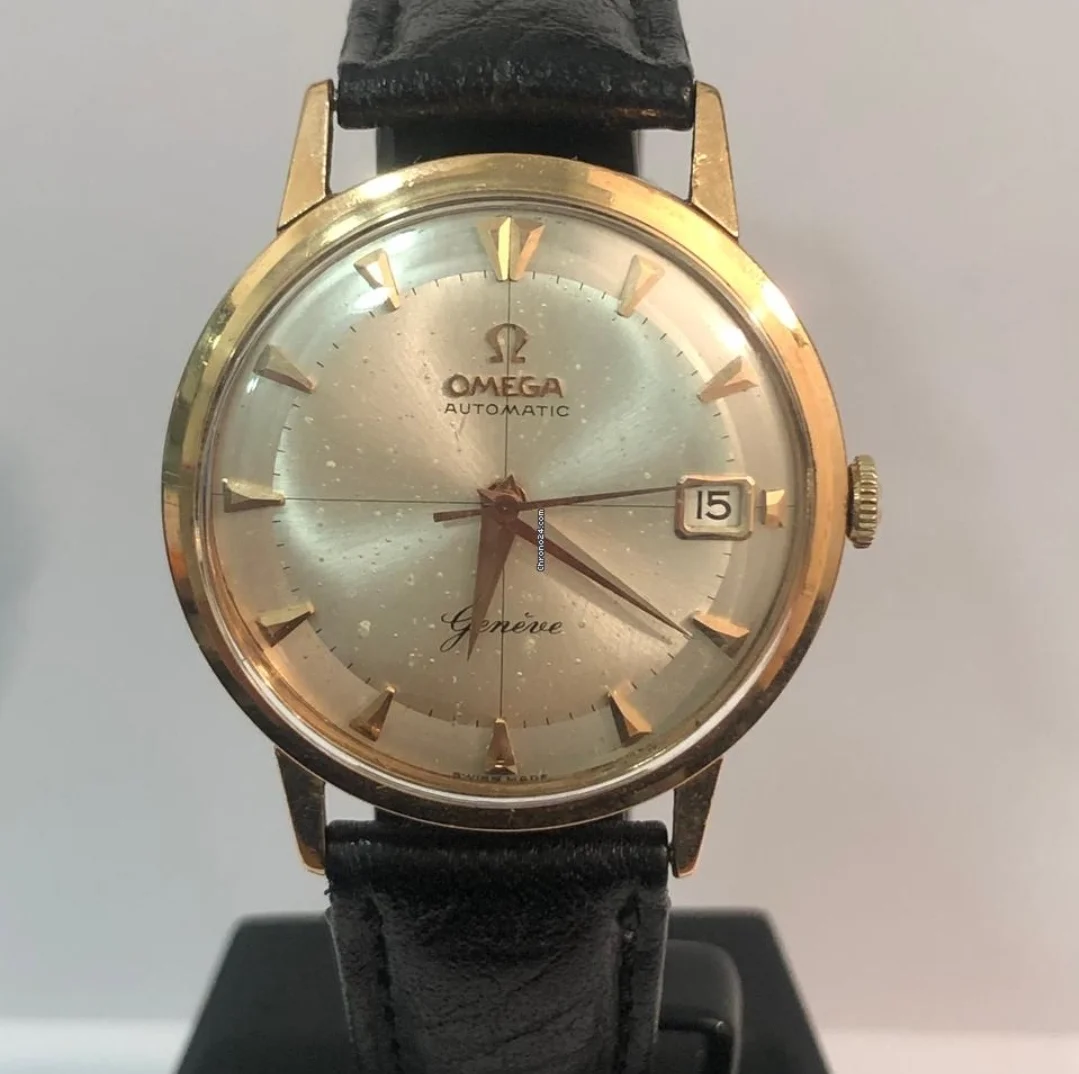

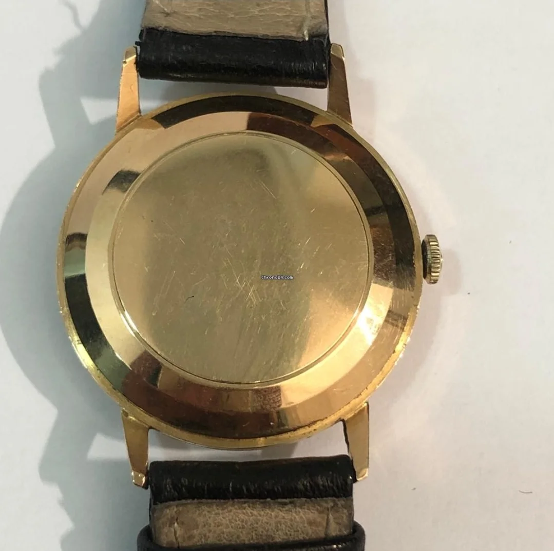

That appears to be a solid gold example. I don't believe that OMEGA produced plated versions of that model, though it's a bit outside of my (slightly earlier) period of expertise.
The crown does not appear to be original, as an aside.

If solid gold there should be hallmark somewhere often on bank of one of lugs. And also marked inside Caseback.
There are also references that had “gold filled” cases and Caseback can be gold color . But this should be indicated inside Caseback Sometimes gold filled is inscribed on side of case. This is common with US market cases.
I agree with @Tony C. this is probably solid gold but need to see inside to be sure.
Gold capped and gold plated watches have stainless Casebacks.
This is a sought after reference but this example has a lot of dial damage with bubbling which brings it down.

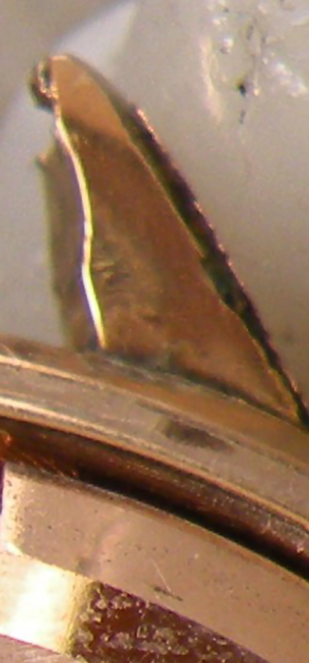

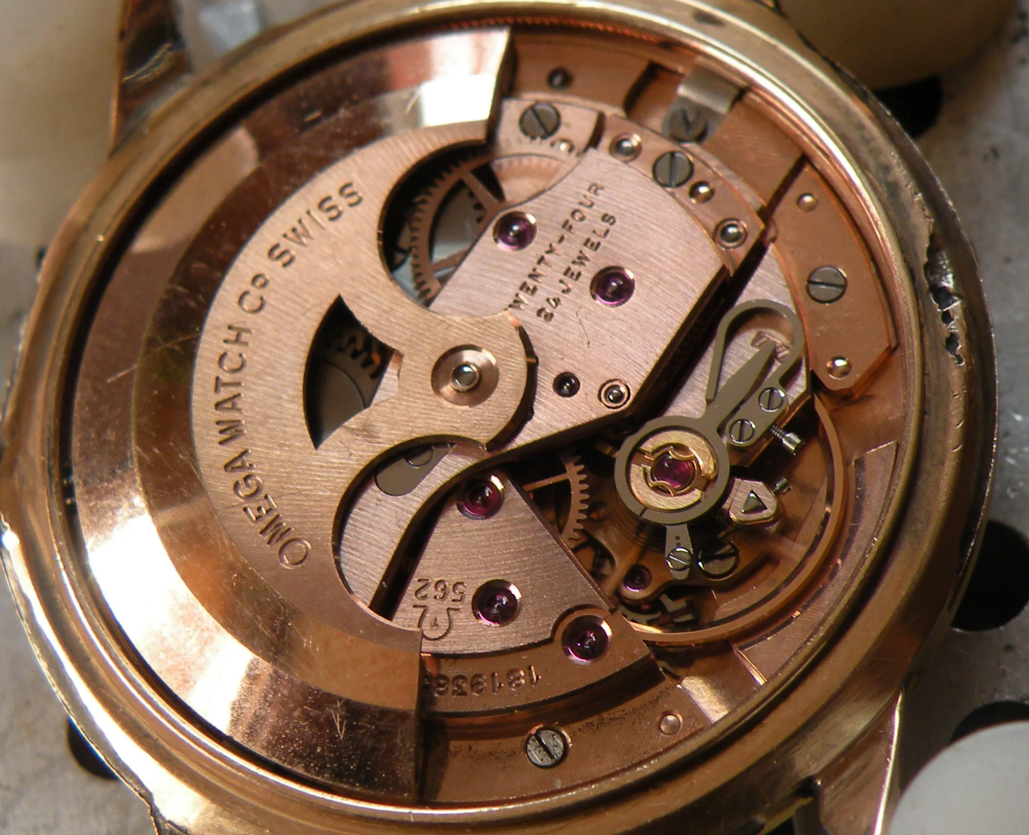

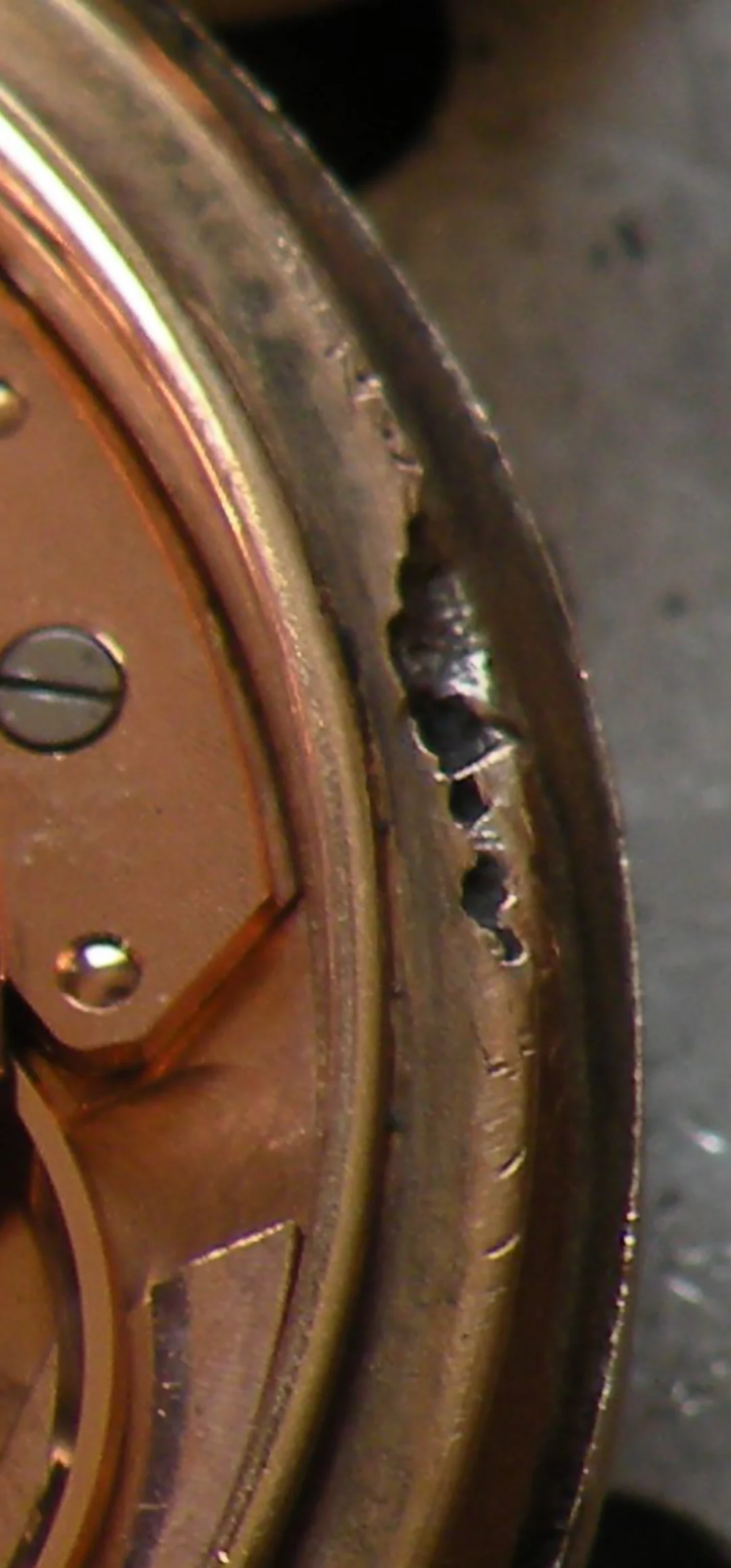

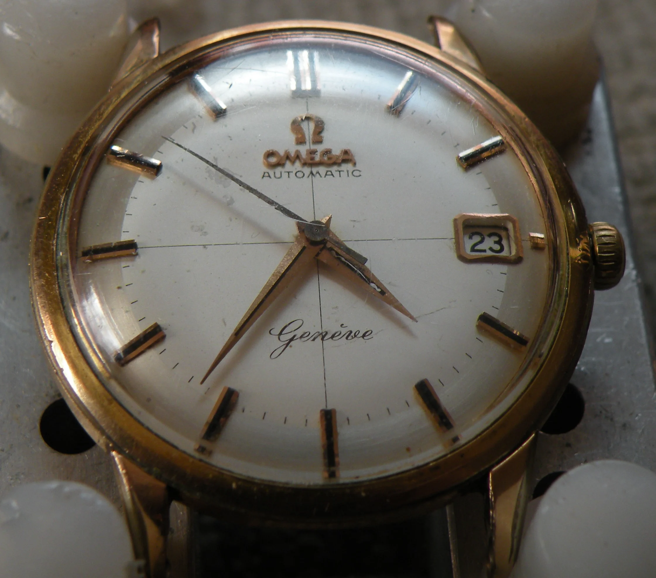

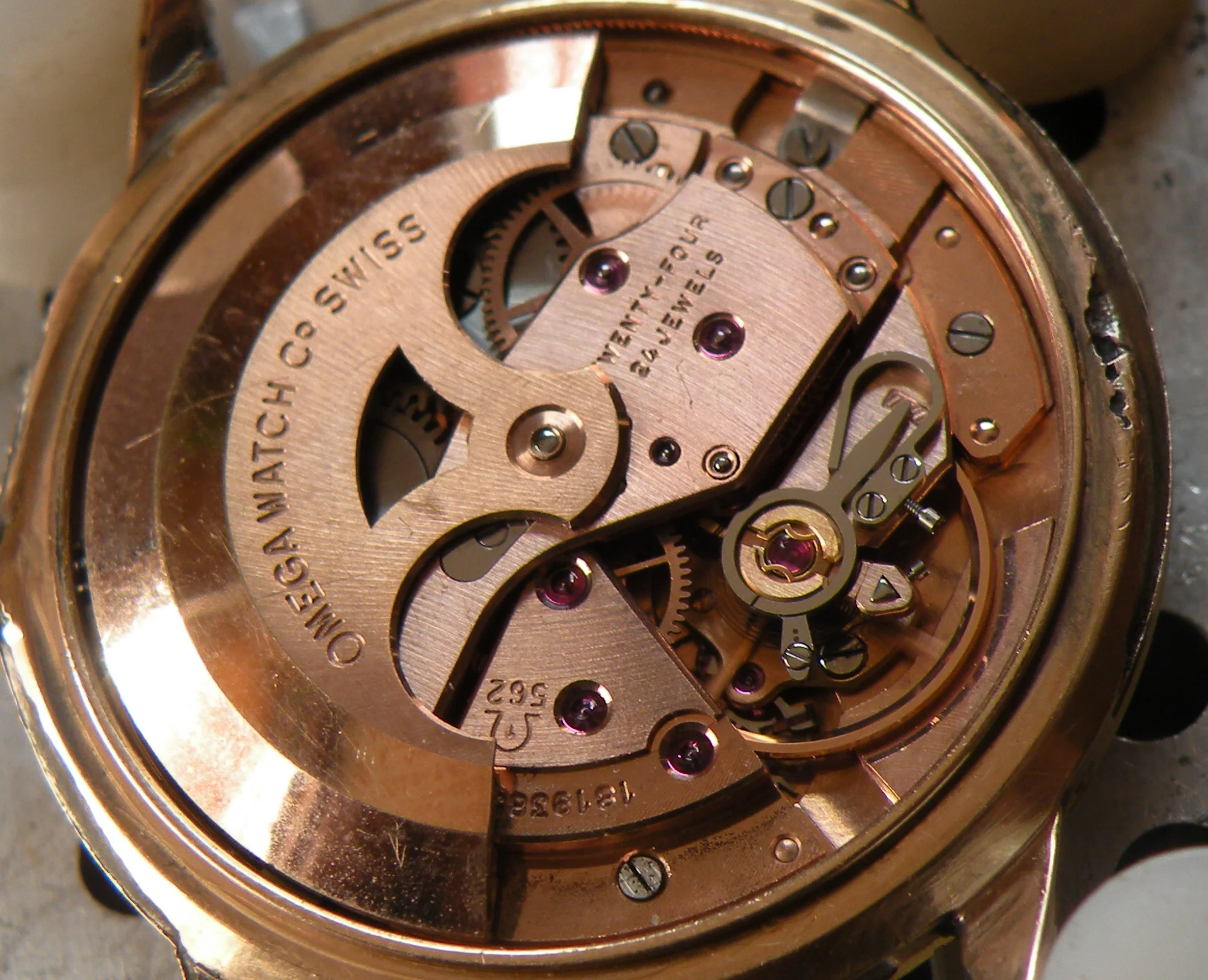

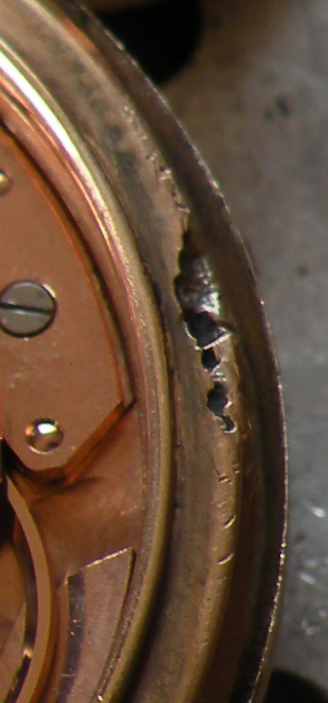

Omega plated a thin coat of gold on vintage Geneve, not 200 micron gold cap.
If you look under the lugs you cannot see any SS there and think it is solid gold but actually, it is gold plated.
Always look for hallmarks to confirm solid gold.

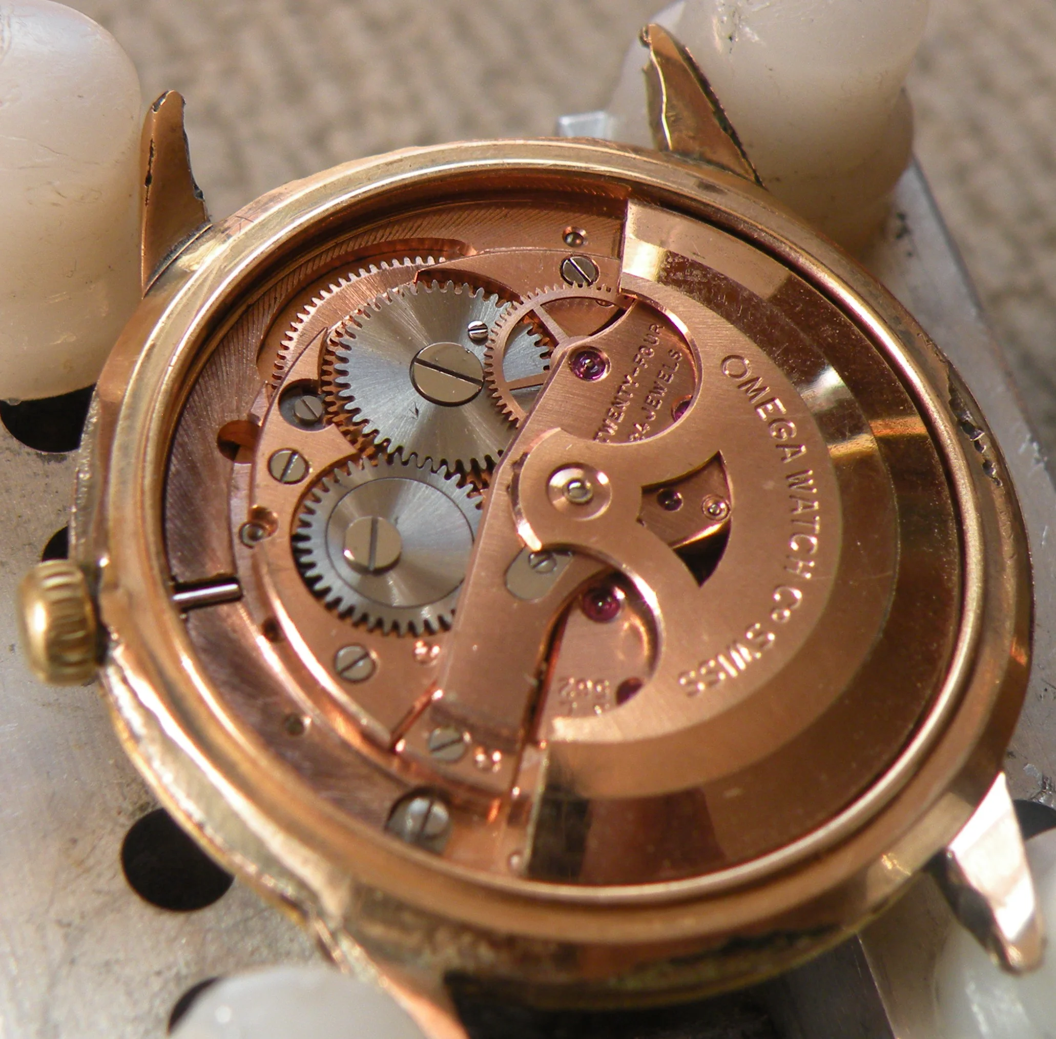

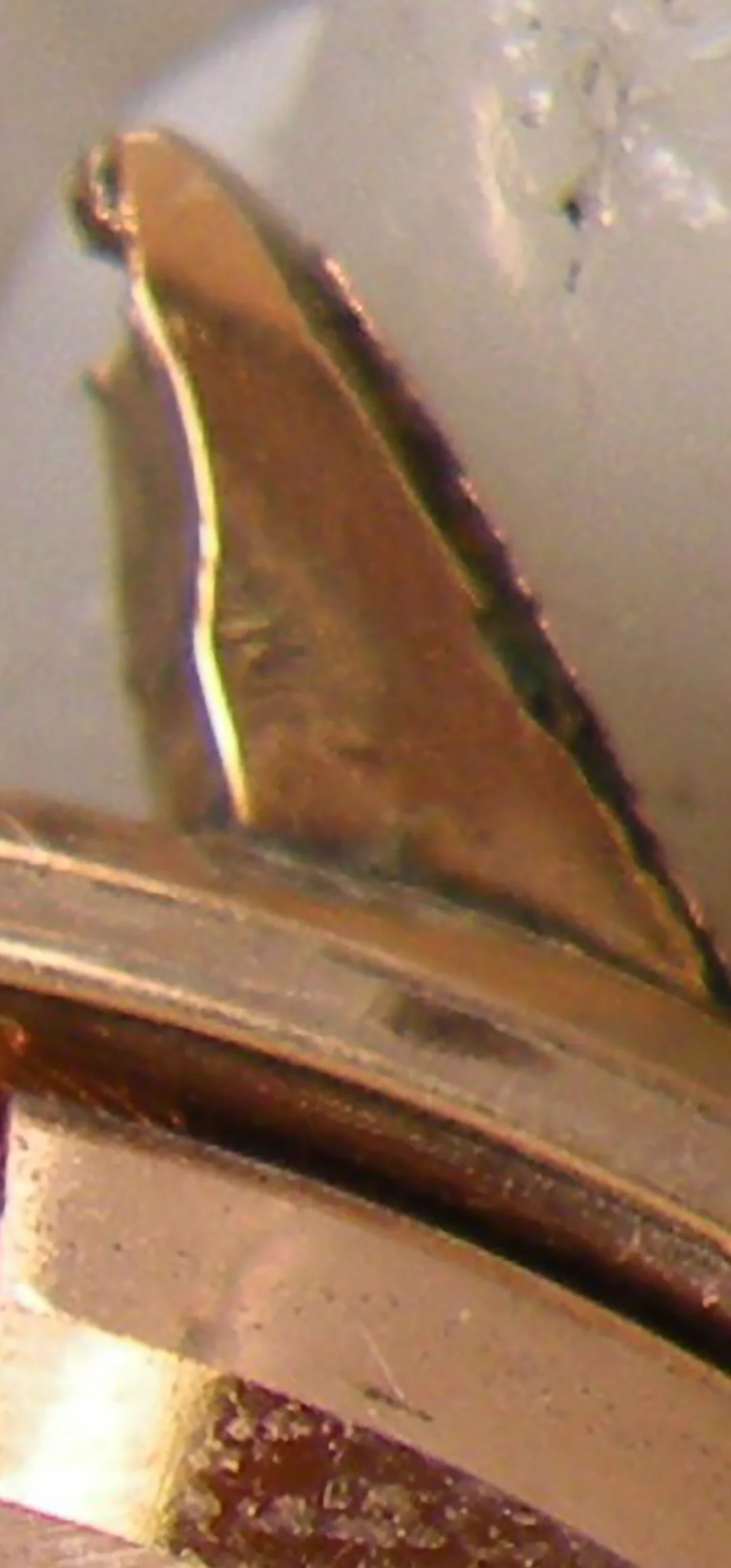

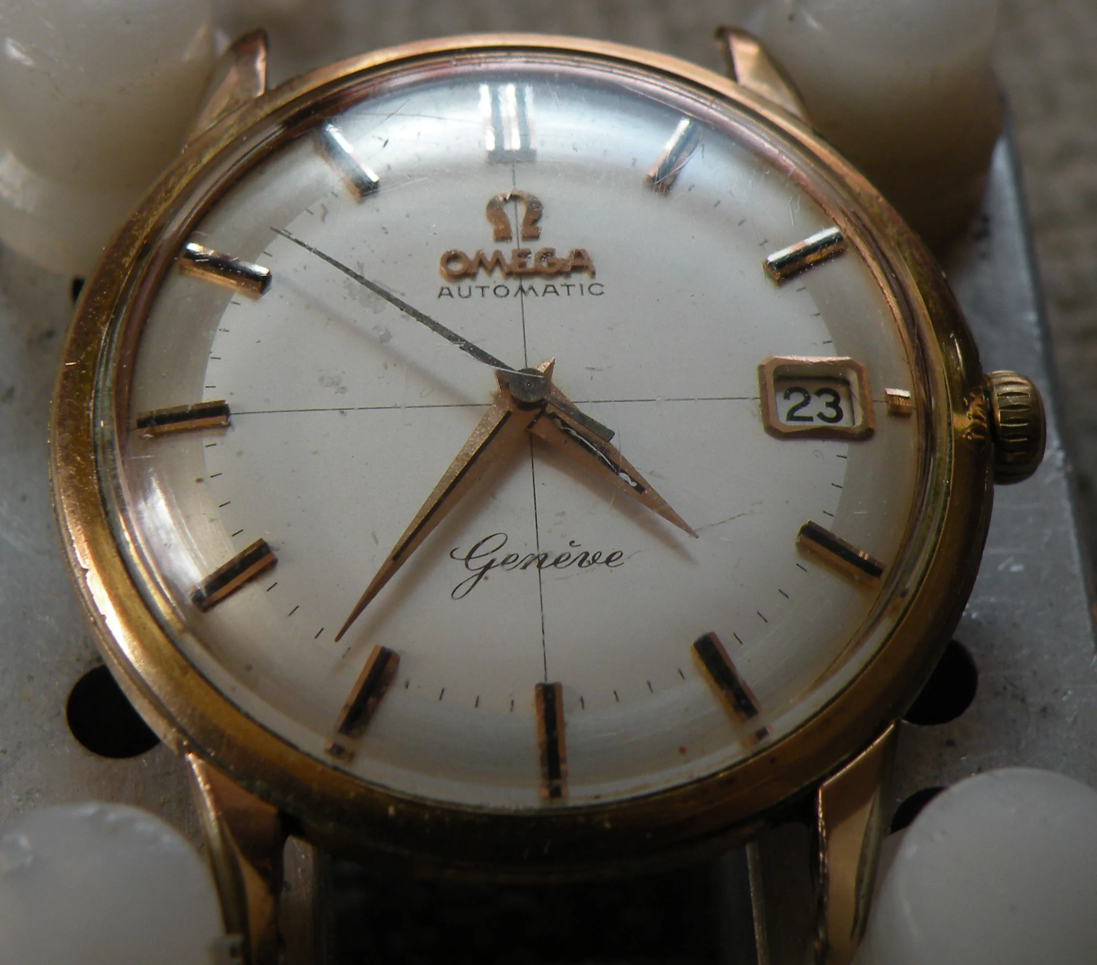

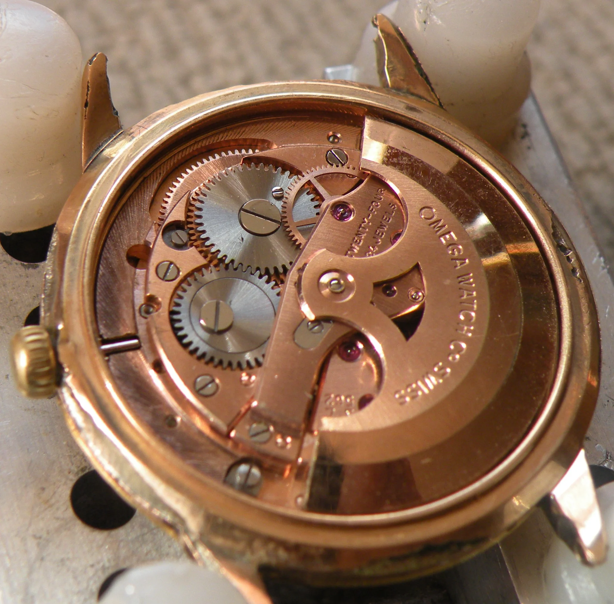

Here are some pictures to know more
They did make gold plated versions of this model, however they would usually have a stainless steel caseback, so we'd need to open it up and find out.
