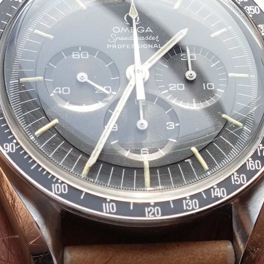

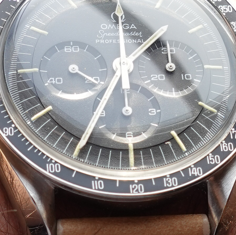

Either way it's a brilliantly beautiful watch and I'm thrilled to have it.View attachment 1134924 View attachment 1134925 View attachment 1134926 View attachment 1134927 View attachment 1134928 View attachment 1134929
Congratulations on your first 145.022 69!
Cases looks sharp!
Everything looks orginal, case, dial, 24 teeth crown, and even the crystal have little omega mark on it.
Dot over 90 looks good too.
The only concern will be the lume on the dial.
From the picture it looks a bit tall, which I can not see clearly with your picture.
If the movement SN is within the range then you just got yourself a great deal!
Cheers

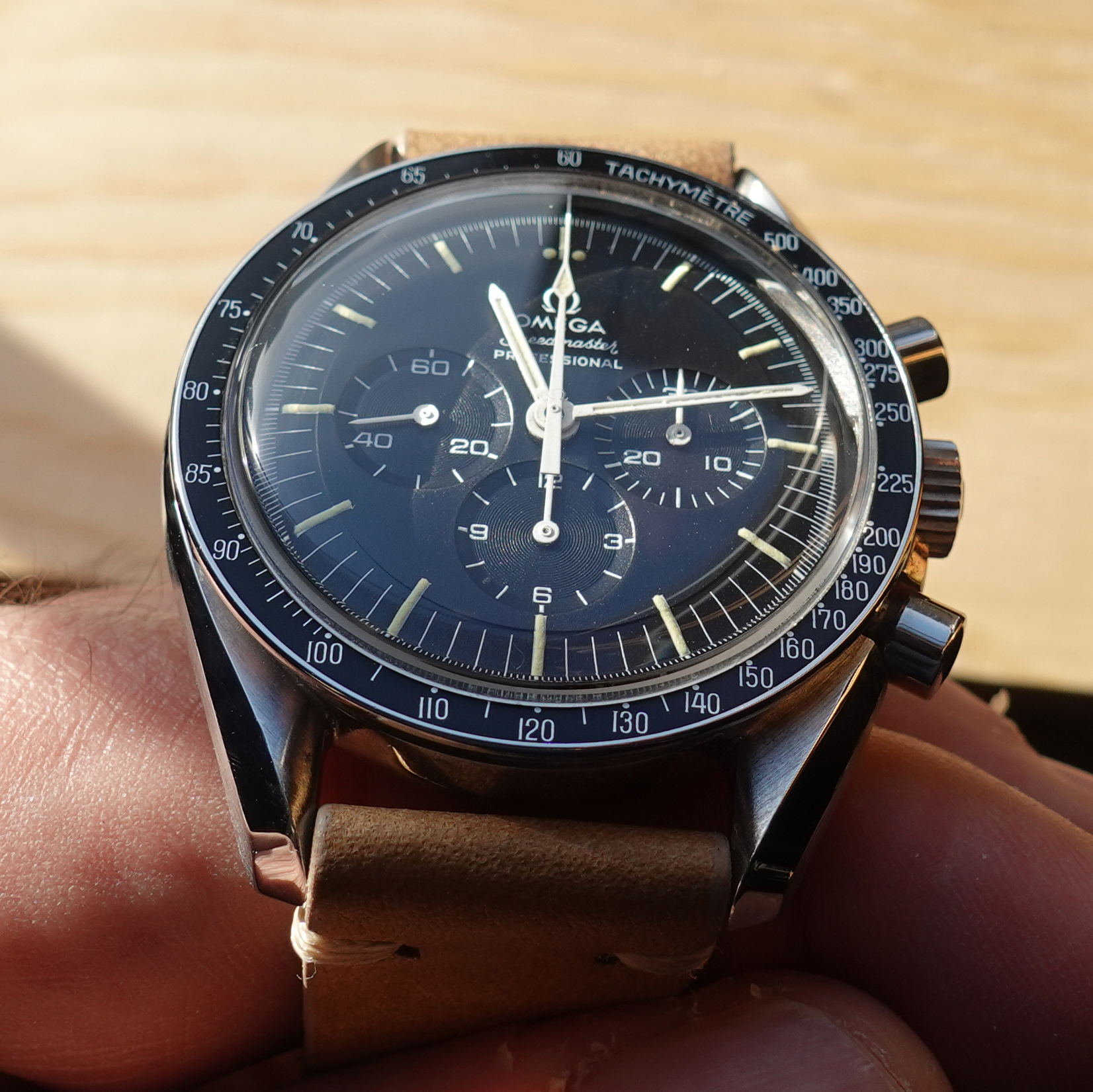

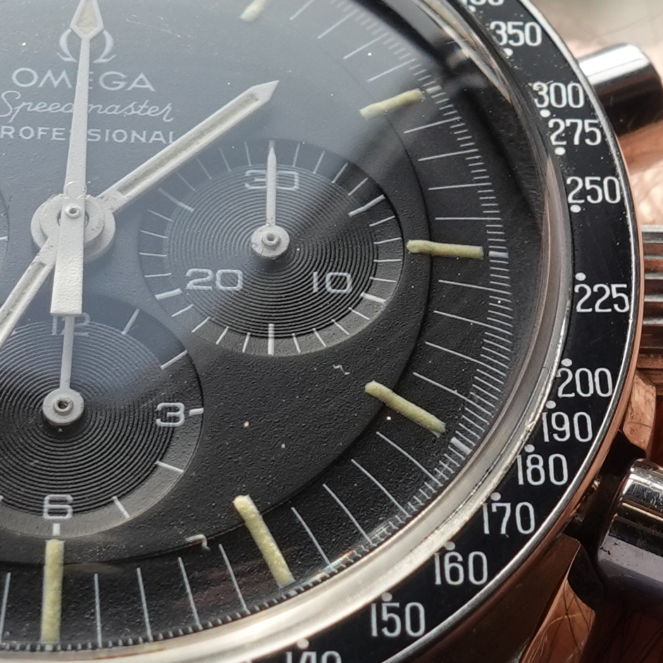

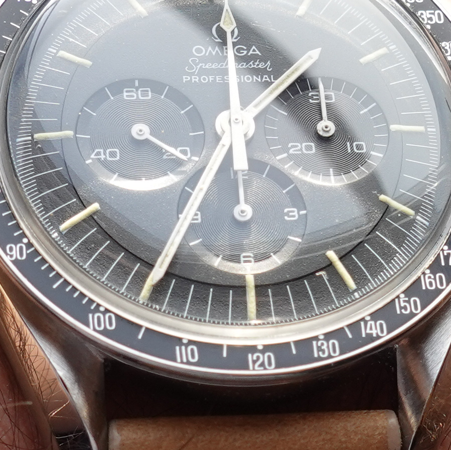

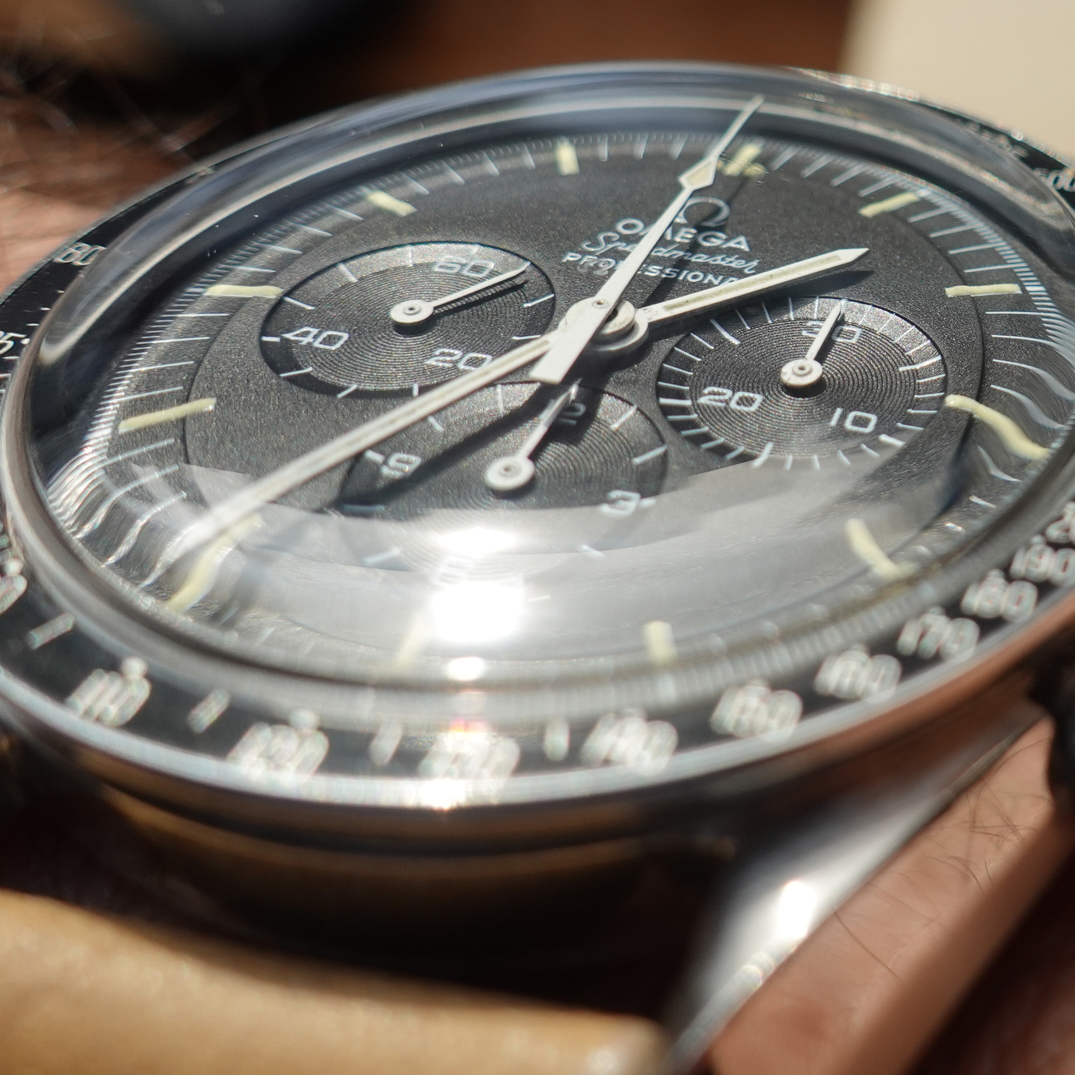

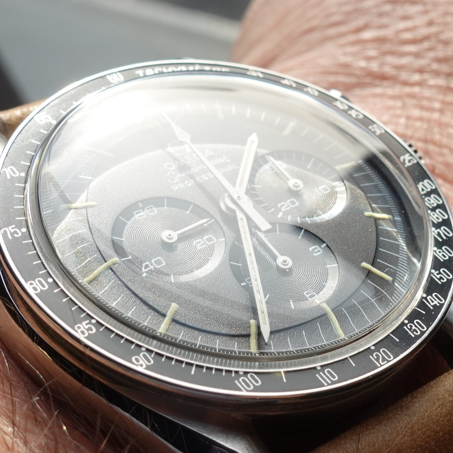

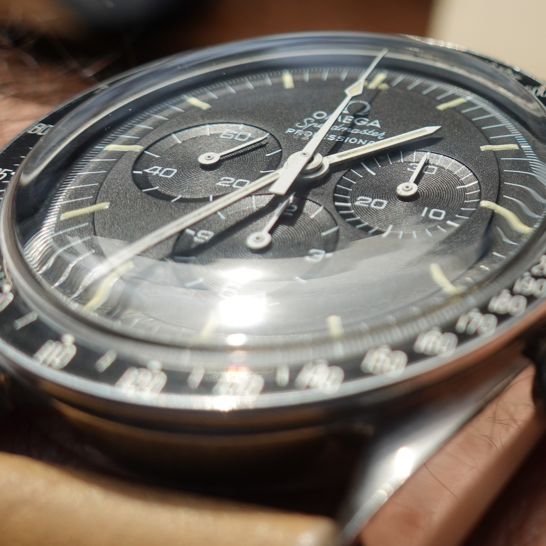

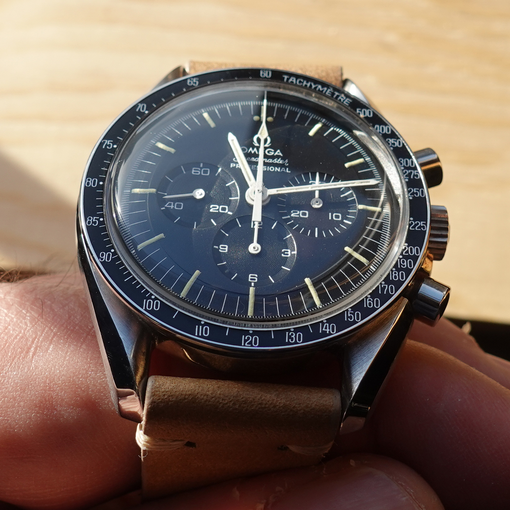

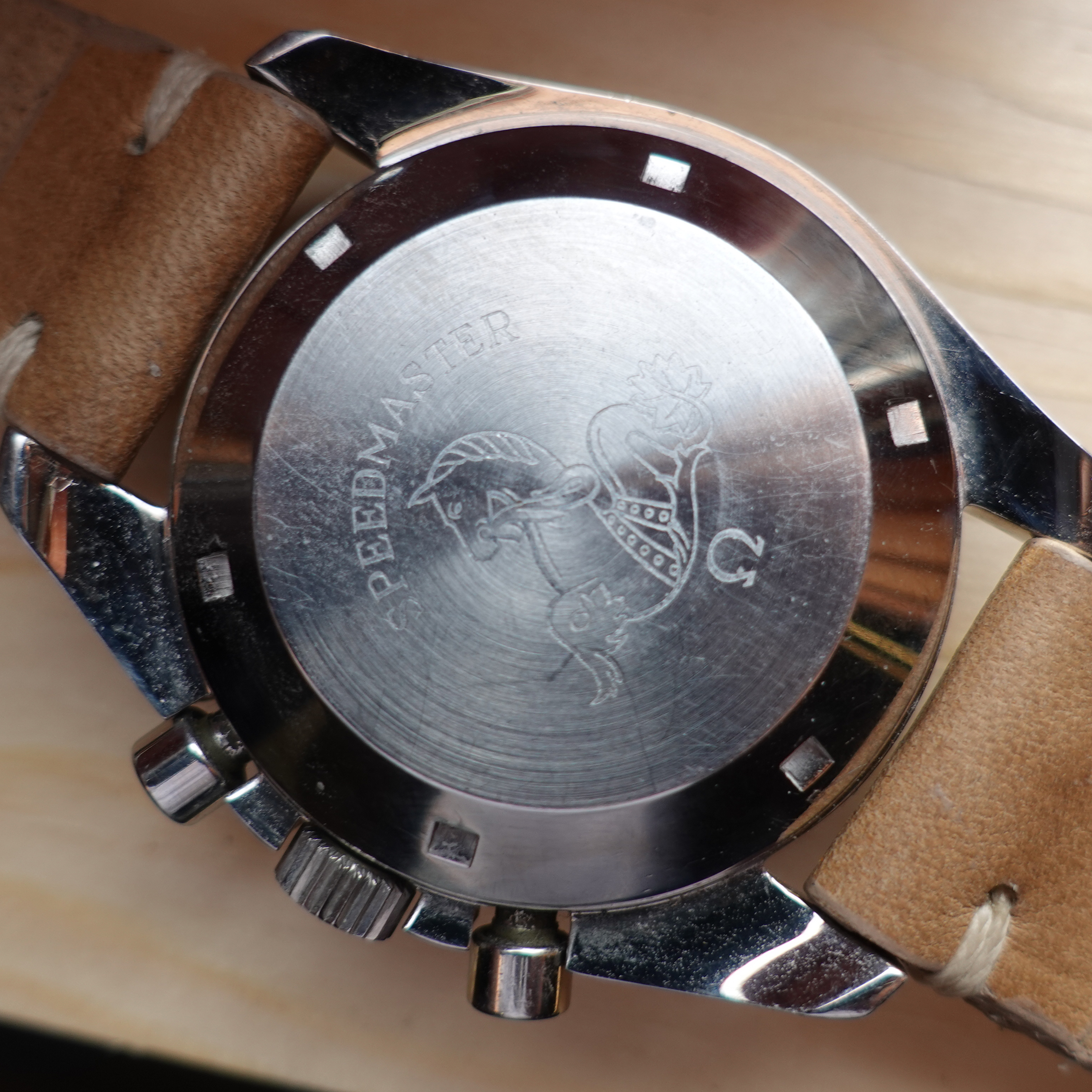

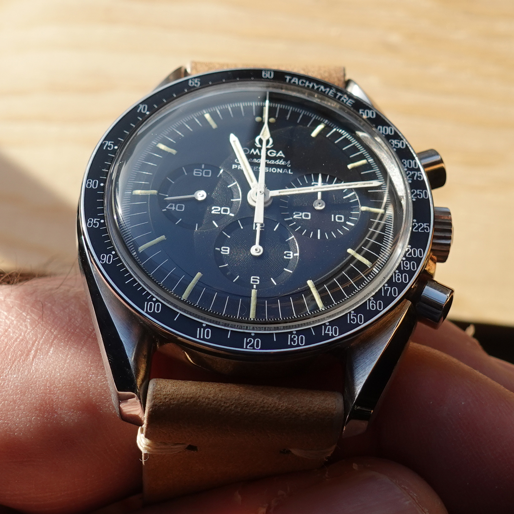

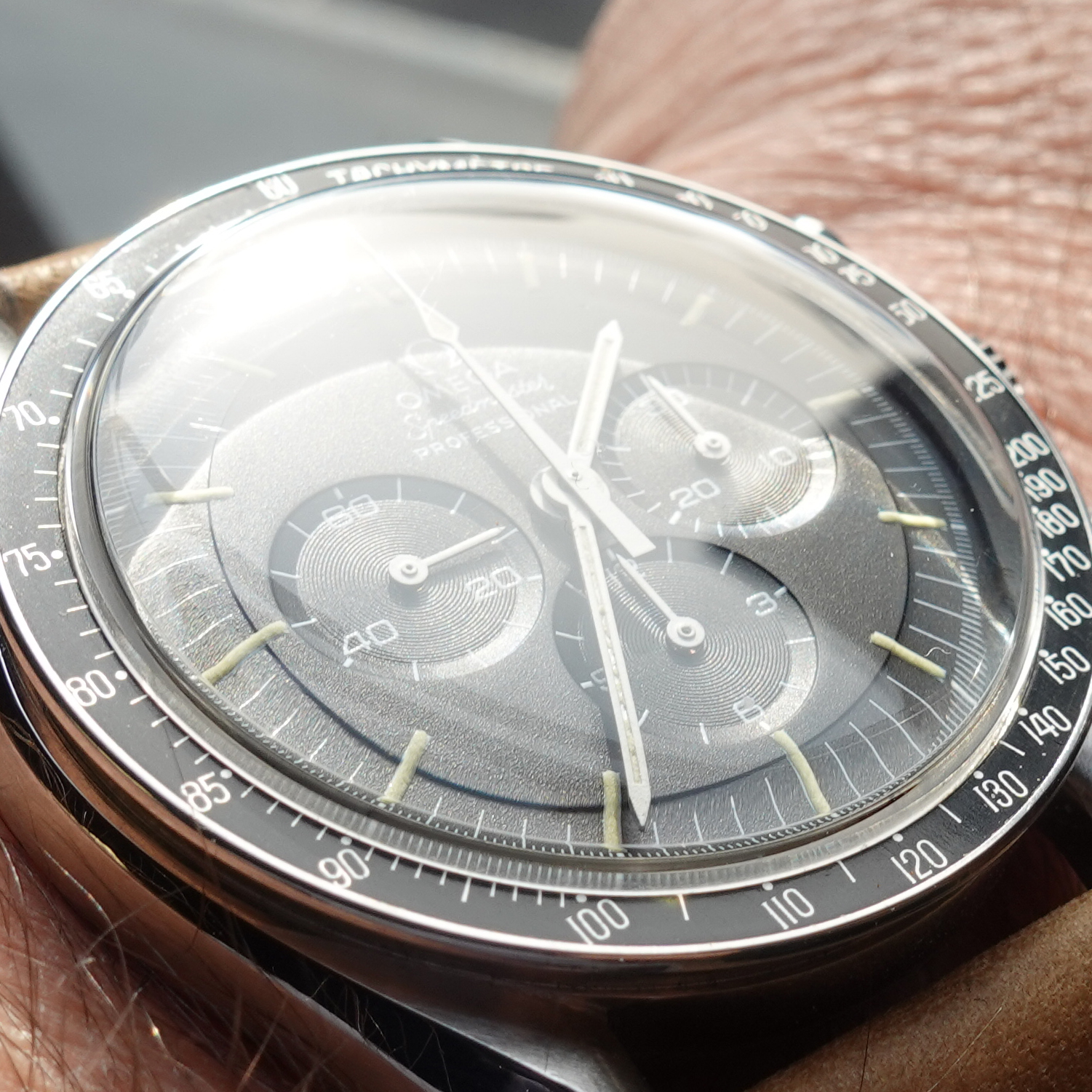

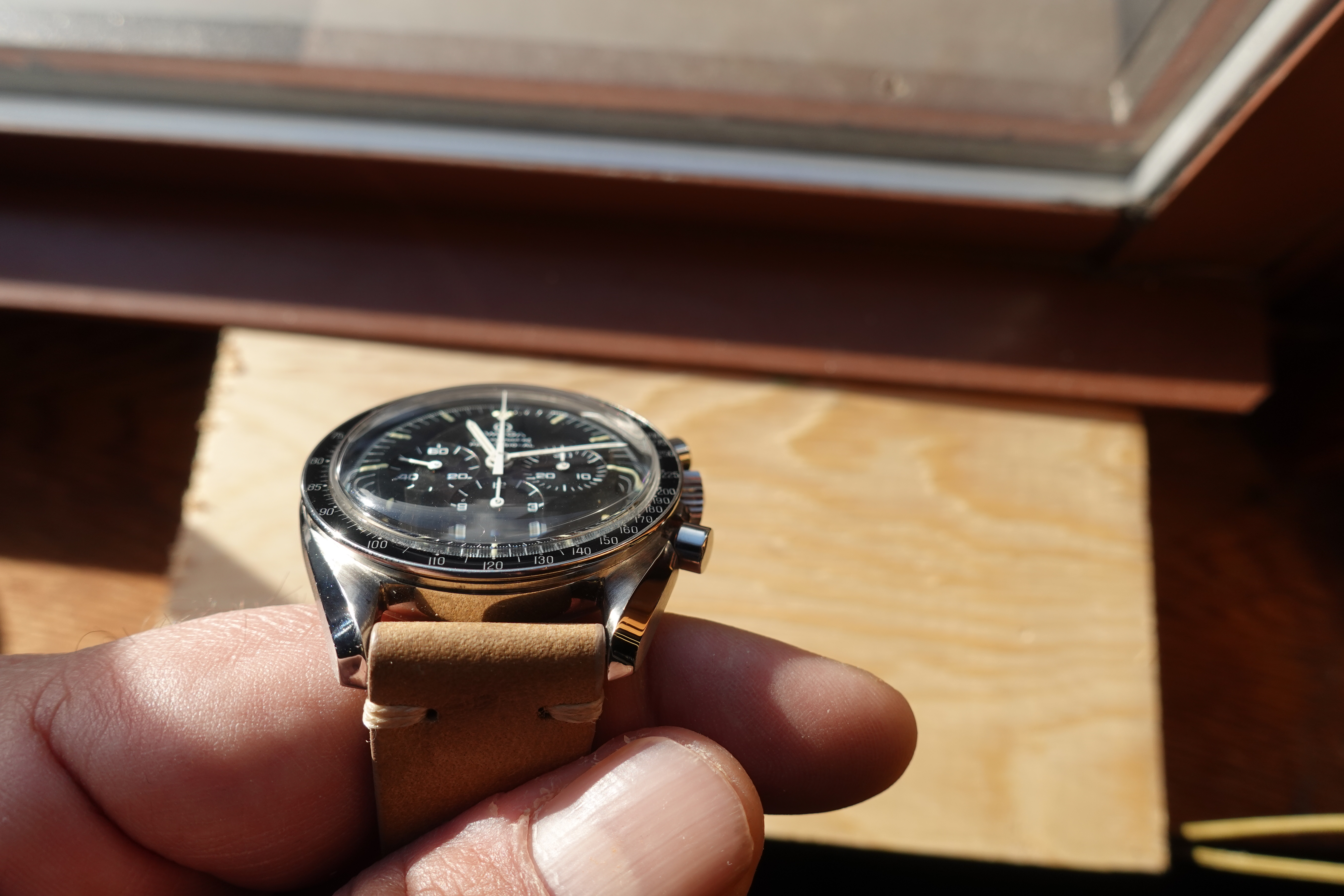

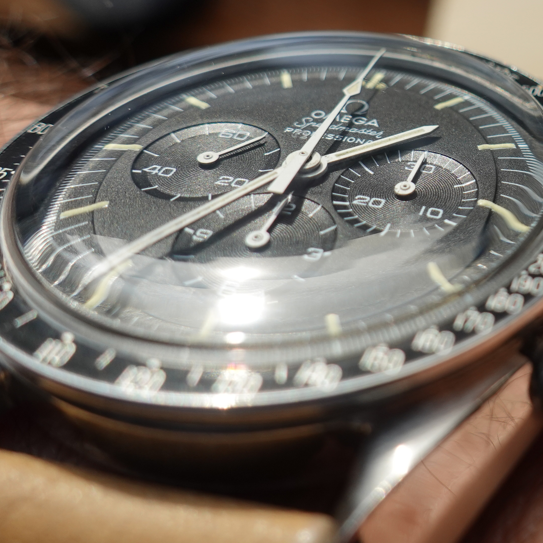

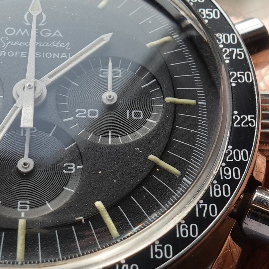

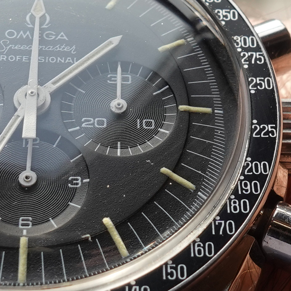

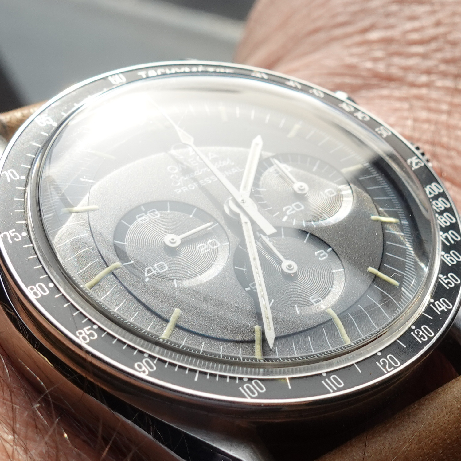

Thanks for your feedback. Here are some new pics taken in the sunlight. I'm not a photographer but hopefully you'll get a better view:
1,565
3,678
Ok thanks. To me, the only interesting picture above is the first one. We clearly see the texture and the volume of the lume.
Thanks to this picture, I, would say the lume on plots and hands is OK and even very nice !
The bezel, if original, is near perfect. The case looks also in really good shape.
My conclusion : congratulations, this will be your daily beater for a loooong time.
Cheers.

Looks all original and in great condition. The case only appears to have had a very light polish.
Overall a nice attractive Speedmaster
Congrats.
