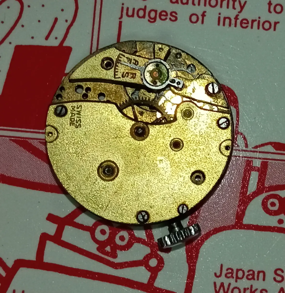

22mm

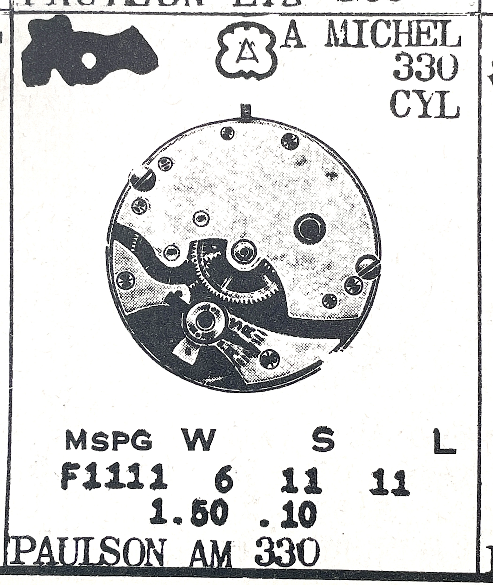

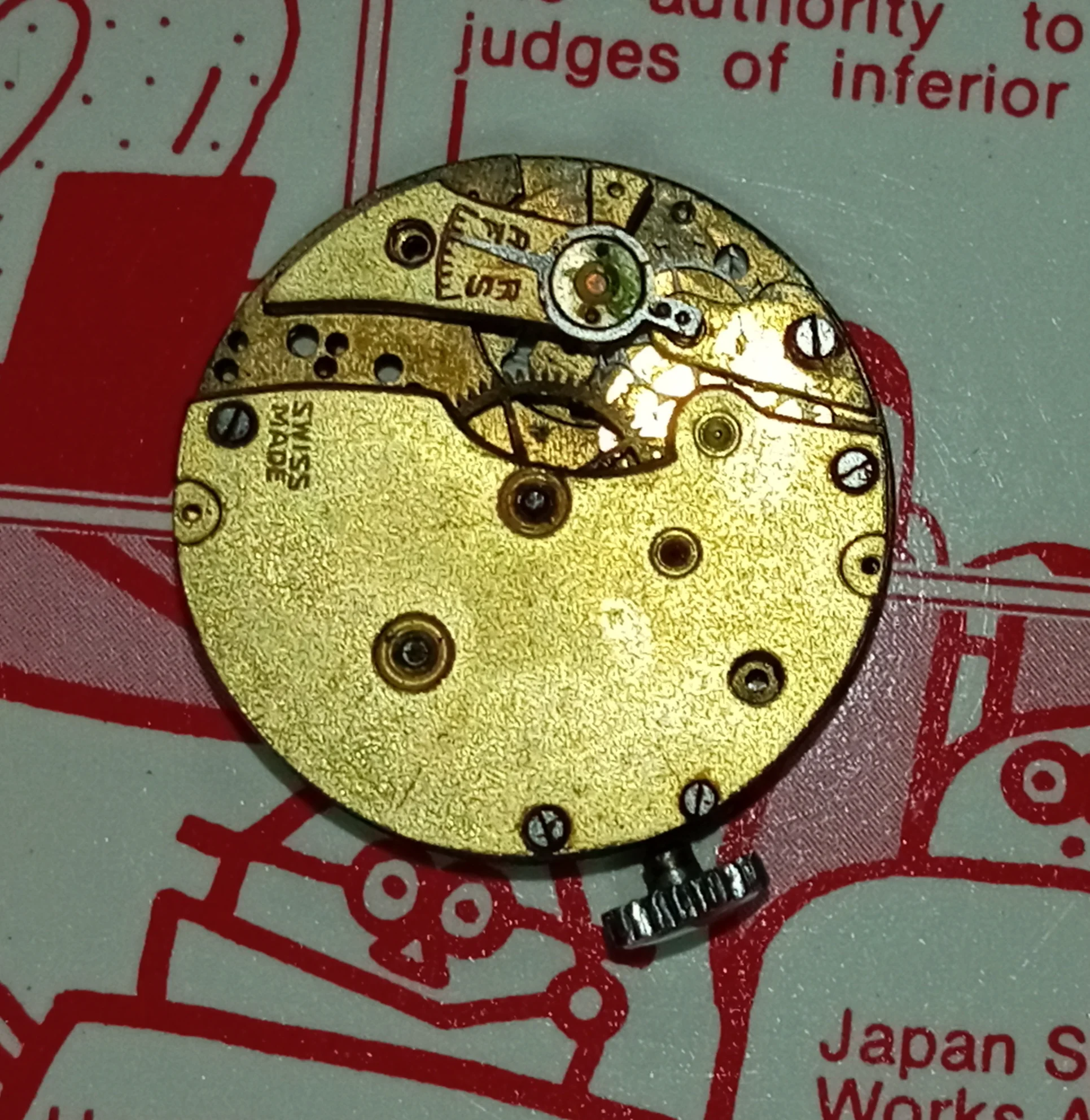

22mm converts to 9 3/4 ligne, so with that size and the shape of the set bridge, and the cylinder escapement, you have an A Michel caliber 330 CYL.
