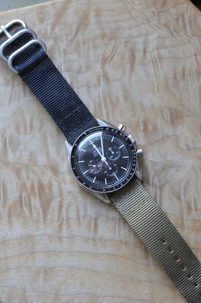

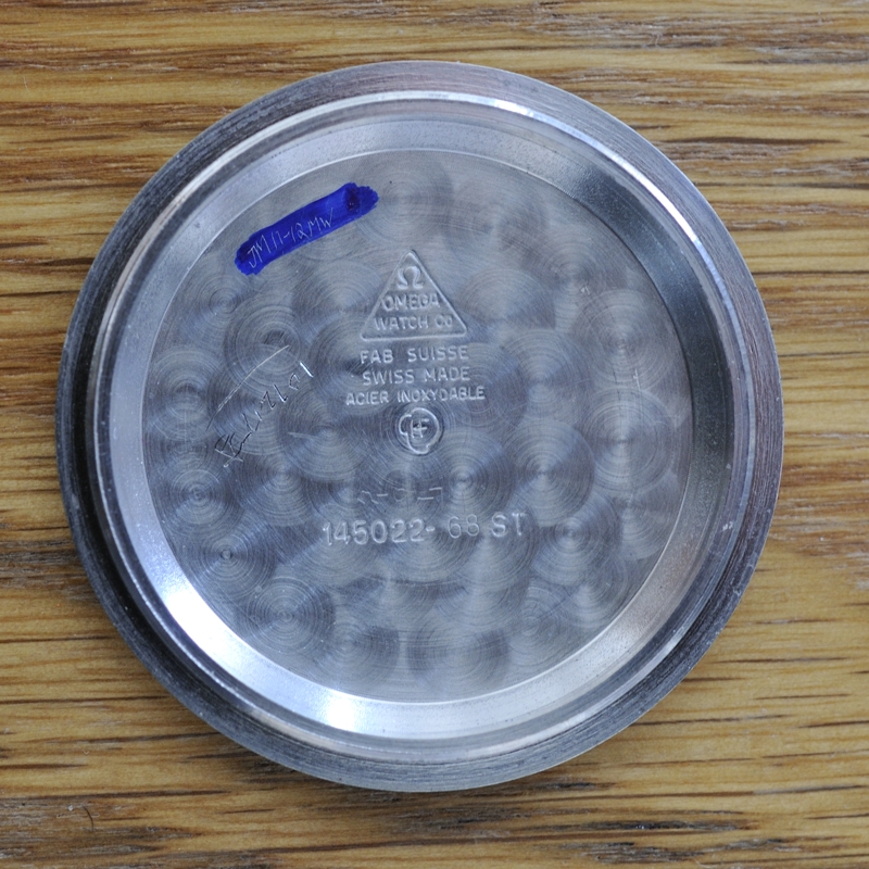

    I have been collecting mostly military watches, but I have been drawn into
    vintage Speedmasters by all the pictures and posts on OF
    So after some reading and studying-
    Here is my first venture into vintage Speedmasters-
    1968 Transitional with DN90 bezel and spear end chrono hand

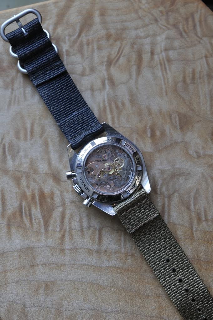

    Case back appears to have been worn smoothe and is blank (no picture included)

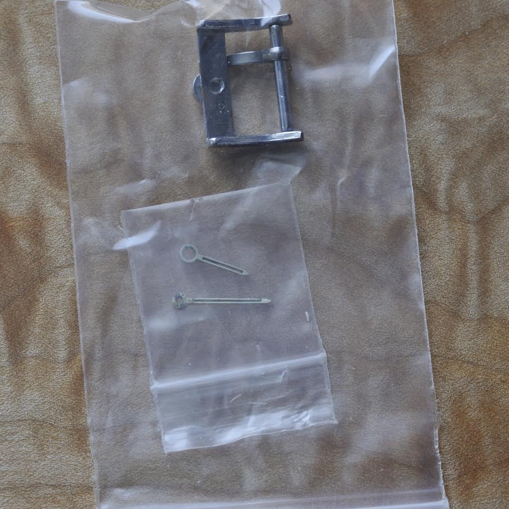

    Hands are replaced but I do have the original ones
    Came with original case back and dust cover and Omega Speedmaster
    clear case back, plus crystal with Omega logo in center
    Serial number in the 26,xxx,xxx area
    Stepped dial has applied logo
    Functions work properly
    Most of the original lume on the long indices is gone-just a bit at the center ends still present
    Have already scheduled a service for March

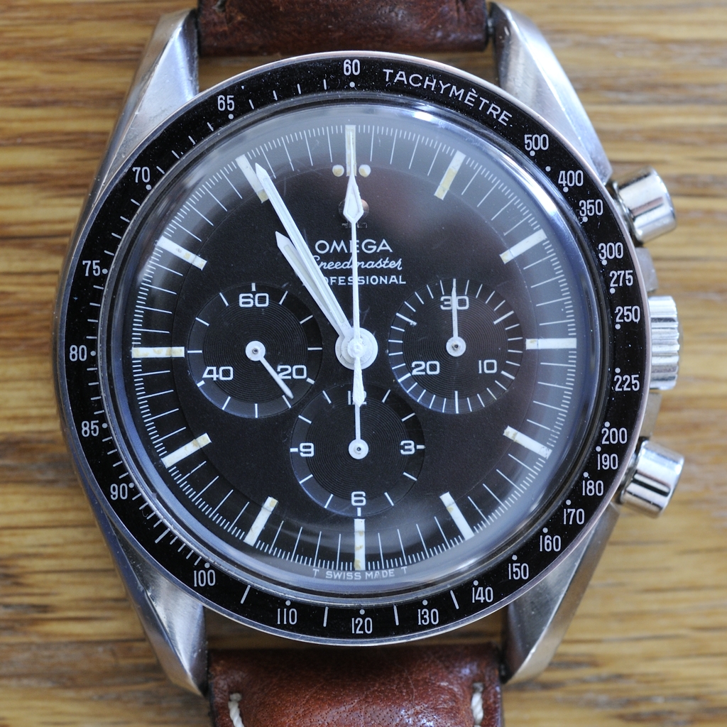

    Questions:
    is the bezel correct? I have read that either DON or DNN can be correct for this
    watch
    Is the spear end chrono correct? I have read that it is, but not sure about the lume
    Replaced hands are superluminova and glow in the dark, but the chrono hand does not glow
    Thanks for the help
    Now I'll be looking for an affordable 321
    68SpeedyDial.jpg 68SpeedyBackIn.jpg 68SpeedySideA.jpg 68SpeedySideB.jpg 68 speedy.jpg 68 speedy back.jpg 68 speedy orig hands.jpg
    Etp095 likes this.
  2. ibis888 Jan 29, 2016
    332
    204
    Welcome to the club! I love the -68 transitionals.
    I'm no expert, but I believe that you have a modern service replacement bezel. The old DN90 bezels have tall TACHYMETRE letters without an accent over the E.
  3. Davidt Jan 29, 2016
    10,409
    18,105
    Are you sure the lume is gone? It looks like a lot of it might be left on but rather pale (hit it with a camera flash in a dark room and the bits that glow still have lume).
    The bezel is modern though. All these should have DON.
    Although there may be some spear end chrono hands on these, the vast majority have flat ended.
    Looks decent. Just the simple matter of a period bezel to find now...
  4. agee Jan 29, 2016
    739
    698
    Thanks Davidt3449 + ibis888
    I appreciate your help
    I thought the bezel looked too new and that it was incorrect,
    but I am still enjoying the watch
    I now see the attraction of these-a pleasure to wear and awesome look
