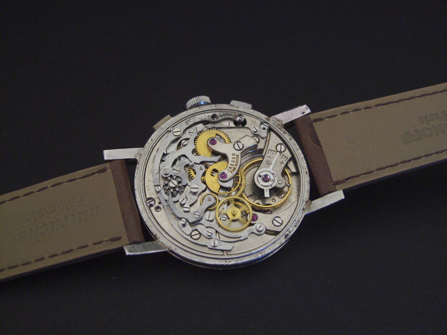

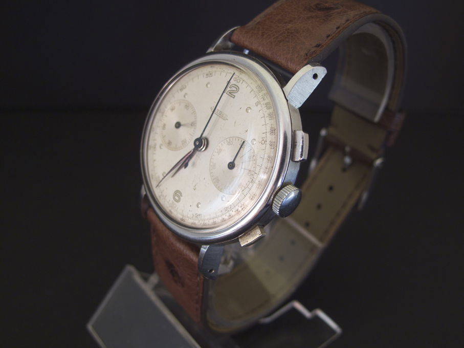

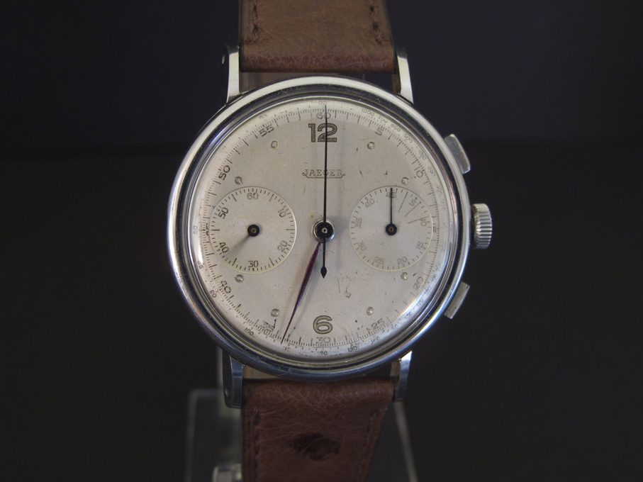

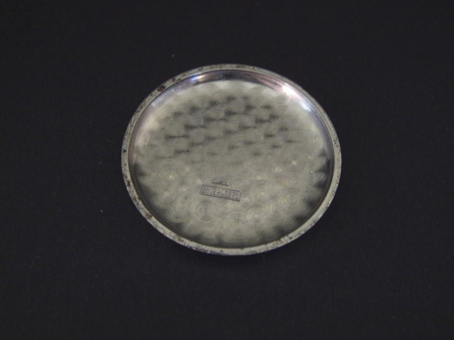

    Jaeger_chronographe_cal285_vintage_2.jpg Jaeger_chronographe_cal285_vintage_6.jpg Jaeger_chronographe_cal285_vintage_3.jpg
    Jaeger_chronographe_cal285_vintage_7.jpg Jaeger_chronographe_cal285_vintage_5.jpg

    1. It has a UG calibre 285 , which is consistent as far as I know
    2. The dial resembles the one in the book on p76 (see below)
    [​IMG]
    It looks quite patina-ed and faded, so it's not a recent redial, and I think it's not refinished (but I could be wrong!)

    4. Inscription says 6-11-90. Bit odd, 1990? Was it a gift of a vintage watch to someone in 1990?

    1. Did these 2-register chronos ever come in SS in that 37mm size? Or is this chromed nickel? Or worse, is this a franken?
    2. Does the movement look OK? (looks a bit mucky, probably needs a service)

    I'm a little worried about the E's in JAEGER, but given the rest of the watch and the period it comes from I'd be inclined to say it's Kosher for Passover.

    So it seems to check out ok? The inscription is weird though - can't figure it out - '90'?

    I believe the dial is fine. The inscription is a head-scratcher, and will likely remain so.
    Always nice to find a "jumbo" from this era of smaller watches - it's from the 40's by the way, not the late 50s.
