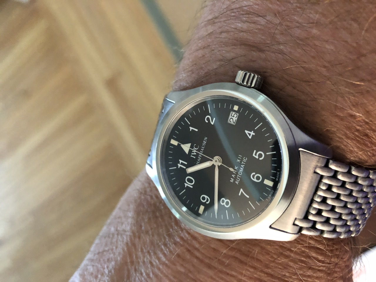

I have a Mark XII, my second actually. I have heard the same about the movement but have never experienced any problems. The pundits say it was IWC’s last great pilot’s watch, I just think it looks awesome.
That looks killer. Not to mention minimal stretch on that bracelet! What happened to the first?

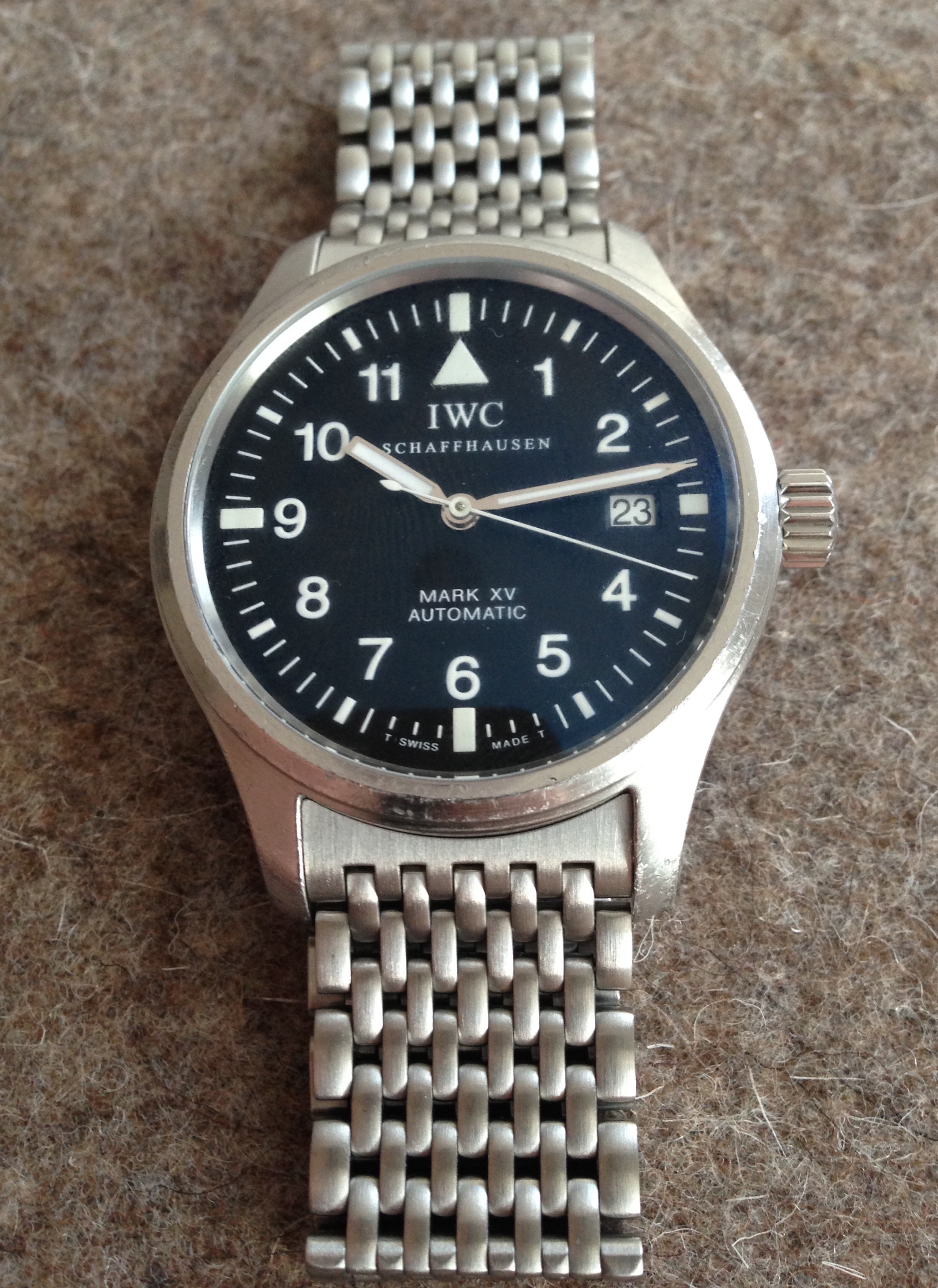

I have a Mark XV and really love it. Dial, hands, case and the size are perfect for me.
I wear it either on the beads of rice bracelet or on a Nato.
Since the movement is based on the ETA 2892-A2, my watchmaker “around the corner” can revise the watch and the costs for it remain manageable.
Here is a service price list from IWC with a price difference of 200 CHF between the Mark XII (base Jaeger-LeCoultre 889/2) and the Mark VXII (base ETA 2892) only for servicing:

For me much of what is described here also applies to the Mark XV.
I sold it to fund something else, I can’t even remember what it was. It took a few years to realize that I missed it. So, I spent the next couple of years scouring eBay to find a replacement. It’s just one of those watches that I will always have. It may be small by today’s standards but is still very wearable, especially with the bracelet.

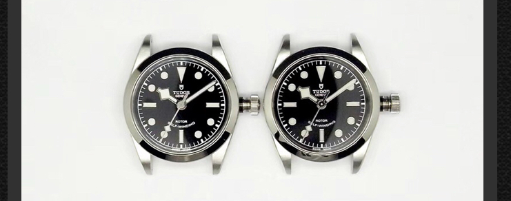

Well, I serviced a Mk XV some years ago (ETA 2892 based movement) and it had been back to IWC twice. What I found was work sloppy enough that I question if the person doing it had ever been formally trained. To give you just some idea of how bad things were, these are shots of the inner anti-magnetic cover...
If it's not obvious, there should not be fingerprints on these parts, so maybe IWC doesn't issue finger cots to their watchmakers...
In any case, a watch that didn't work right from the day it was purchased from what the owner told me, and had been back twice for service to IWC and still wasn't right, worked fine after I serviced it. And to be clear I didn't do anything special - I just gave it a proper routine service, and it worked great.
So I'm not so sure the cause of any service problems are really because the movement, but maybe the watchmakers they hire for their service centers.
One thing to consider on the ETA (now Sellita) based watches, is that there are some pretty convincing fakes out there. I've had one in my shop and it didn't have the normal set of tells on the dial - it came down to the movement. So the JLC based watch is less likely to be a fake if you can get a shot of the movement. Just one other thing to think about.

Wow, thanks for that. I knew there were “reps” (detestable term and practice) out there, but I didn’t realize they were that good. So the Mark XII is less likely to be faked? Is there any safe way for a prospective online non-watchmaker buyer like me to tell if the watch was legit, assuming I can get the seller to pry open the caseback for me?
The one I had that was a fake was a Mark XVI, that had an ETA movement in it. It didn't have an IWC movement number on it anywhere, and the finishing of the bridges and wheels wasn't the same as the other IWC's I'd serviced. In addition it had a nickel gilt balance instead of the higher grade Glucydur balance...
Externally it was a very good copy, and as I mentioned didn't have the normal tells on the dial and case. But the dial and case for this watch is very simple, so not difficult for fakers to get right.
I think the way to minimize your risk is to buy from a reputable seller, and then see if IWC will authenticate it for you.

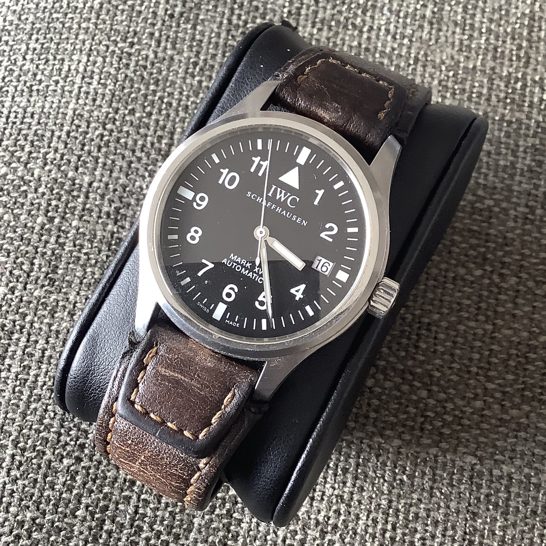

I used my mark XV daily for the best part of 7 years and it never missed a beat (that is until I dropped it). Although I haven’t had it repaired yet I’m pretty confident it should be a simple and low cost job. They make great daily wearers and I’d say the size is spot on. I used a UTC buffalo strap on mine and even that survived the 7 years without failure.

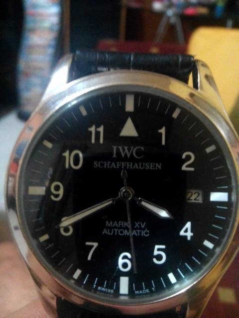

The first one’s a fake Mark XV I saw on Facebook. Not a very good attempt. On the other hand, the second pic is of a ridiculously good replica of the Tudor BB36. (Cropped the pic to deny publicity of these abhorrent things). I always thought fake/replica makers went after Rolex. I guess For IWC the importance of the rule of buying the seller exponentially increases as you move up the horological ladder.
Interesting. The watch fell out of your rotation? 😀 Great looking watch on a drool worthy strap! I thought they only made those for the TZC/UTC 3251. Did they make those for the Mark XV/XII as well?
