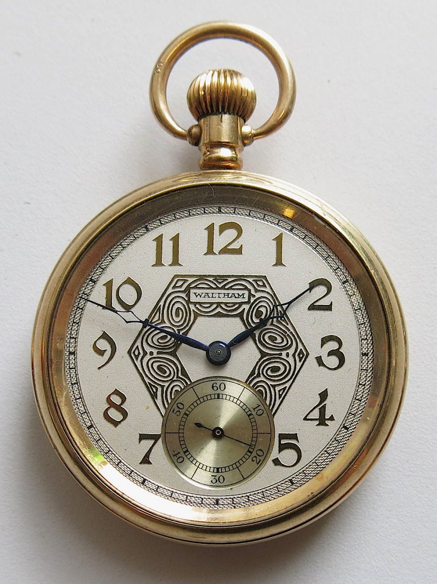

    While waiting for new balance staffs for my Hamilton 992B movements, I had time to strip my Waltham pocket watch ready for cleaning.
    Disassembly was trouble free and it was interesting to see the difference in design between this and the Hamiltons.

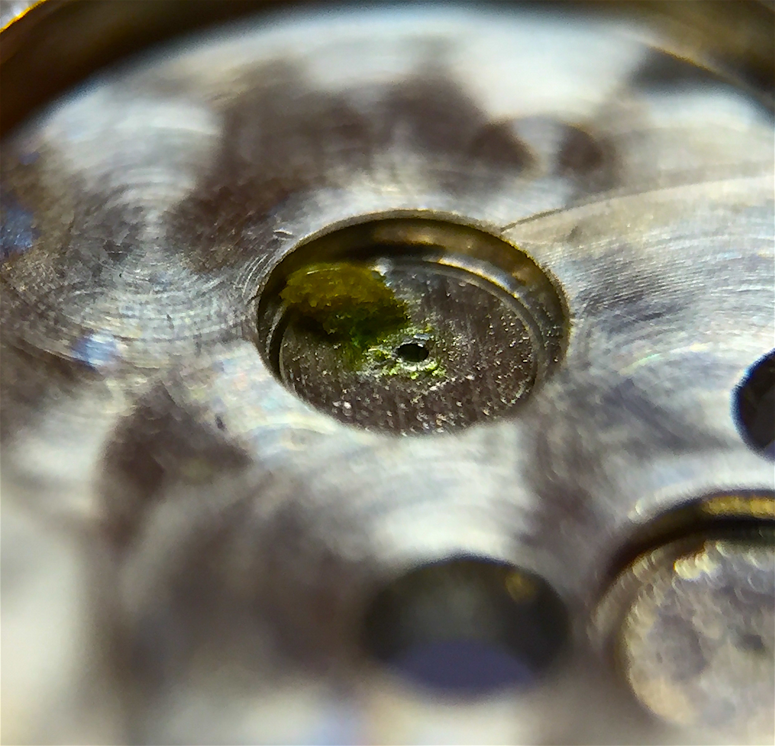

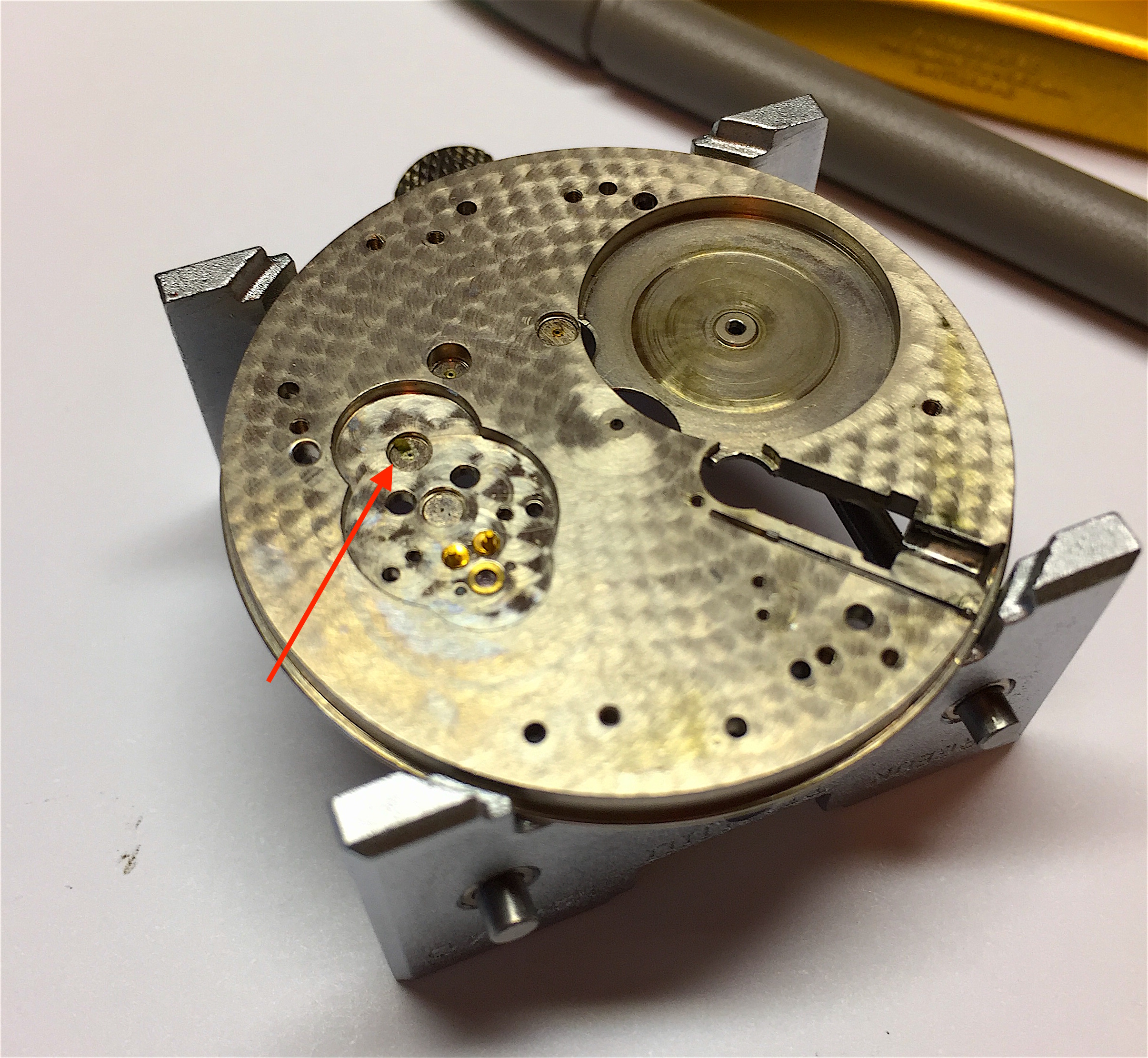

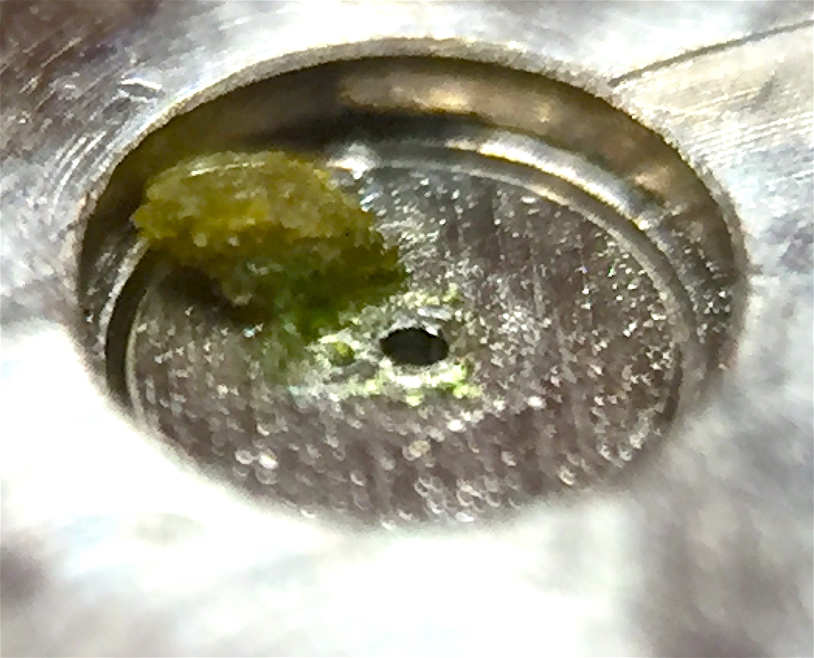

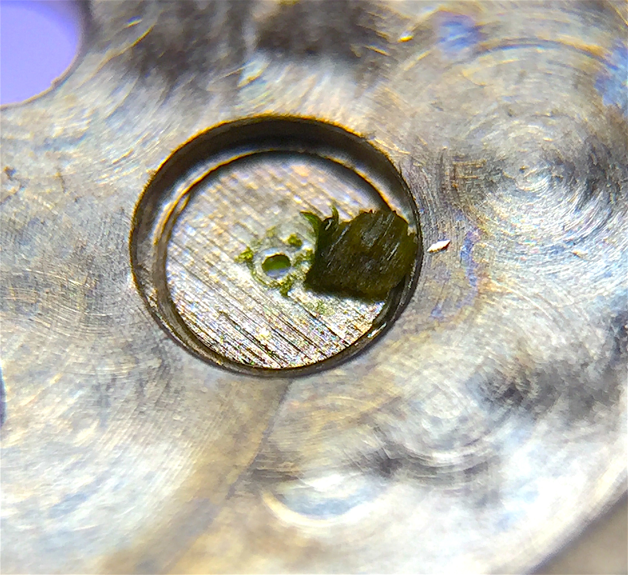

    In addition to enough excess oil and grease to start my own refinery, I happened to find this "jewel" under the escape wheel.
    Can't see it? Let's have a closer look.
    Definitely not part of the movement.
    I know it's good to use pegwood to clean jewels etc. but you don't leave chips of it behind!
    It may explain erratic performance.

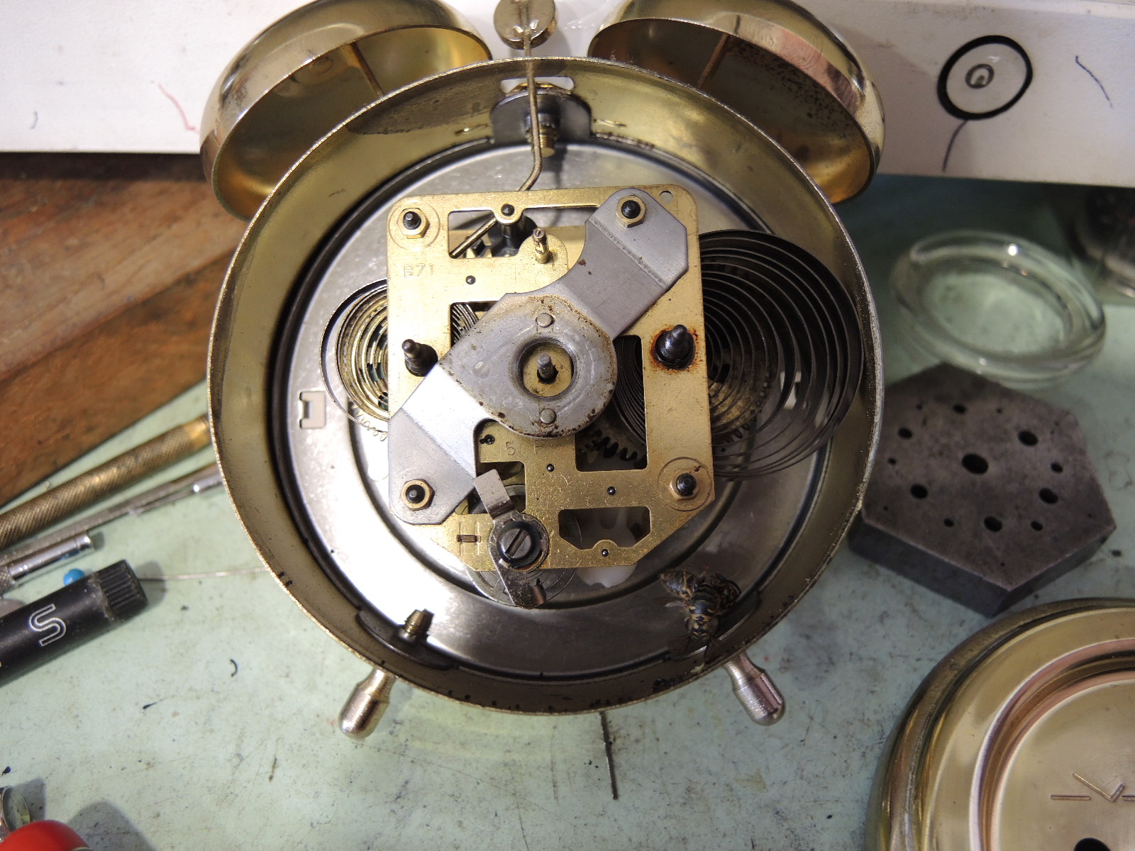

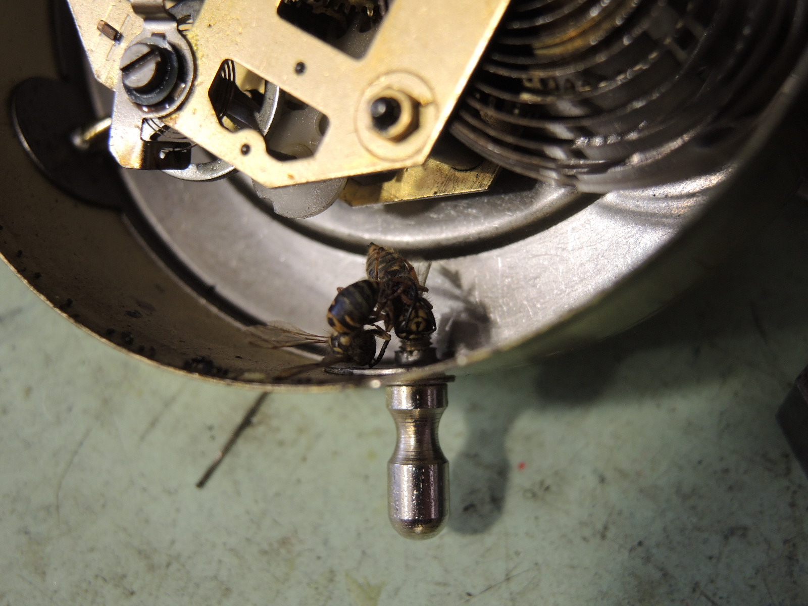

    When I read title like yours I always have this (or worse) in my mind:
  3. Archer Omega Qualified Watchmaker May 10, 2017
    26,343
    65,049
    I recall seeing a video on TZ years ago of a watch that had a live bug inside it - crawled across the dial then disappeared inside the movement through a hole in the dial.
    Oh, and there appear to many "watchmakers" who went to the "if some oil is good, more must be better" school of watchmaking. The butchery you see is sometimes quite amazing...

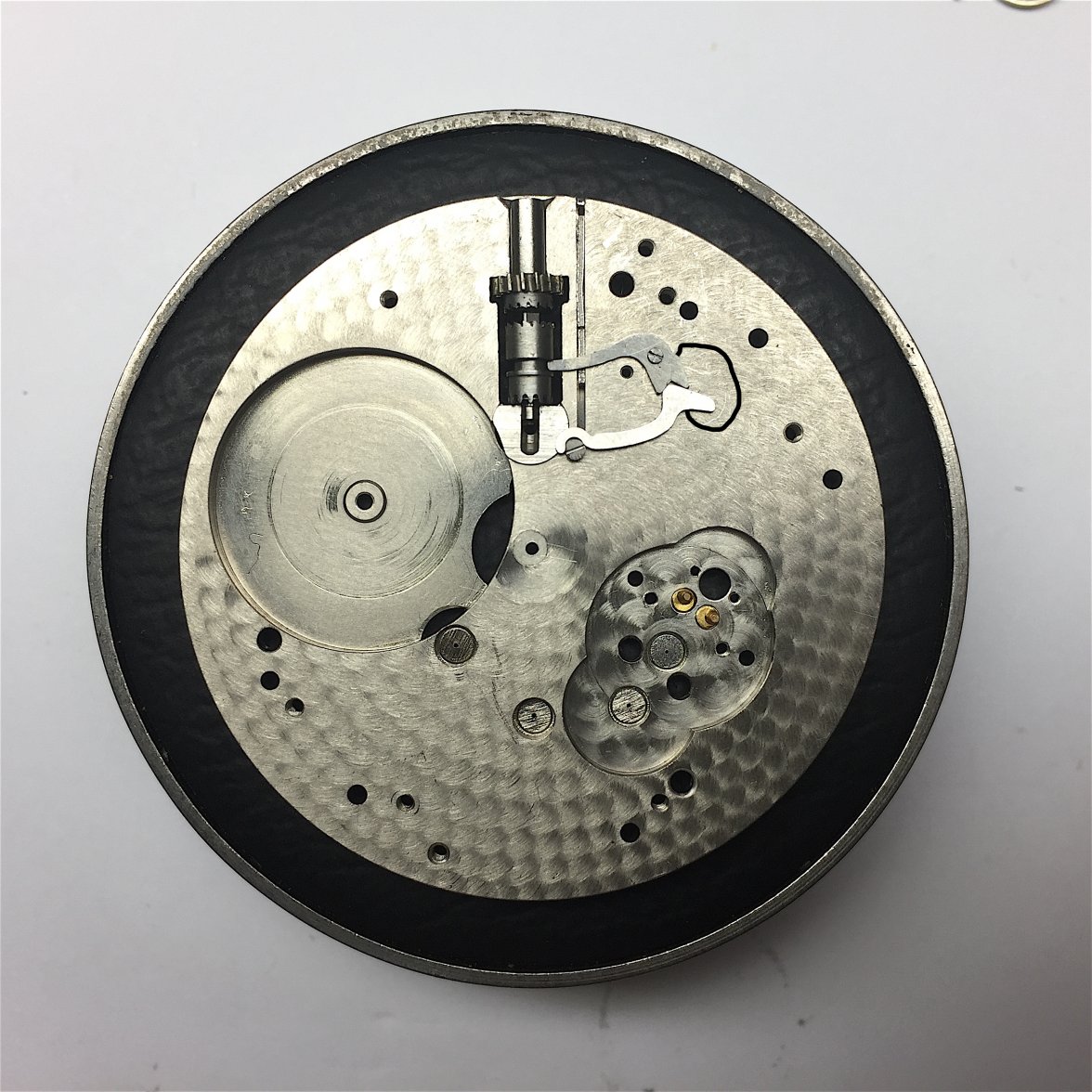

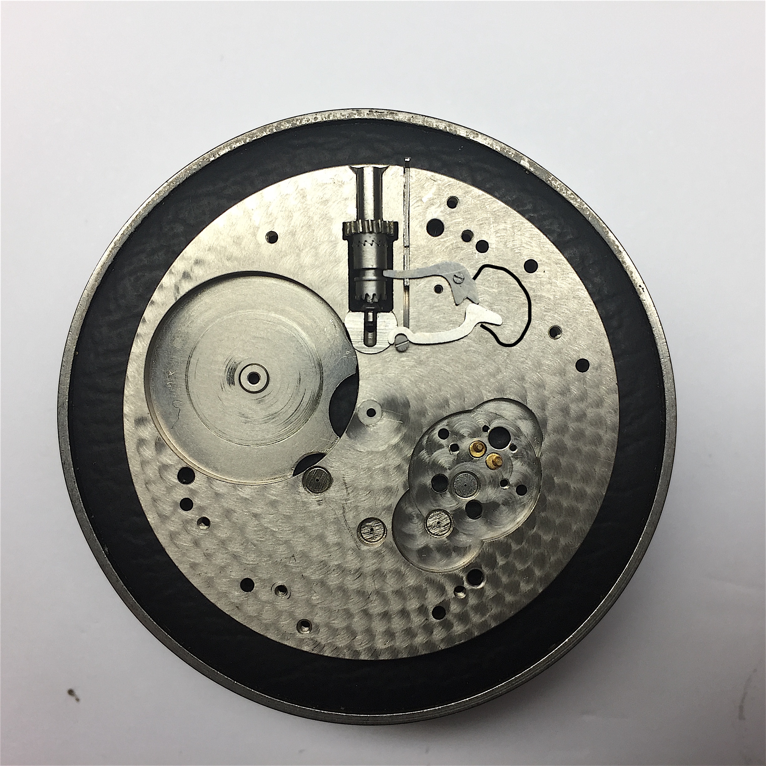

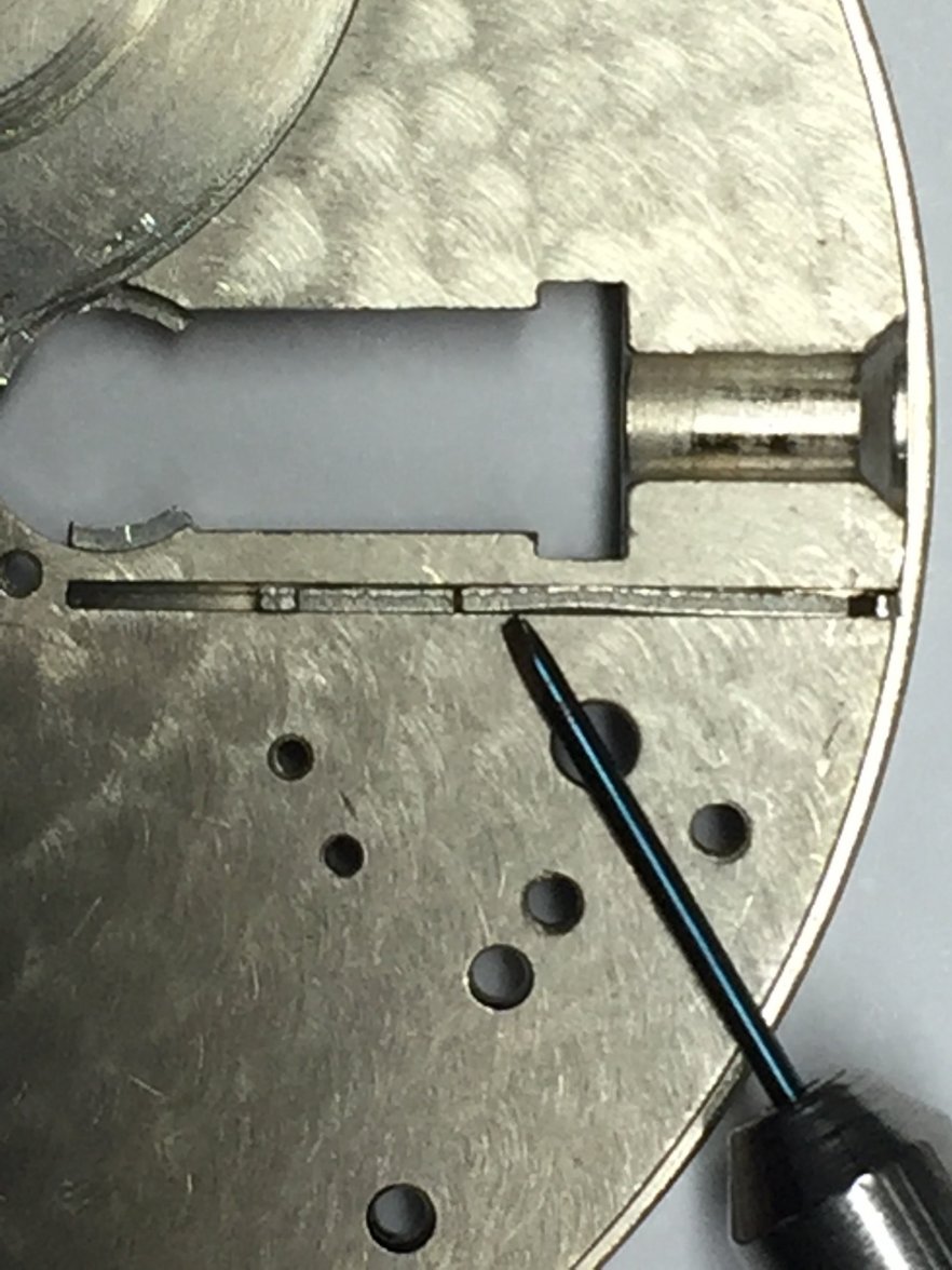

    Not scary this time, but I can't figure out what it's for.
    The sliding bar to the right of the winding works, can anybody tell me what it's purpose is?
    There's a small raised tab at the inner end and a raised point at the outer end and it can slide in the groove.
    The movement is a Waltham No 12 dated to 1928.
  9. SeanO May 11, 2017
    1,306
    1,443
    Something to do with having the option of being either lever set or stem set?
  10. JimInOz Melbourne Australia May 11, 2017
    15,404
    32,163
    Ah yes. Let me look at the crown assembly on the case again. The two position stops are controlled by the crown in the case, not by detents in the setting lever etc.

  11. Archer Omega Qualified Watchmaker May 11, 2017
    26,343
    65,049
    You got it - not related to stem or lever set, but for putting the watch in winding or setting positions when out of the case.

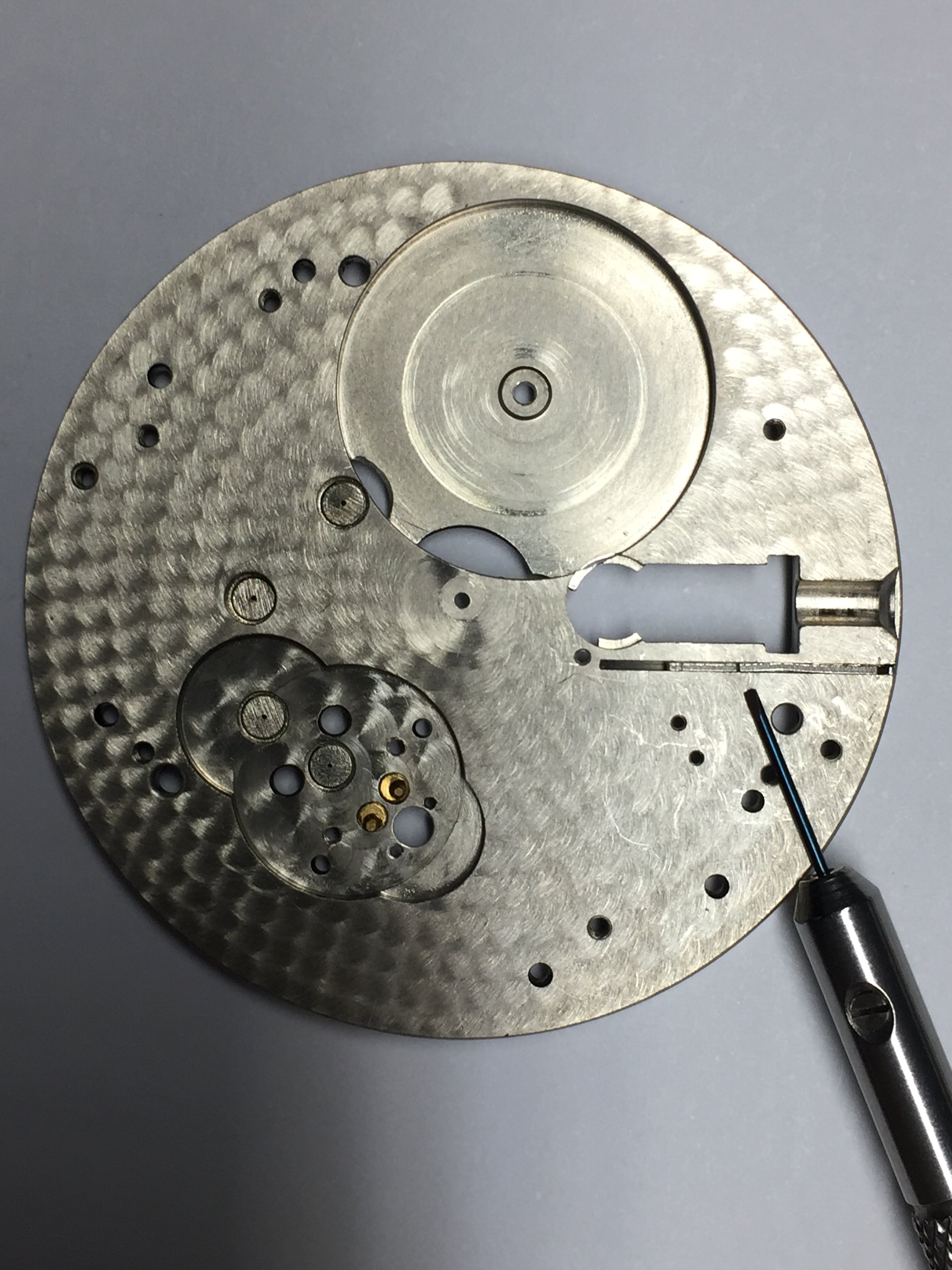

    Yep, I should have realised when I was taking the parts off :rolleyes:.
    Here it is in the first position.
    And here is the pulled up by the bar to the next position. Note that the "C" spring has been drawn in. The actual one went "ping", if anybody knows where it went just let me know. Looks like I'll have to make another one :mad:.

    Over there, just to the left of that thing...
    Easy enough to make - just some wire...
